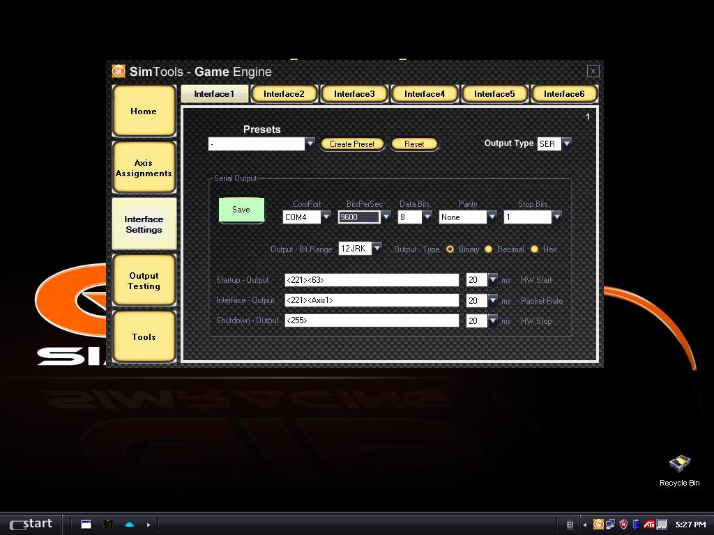

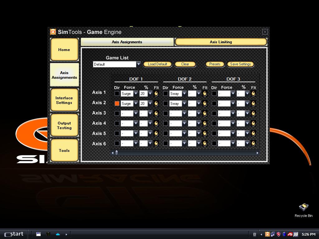

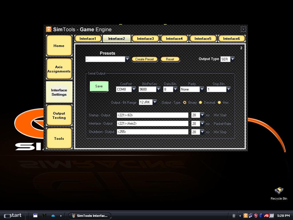

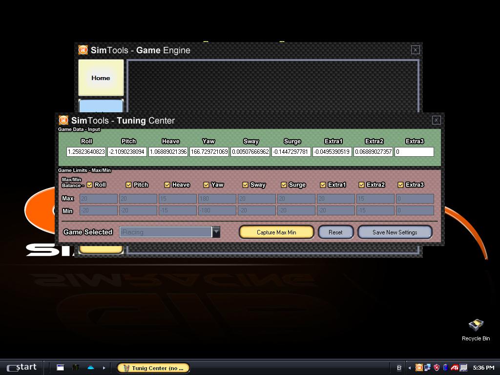

    Right'o. I got both Jrk's configured and I have both motors responding to the Jrk config utility. That's a good start!
    But, as I always thought, when it comes to the software part there will be teething problems.
    So here is what I'm up to:
    I am using an old laptop (win XP pro SP2) for the motion as I don't want to use any more USB devices on the gaming PC.
    I have installed SimTools on both machines. When I start up iRacing, I can see the values changing within the tuning centre. Awesome, things are happening!
    But, unfortunately no movement of the motors.
    I have looked at various tutorials on how to set things up and I think I am on the right track but as far as I can tell, by now I should have had some motion. I am sure there is something really simple that I'm not doing right but whatever it is, it's not obvious to me at this stage.
    So, I will be doing more research and will try to get my head around this whole thing a bit better as there are still a fair few things I don't understand just yet.
    I can almost see the light at the end of the tunnel!!!:D

    Hey @noorbeast - Here are the documents I have used so far:
    I started with this: http://www.xsimulator.net/community/threads/how-to-set-up-a-dual-pc-installation-of-simtools.4974/
    Where it said to install SimTools on both PC's, I did the Full install both times. I also drag and dropped the plugin on both PC's and that seemed to have worked too.
    I have also used the attached document to help me out.
    And here are the Simtools settings:
    SimTools Axis.JPG SimTools Interface 1.JPG SimTools Interface 2.JPG Tunig Center (in game).JPG
    The Commports used within SimTools are the ones called "Pololu Jrk 12v12 Command Port" when I look in the device manager in windows.
