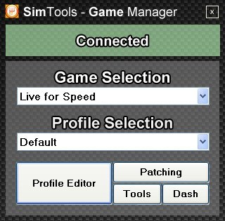

    The guide says that the game must be patched, but I can't find any "patch" button?
  2. Nick Moxley
    17,056Coins
    +2,506 / 30 / -2
    Game manager. In your Notification center you will have 2 simtools Icons, One is the Engine, One is the manager. the Patching button is located on the main page of the Game manager as seen here.
