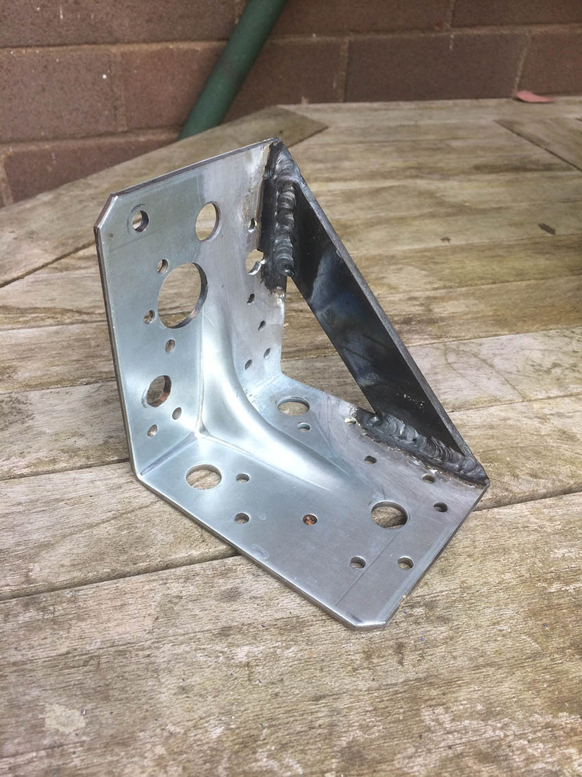

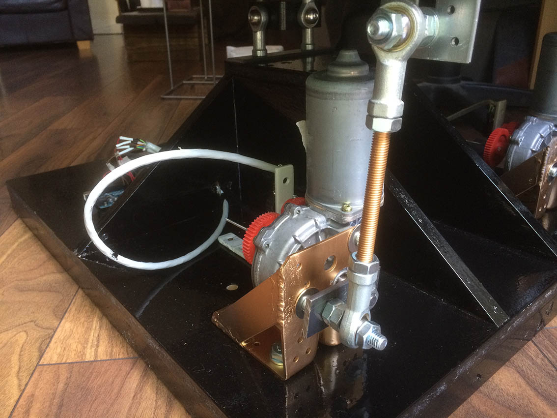

    So decided to re-enforce the brackets after getting some gear slipping, so I took the brackets to my local car garage, and they very kindly welded me a brace for a tenner.
    I have run the profiles at 100%, and no gear sipping! So I'm very happy now.
    While I took it apart I took the opportunity to paint it, and I made the stupid mistake of choosing gloss paint, (should have gone with a matt/satin finish). It came out terrible, was painting outside and bits of fluff kept landing in it, then it started raining, the primer didn't seem to take so the paint kept absorbing into the edges.
    But it doesn't matter, the important thing is it can run at full power with no slipping now. Theres still a tiny bit of play, but not enough to disengage the pot gears.
    Don't let the pictures fool, it looks a lot worse in person! lol

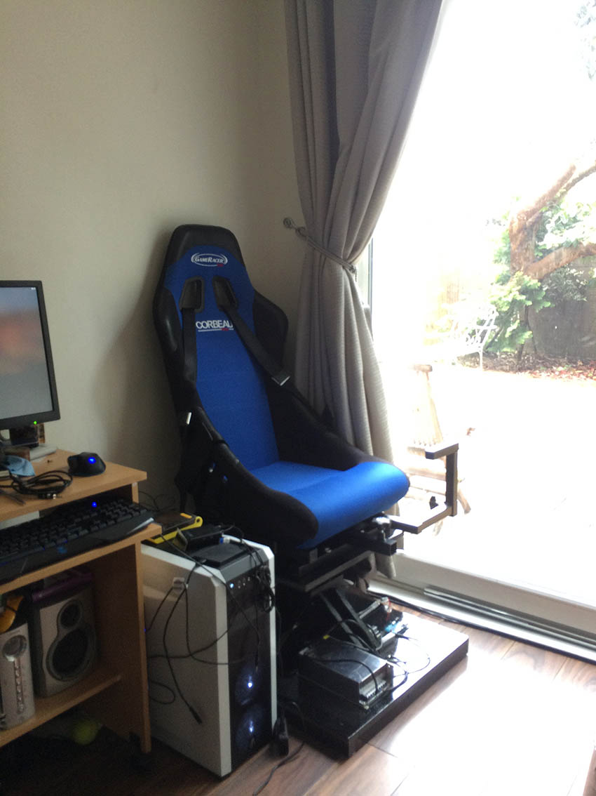

    Another good thing about the SimuKit is the footprint. It stores away nicely in a corner.

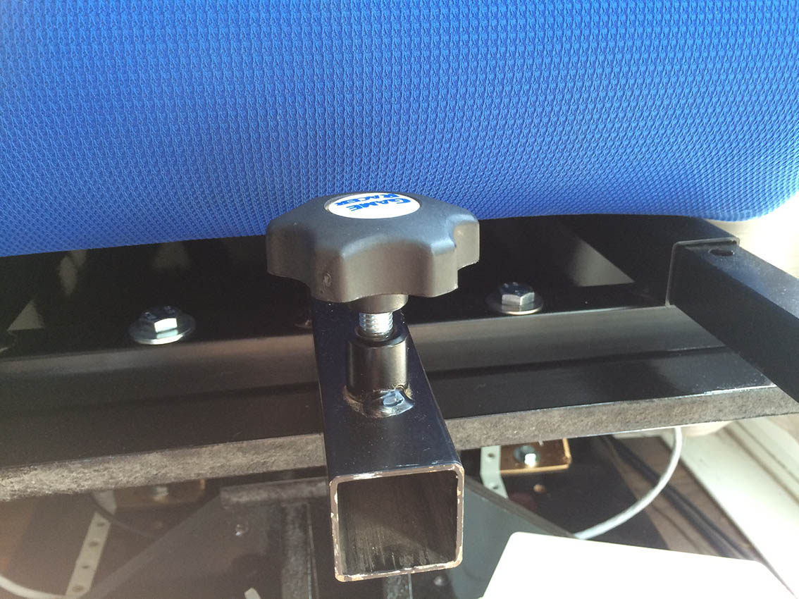

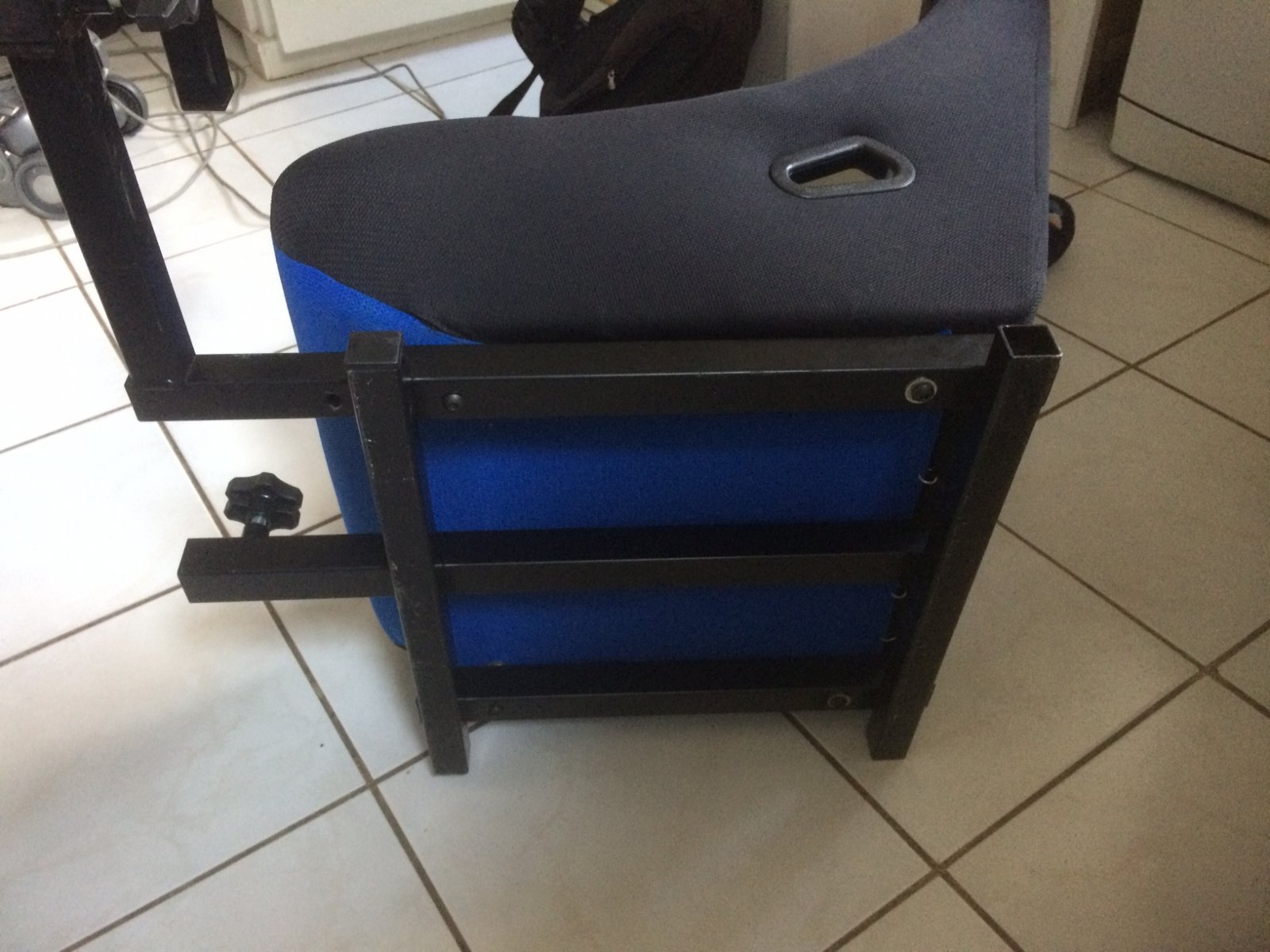

    I just drilled 4 x 10mm holes in the chair base, after finding the centre of gravity.
    Because of the COG of my full frame choice (I think the simukit was designed to be a seat mover), I needed to adjust the pivot point forward, on the top MDF plate, and move the motors back. Chair Base.JPG IMG_3926.JPG

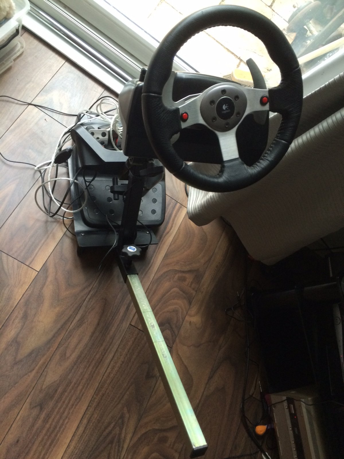

    IMG_3927.JPG Sorry, I misunderstood.
    The pedals and wheel are part of the GameRacer Elite cockpit.
  20. Paul Shortland
