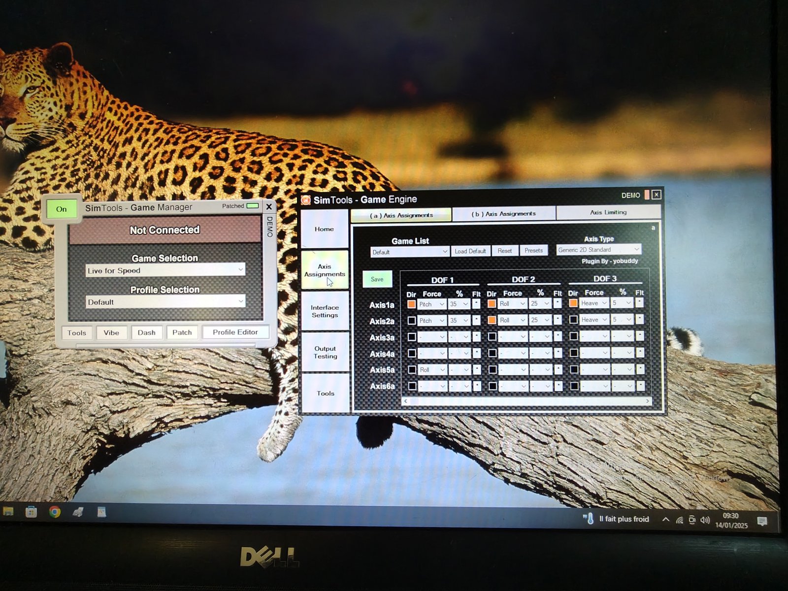

    hello I downloaded the LFS game from the site you gave me I followed your advice I uninstalled the old one I had I started the computer I installed the game on the site that you gave me I launched the game solo after I patched the game and it doesn't always work did I miss something thank you

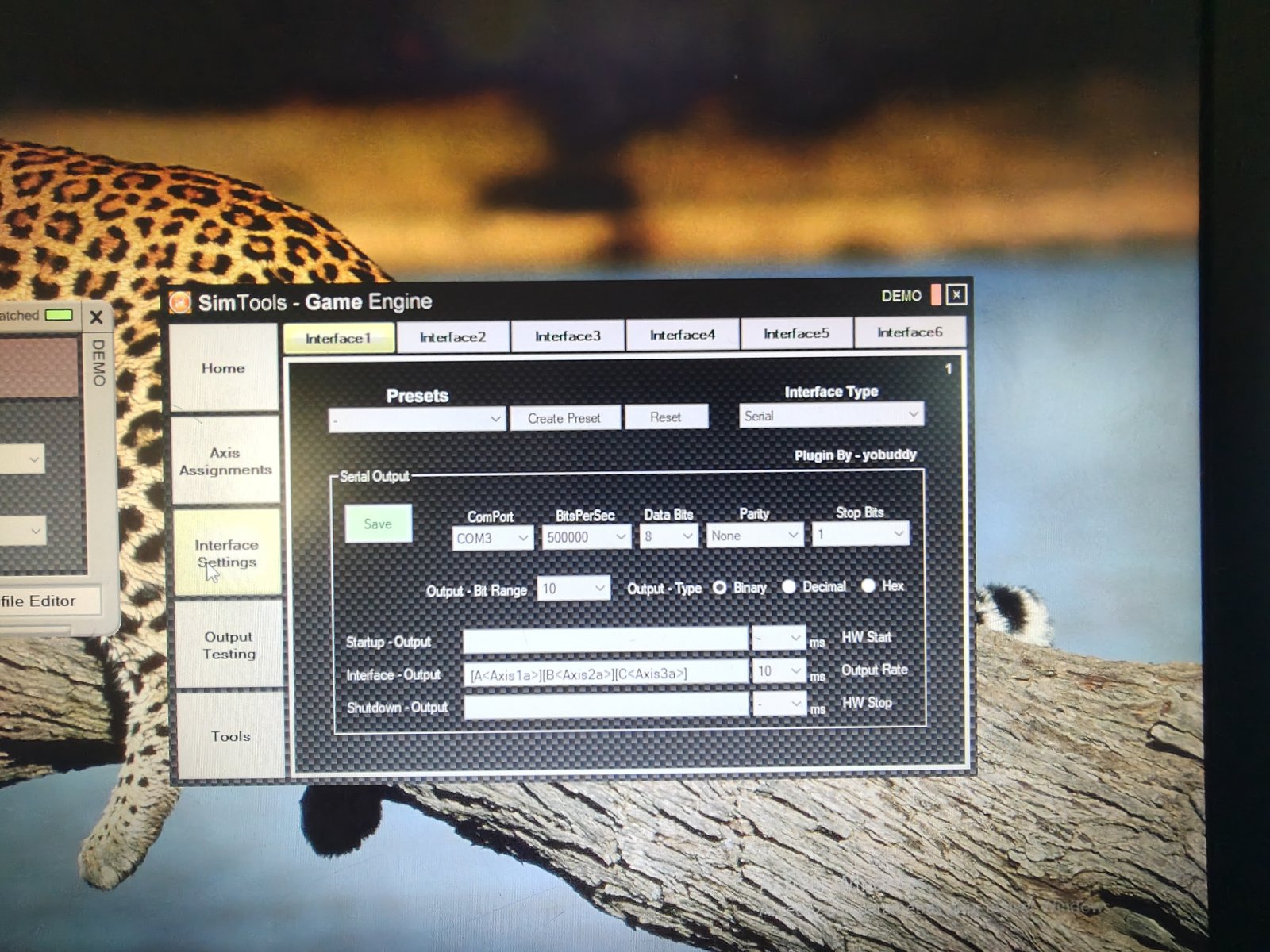

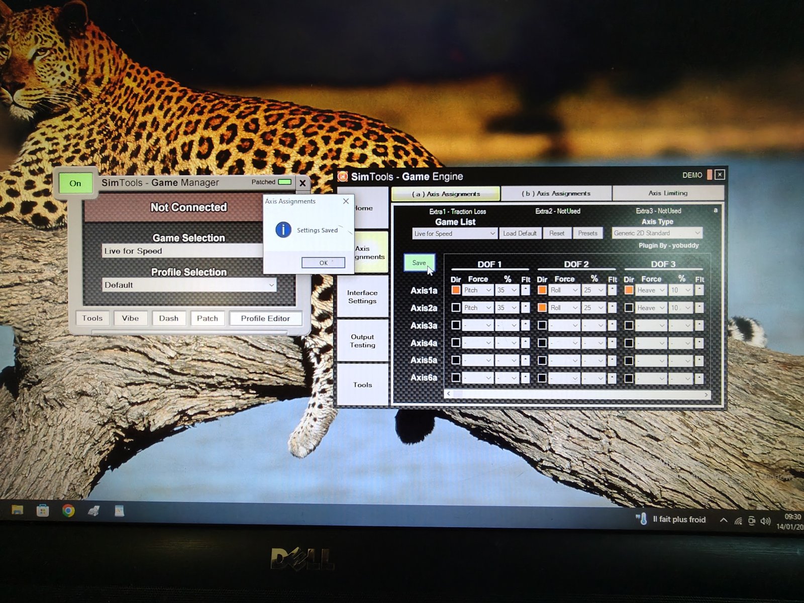

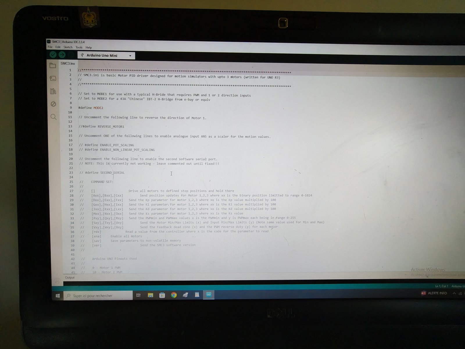

    Can you please post pictures of all your current settings and confirm the rig does move as expected in Output Testing with a configured Default profile.

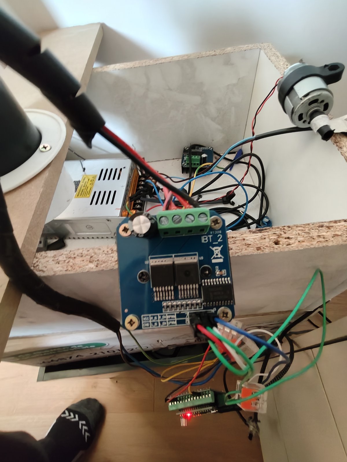

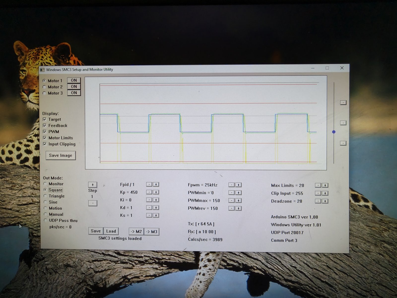

    hello as agreed I put the photos and videos of my programming thank you and have a good day for your help thank you.

    I can confirm that when I move the motors manually it moves in both directions thank you

    21,665
    151,644Coins
    +11,044 / 56 / -2
    By that do you mean Output Testing works as expected with the Default profile?
    The first bit of the video looks to move as it should, but I am not sure what you are doing that triggers the weird movement in the second part of the video, as only the motor is shown.

    in fact I moved all the axes I left the axes I did not set to zero and when I moved the 4th axis in fact it moved strangely with the others

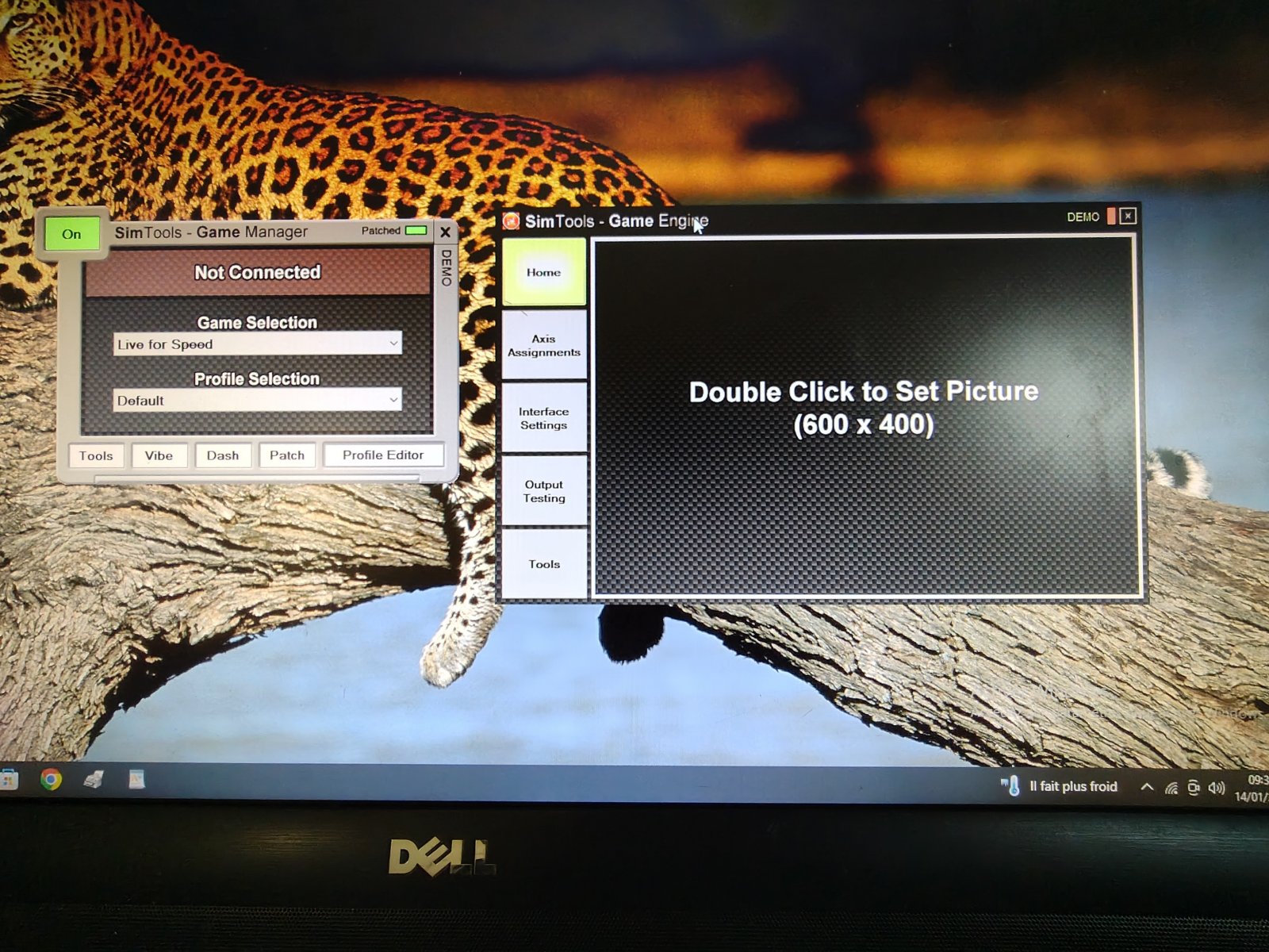

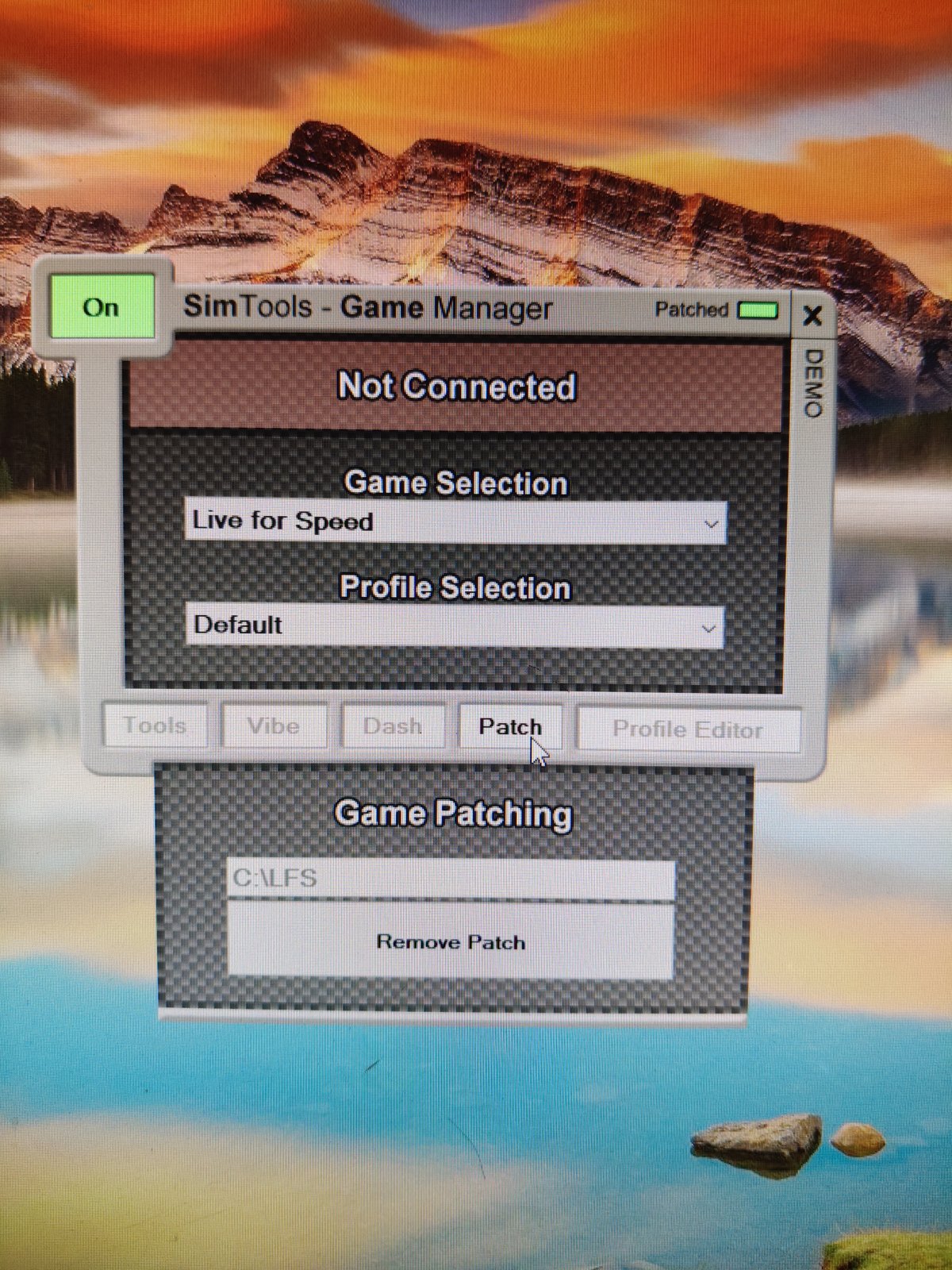

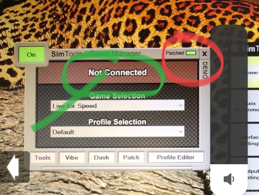

    hello after several tries I can't always get my LFS adjusted in the photo that I just posted circled in red the games patch is indeed made of glass but the glass surround is marked not connected is that It’s normal, it could come from there, thank you.

    If output testing works as expected either something is interferring or not configured correctly.
    Unpatch LFS, temporarily disable antivirus, run LFS, then repatch LFS.

    hello thank you for the answer I just did everything you told me I uninstalled I installed the game and still does not work with the LFS game. I don't know where it comes from I have pascth the game it's in glass, but not connected it's normal

    What @Attyla.pl means is that the language settings on your computer may be related to a known bug, you need to make sure your computer is set to English local and see if that resolves the issue.
    If not the SimTools dev @yobuddy may have some suggestions.

    Hi @titofe,
    Since you are just running in demo mode with not a lot setup in v2, you way as well install SimTools v3 and test out Live for Speed with the newest version.
    https://simtools.us/downloads-links/
    (The region problem is all fixed, and you can install game plugins directly in the app.)
