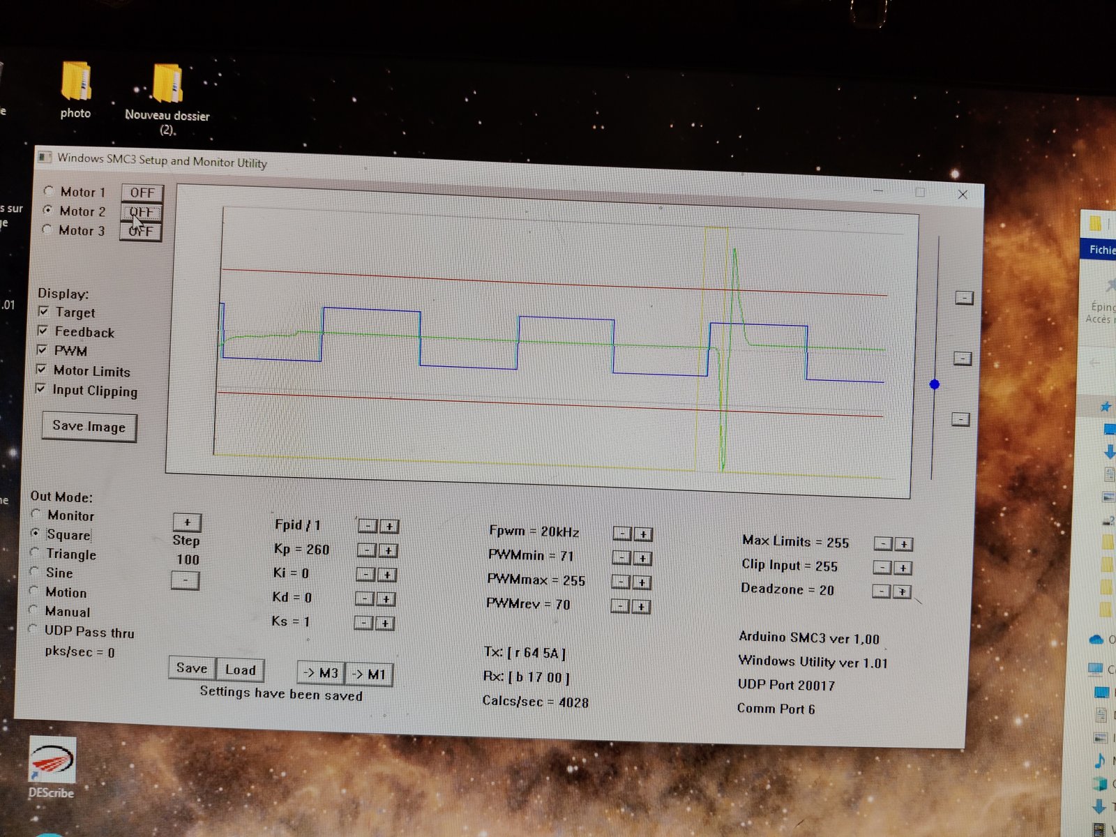

    new problems with the 2nd engine adjustment. as soon as I start the green line and go up it goes down quickly it cuts off the values they are lower than the first motor thank you

    in the picture you can see motor 1 completely disconnected.

    Do you have any ideas on how to adjust the 2nd motor? Thank you

    Are you using a 180 degree hall sensor, if so it could positioned 180 degrees out.
    Also try swapping the control boards around and see if the problem follows.

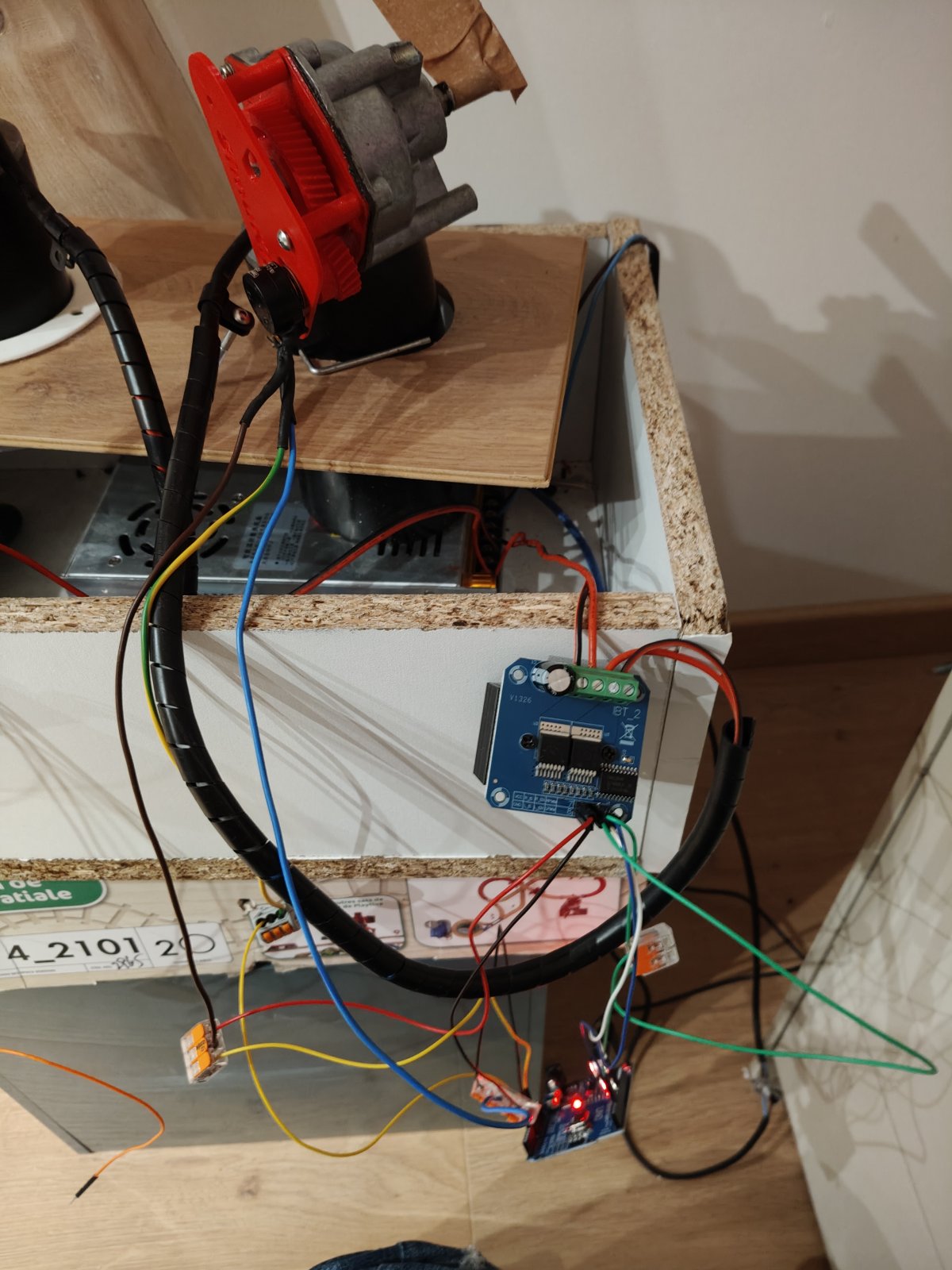

    thank you for the answer hall sensor no I don't use is there a photo where to put it. on the other hand the card for the second engine is the second one because the first one had burned out, it is brand new.

    Being brand new is not a guarantee there is no fault, and swapping cards is an easy check.

    ok I'm going to try a new card on the other hand the hall sensor do you have any photos? on the other hand, 1 motor is well adjusted but the second one has interference everywhere.

    Whith electrical interference carefully check cable management, use shielded wire, and Ferrite magnets can all help.

    swap the plus and minus wires on the motor output of the IBT2 controller by place.
    Run the “Sine” control on the first engine and then compare with the second engine you will see the difference

    hello big disappointment today I managed to get new iBT 2 cards to be able to adjust the second motor I lost everything even the adjustment of the first motor it's incredible I can't even adjust the first motor, I'm a little disappointed for the 1 motor it was well adjusted it reacted well. if you have any idea thank you friends.thank you:(
