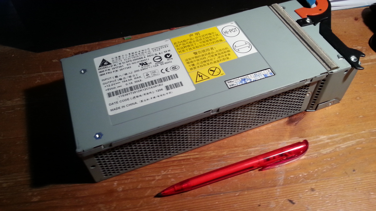

    Holy shit how they are big! The two babies have been delivered, so hot and pretty nice looking :grin

    Surprisingly small for the wattage when u think about it. 3X as much as the 600pb's but really not THAT much bigger in comparison, Wider yes, but I thought it would have been a Far Larger Brick.

    I tend to agree @Nick Moxley, not a bad size for the power, even taking into account that external fans are needed.

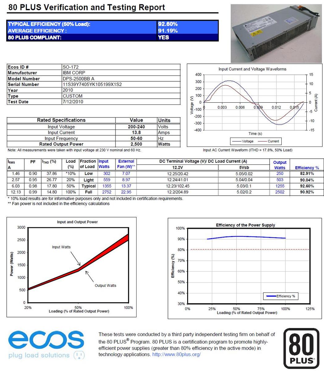

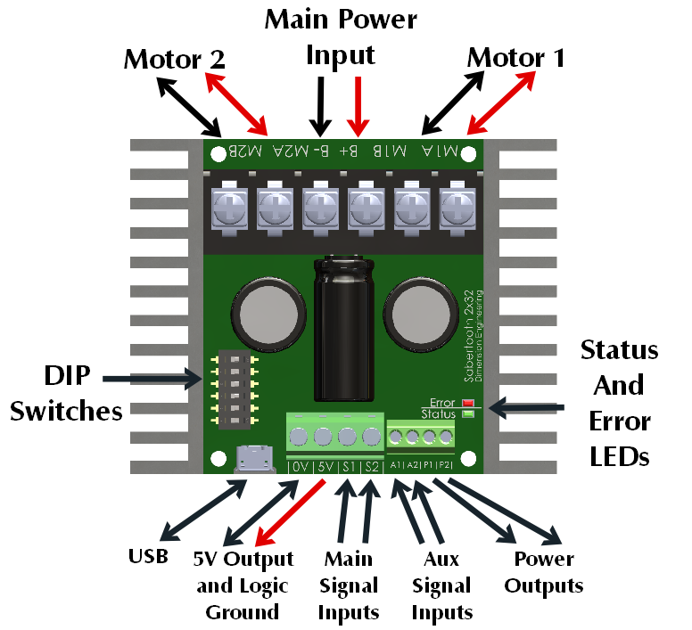

    @Pit I have the same issue with my PSU (2 in serial to achieve 24V btw, but same problem with one). In fact the server PSU are protected against a lot of things... and when our DC motors stop/reverse they generate power, which is sent over the lines to the PSU. and the PSU is not desisgned for this => failsafe mode. A solution would be to put a diode to avoid current going back to the PSU but dimension engineering argues that the current generated by the DC motors should be dissipated somewhere. The sabertooth 2*32 has such connections for resistor to dissipate current, but my PSU still go to safe mode (less frequently). So my next try will be with resistor and a big diode (like used in automotive)

    So I found a 4A diode which I fitted on the minus side as I noticed that it is generally this PSU that shut down before the other (I have 2 12V PSU in serie to get 24V).
    I did forward/reverse many times for several minutes.... no safe mode :p

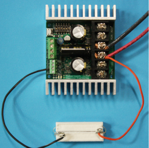

    The voltage clamp resistor became slightly warm on the sabertooth (9 ohm/25 W). I have the feeling the power is not sent back to the PSU but is dissipated by the resistor.

    On the sabertooth 2*32, it is located on the P1/P2 ports on the board. Those ports must be configured for voltage clamping but they can also be used for brakes or as general outputs. This is configured through the describe software on your PC.
    This is why I changed my 2*25 for a 2*32.
    On my previous pictures, they are the "golden" heatsinked resistors. I put them in parallel to get a 9 ohm instead of 18. (with the sabertooth, you get a pair of 5 ohm / 10W in the box)
