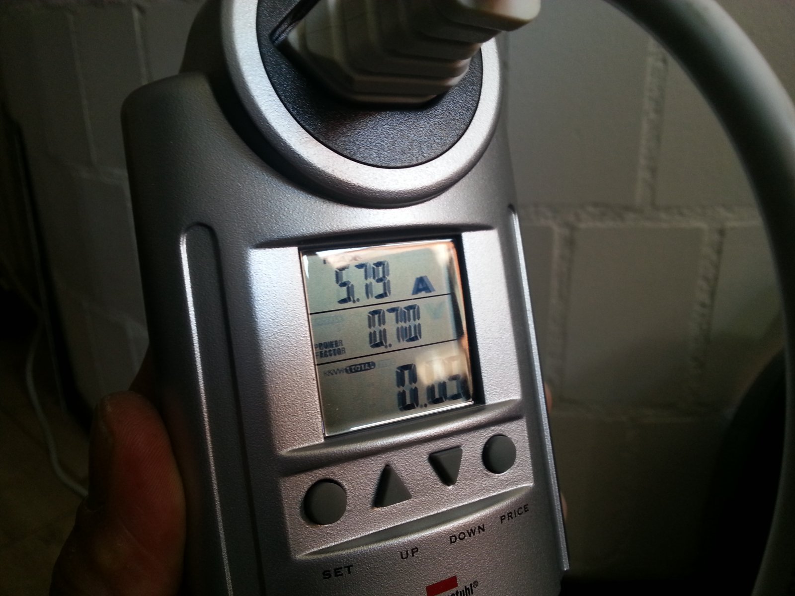

    Daniel thanks for sharing your thoughts. As I have posted above I have no issues anymore. Sometimes I am going through the process as long as I can see there is some progress but now I will waste time for nothing. The DPS-2000B is a very powerful but sensitive psu. Bypassing the "intelligence" makes no sense to me. I am going to post more information in the new psu thread today. BTW not bad the power consumption of my two winches on a 220v line :

    Power factor could be better (can't do anything about that) but that current draw is a good indicator that the system isn't going to overload the wall socket.

    I measured all again, I connected all gadgets (all motors including PSUs and ventialtors, speakers, 3 LED projectors, PC (i7 3.8 GHz, GTX 670 SLI), Notebook (Ard/MM), smartphone, T500RS wheel, bass shaker, butt kicker) to one wall socket and the powermeter as well.
    1. No driving, all gadgets on: ~950W, power factor 0.88 - 0.97, 4.2A
    2. Driving on Nordschleife: ~1200 W (~1450 W peak.), power factor 0.88 - 0.95, ~5.00 -6.00 A (9.4 A peak).
    IMO not too much I expected more. The peaks are coming from crashes.

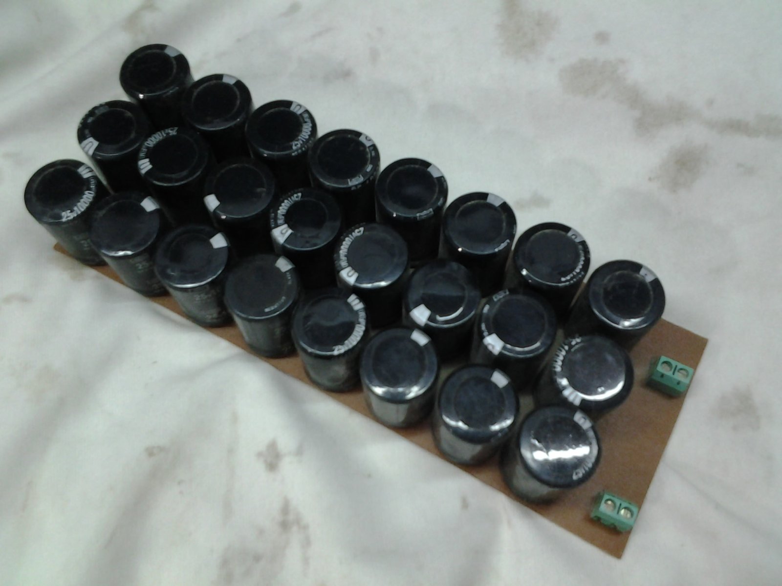

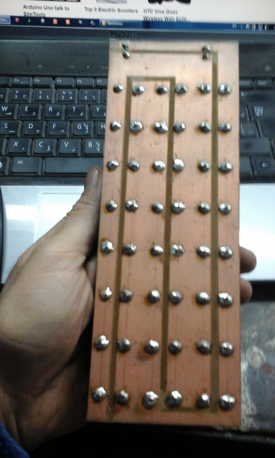

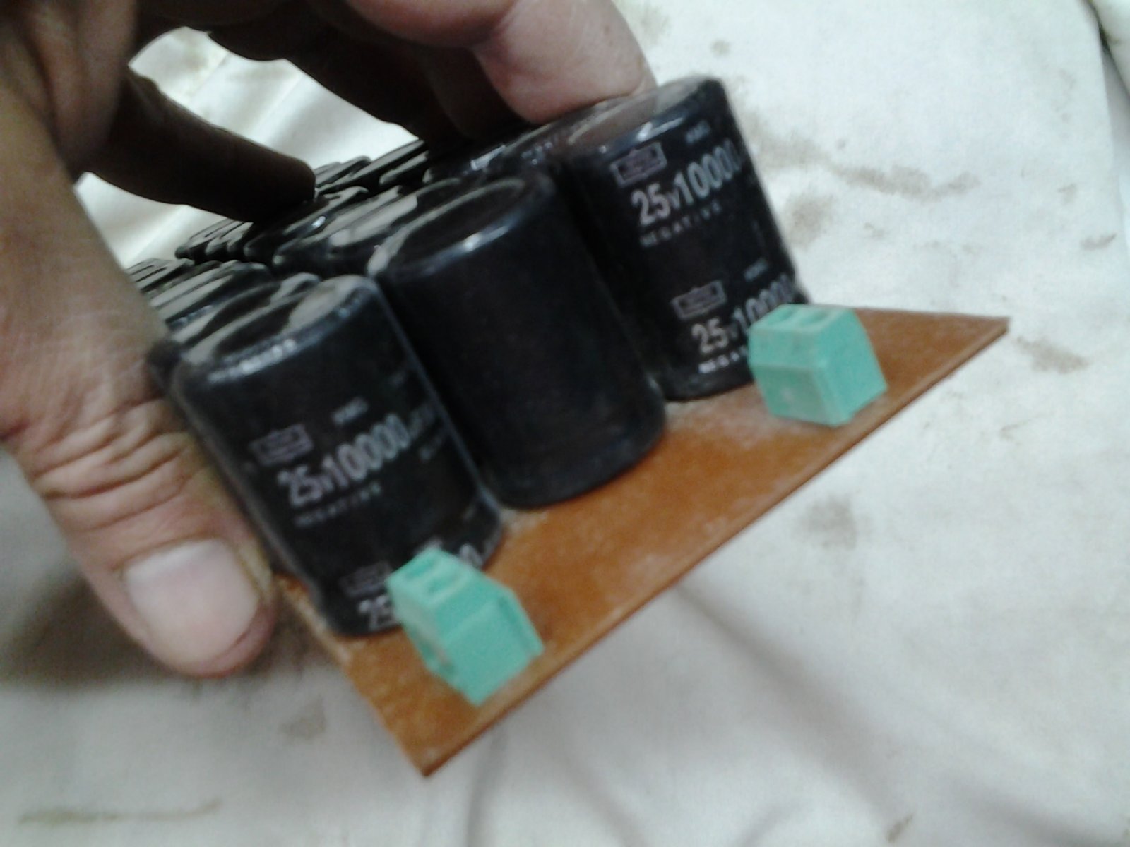

    I've created and tested this "Capacitors power bank" of 24 caps of 10000uf/25v connected all together in parallel ... then used in parallel with a normal desktop PSU 12V that kept shutting down when using a big 70Amp burst current wiper before adding this beauty then worked like a charm ...

    Nice. You just missed a "0" in the text. The caps you use are 10 000uF, which makes more sense. Have you protected the "caps bank" by diodes or something else ?
  12. speedy
    speedy Well-Known Member
    Feb 1, 2012
    1,193
    Alexandria , Egypt
    7,950Coins
    +1,287 / 10 / -0
    Yes it's a 10000uf/25V "typo" ... corrected thanks :cheers
    No diodes here at all ... this power bank can absorb any feedback voltage/spikes ... and is connected and treated as if you have a car battery in parallel to the 12v charging line in parallel to the h-bridge supply lines ...
    protection diodes are actually used in the h-bridge circuit to direct any excessive voltage back to the power supply which is bad for the PSU ...
    The issue with some power supplies is that they cannot provide such huge amps at the start/reverse of a motors and that what causes many of us to select bigger PSUs ...
    So, Go for more caps enhancing the output stage of the PSU if you need .
    Caution : When done with playing .... you have to use a bleeding 35w filament lamp or 1/2w resistor for a good 2-3 seconds to make sure they are really empty "LED is not recommended as they will stay ON like forever " :grin .
    Huge difference at the motor starting torque with absolutely no shutdown protection to the PSU .:thumbs
