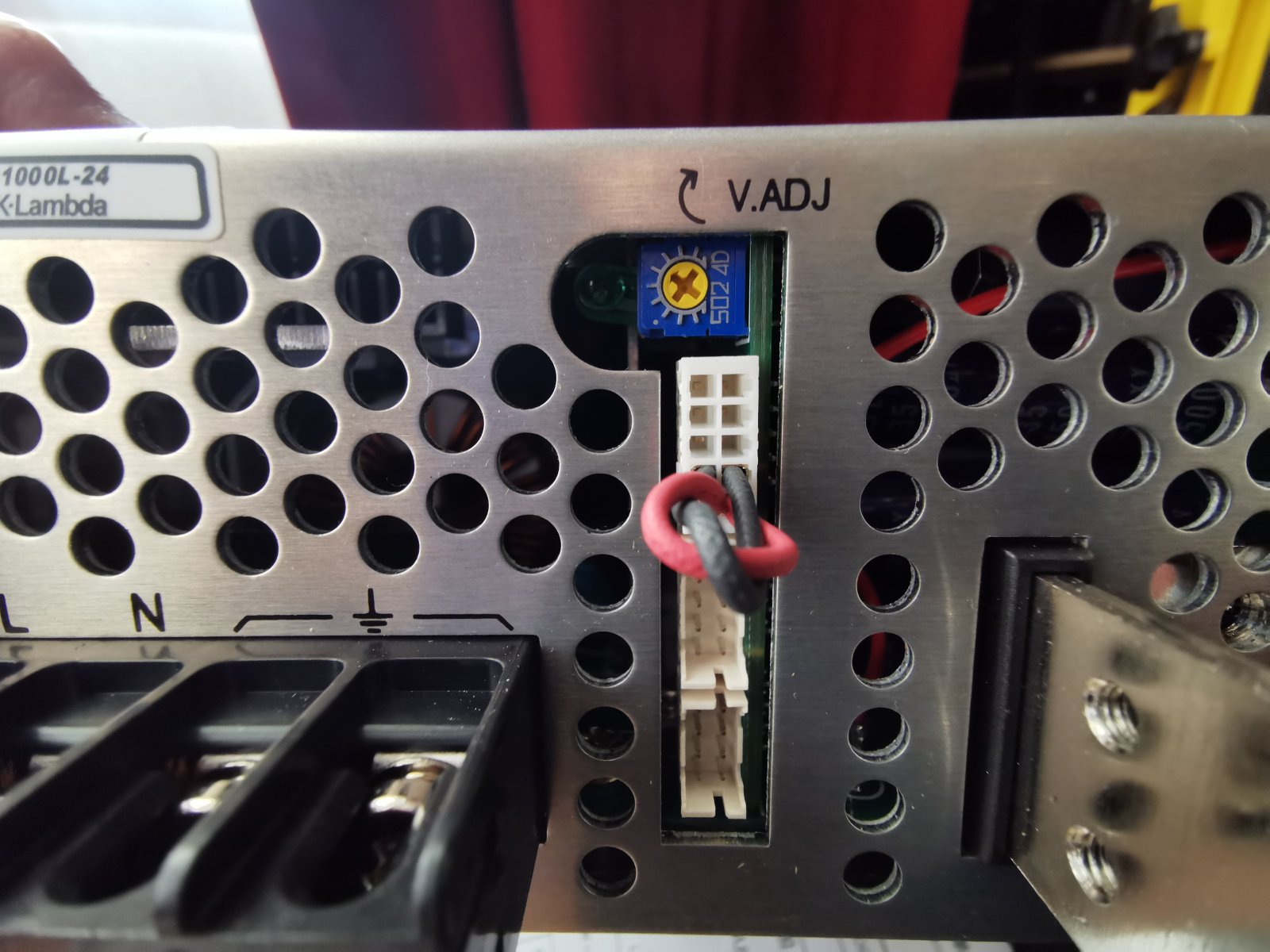

    I'm not sure if I understand what you're trying to say, @Anthony Morris. I guess you don’t mean the PSU has 44 A @ 240 V! That would rediculously mean it has >10.000 W...
    Btw: The PSU can deliver up to 51 A according to the manual.
    So, are you saying, that my voltage of 0 V at the output side depends on my voltage of the input side? No way!

    Does your drive have the jumper lead on the back?

    Yes, and it's pluged in in CN1.

    Yes, I read the whole Manual. To find out, that everything is wired the way it should be. I have the jumper like it was deliverd +Vm to +S and -Vm to -S.
    As far as I understand this jumper setting makes it a „normal PSU” without any remote functions…

    Found the problem:
    the output voltage adjustment trimmer was put to max which caused the PSU to shut down. The green LED turned on and off again immediatly but the fans were working, so I didn't assume in first place, that the PSU did shut down.
    After turning the trimmer down I can measure the voltage. Hopefully I will be attach the actuators to my rig, than I can also test it the PSU delivers enough current.
