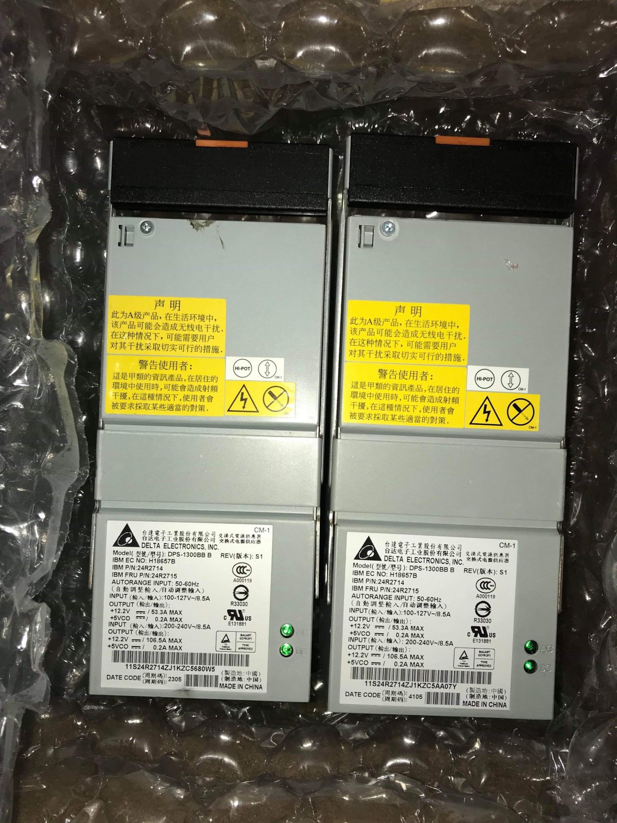

    Here is my SPUs
  3. SilentChill
    2,653
    20,660Coins
    +3,593 / 34 / -0
    Yes but you need a 12v car battery in parallell to get rid of the regenerated current from the motors.
  4. cnupa4ka
    cnupa4ka Member
    Mar 1, 2019
    53
    385Coins
    +17 / 0 / -0
    or better replace it with 2x32?!
  5. BlazinH
    BlazinH Well-Known Member
    Oct 19, 2013
    2,145
    Oklahoma City, USA
    16,703Coins
    +1,840 / 32 / -1
    Not better if you need the additional amperage the 2x60 provides.

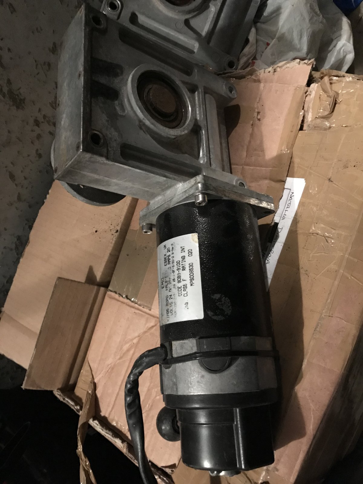

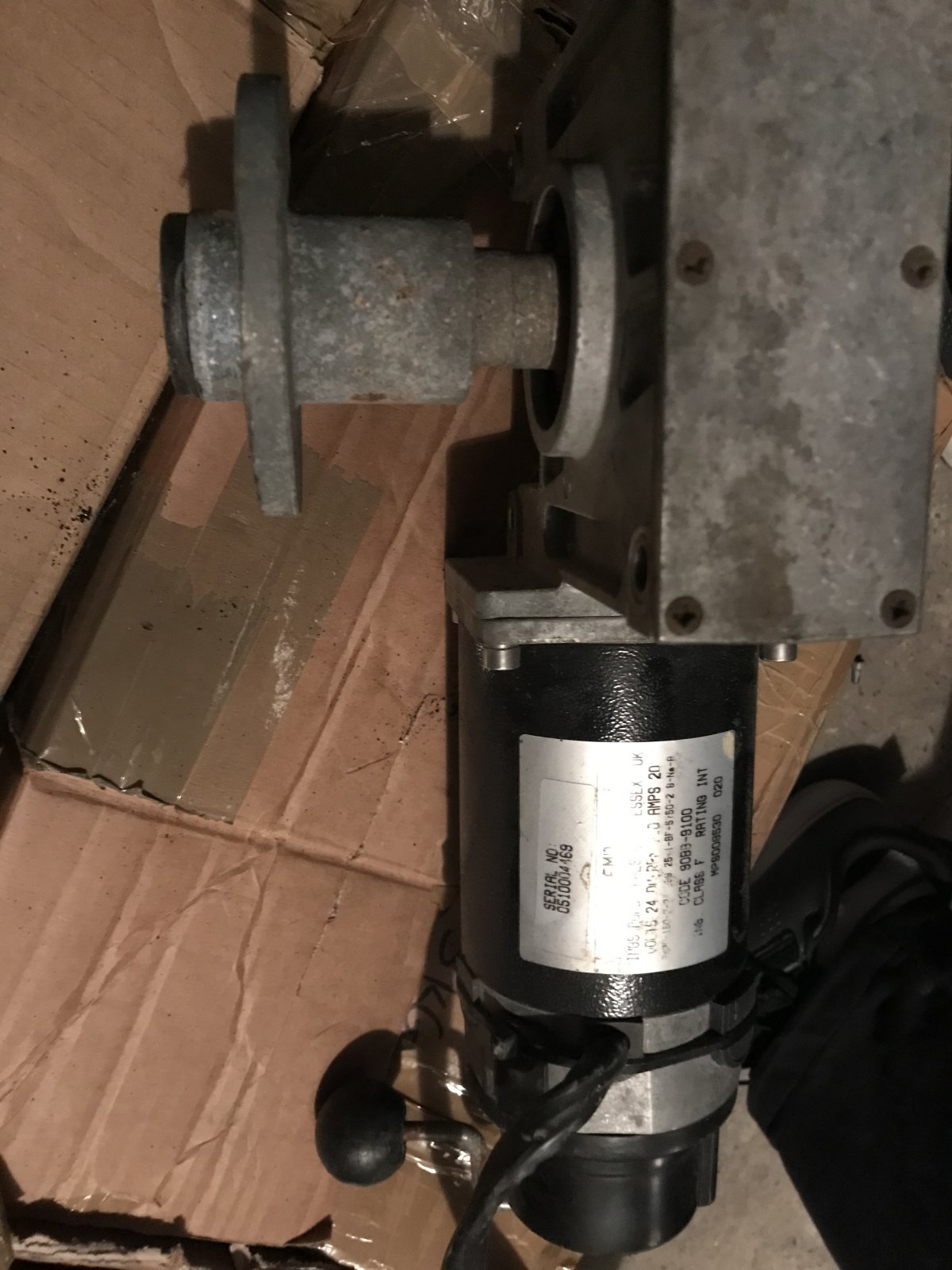

    This is the motors I will use..
  7. BlazinH
    Oct 19, 2013
    2,145
    Oklahoma City, USA
    16,703Coins
    +1,840 / 32 / -1
    Also I just use a 100 watt power supply with no battery to run two 2x60's so a battery isn't always required.
  8. cnupa4ka
    cnupa4ka Member
    Mar 1, 2019
    53
    385Coins
    +17 / 0 / -0
    So what about in my case? How do u think?
  9. BlazinH
    Oct 19, 2013
    2,145
    Oklahoma City, USA
    16,703Coins
    +1,840 / 32 / -1
    A 2x32 should run those okay although they may peak over 32 amps at times.

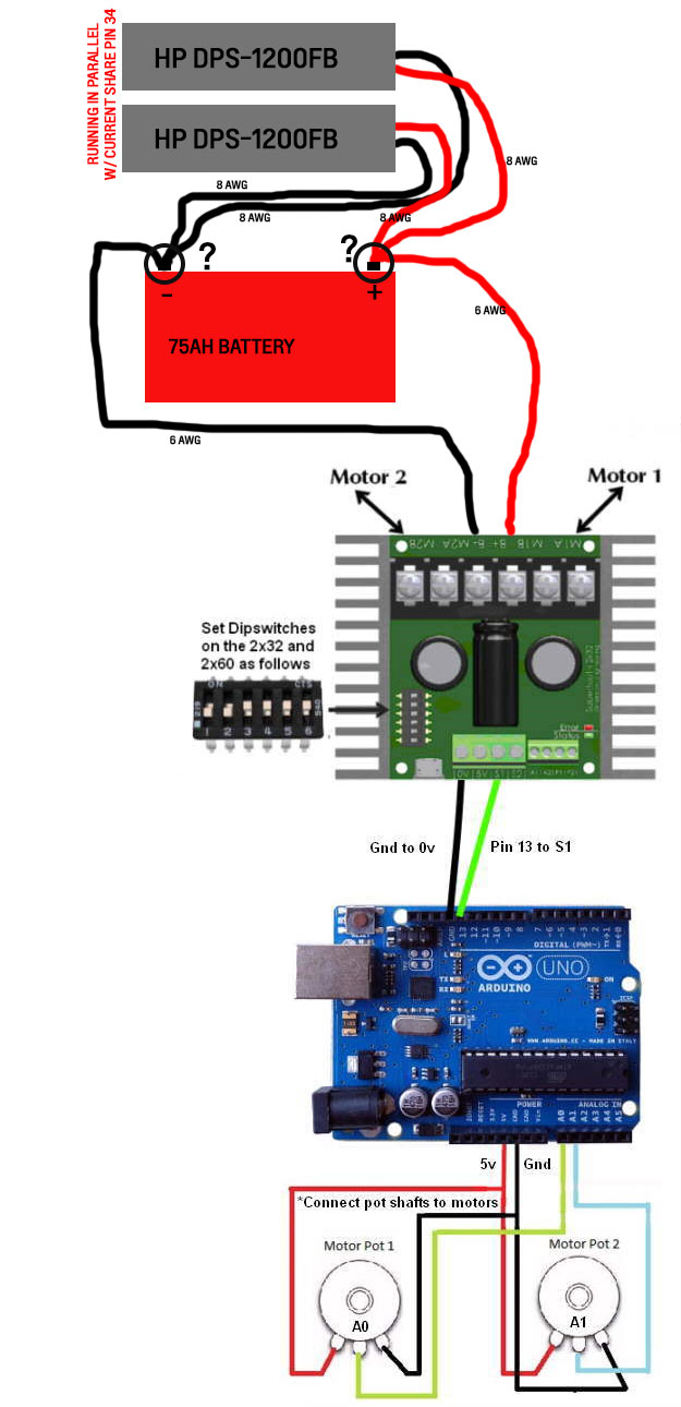

  12. cnupa4ka
    cnupa4ka Member
    Mar 1, 2019
    53
    385Coins
    +17 / 0 / -0
    What about if I use this circuit?
    Is the PSUs replace the charger for the batteries?
  13. cnupa4ka
    cnupa4ka Member
    Mar 1, 2019
    53
    385Coins
    +17 / 0 / -0
    Use of our motor drivers with cheap AC adapters is not recommended. Use a battery or at least put a battery in parallel with a DC supply.
    They say that for 2x60
    So that means I can use it with my PSUs but with battery in parallel to pick the regenerative current?
    If yes what battery size I need to put?
    The motors is 24V and I will use 2pcs PSU in series.
    Thanks!
  14. BlazinH
    Oct 19, 2013
    2,145
    Oklahoma City, USA
    16,703Coins
    +1,840 / 32 / -1
    Yes.
    One 24 volt or two 12 volt in series with a minimum of 25 amps hour for 2x32 and 35 amps hour for 2x60.
    Since your supplies aren't designed for charging batteries just be sure to disconnect them when not in use so you don't risk overcharging.
