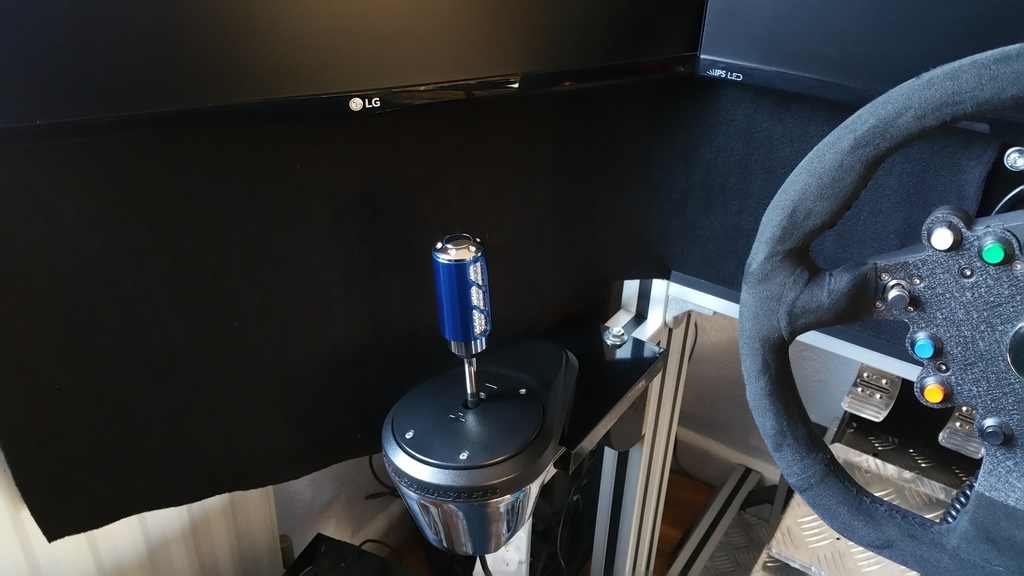

  3. Hoddem
    Hoddem Well-Known Member
    Sep 27, 2016
    404
    Engineer
    Minnesota, USA
    3,343Coins
    +717 / 2 / -0
    Is your shifter static or is it mounted to your chair? I'm building a seat shaker similar to yours and I'm struggling with how to mount the shifter and e-brake. Static or moving with the seat.
    Also, any idea how many degrees your seat moves through in each axis, pitch and roll.
    Great looking rig, congratulations
  4. stevemontuno
    stevemontuno Active Member
    Apr 24, 2015
    316
    UK
    1,461Coins
    +335 / 0 / -0
    Cheers ,,,,, The shifter is static attached to the H-frame next to my wheel,
    I don't know the actual degrees but i am using the Boundary filter with Pitch & Roll to shorten the degree of movement whilst still keeping the effect full on so to speak ,, Plus i find it stops pitch,roll & heave bleeding into the surge & sway too much with a 2DOF .

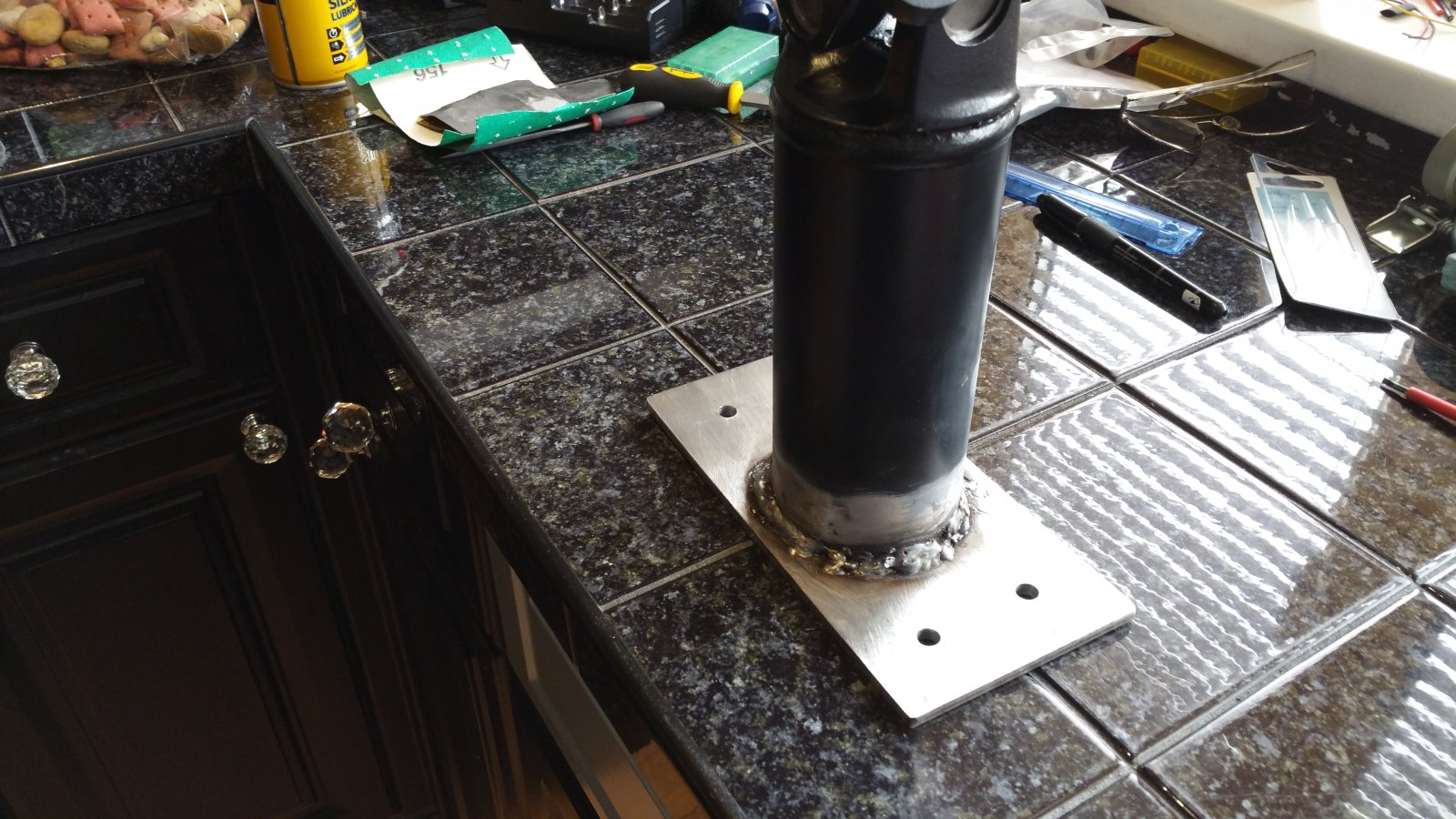

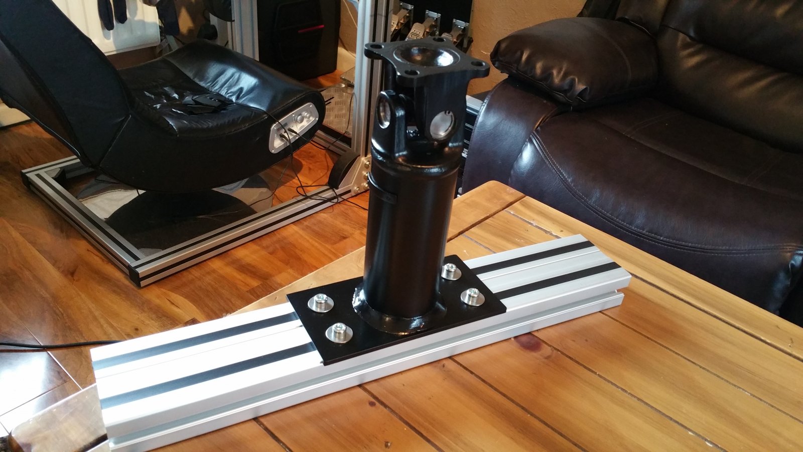

  8. Abram Manoge
    Abram Manoge Member
    Apr 6, 2021
    46
    Web developer
    South Africa
    319Coins
    how long did you make your Ujoin?
    22,185
    154,750Coins
    +11,196 / 57 / -2
    @stevemontuno has not been active since March last year, and the post you are referencing is even older, 2016, so I am not sure you will get a response.
  10. Abram Manoge
    Abram Manoge Member
    Apr 6, 2021
    46
    Web developer
    South Africa
    319Coins
    Oh I has not noticed. Do you by any chance know roughly how long a can make the ujoin and still have a comfortable seat height.
    22,185
    154,750Coins
    +11,196 / 57 / -2
    That depends a lot on the actual rig design and if it is a seat shaker (needs less clearance so shorter Ujoint) or full frame (needs more clearance so longer Ujoint).
  12. stevemontuno
    Apr 24, 2015
    316
    UK
    1,461Coins
    +335 / 0 / -0
    I seem to think it was about 25cm long ,,I needed it that high because i wanted my foot pedals raised so i could fit my motor control box under them ,,,,
    noorbeast is right though it all depends on what type of design your going for.
