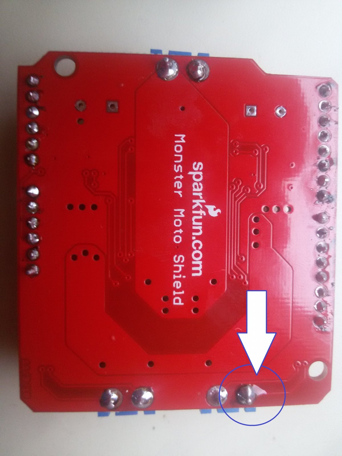

    Ok, there MUST be something wrong, because I can use the MMs without cooler only for testing with especially when no motors are connected. They stay cool so if they became hot - this is no good sign. Can you check out the board of the MM if somewhere is some solder or a very thin wire where it not should be...you can help us better if you take some more photos, one detailed photo from the bird eye's perspective (high resolution), from each board, but please from the whole board...again look very exactly if somewhere is some metal which can be responsible of a short circuit.

    I can't see any shorts or unwanted connections. I chcecked with the multimeter - anly pins connected are 2 GND on MM. Maybe screw cennections for wires are too close the chips on MM? But A1B1 and A2B2 are not shortened.
    Here are the pictures:
  6. Pit
    3,007
    30,501Coins
    +3,098 / 31 / -0
    Obviously damaged!

    My soldering skills are not the best I know ;/ but most the time it works ;) Tommorow I will show You pictures of my soldering bolt. The pin You showed is ok - I checked it twice with multimeter.

    Sure - I hope not :) Why I resume that the MM could be damaged: first the photo which I have uploaded shows you a white spot, a wire on the board itself seems to be broken. Second if you have not 12v output without any motors connected and no power (volts) if motors are connected the MM has been damaged. A very small motor like a fan works well, but that says nothing. I hope I am mistaken but I am rather sure.

    Recommend that you connect your motor directly to your 12V DC power supply, if the motor turns then your motor is OK. All the solder splatter and board delamination points to too much heat (or left in place too long) from the soldering iron. Are you using a temperature controlled soldering iron? Edit - seems you do - maybe it is turned up too high (picture shows it on max :eek: - not required when soldering small wires onto a circuit board) or you are leaving it on the job too long? Practice makes perfect. I like to use a iron that has a closed loop tip temperature gauge - removes the guess work.

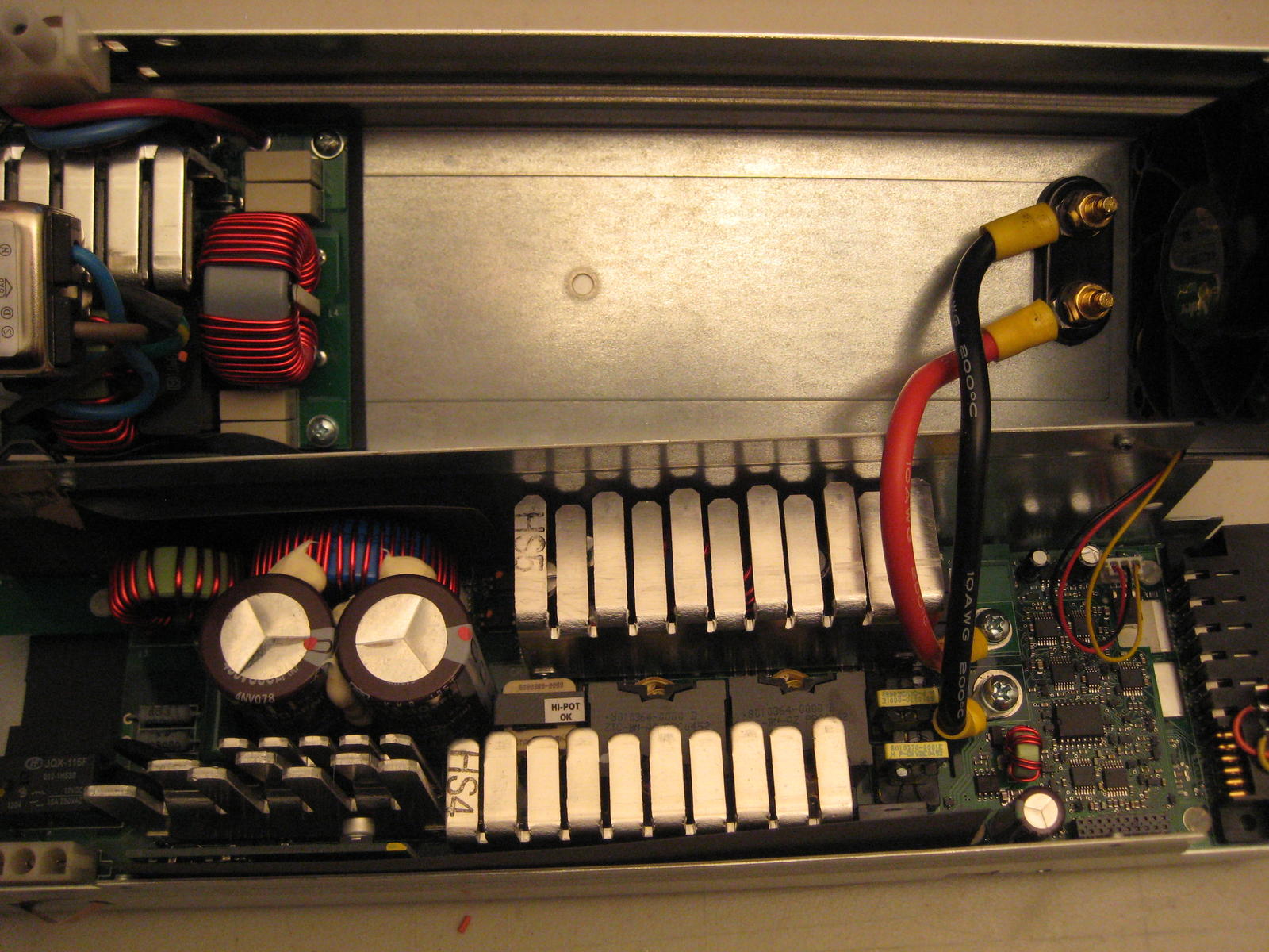

    I used this manual to mod it
    and I took volatge form two pins inside like on this picture:
    Tommorow I'll try to use my car battery and we'll see.

    Did you enable the 12v line by placing a resistor across the sense lines? If you did then the supply is going into overload protection, if not then you need to add the resistor.

    Thx Alexey, You right. I forget to add the resistor. I enabled 12V with short connection, but no resistor and voltage is maybe to high (12,8V). I disconnected it and my voltage went 11,7V. With this voltage motor connected directly to the PSU sometimes starts, but not always. I read that I need 470 ohm resistor there. Do You think this is the problem with my PSU, or I have to look somewhere else? I think 12V motor should have some tolerance and should work with the range 11,5V-12,5V.
