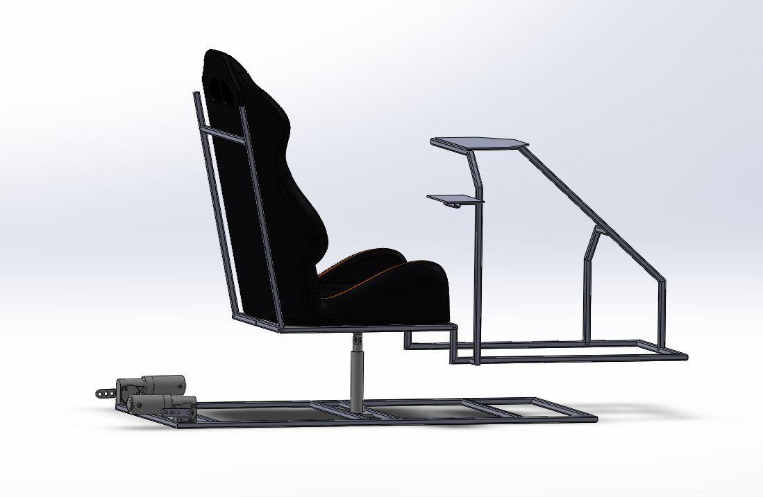

    Alright, well I pulled the trigger and bought the 25:1 motors as well as the driver boards and power supply. They should all be arriving sometime within the next month.
    There should be a lull in my schoolwork fairly soon, and I'd like to try and get some work done on the frame if possible.
    It's going to be constructed from square steel tubing, and MIG welded together (that's what I have access to at my school's machine shop).
    I'm planning on using two sizes of steel, a thicker one for structurally integral parts, and a thinner one for supports and the wheel mount.
    As I'm not the most experienced metalworker, would I be able to get some recommendations from you guys as to what thicknesses of steel I should be looking at? Obviously I don't want the rig to be wobbling once it's constructed, but thinner steel will be lighter and cheaper.

    2mm wall thickness steel for the frame, depending on your weight and planned weight of things to put on it, maybe 25mm box mild steel square.

    I weigh about 90kg, but I'd like to have people up to 100kg be able to use it with a reduced motion profile.

    I've updated my frame design to look prettier and use less metal.

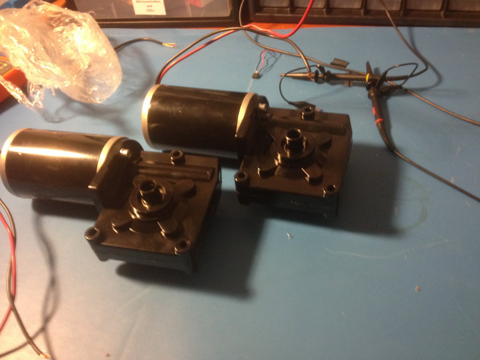

    Motors arrived today!
    How have people gone about mounting their levers to these hollow shafts in the past?
    I was thinking about putting a large bolt through the hollow shaft, and then drilling a hole in the bolt to line up with the hole in the shaft, then either putting a tight pin in there or tapping some threads and putting a screw in there.
    As for the CTC itself, how do you guys keep that on the shaft without it torquing itself loose? My plan would be to either weld a nut straight onto the lever and just tighten the hell out of it, or weld the CTC to the head of the bolt.

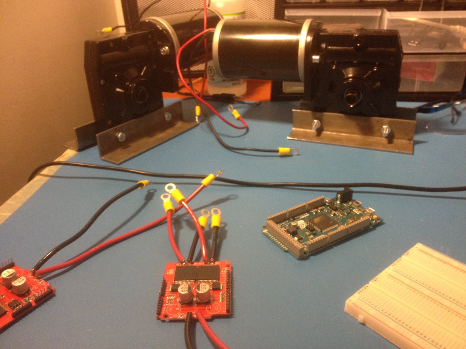

    Alright, some progress today. I cut and drilled some rough mounts for the motors. My H bridge drivers also arrived, so I've wired them up along with the power supply.
    I also tried getting a shaft attached to the motors. I'm using a 1/2in cap screw, which fits, but it's a very tight fit. I need a wrench to move it more than halfway in, and eventually it just starts to backdrive the motor.
    My seat is also in the mail, and I'm going to a few scrapyards this weekend to look for a good U joint.
    Also, what in you guys' opinion would be the best way to mount the joint to the seat frame? I was just going to bolt it on, maybe weld plates to either end of it if there aren't bolt holes to begin with (something like the pictures that were posted earlier in the thread). Also being able to slightly adjust the mount point after the fact would be a bonus (not by a whole lot, maybe 2-3 inches).

    My seat had a metal frame hence I attached a 6mm aluminum base plate to it and bolted the uni joint direct to that.
    You may find the shaft is 12mm not 1/2in. I have had both sizes come from the same supplier packaged in one order, so do check.

    When I was trying both sizes out I couldn't readily tell. Either it's a rather sloppy fit of M12 or a really tight fit of 1/2in.
    I may just file the bolts a bit on the lathe. Tighter is probably better than looser I'd imagine.

    For mounting uni joint to seat frame. Basically what I have done with all my builds. Under the seat frame of 25mm box steel is a sheet of 16mm MDF screwd to it. Uni joint bolts to that at the right balance point. For me its supported 115kg driver no problem.
