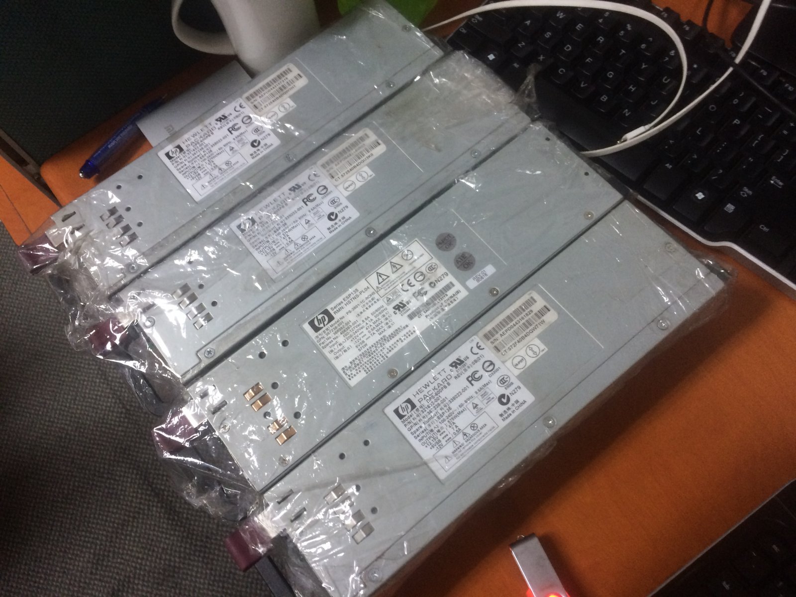

    by the way, what is minimum wattage and voltage for 3dof psu?

    @noorbeast, how much do i need? one for each motor or two/one for all rig?

    @DonCorleonez You can use one PSU with 1 mostermoto running 2 motors ,,, or 2 PSU's for 2 monstermoto's running 2 motors ,,,,,,or 2 PSU's with 4 monstermoto's running 2 motors,,,.
    21,632
    151,449Coins
    +11,038 / 56 / -2
    One per motor is recommended and they are cheap enough. Even though you can get quite powerful server PSUs they can be a bit sensitive and our sims tend to have significant power spikes, so best to have one per motor.

    thanks, will looking 3 server psu..

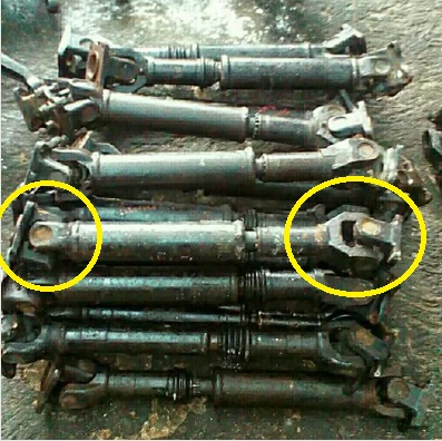

    meanwhile, what is recommended pivot for under seat?i mean which parts of car can be used(with photo better, sometimes it have different meaning). And is there any specific type of vehicle?truck, sedan, mpv?
  15. noorbeast
    21,632
    151,449Coins
    +11,038 / 56 / -2
    Use a universal joint from a car tailshaft and mount it as close to the base of the seat as possible: https://www.xsimulator.net/community/faq/universal-joint-placement.108/

  18. DonCorleonez
    DonCorleonez Member
    Mar 14, 2009
    80
    195Coins
    +15 / 0 / -0
    @noorbeast, i mean is the thickness is it 2.00 mm enough?or little bit overkill?
    for pivot?is it what i circled in photo can be used?both end? (dont mind for filename:D)
  19. Nick Moxley
    17,056Coins
    +2,506 / 30 / -2
    Yes that is a U joint style that your after. Just make sure its nice and tight at the joints and your good to go.

    got 4 unit second hand psu for 60 usd
