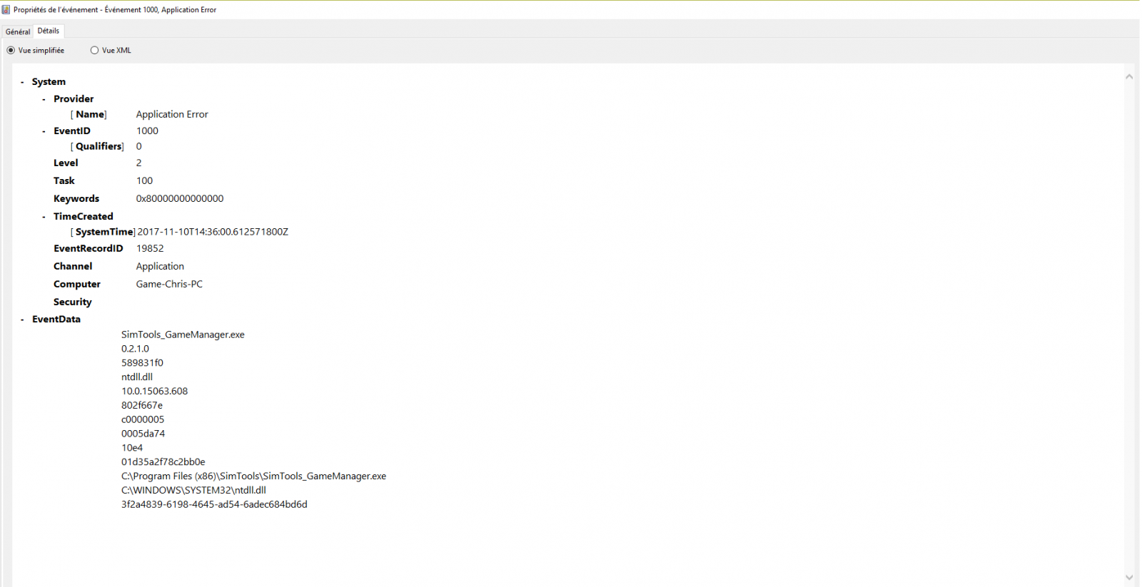

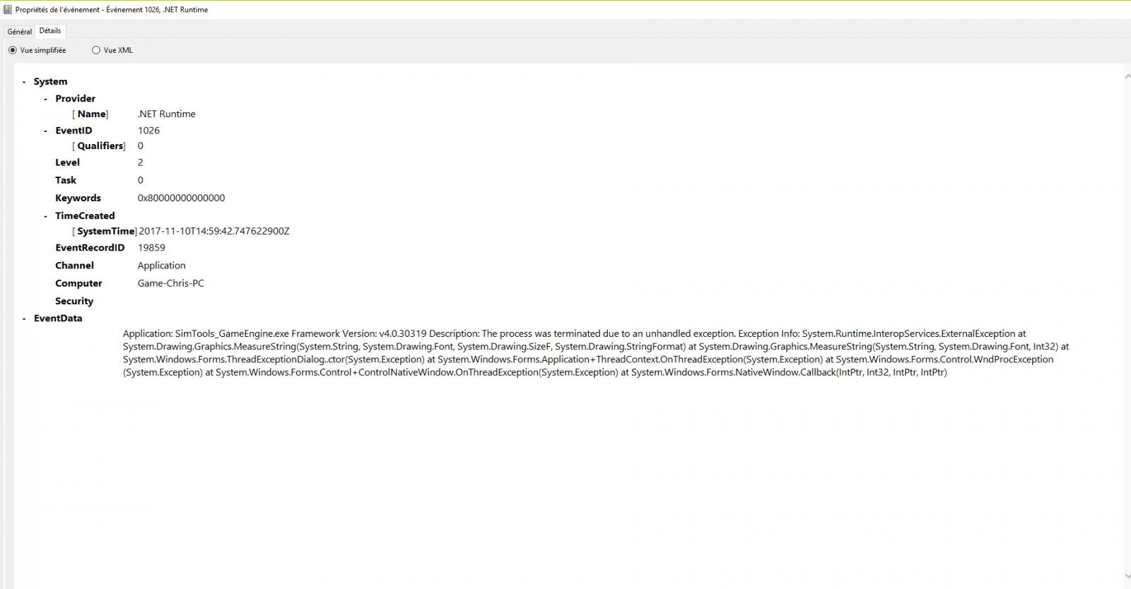

    PROBLEM
    All in Output Testing working.
    (last version of simtools, new plugin,...)
    Start playing and 2 minutes after simtools crash.
    Windows message "Game Manager has stopped working"
    Problem with all my games.
  3. Seth2Christ

  5. Seth2Christ
    Seth2Christ Member
    Apr 14, 2015
    58
    216Coins
    +14 / 0 / -0
    No, it still does not work.
    Even with only the simu plug, the game manager crash after 2 min. And then the game engine stops responding and stops working ...
    22,211
    154,729Coins
    +11,213 / 57 / -2
    Is there any other error message information? If so please post that.

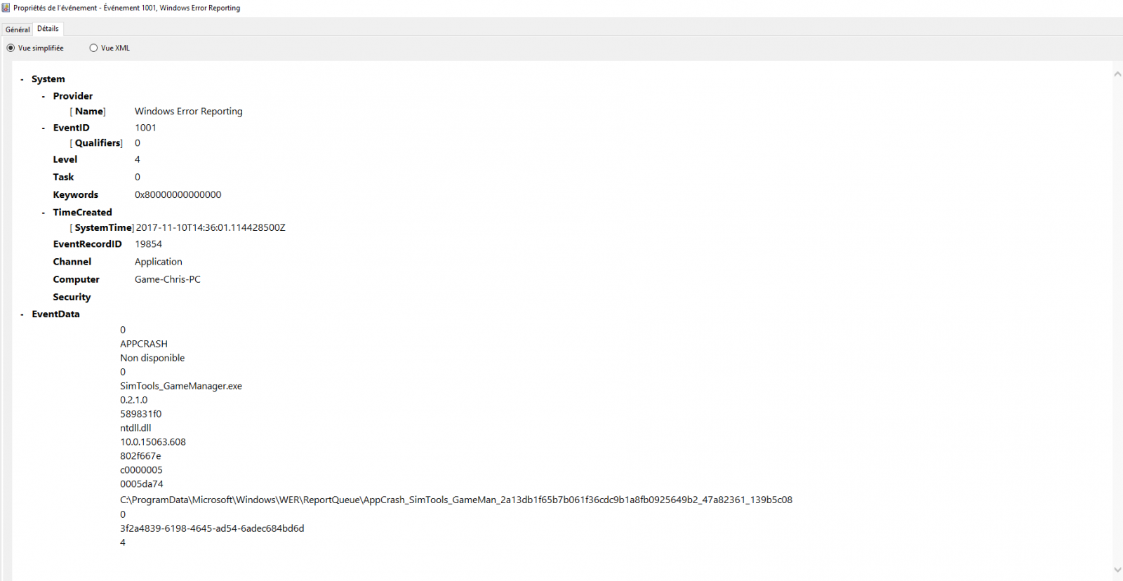

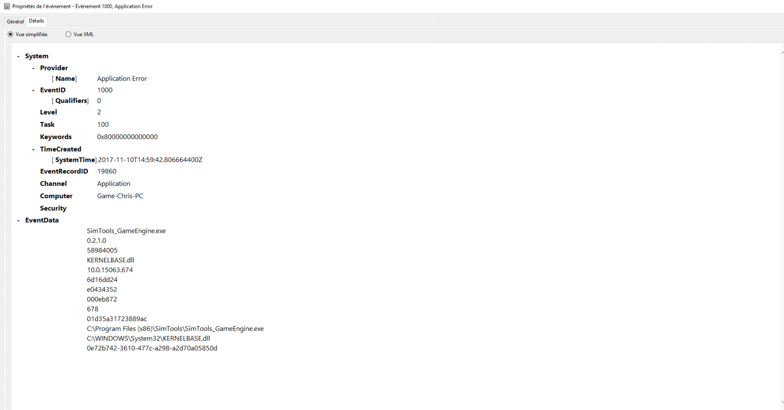

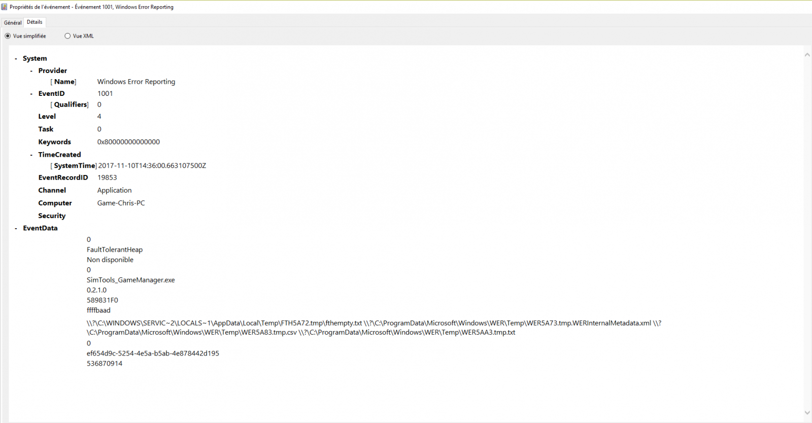

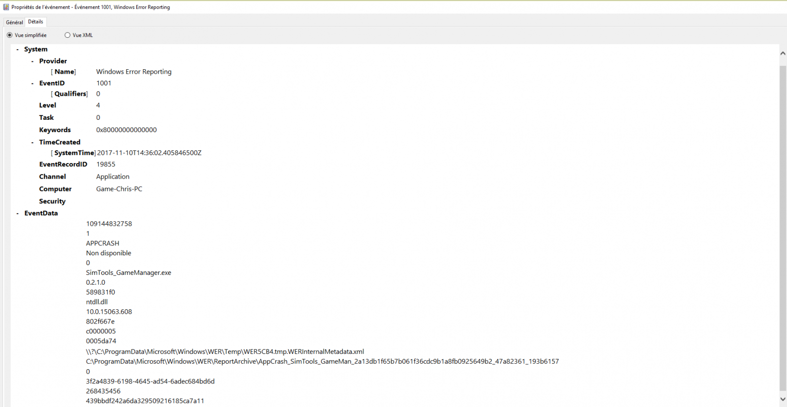

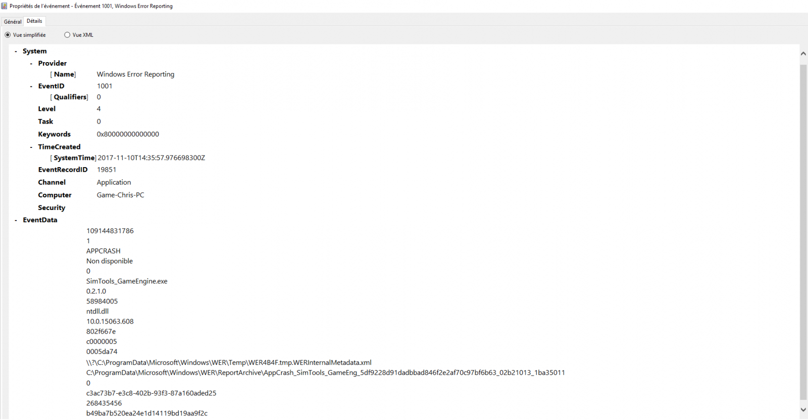

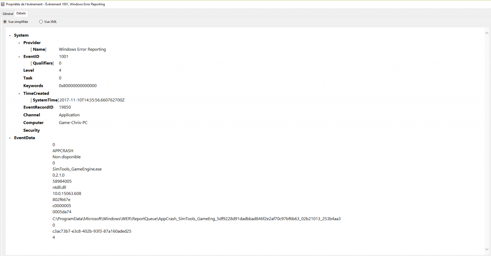

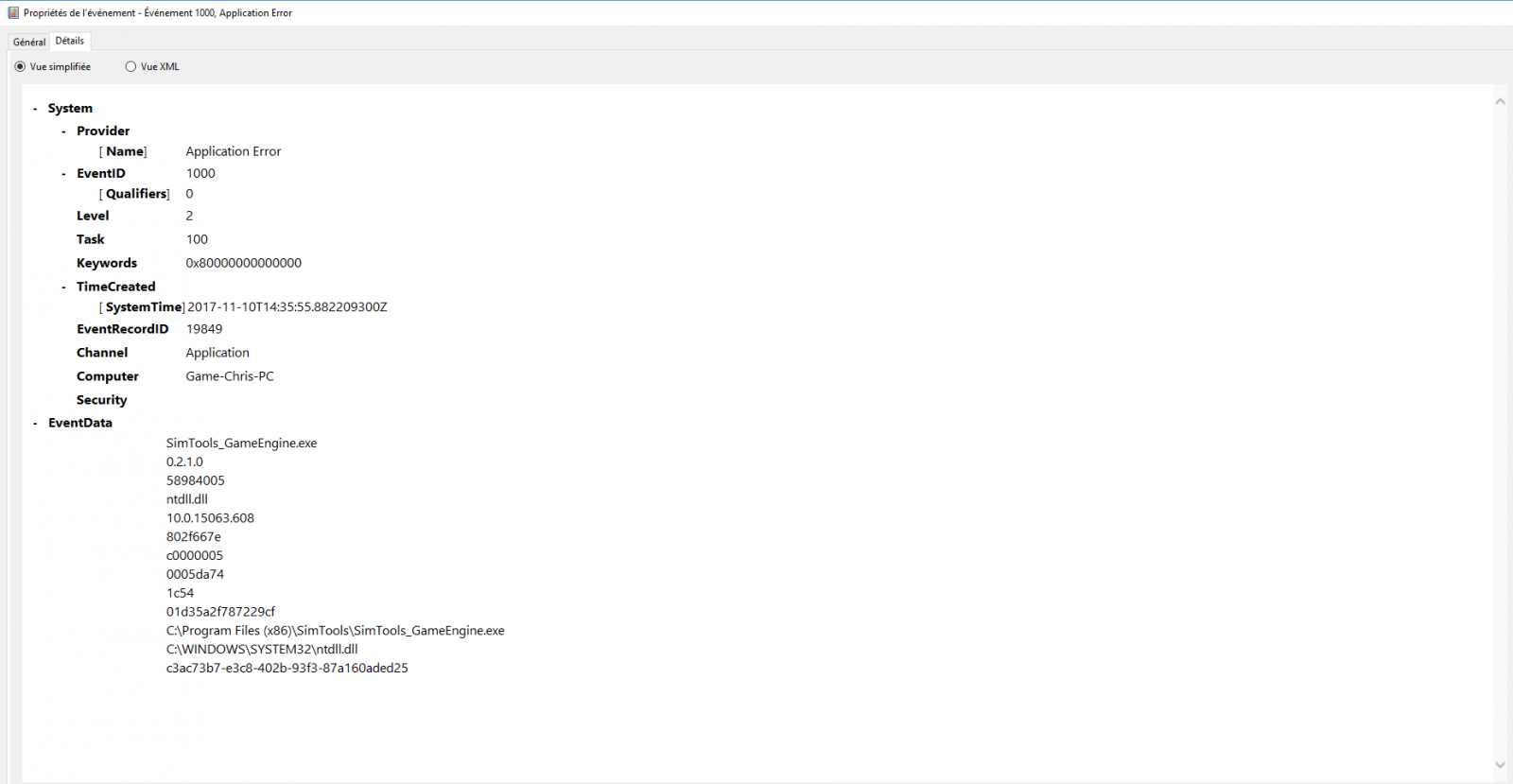

    Here are the examples of windows messages:

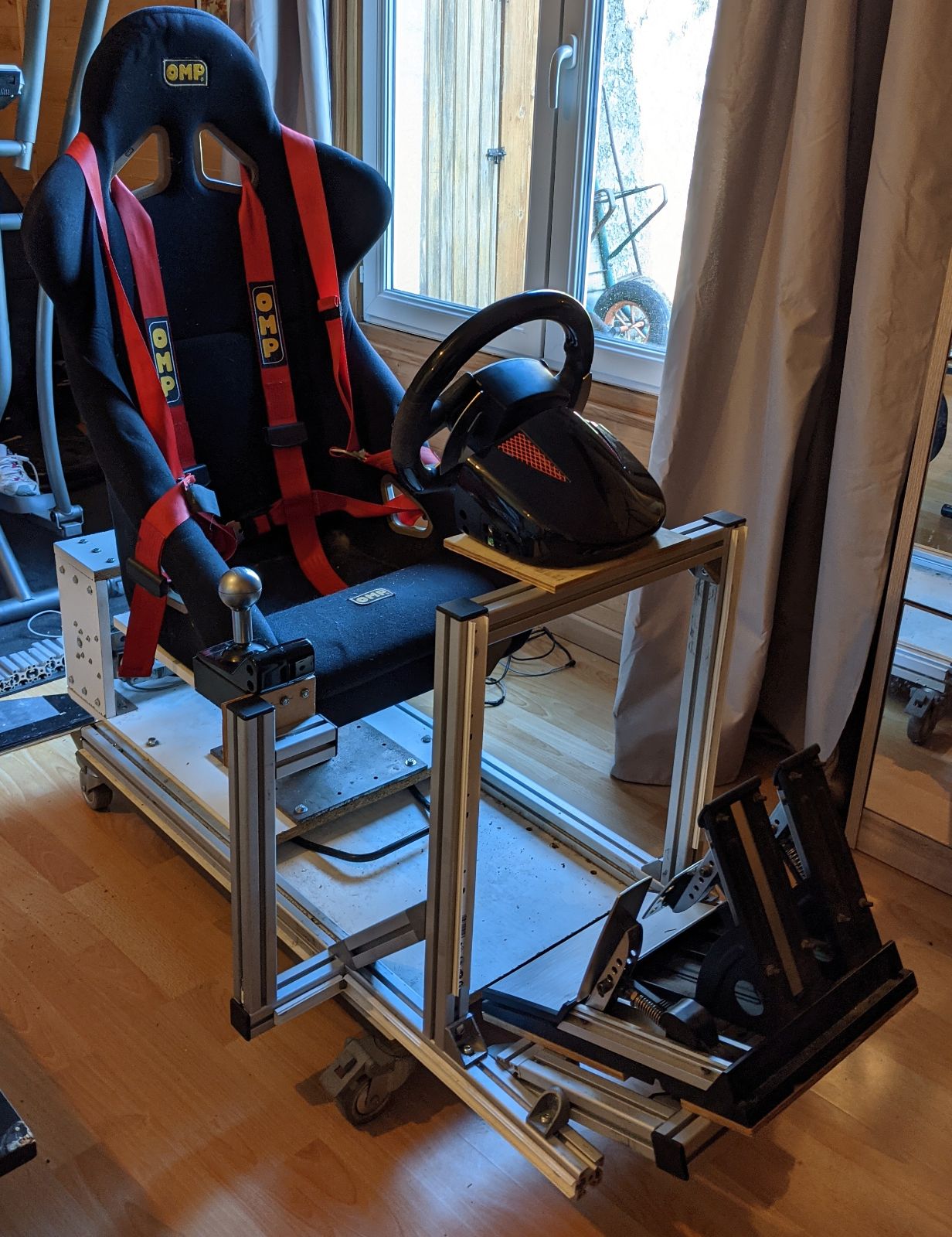

    Hello ! Life goes on and I'm starting to have time to resume some activities :rolleyes:
    I took my simutor out of the boxes to reassemble it!
    I simplified it a bit, I just hope it will work again :)

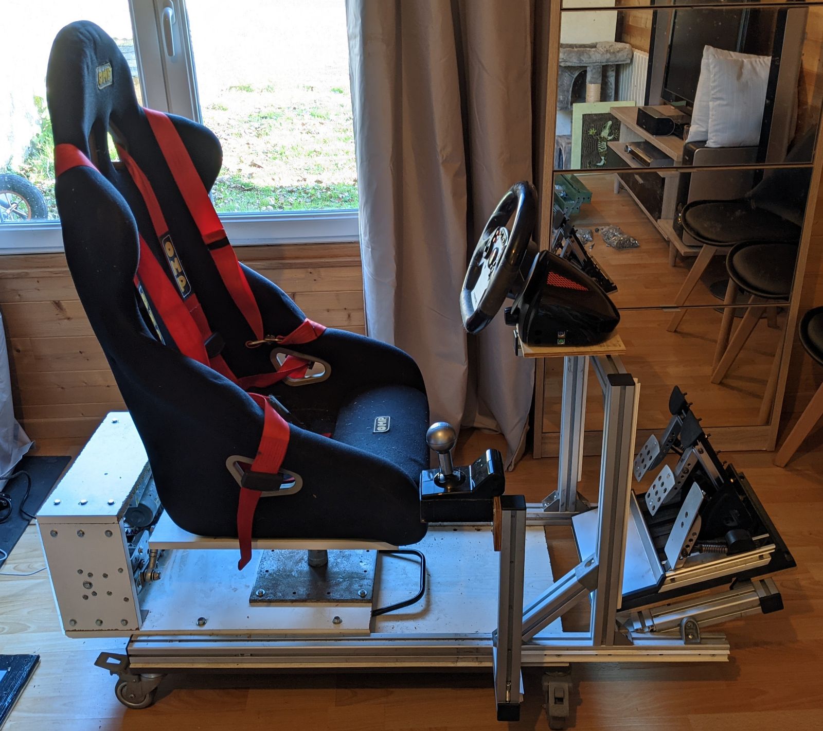

    Hi!
    What is the Simukit kit you use? 2dof 120W?

    It's a 2 DOF but not exactly a simukit as currently sold. in 2014/2015, when I built my simulator, I used wiper motors (Smolka 24V), arduino UNO and sabertooth 2x25. The rest is quite similar to the SimuKit.

    I had an "platform move" version at the beginning, then I switched to a "seatmover" version.
    My specifications have always been the practicality of storing / moving the structure, therefore quite compact. Here the goal was to have the steering wheel support, the pedal support and the gear lever support, on two main aluminum profiles, so that they can be adjusted independently.
    The other point is to maintain the center of gravity of the seat under the "gimbal" but to be able to adjust the seat as in a car. So I placed the entire seatmover on a car seat rails.
    The whole structure is on wheels.
