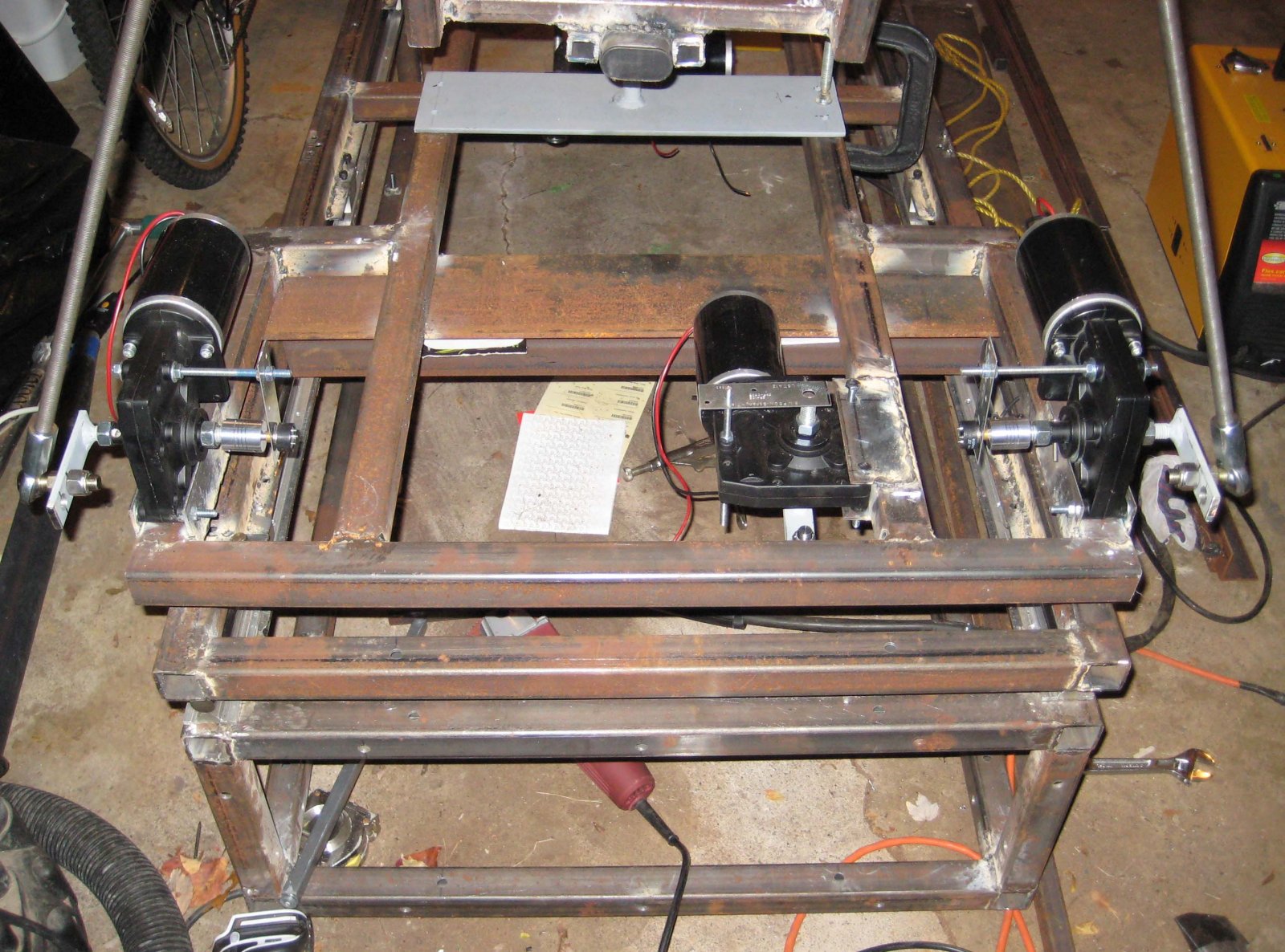

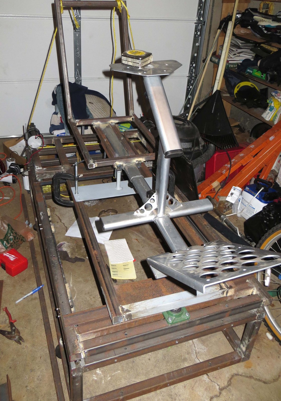

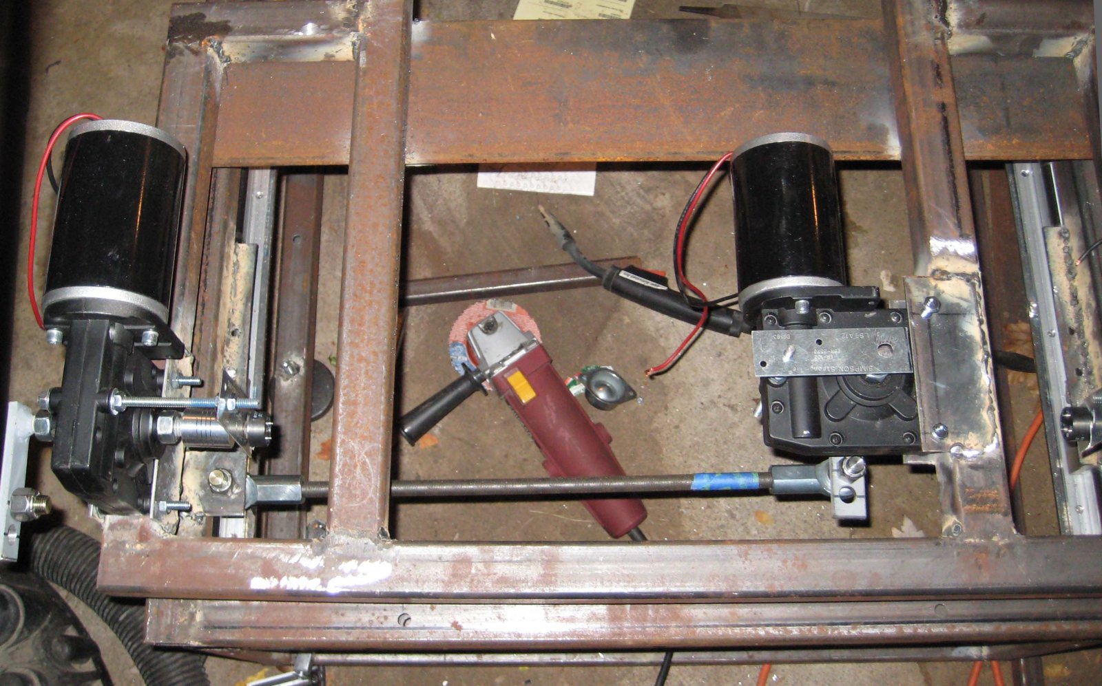

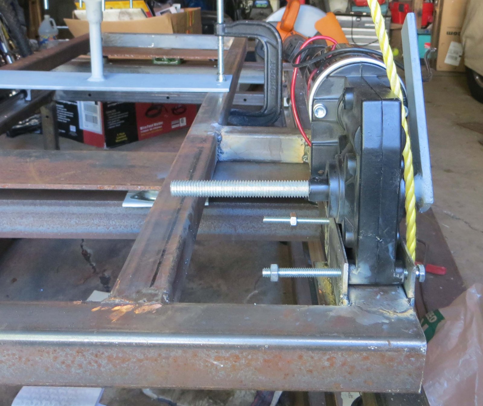

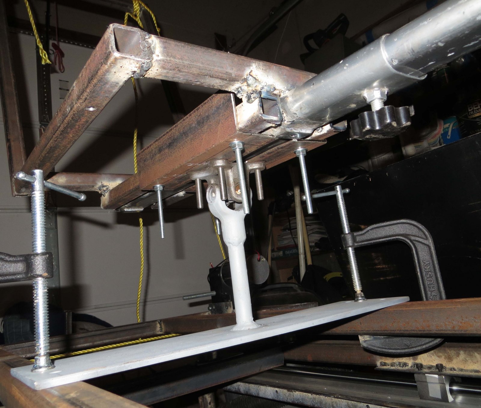

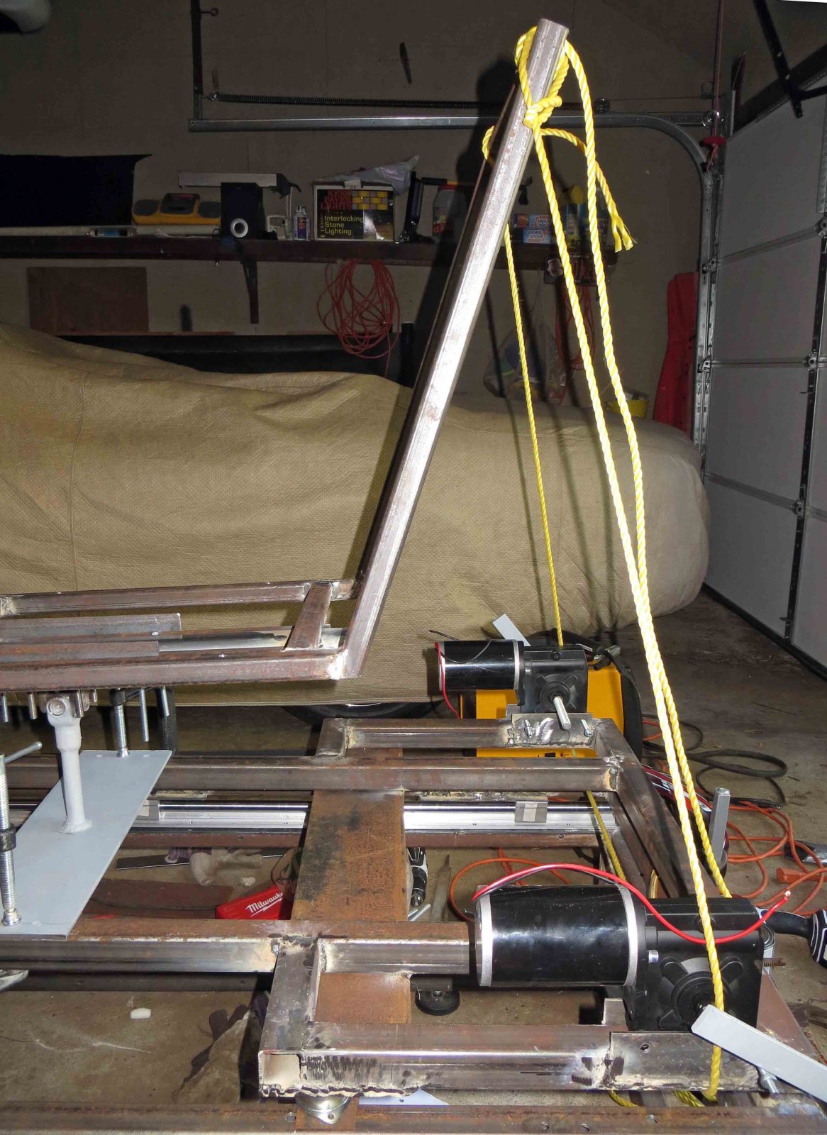

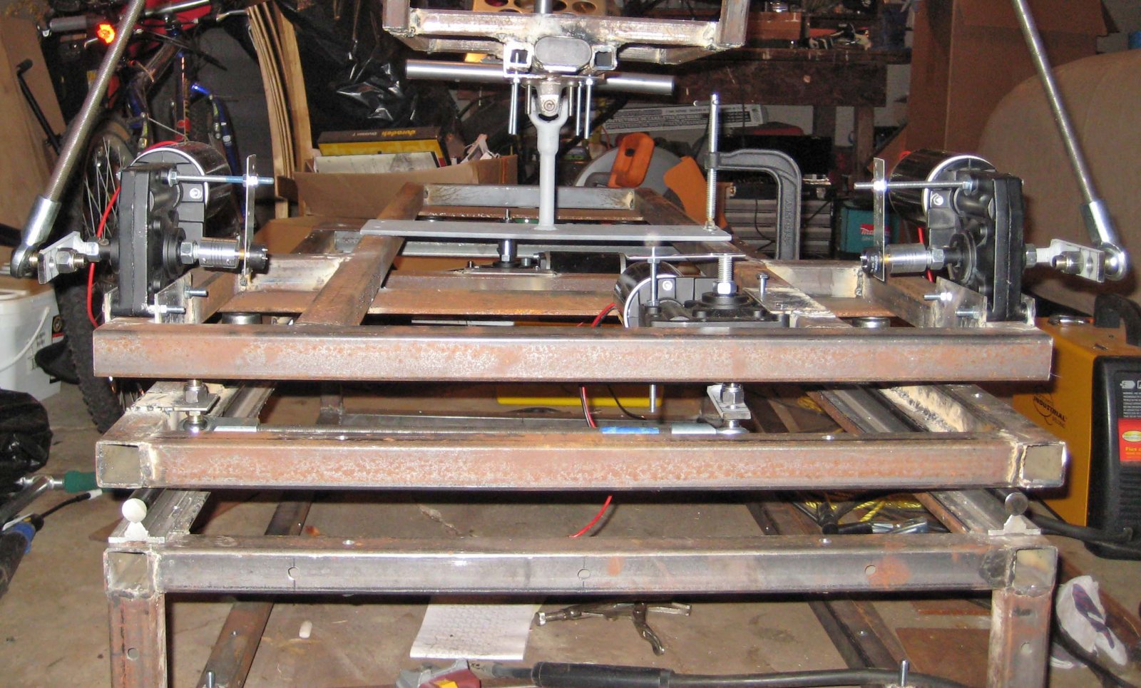

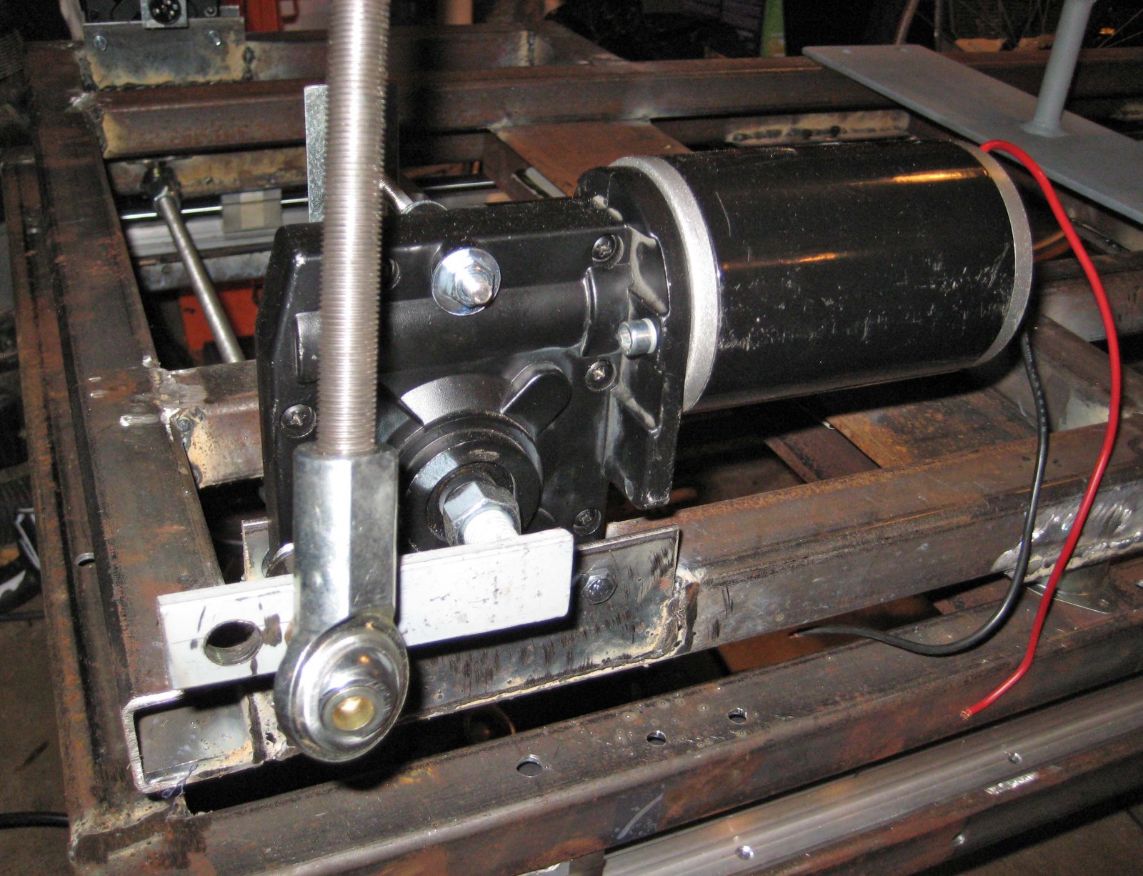

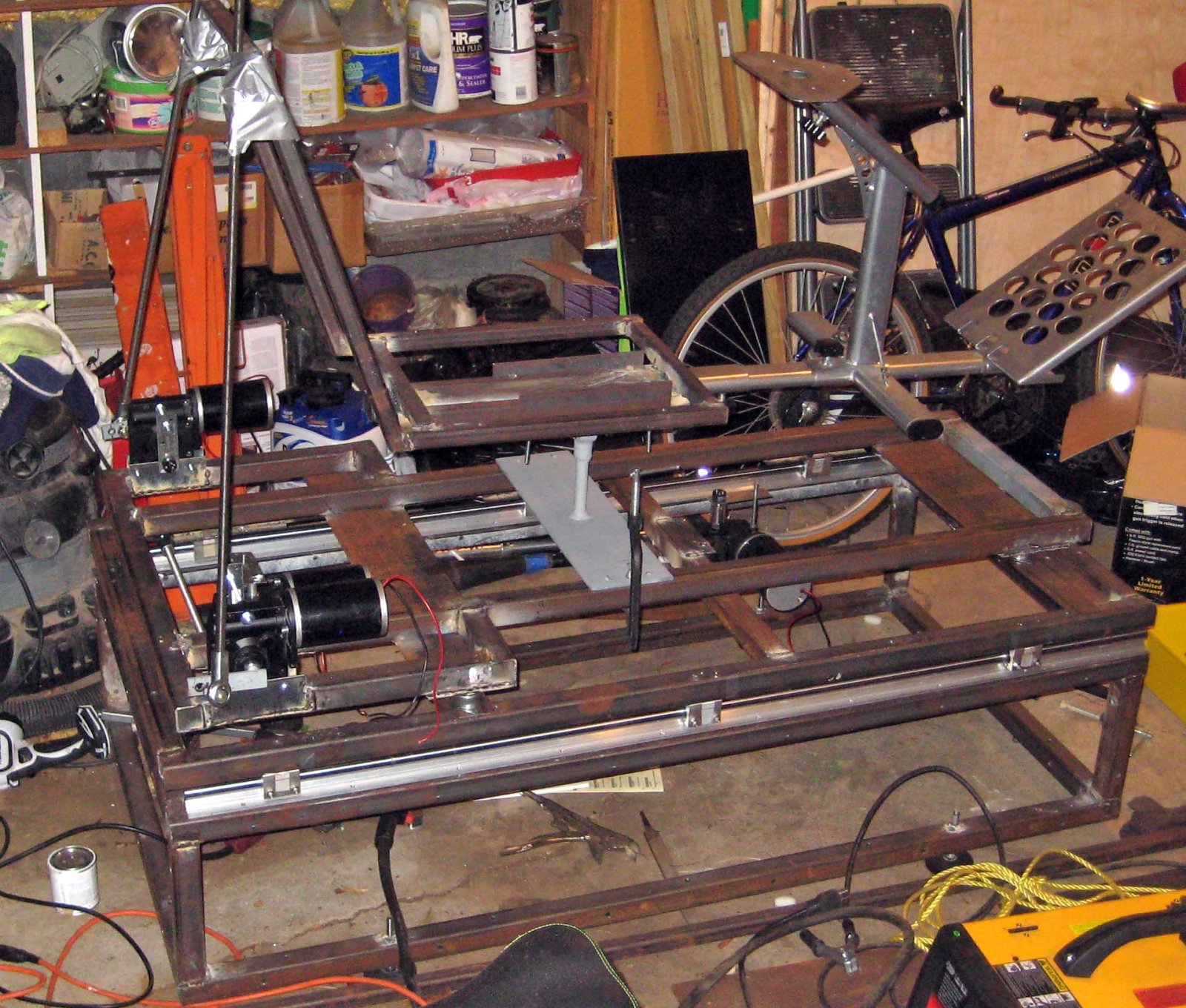

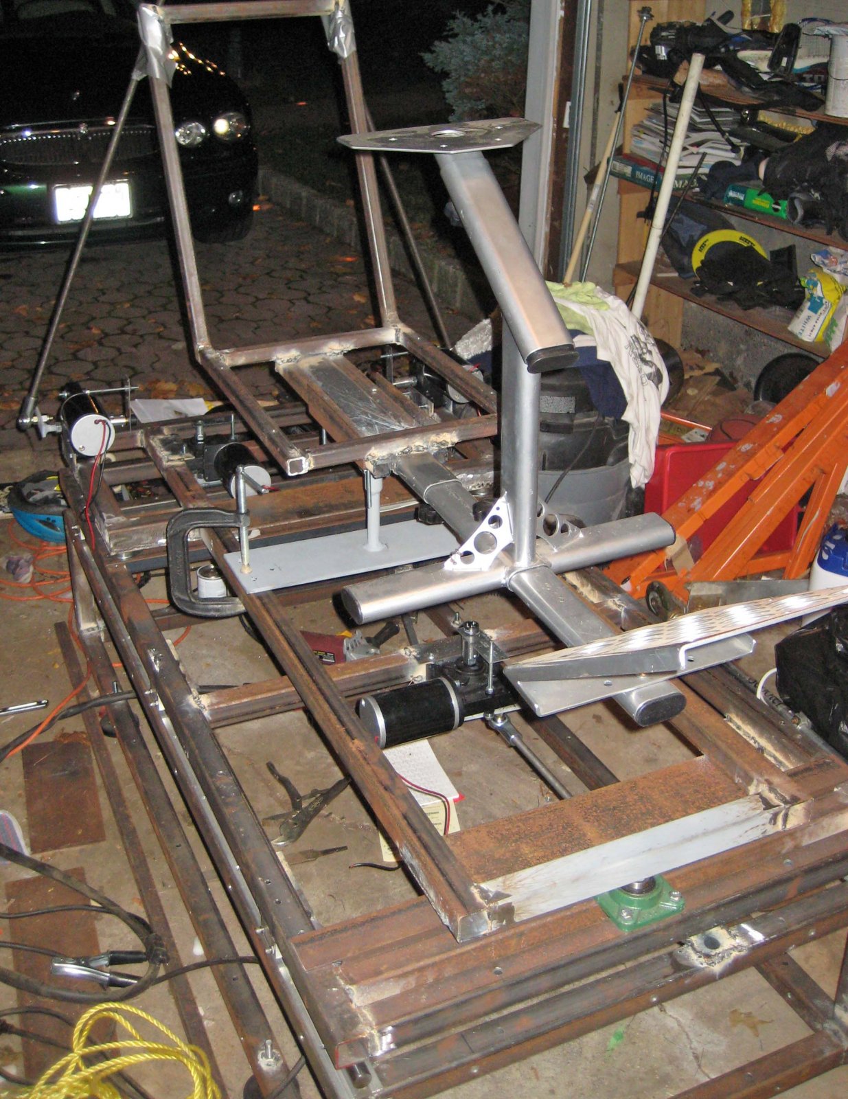

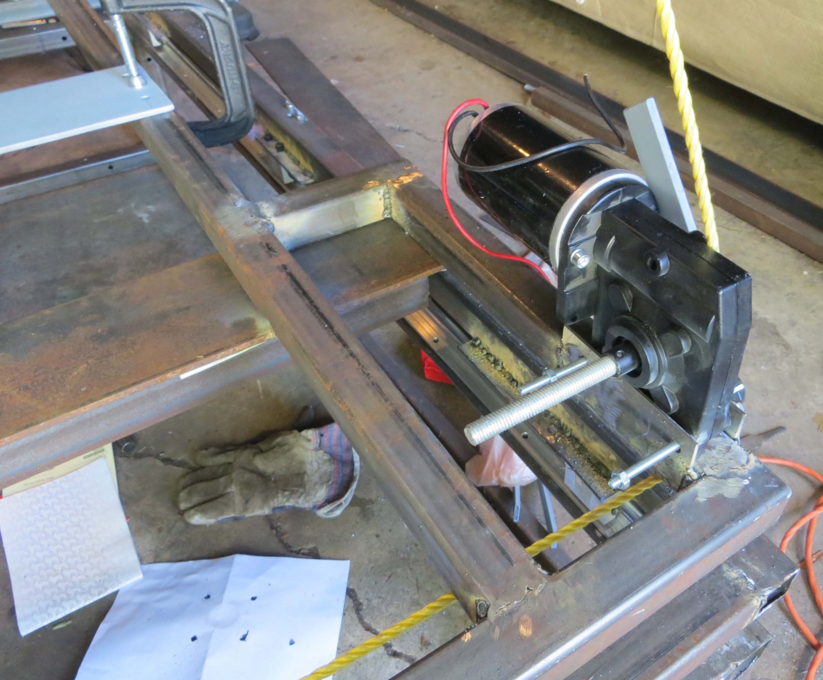

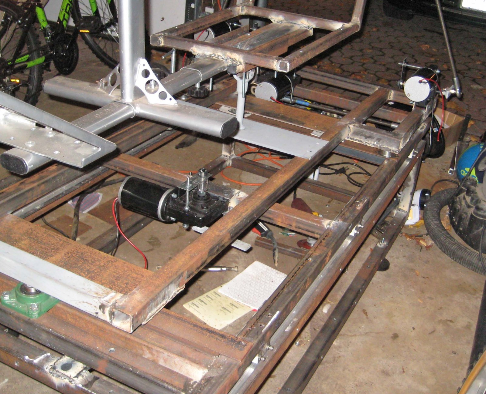

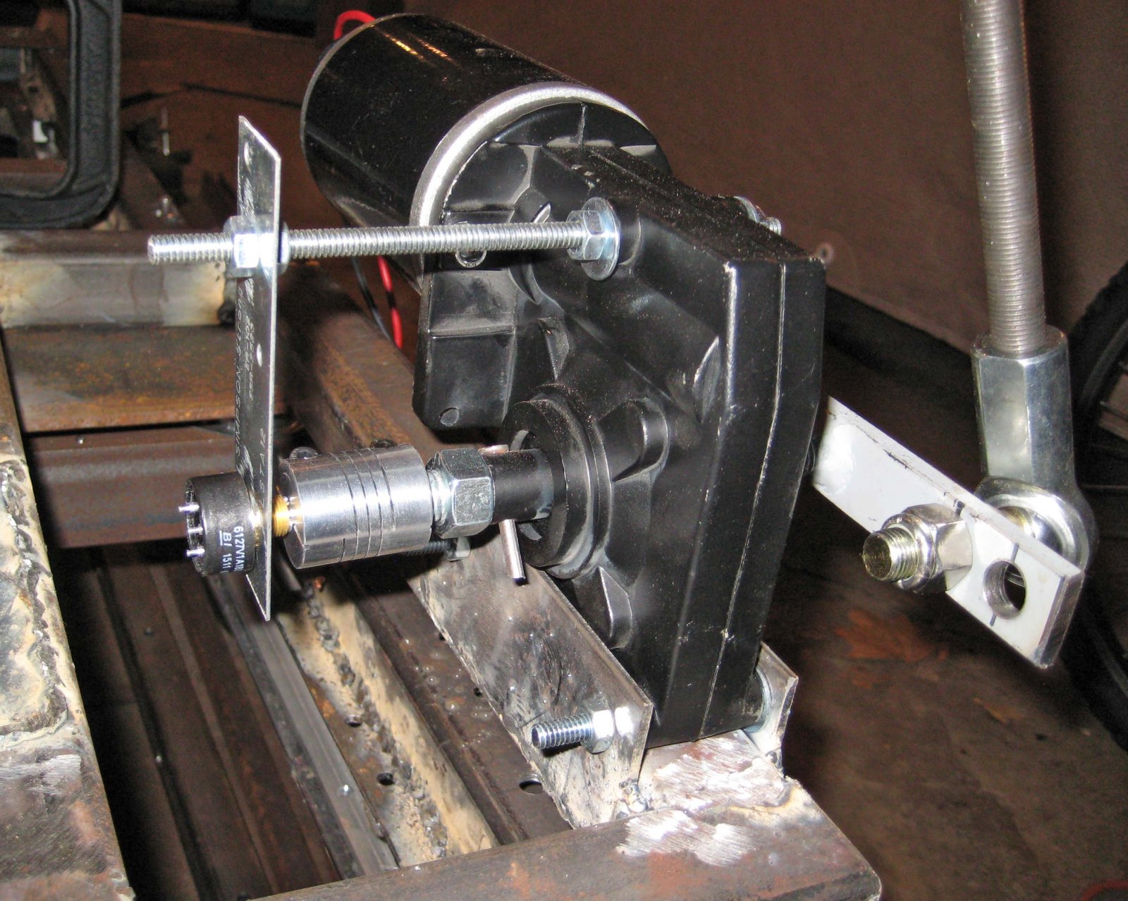

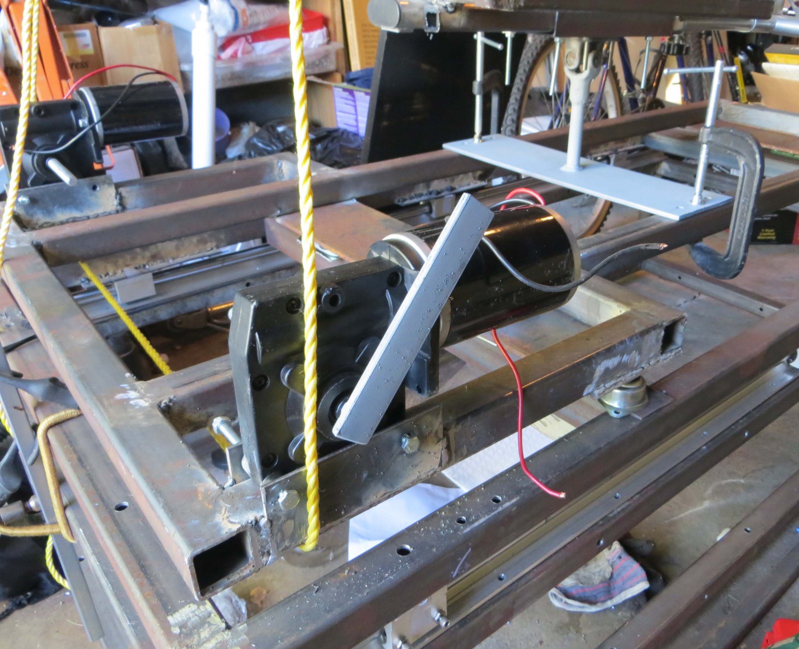

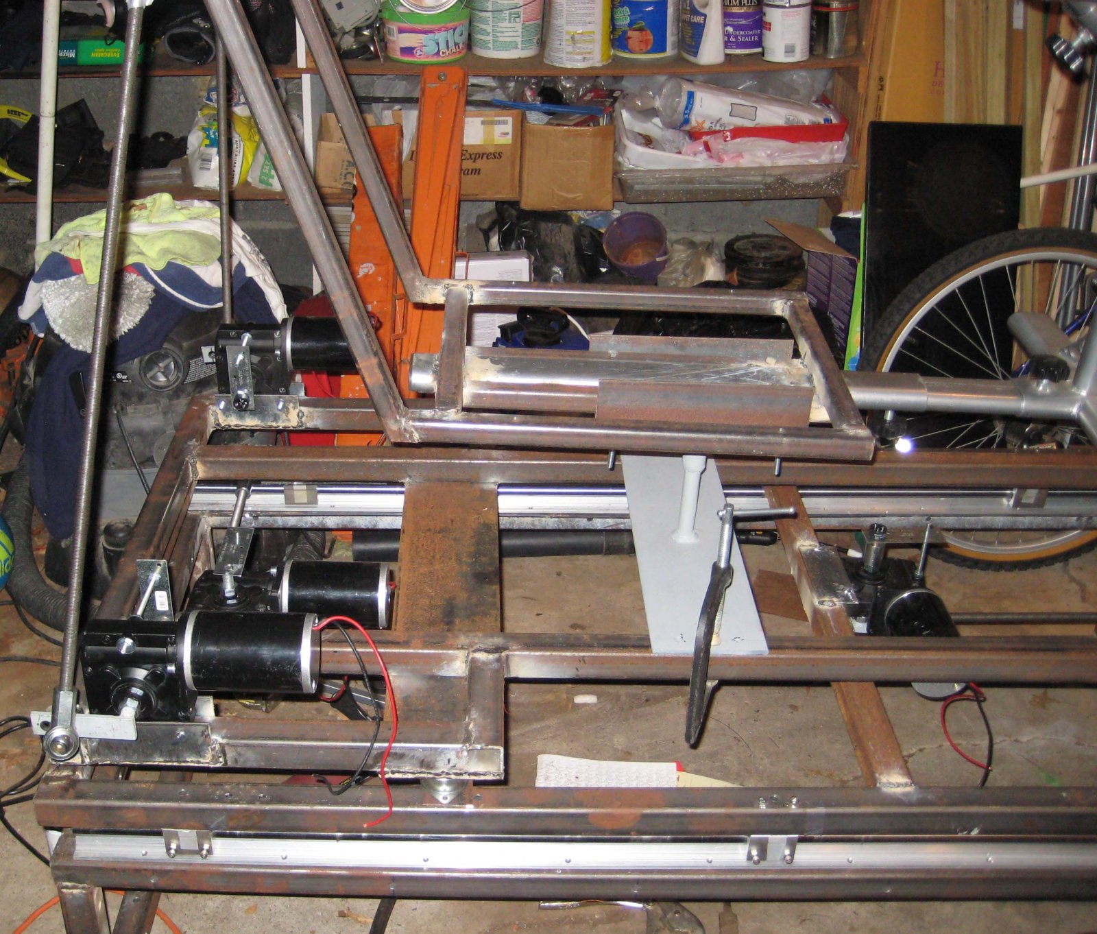

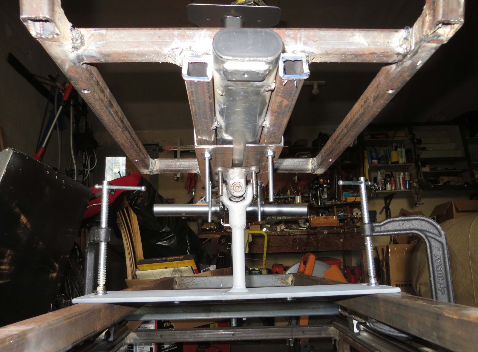

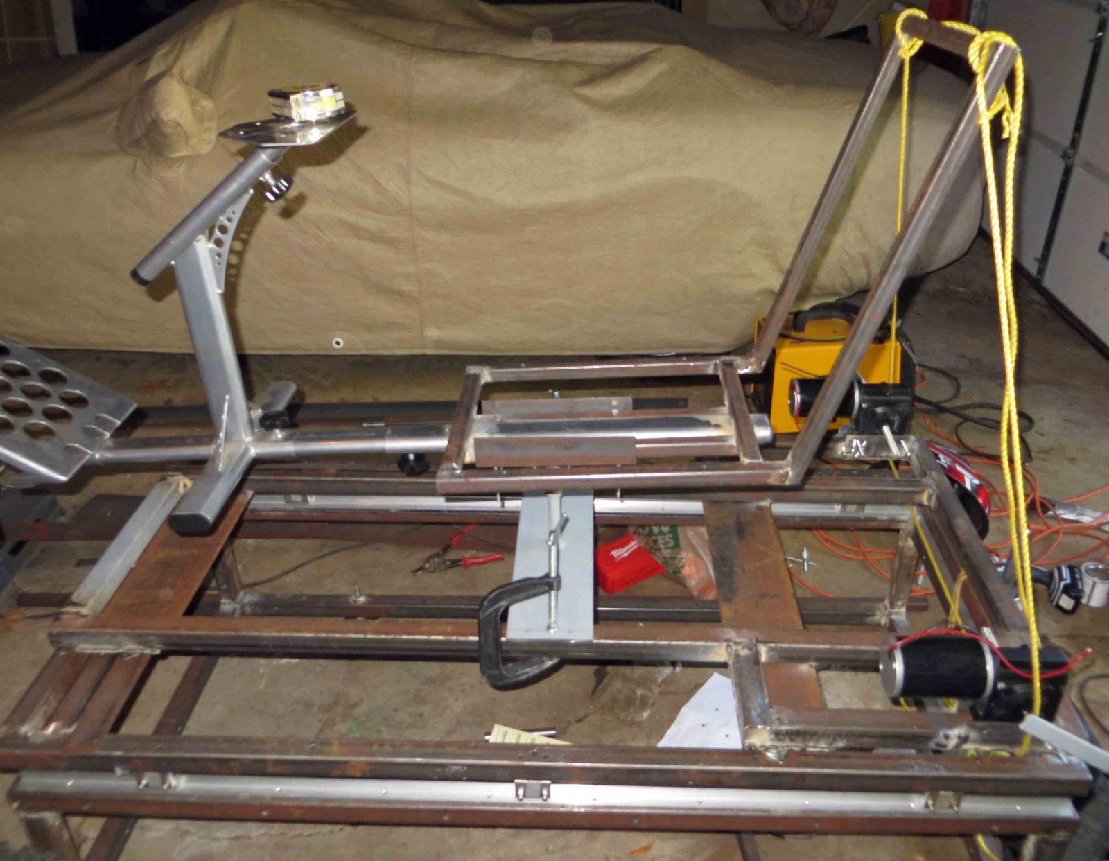

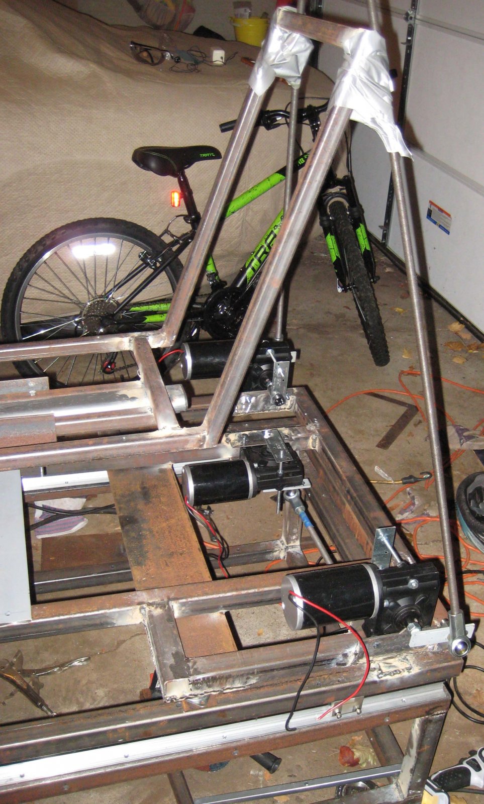

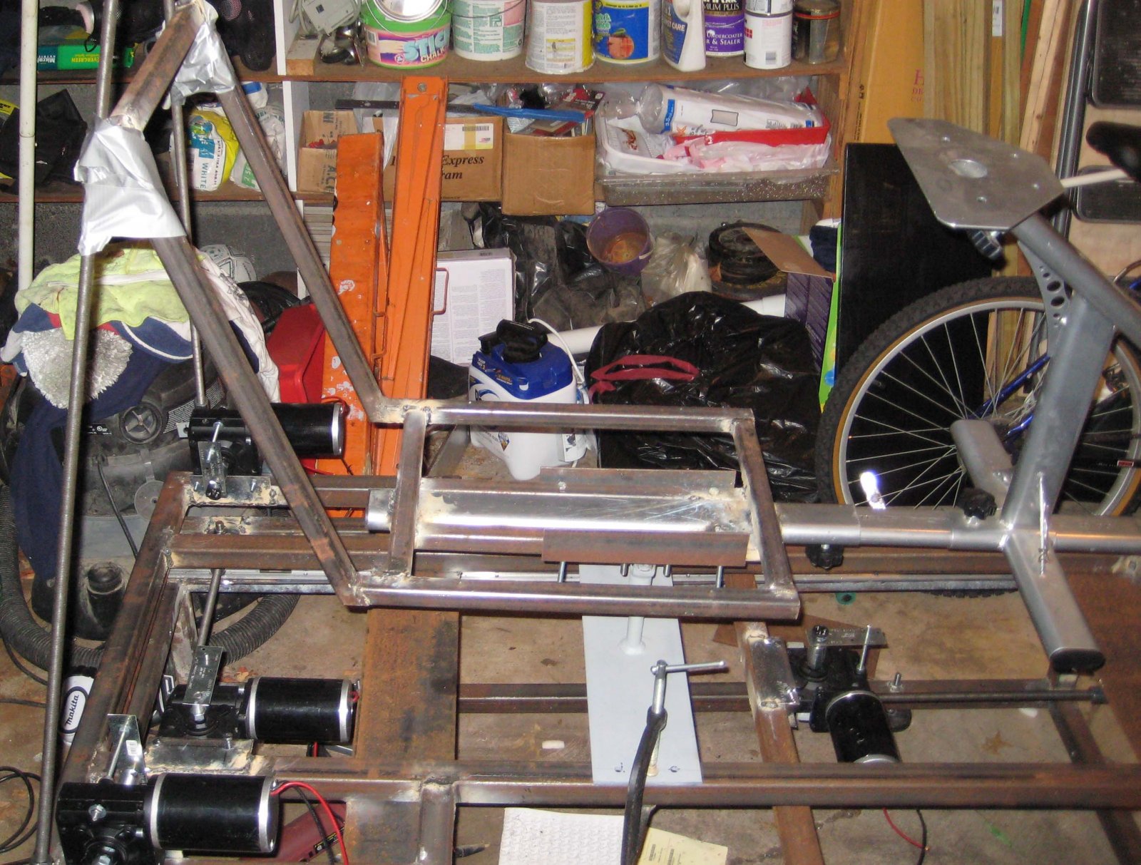

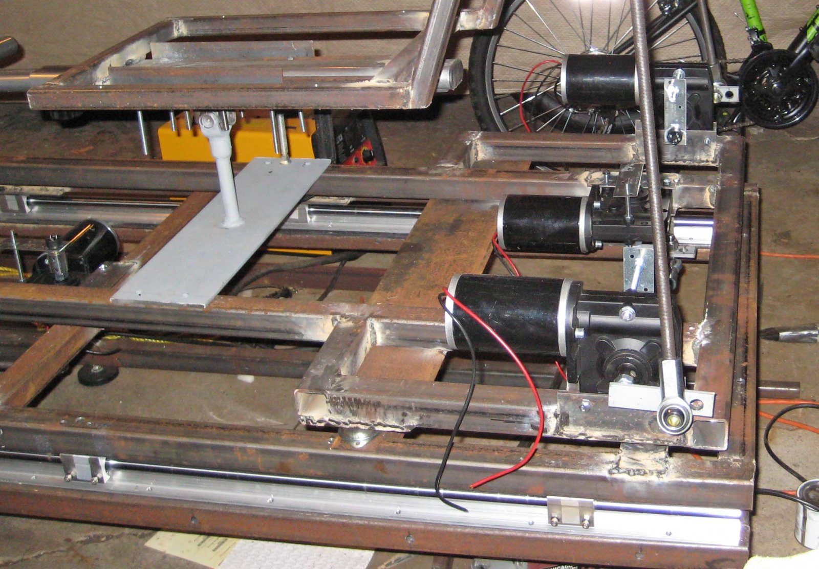

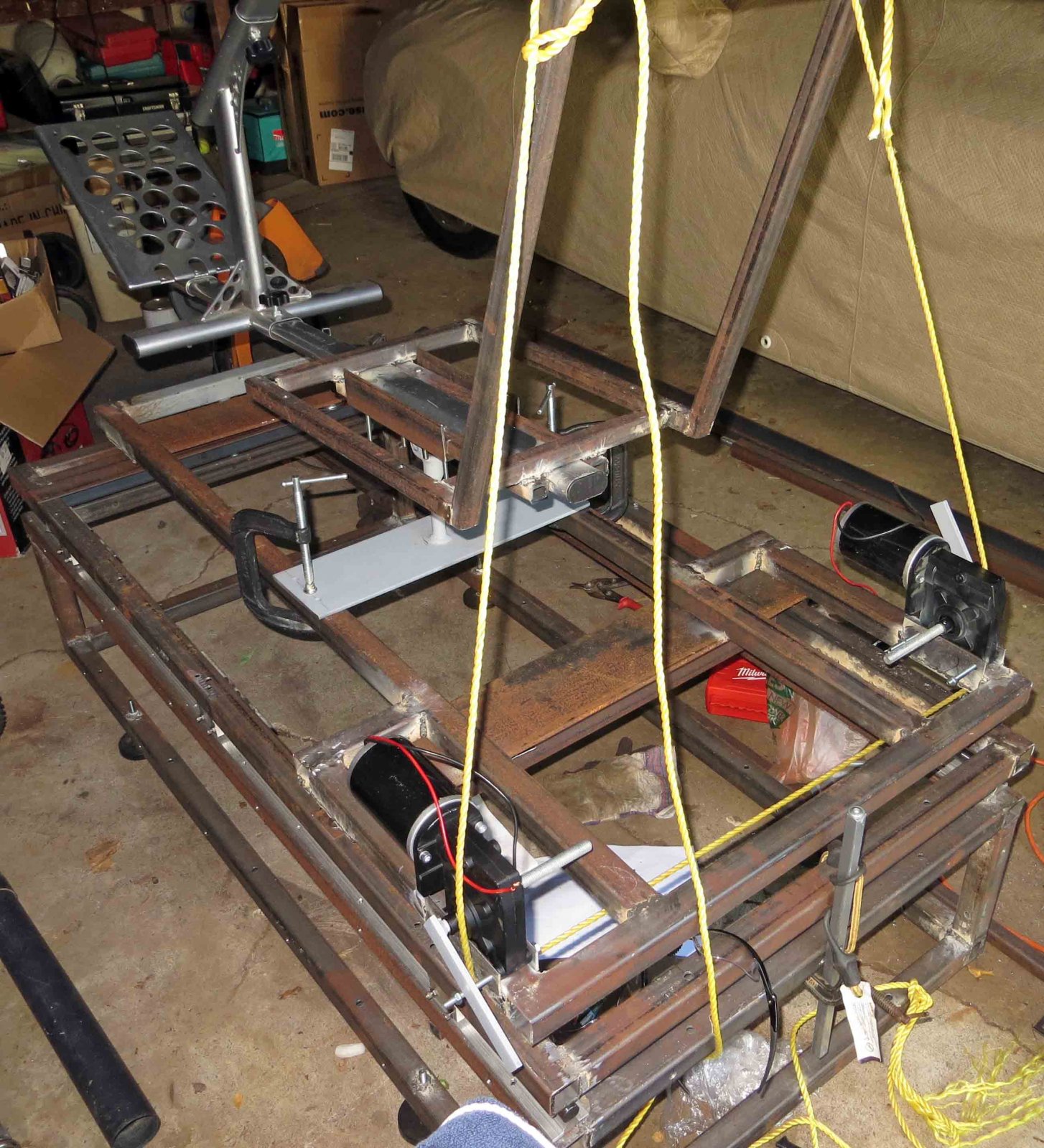

    still have some welding and drilling to do, but for the most parts the frame is complete. should be able to move it into the house so I could continue to work on it throughout the winter. the only one thing I am not really happy about is that there is some plays in the levers, tried using different pins sizes, etc. with no avail. will see if this becomes an issue later on
    IMG_4933.jpg IMG_4934.jpg IMG_4935.jpg IMG_4936.jpg IMG_4938.jpg IMG_4940.jpg IMG_4941.jpg IMG_4942.jpg IMG_4943.jpg IMG_4944.jpg IMG_4947.jpg IMG_4950.jpg
  18. noorbeast
    21,711
    151,973Coins
    +11,061 / 56 / -2
    Great progress :thumbs
    A little play is normal for worm gearboxes, they need some clearance for lubrication.
    The greater the CTC on the lever the more noticeable the impact of the gearbox play.
    A very slight bias in the balance of the rig, so the levers have a small load at rest, makes the play a little less noticeable.

    Thanks @noorbeast, the play is actually mostly not due to the gearboxes but at the point of attachment. Not sure how to explain it but because the hole in the lever is not 100% matching the whole in the shaft. worst case would have to redo it.
  20. bsft
    Thats weird, I have 10mm hole drilled through it with 10mm threaded rod and it doesnt wiggle any so what, probably because I tighten the @#$%K out of it.
