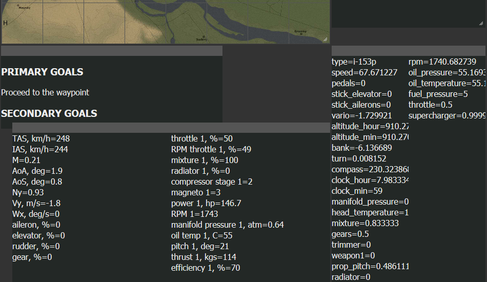

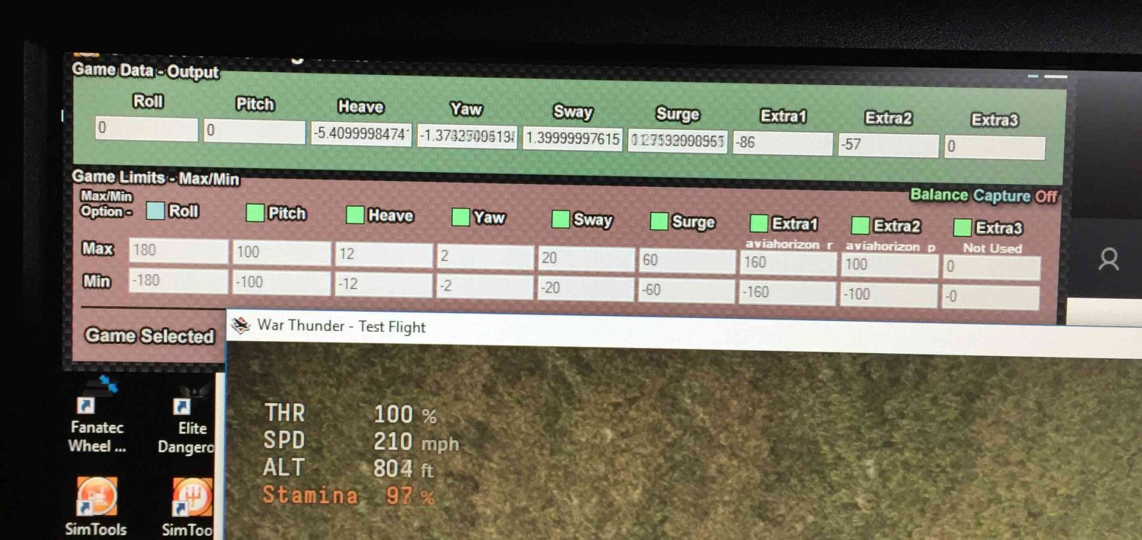

    It is very odd to have the majority of values but not all show in the Tuning Center, perhaps the plugin dev @Ville Pesonen could make some further suggestions as to causes.
    The plugin uses the WT battle map to derive values and you can actually check values are being produced by opening the following address in your browser while WT is running: http://127.0.0.1:8111/
    Something like a firewall could be interfering with data flow, so try temporarily shutting whatever one you use down.
    I have flight and race controllers all hooked up at the same time and also regularly disconnect and reconnect them. Sometimes with the latter I do have to reset axis/button assignments in AC, but it only takes a few moments to do so.

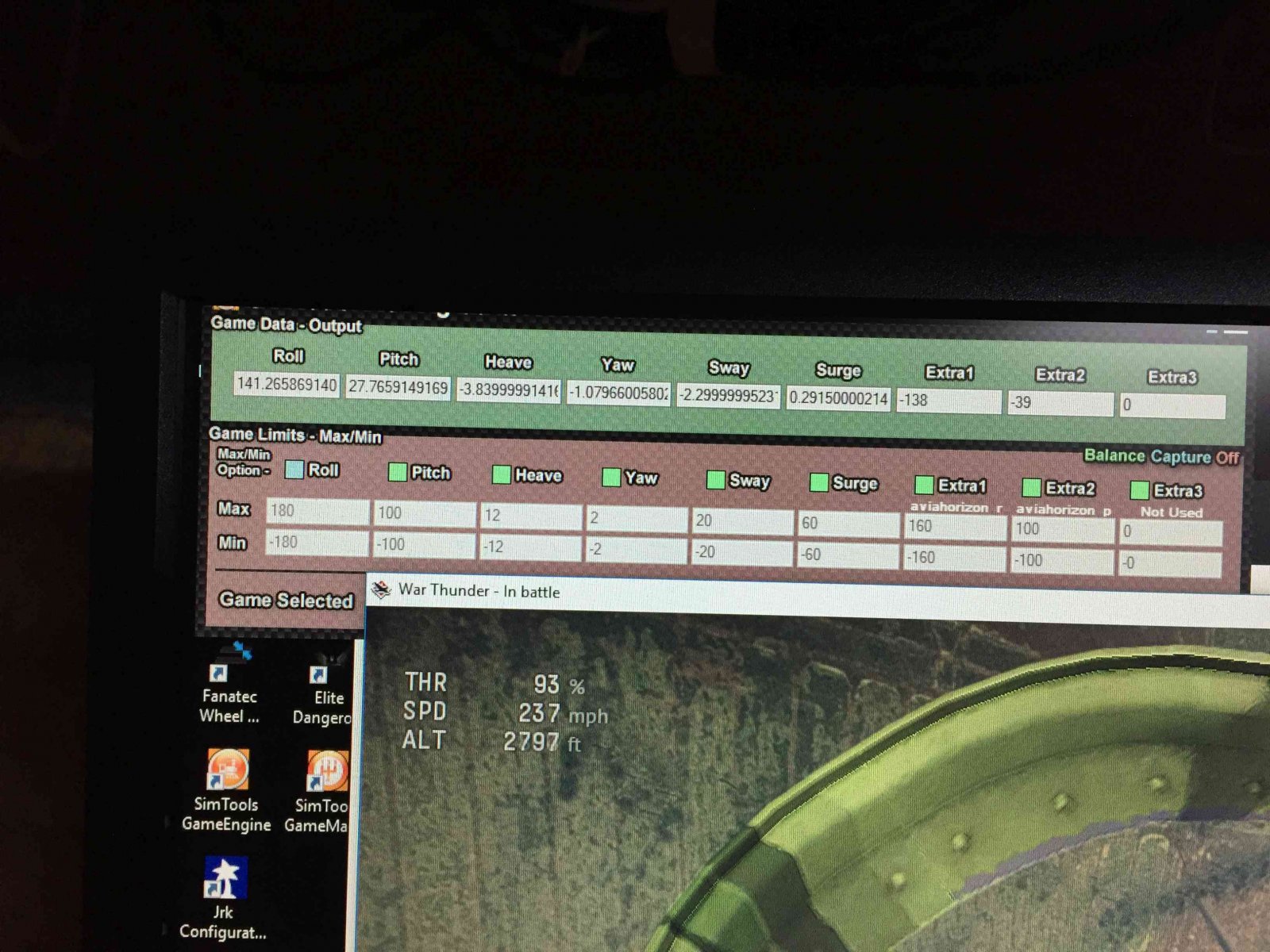

    Thank you for the reply. Shutting down Mcafee firewall didn't help. I could see pitch values changing with the browser. Any other suggestions, please.
    22,185
    154,750Coins
    +11,196 / 57 / -2
    For now I would suggest using Extra 1 and 2 in place of roll and pitch, personally I prefer them anyway combined with smoothing and/or washout filters, as I find that more realistic for VR.
    Did you check running processes to make sure Mcafee and any other potential programs that could interfere with network communication are actually shutdown?

    is there a way to run war thunder in the windowed mode? stopped getting extra 1 and extra 2 only getting heave, yaw, sway, and surge. not sure what the heck is going on.
    thx
    22,185
    154,750Coins
    +11,196 / 57 / -2
    You can set window mode on the initial launch screen.
    It sounds like something on your system is interfering. Perhaps you could temporarily uninstall McAfee to see if that is it.

    @noorbeast first and foremost thank you for your constant help. I think I figured out what happened. I was only flying a basic tutorial mission. As soon as I switched to advanced tutorial all my issues went away, I am now registering all axis in the tuning center. I think it has something to do with the basic tutorial mission.
    22,185
    154,750Coins
    +11,196 / 57 / -2
    I actually pointed that out to someone else just recently, you should not use tutorials but rather the War Thunder Test Flight options: https://www.xsimulator.net/community/threads/war-thunder-plugin.9779/page-3#post-142664

    OK, more strange behavior. When I am in test flight I don't get roll or pitch, only extra 1 and extra 2. When I am in air combat and landing tutorial, I get all data. Which makes me think that the problem is not with my firewall.
    I think figured it out. Fir future references: I think it depends on the aircraft. For some reason, roll and pitch data doesn't come in for the two biplanes that are available for the beginner level. Once you click on "research" button and select a different plane, it works.
    With this said, it looks like Extra 1 and Extra 2 values jump around a lot less as compared to roll and pitch. @noorbeast is this why you prefer to use them?
    thx
  12. noorbeast
    22,185
    154,750Coins
    +11,196 / 57 / -2
    I prefer Extra 1 and Extra 2 for VR as they do not go from one motion axis extreme to the other at the point of inversion for a roll or loop.

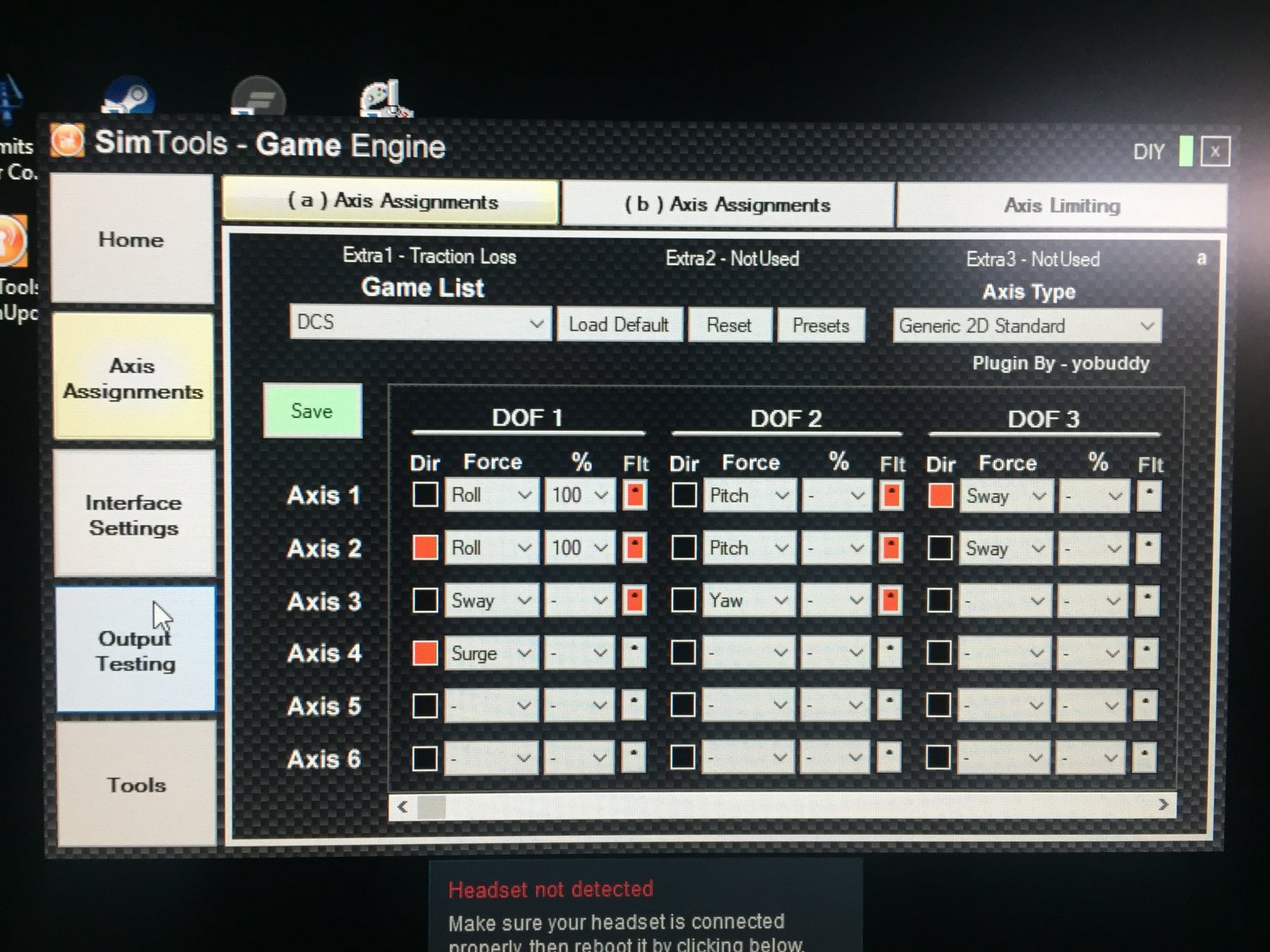

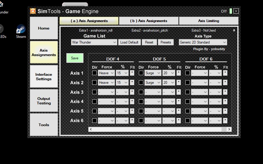

    So roll and pitch are working as expected, just need to tune it. Tried using Sway for my "traction loss" but results didn't make any sense. I was expecting it to activate when I use rudder but it was all over he place. I think I need to experiment with Yaw instead. Surge also wasn't great I am planning to try assigning Heave to my Surge axis instead. Anybody with surge and traction loss SIM could give any suggestions?

    Dully noted, but it works pretty well for NL2 with Sway assignment.

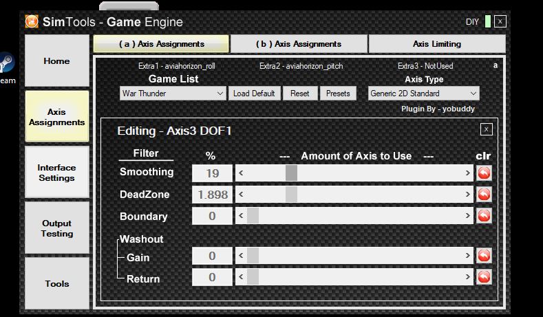

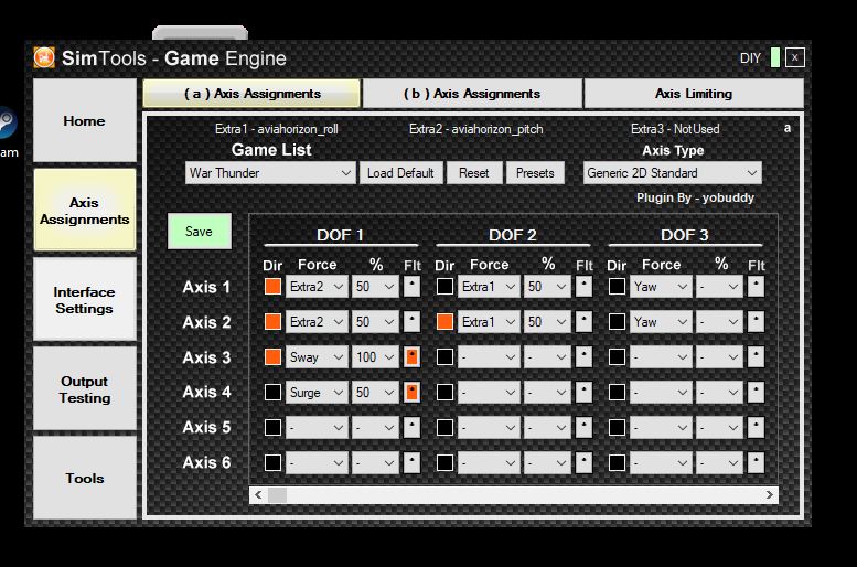

    I uploaded a couple of (not so great) videos so let me know what you think. I just turned the VR mode off for the videos so you could see what is going on on the screen. Overall I think I am pretty happy with the results, always room for more tweaking. Screenshots of my settings are attached as well. Comment away :)

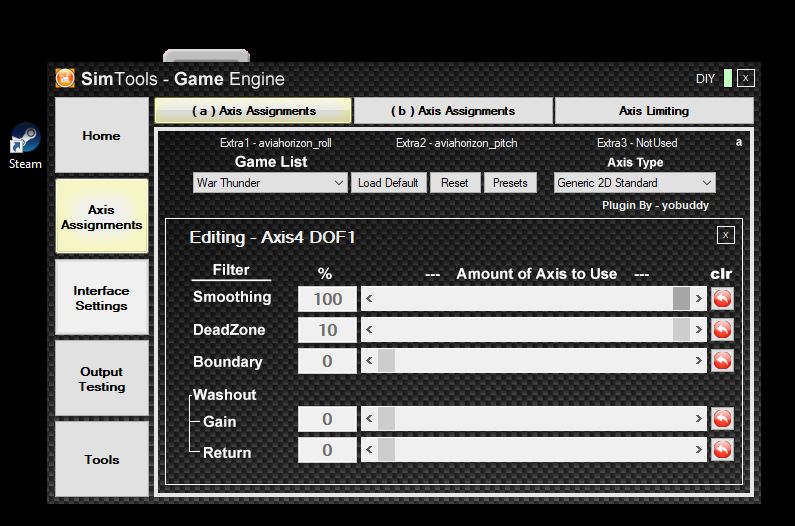

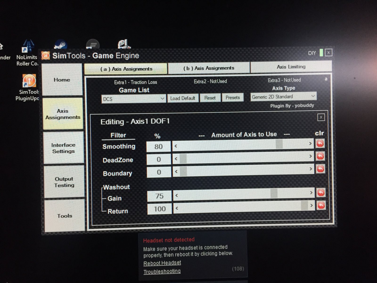

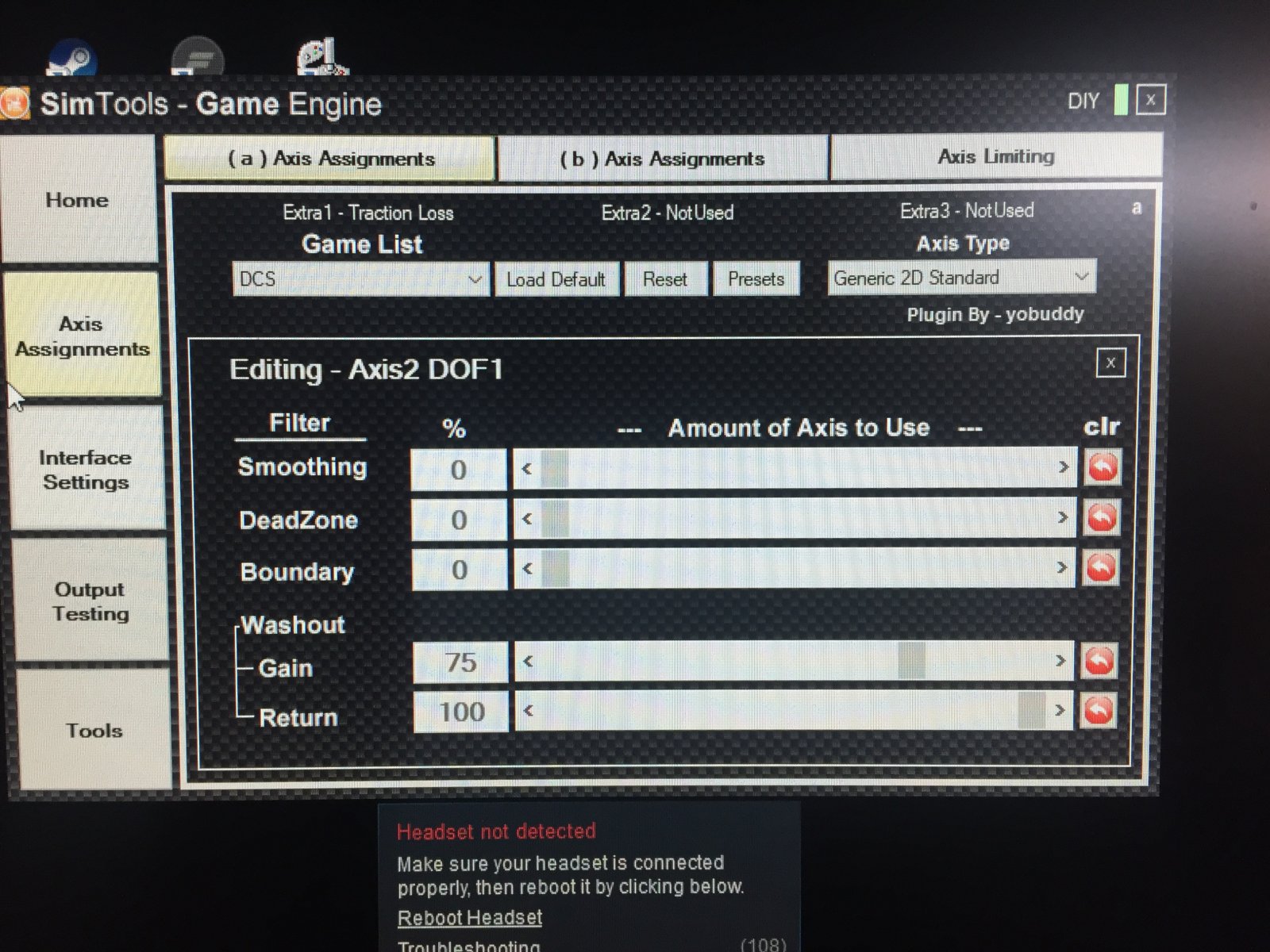

    So far DCD is giving me hard time.
    The settings are attached.
    First video is with 80%smoothing:
    Second one with 0% smoothing:
    Hopefully you could see that in both videos after I come out of the roll the chair stays lopsided to the wrong side for a very long time until it returns to normal position. And that is with 100% return which supposed to be the quickest. I allocated 100% force to the roll just to emphasize the point, it will be reduced in the final settings. I spent a lot of time with it yesterday, as soon as my gain is over 10% or so it takes forever for it to level out and is stays tilted to the wrong side. Any suggestions would be appreciated.
