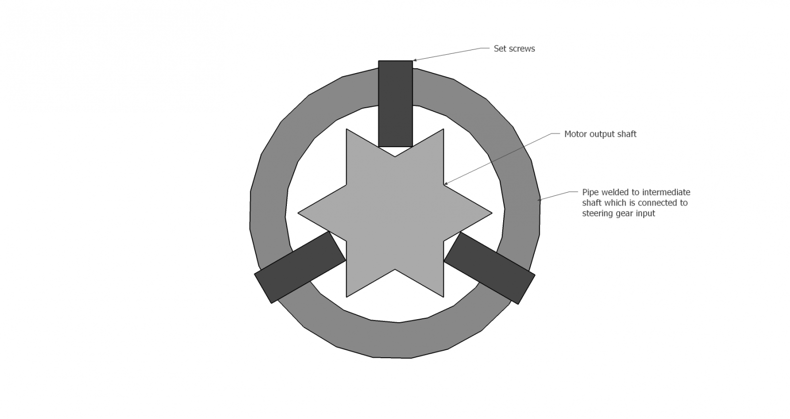

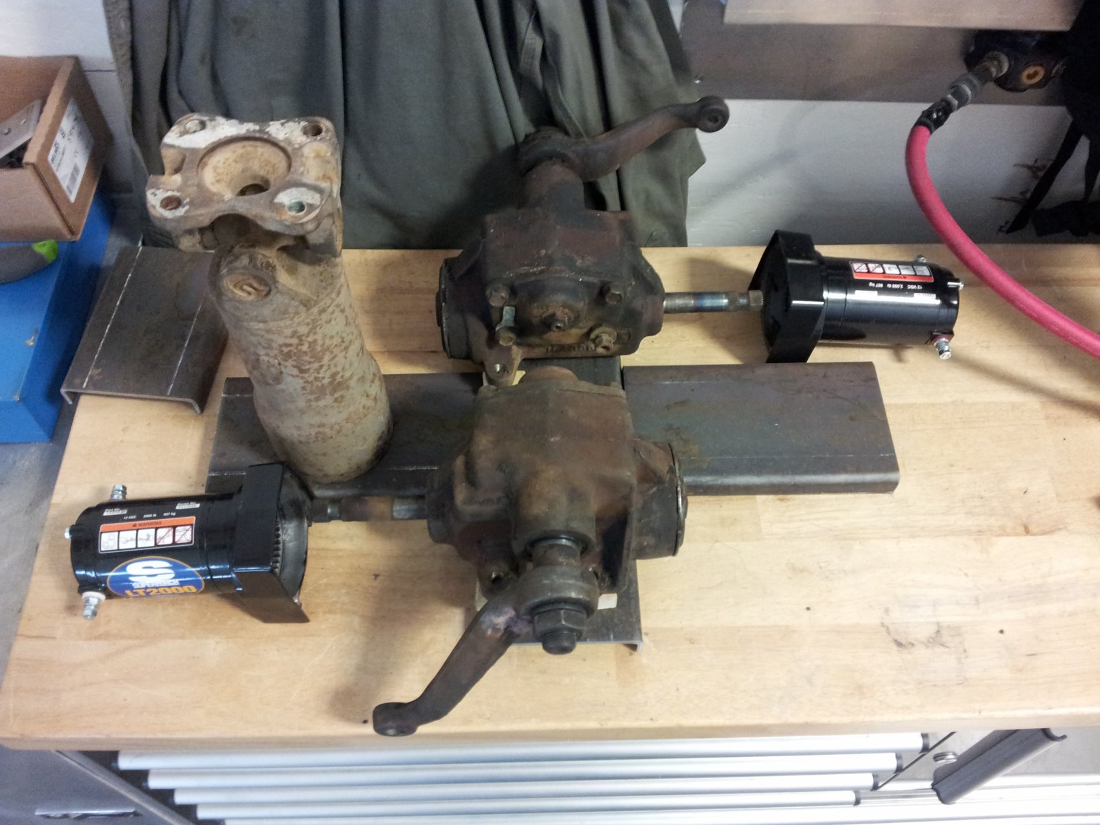

    @Pit the steering boxes I picked up are from late '80s Chevrolet S10 pickup trucks. I think most of the 2WD trucks with 4 cylinder engines came with manual steering boxes that were a lower ratio than the power steering boxes.
    It looks like it should be fairly easy to splice them onto the motor shaft. The motor output is a 6 spline shaft, so I'm figuring a pipe with three set screws drilled and tapped into the pipe 120 degrees apart with some Loctite should be sufficient. Hopefully I can center it well enough with the set screws that vibration is not an issue. There will also be a rubber flex coupler between the motor and the steering box that came with the intermediate shaft to take care of any minor misalignment.
    I'm hoping to get these couplers made up this weekend, so I'll post some pictures of them once complete.

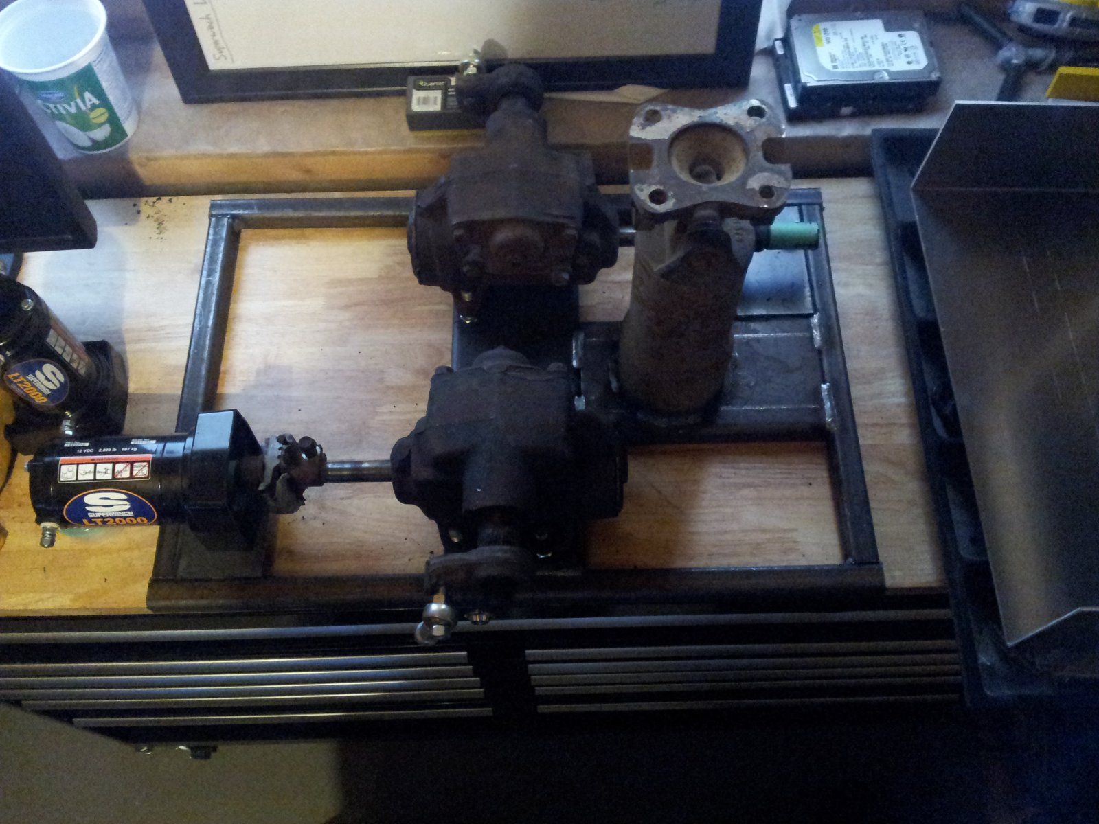

    Realizing that my frame dimensions could effect how long my couplers would be, I decided I'd better start on the frame first.
    Here is the layout I'm figuring on for my base frame. The steel underneath is 3/16" mild steel plate, bent to be the same height as a 1" square tubing. I'm sure 3/16" is overkill for the application, but the next size down we had in stock at work was 12 ga. At least flex shouldn't be an issue!
    I plan to remove the pitman arm from the gear box in the foreground and turn it 180 degrees to match the one in the background, just need to find someone to borrow a puller from. After that, I'll be making a perimeter for the base out of 1" square steel tubing and starting some welding. The pitman arms will be cut down to just under half their current size to increase force.
    Also, I purchased hall effect potentiometers that have a range of measurement of 90 degrees, so they should match my steering boxes 93 degrees of travel with no gearing necessary.
    I'm hoping that by building a sturdy, separate unit for the 2DOF seat mover part, I could easily reuse the whole assembly in a rig with more degrees of freedom down the road. Alternatively, I may just build an aluminum shell around it to house all the electronics and call it complete.

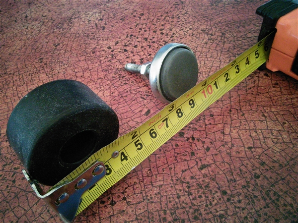

    @noorbeast looks like a very elegant solution to the portable/stable dilemma that @mazak515 has come up with. I'm not sure I'm feeling up for building something that fancy though.
    How big of rubber feet are you using now for your simulator? We've got some 75mm round by 25 mm thick rubber door bumpers at work that I was thinking of using for feet. The rubber isn't particularly grippy, but I was hoping 6 of them would do the trick.

    These are the old and new feet. The new rubber feet actually came with the Buttkicker mount for a couch and are 50mmx25mm, so were design for vibration dampening.

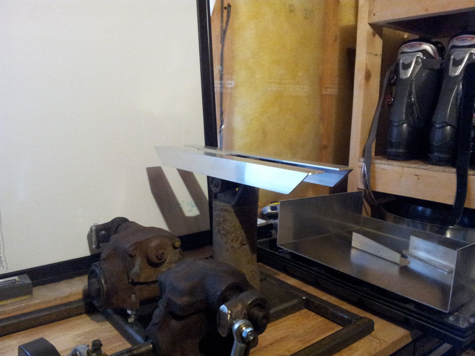

    Well, my seat has finally arrived, so I'm running short on excuses not to have this thing put together. I got a Procar Drifter seat in grey velour. Here it is pictured with my test pilot and a 5 point Racequip harness.

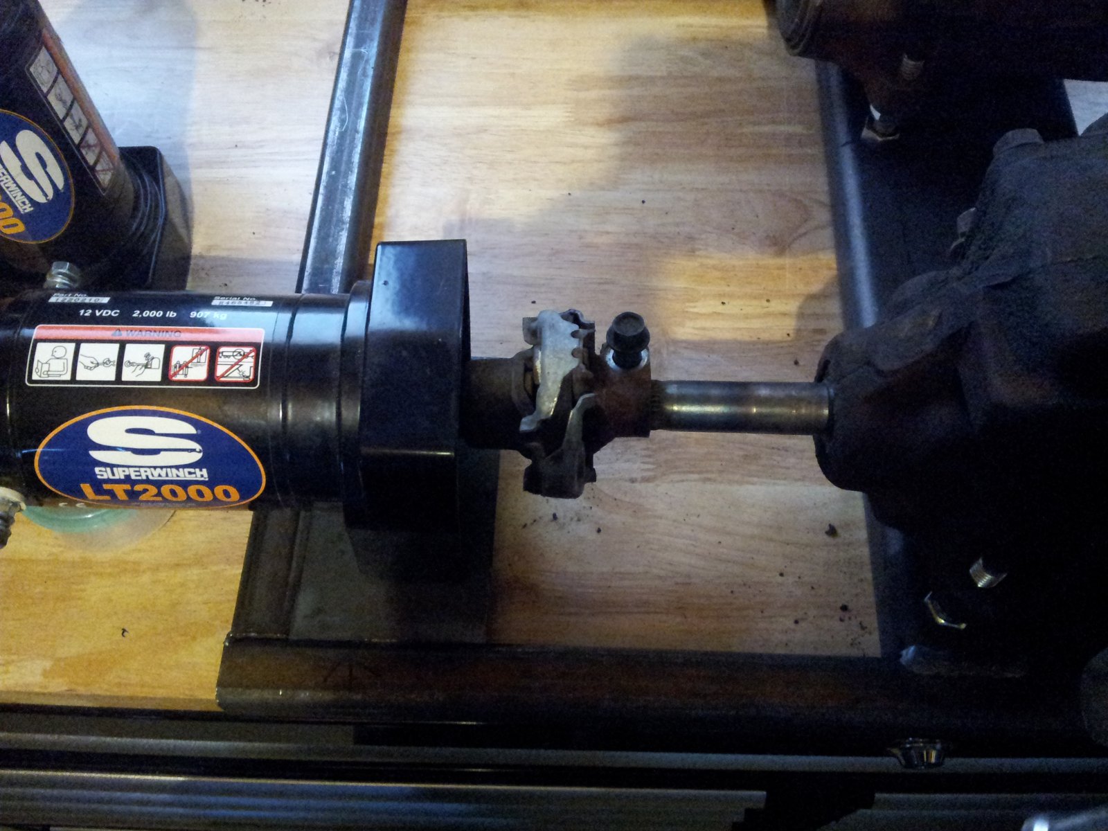

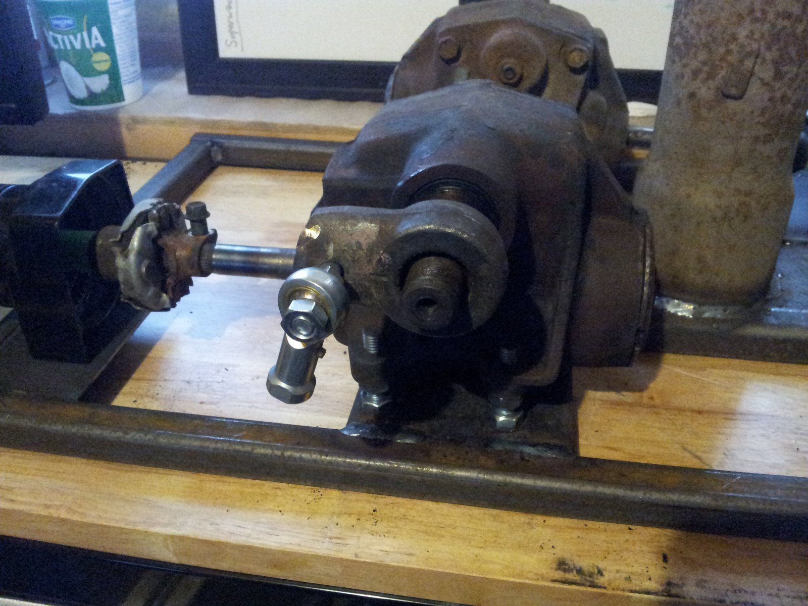

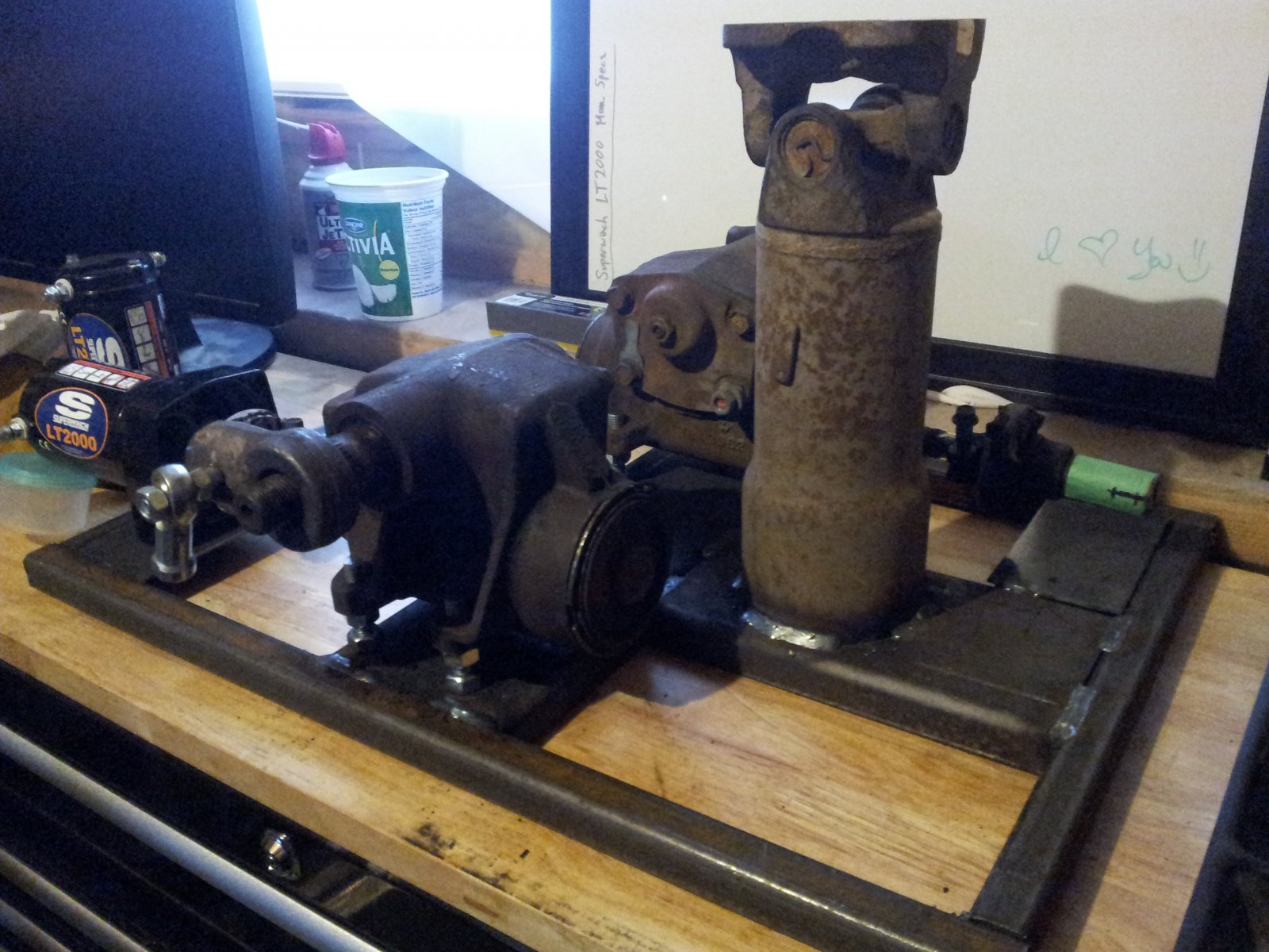

    I welded the frame together using 1" x 1" square steel tubing and 3/16" steel plate bent 90 degrees on each side to stiffen things up.
    I think the rubber couplers from the intermediate steering shafts will work out well to join the motors and steering boxes. The steering boxes are mounted on 7/16" threaded rod with nuts on both sides of the 3/16" steel plate so I can adjust the height and angle to align them with the winch motors.

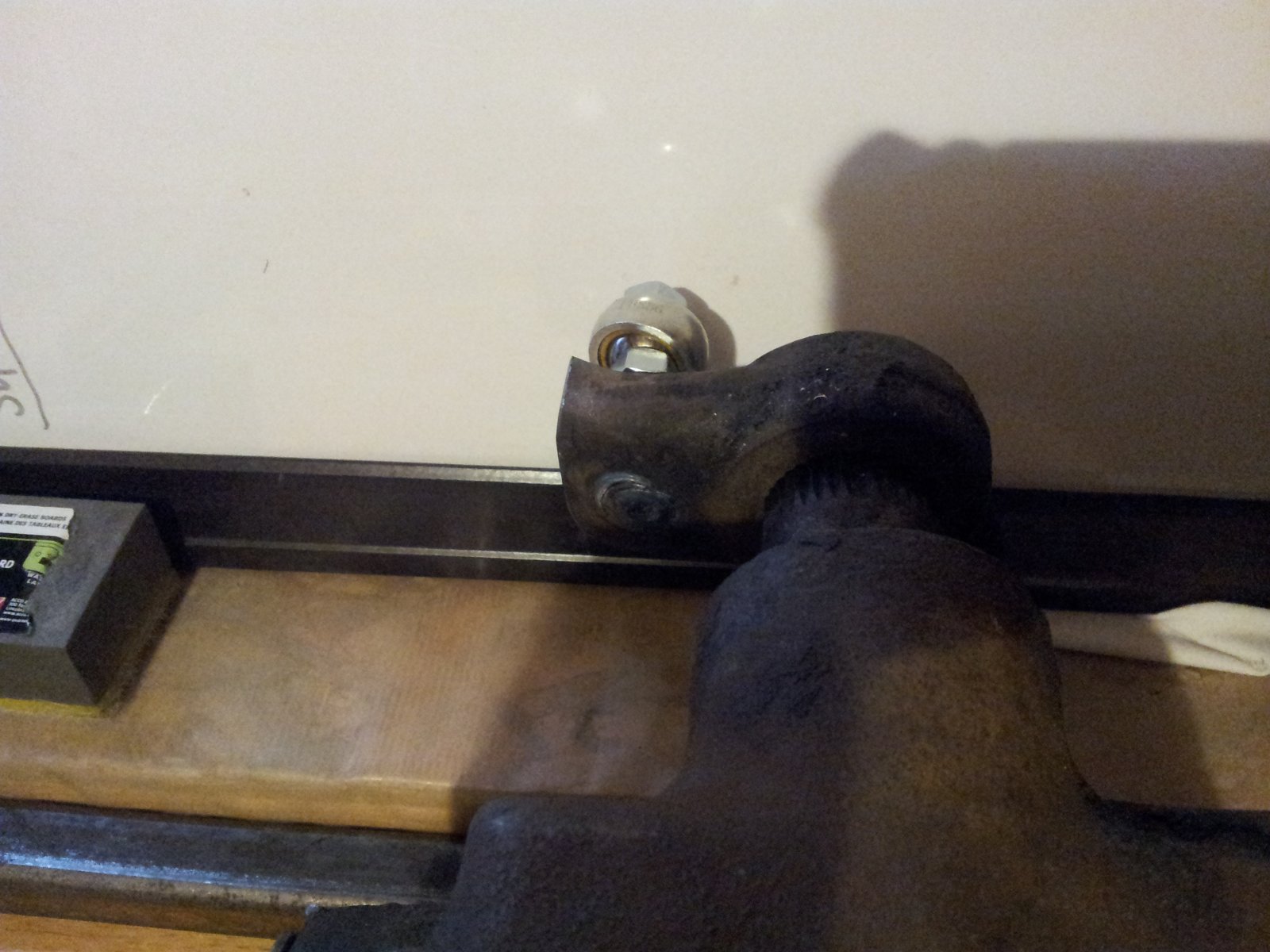

    The heim links are size 3/8", and I attached them to the pitman arms by welding bolts into the pitman arms. I drilled a 3/8" hole in each pitman arm, cut the head off a bolt, and plug welded it in place. When plug welding, I had the end of the bolt recessed about halfway through the pitman arm to ensure the weld penetrated sufficiently. I used stover nuts on both sides of the heim link with the beveled side facing inwards to improve the range of motion. To thread the stover nuts on more easily, I first cut the locking part of the threads out with a tap.

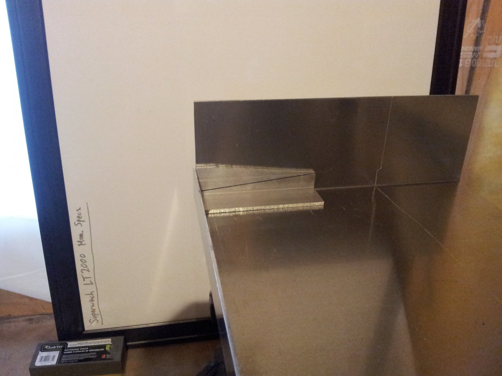

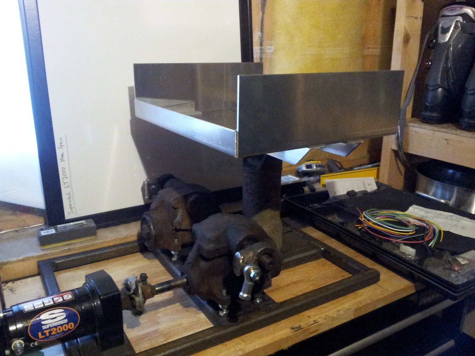

    For the seat platform, I've got a sheet of 1/8" aluminum bent to form most of a box for stiffening. Under the box, I've got 1 1/2" x 1 1/2" aluminum angle 1/8" thick to carry the weight to the u-joint. Inside the box, I've got 2 pieces of 3/16" thick aluminum angle to bolt the heim links through. Once I get it all welded together, I'm planning to cut some rubber isolators out of 3/16" thick rubber matting to go between the aluminum frame and the fiberglass seat.
    The fiberglass seat has a little more flex to it than I expected. The other compact simulators I've looked appear to have the seat only attached by the four bolts at the bottom, but I'm concerned about damaging the fiberglass.
