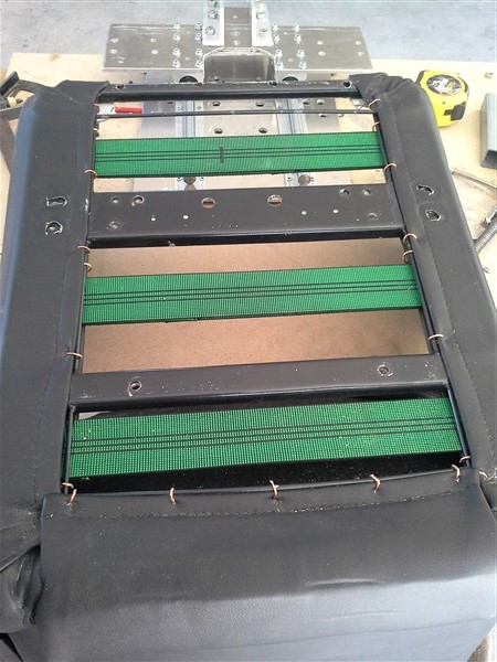

    Hang on, you asked about fibreglass integrity of a seat, not the aluminium of a frame?
    I only use steel on my frames, aluminium too expensive for me
    21,712
    151,979Coins
    +11,061 / 56 / -2

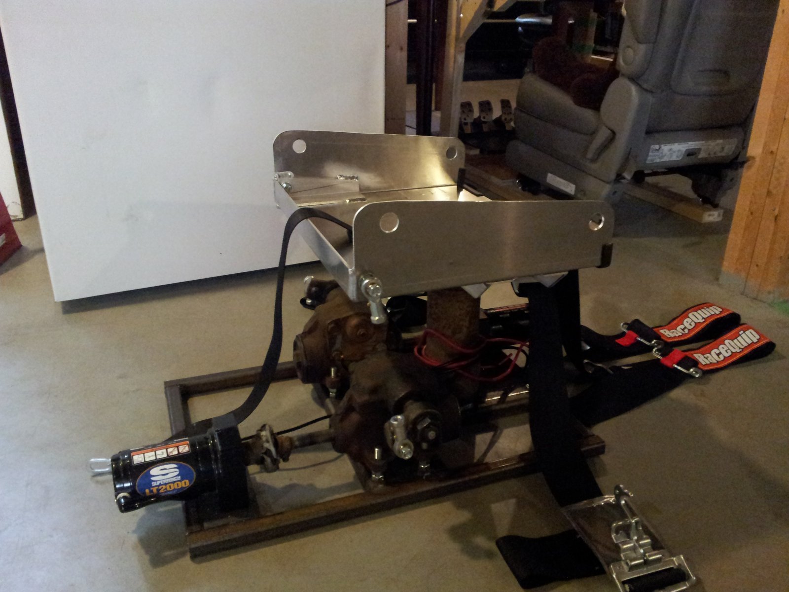

    I use 5mm aluminum plate as my seat base and that is OK for the pivot and 3DOF connection supports, but it is supported by the substantial built frame of the seat I use.
    Check what you are doing for flex once fully mocked up. If there seems to be any than add a reinforcing base plate, which would add substantial rigidity to your existing angle aluminum frame.

    @bsft I currently work in a fab shop that deals with mostly aluminum, so it's easier for me to get than steel. I had aluminum in mind primarily for the weight savings on the moving parts of the simulator. My concerns about strength were only for the seat itself when using just the 4 bolts near the bottom to attach it, for the aluminum frame is easy to reinforce if it flexes too much.
    @noorbeast is your 5mm plate just a flat piece to transfer load from the seat frame to the pivot? I'm hoping my 3mm plate will be stiff enough with the bends and added aluminum angle which will all be welded together.

    Yeas mine is flat plate but my seat has a substantial frame so that adds a lot in terms of rigidity, including the front bolts of the uni passing through the flat steel of the seat frame and the aluminum plate.
    Seat frame:

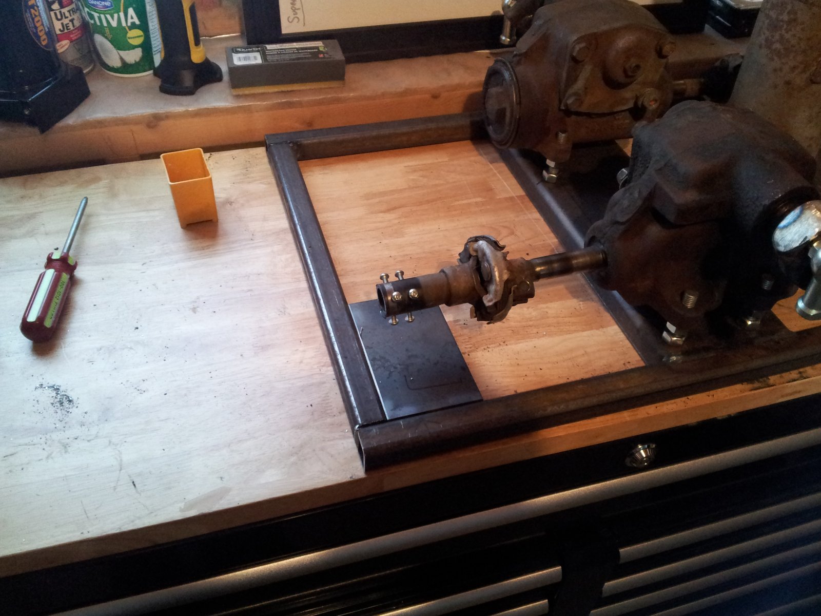

    The simulator is just about ready to start moving! Thanks for all the help I've gotten along the way, this project would not have been a success without it.
    I'm having some difficulty getting a USB to DB9 serial adapter that works with Windows 10. Has anyone else had trouble with this? Most of them seem to only be compatible up to Windows 7.

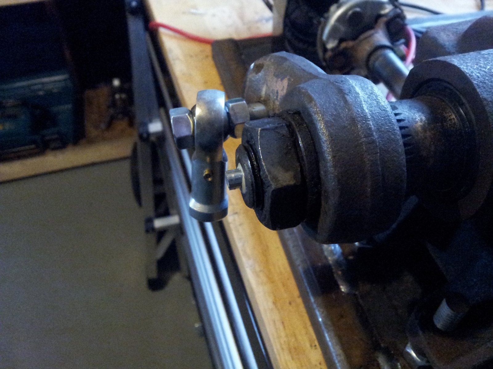

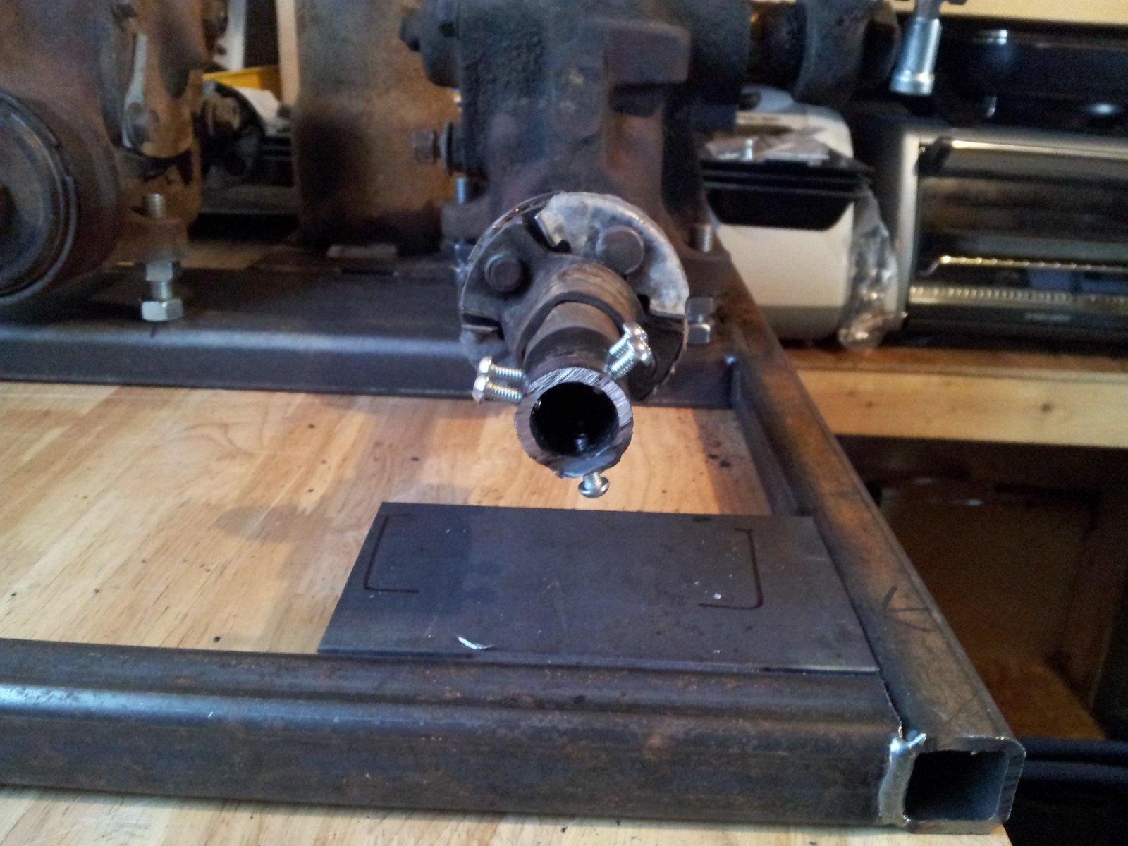

    The motor couplers worked out quite well. I just marked the holes by holding a hex driver up to the end to be able to judge 120 degrees. I had to drill a couple holes in the winch motor to be able to tighten the screws on the couplers and align the shaft with the gear boxes.

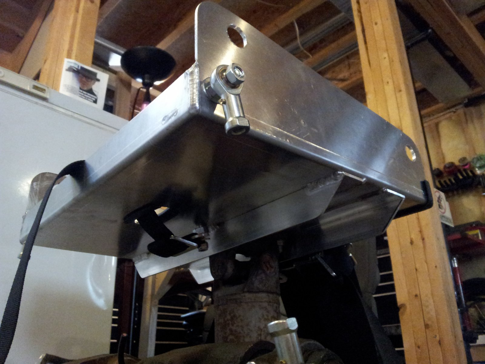

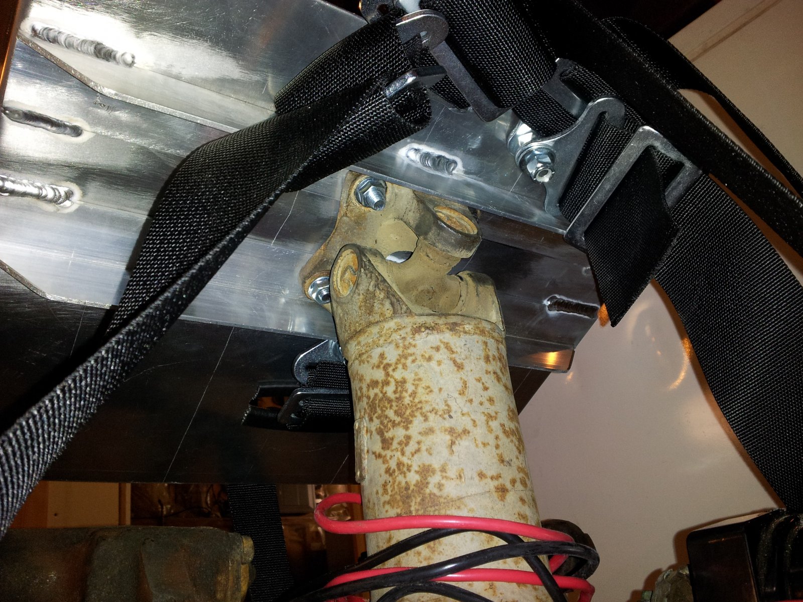

    I used epoxy to attach some small pieces of 1/4" bolt to the output shaft of the gearboxes. I'm going to be clamping on a piece of quarter inch hose to couple the hall effect potentiometers to the shaft.

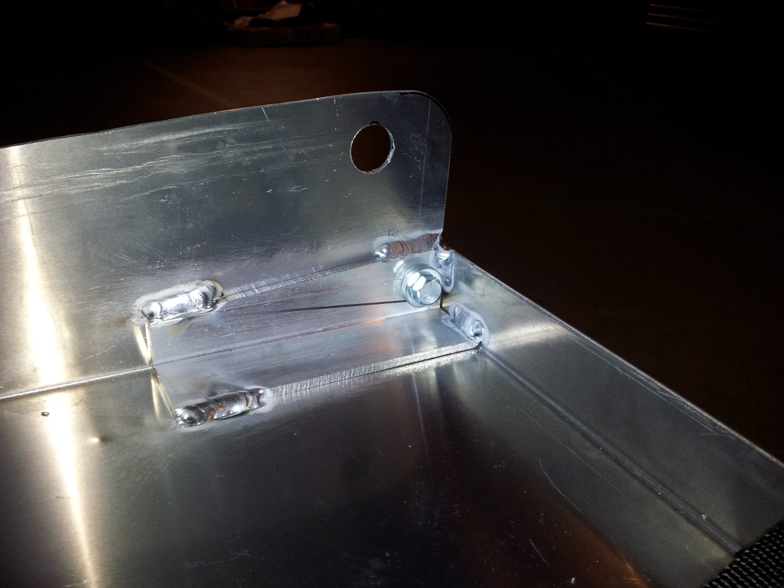

    The aluminum frame fits nicely over the u-joint. I drilled the mounting holes out to a large size so that I could put rubber washers in there and isolate the vibration of the Buttkicker to the seat as much as possible. I haven't figured out how to mount the Buttkicker to the seat yet, as I got the gamer edition and it just has a clamp.
    20150824_183612.jpg 20150824_183643.jpg 20150824_183737.jpg 20150824_183957.jpg

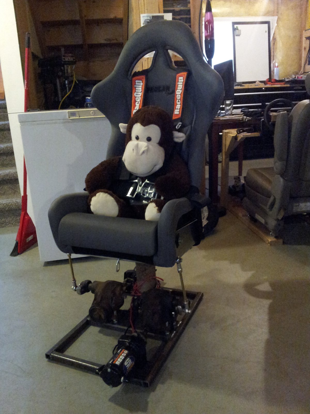

    My test pilot is ready to go, and I'm ready to move my focus to the electrical portion of this project!

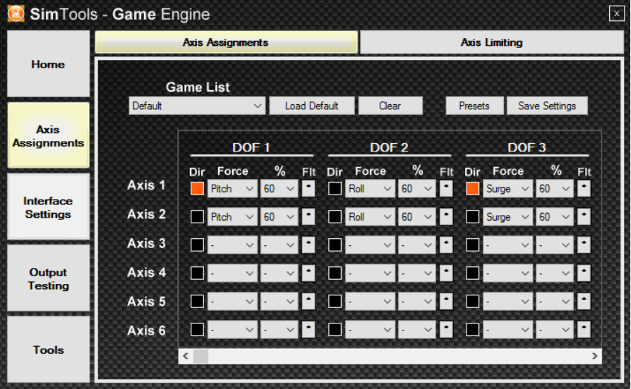

    Here is the first in-game test of the simulator.
    I haven't spent much time with the tuning yet, but this is what my axis assignments are in the video, with the addition of DOF 4 set to sway. The axis are currently limited to 50% of their travel.

    Congrats! Looks powerful!
    I think it would be better to start tuning from sway and surge instead of roll and pitch.
    Looks like there is no sound from the winches and that is great by itself!

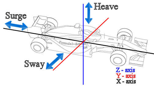

    I'm not an expert at all, but iirc, usually, bumps comes from heave, cornering from Sway, acceleration and braking from Surge.

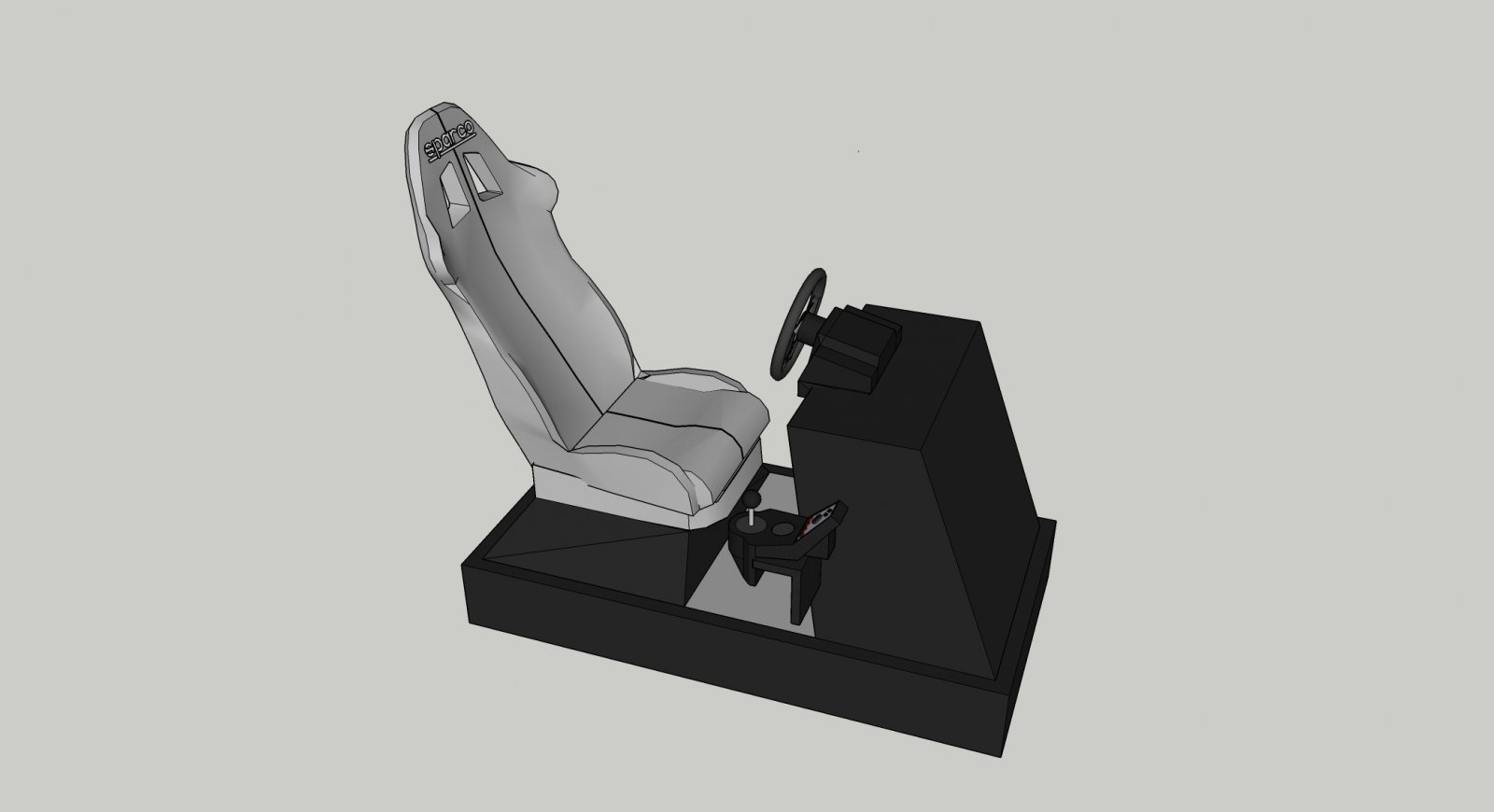

    I haven't set up my wheel and pedals with the chair yet (I used an Xbox 360 controller in the video), but I have a plan where to go next.
    I'm figuring on building a wooden frame about 20 cm high that will be a base to support everything. The steel frame of the seat assembly will be bolted directly to the frame, and the wheel and pedals will be on some kind of a slide system. I'm leaning towards using one of those worm screw type car jacks and a power window motor for power adjustable pedals, but I haven't figured that part out quite yet. The screen will be on a separate stand or possibly wall mounted.
    With some vent holes and a fan, I figure I can mount all the electronics in the base part out of sight. I'm planning to enclose the power supply, motor driver/controller, a subwoofer, usb hub, Buttkicker amp, USB sound card, and power bar. My goal is to have only two cables exiting the simulator, one power and one USB.
    Once all that is operational, it'll be time to wrap all the exposed surfaces in carpet or vinyl to pretty it up a bit!

    Why are you Limiting so much travel on the Engine ?
    Have you read about the 20% and tune it method ? 60% on the actual Axis and limiting it 50% in the filter's doesn't make much sense.
