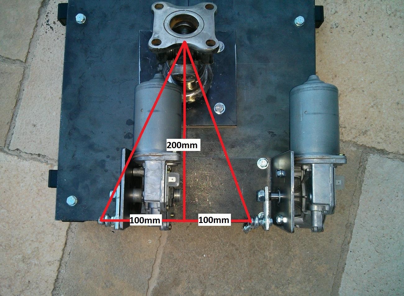

    thanks for taking the time to watch the video.
    Well, since its a seat mover i thought it was better to start with forces (sway and surge) and then move to angles (Pitch or Roll).
    As far as the heave issue, i can well understand what you say about the vertical forces, but i don't feel confident messing with it at the time.

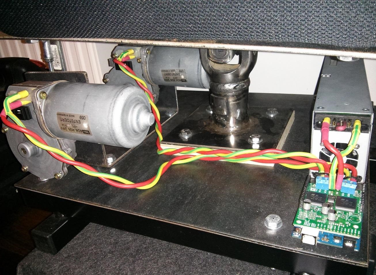

    It moves pretty good, considering wipers and the narrow motor position / rod connections, usually people set motors wider and connect to corners of the seat base. Are you running those wipers at 24V or 12V?
  6. pipis2015
    pipis2015 over-boost
    Feb 18, 2015
    221
    Athens, GREECE
    10,248Coins
    +272 / 1 / -0
    12volt
    Pwm 215 to 255 depending on distance... the more distance the bigger pwm.
    My weight: 63kg.

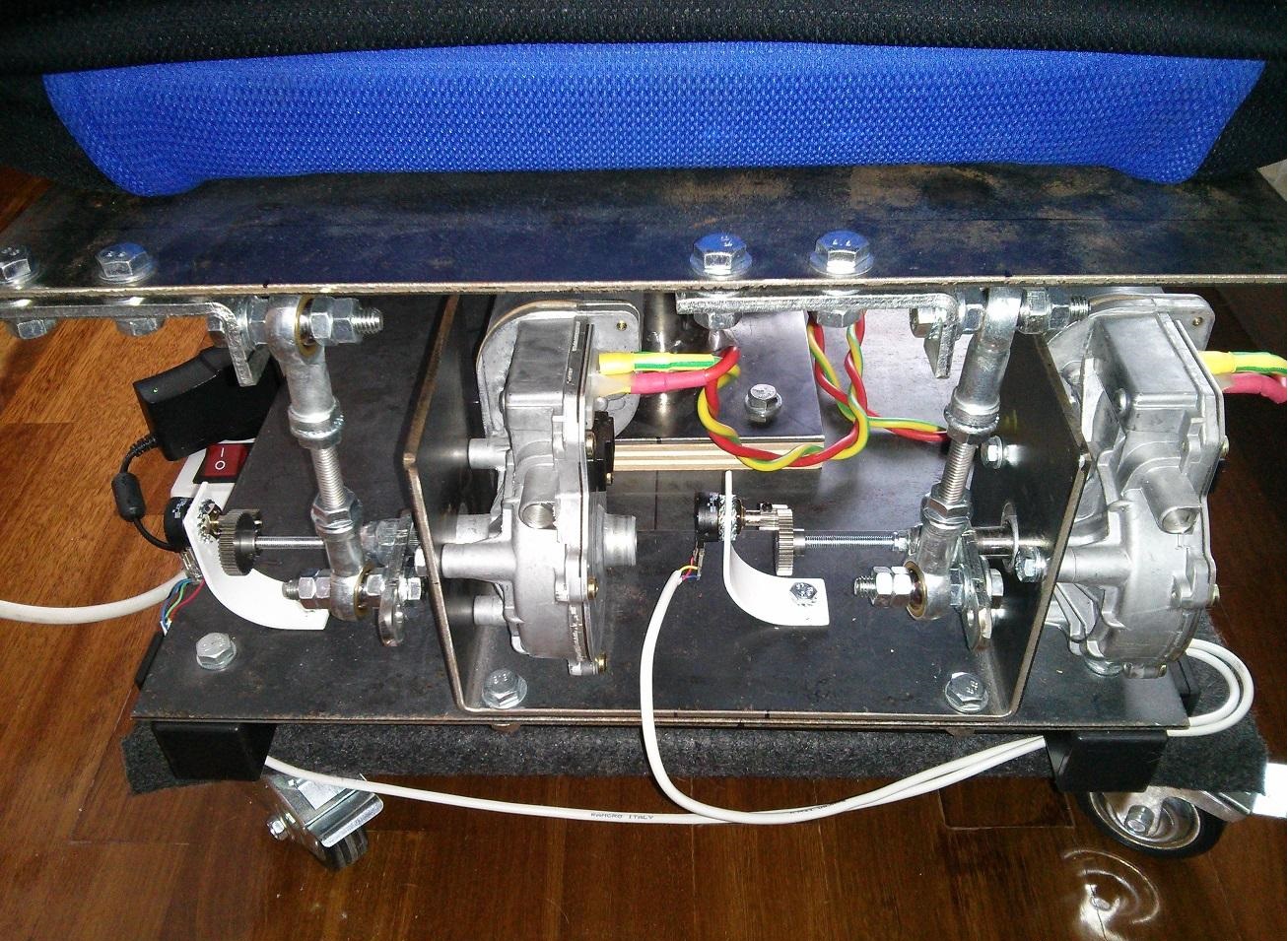

    Great work @pipis2015! I have the same Gameracer seat, and I love the fact that you've made it reversible back to static sim if you need it to be! Very well planned build and great documentation! Thanks for sharing!

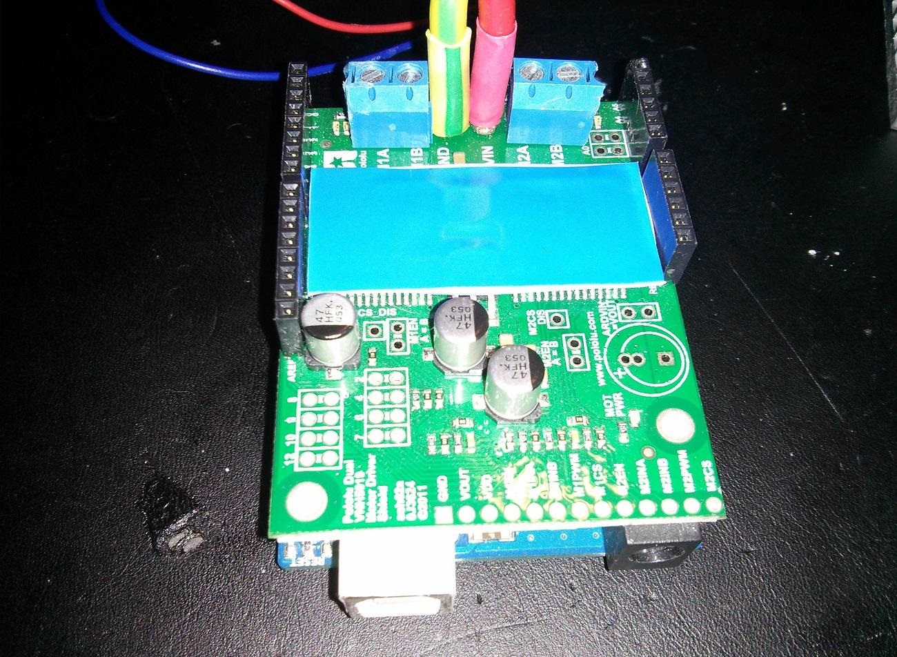

    Hello going to purchase the Arduino Uno R3 and the Pololu Dual VNH5019 motor driver shield for Arduino were did you get the firm ware for this im just trying to do my home work and figger this stuff out
