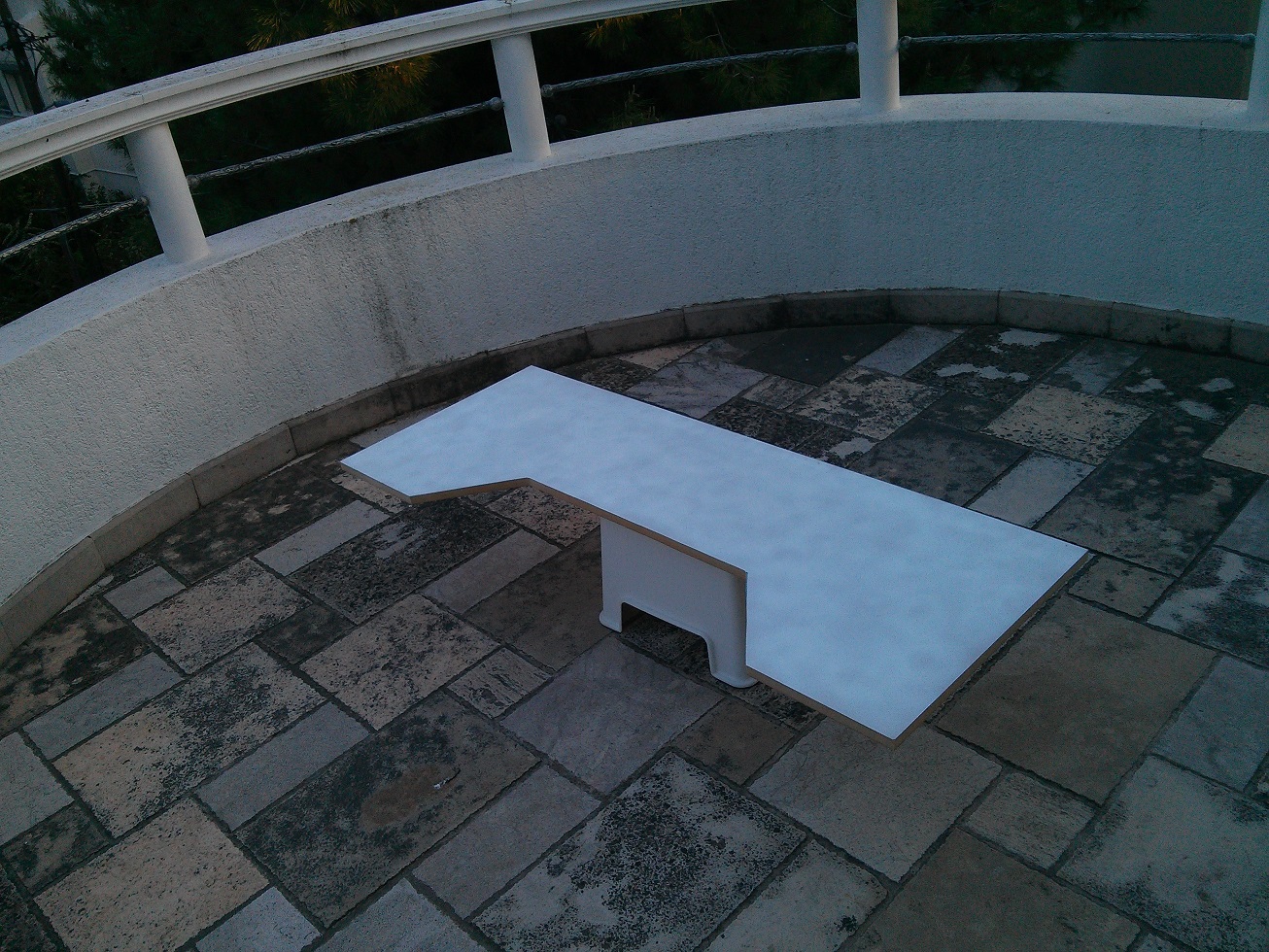

    ...simple triple monitor base for desk use.
    ...the wooden "base" can slide forward on the desk to embrace the driver when driving or backward to leave space for the keyboard and mouse(for games that require mouse and keyboard that is :p ).

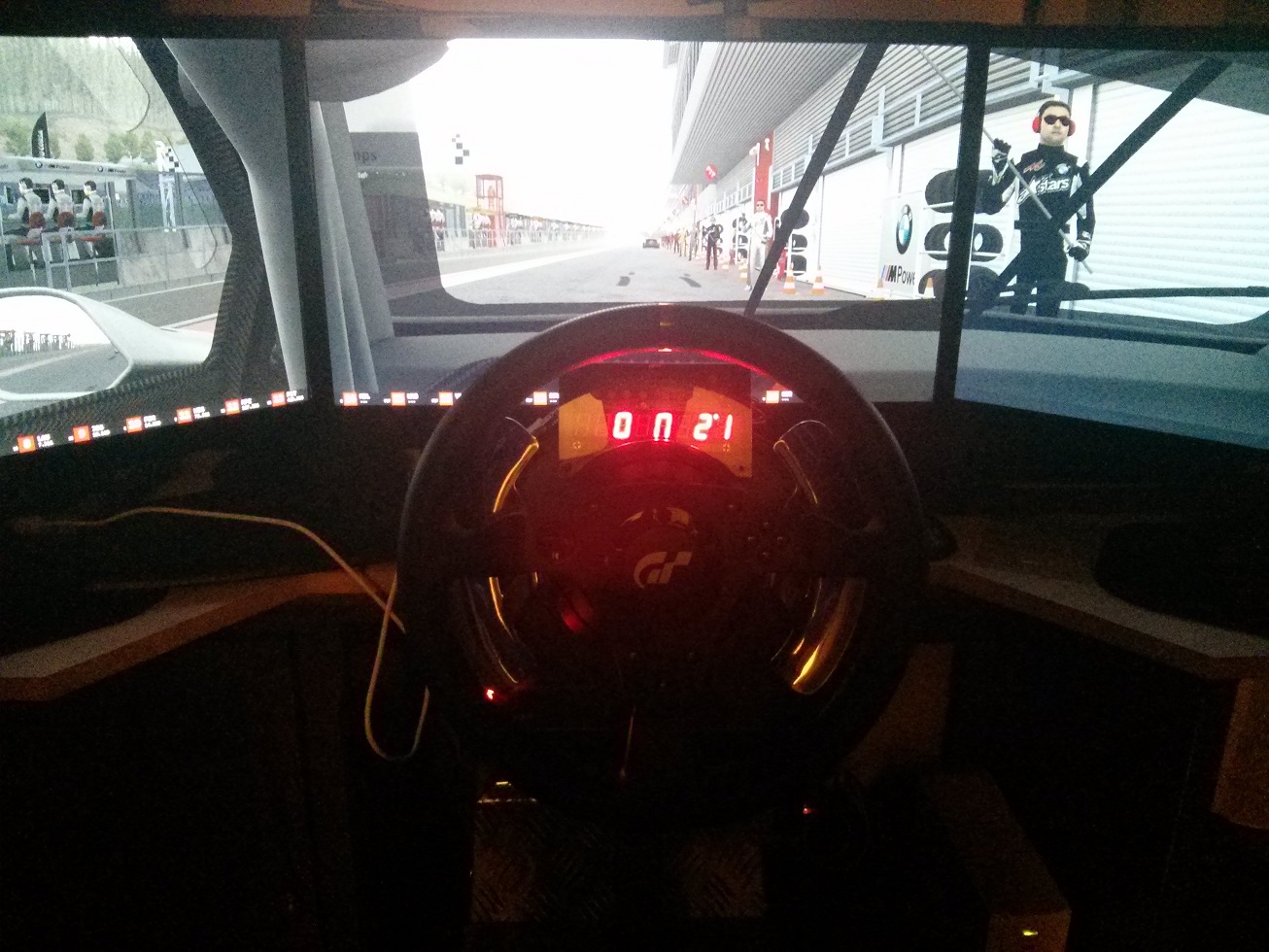

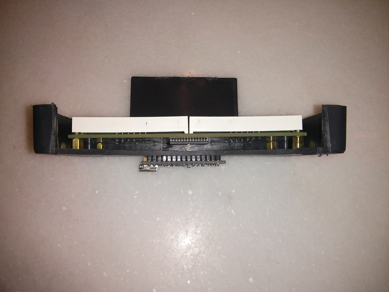

    my new dashboard driven by
    AChub
    my display configuration:
    speed in km/h(3 digits)
    gear(1 digit)
    rpm in thousands point hundreds(2 digits below 10.000rpm and 3 digits above 10.000rpm)
    e.g. 5100rpm=5.1 and 11600rpm=11.6

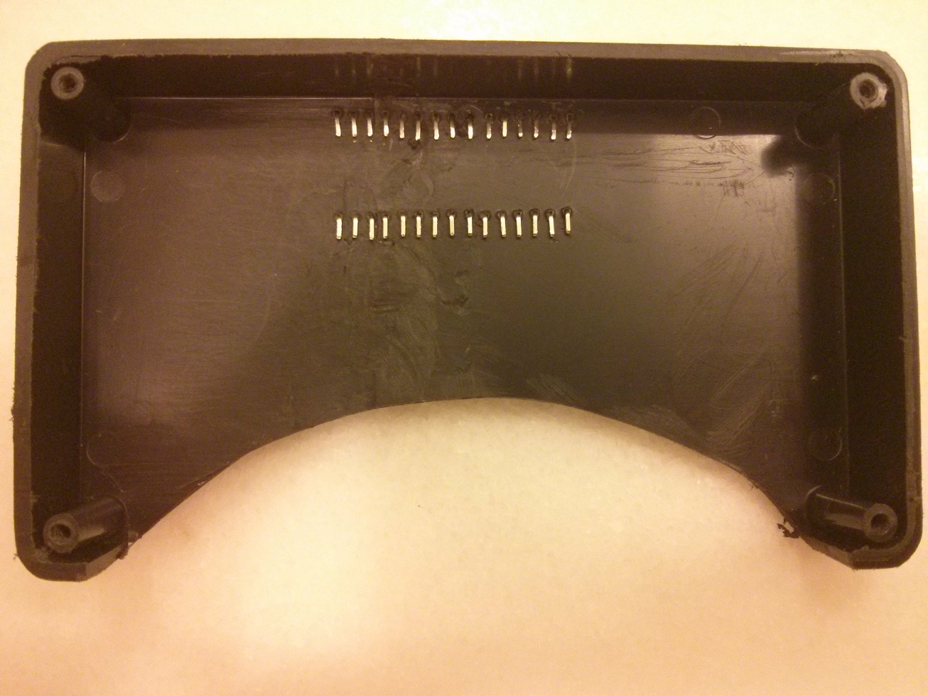

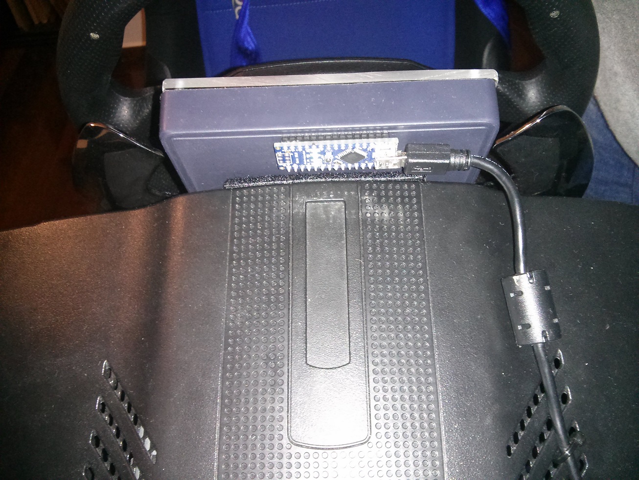

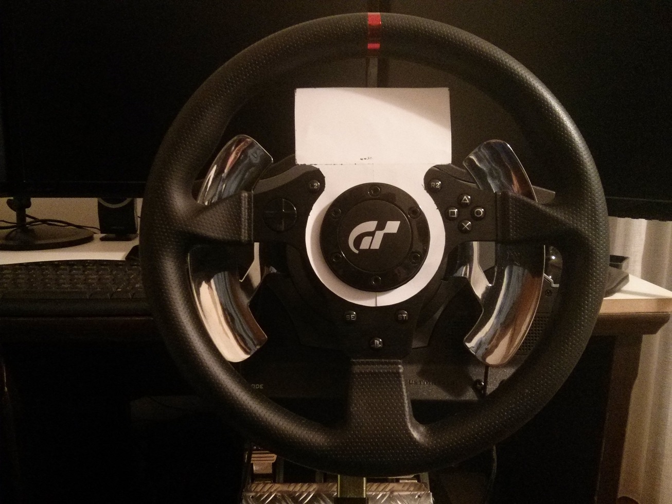

    My first attempt to fit the dash was this:
    But after some thought, i didnt want any cablework floating around the steering axle so i went for a more simple approach.
    First fit was ok.
    "ingredients":
    a)A plastic project box of the proper size to fit the tm1638 board (and have some extra space to fit a few toggle switches at the sides to take advantage of the 8 buttons of the board)
    b)A piece of plexiglass
    c)Some rough cutting drilling and sanding
    The project needs some polishing of course and a final touch with 3d carbon-fibre sticker for some more pro look.
    Total cost: less than 20 euros.
    Fun factor: "priceless".

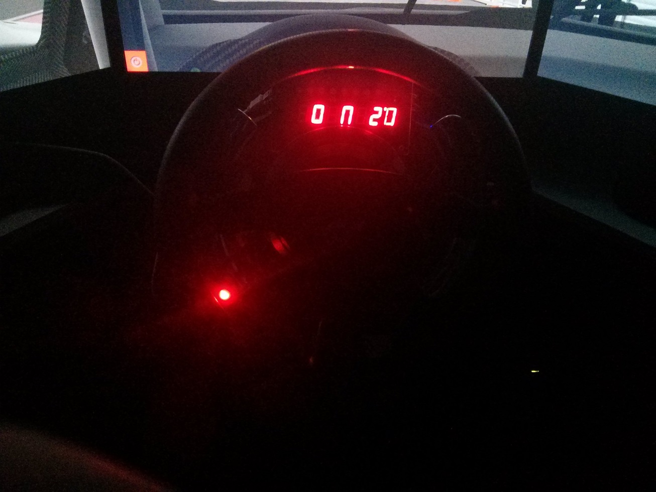

    bonus POV nightshots :

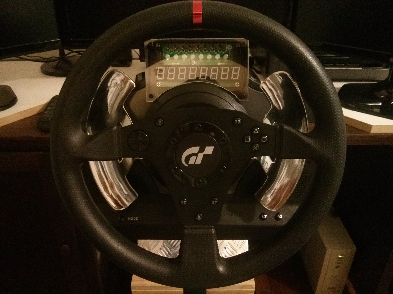

    some detailed pics of the display.
    I chose this config to keep the reset button handy ;)

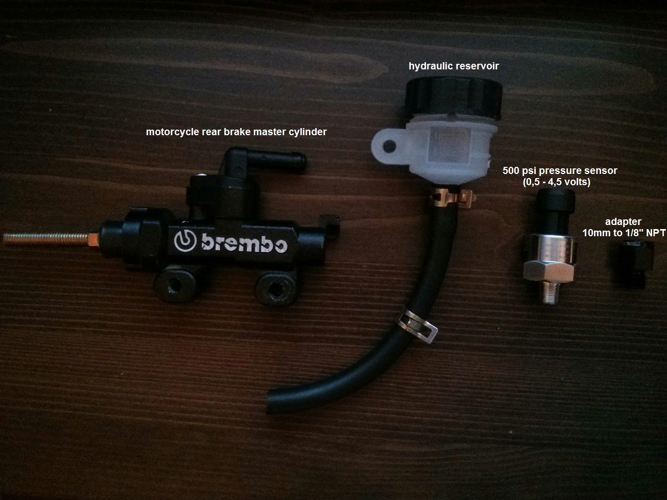

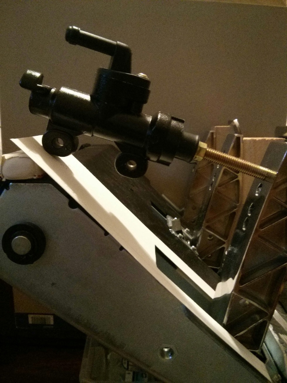

    Athens, GREECE
    10,248Coins
    +272 / 1 / -0
    cost: 34 eur
    cylinder(+reservoir): 12eur
    sensor: 16 eur
    adapter: 6 eur
    i am planing to fit the sensor directly on the pressure output (leaving a small pocket of trapped air) and see how it feels.

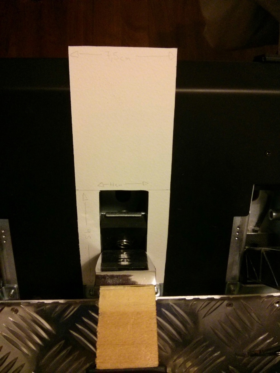

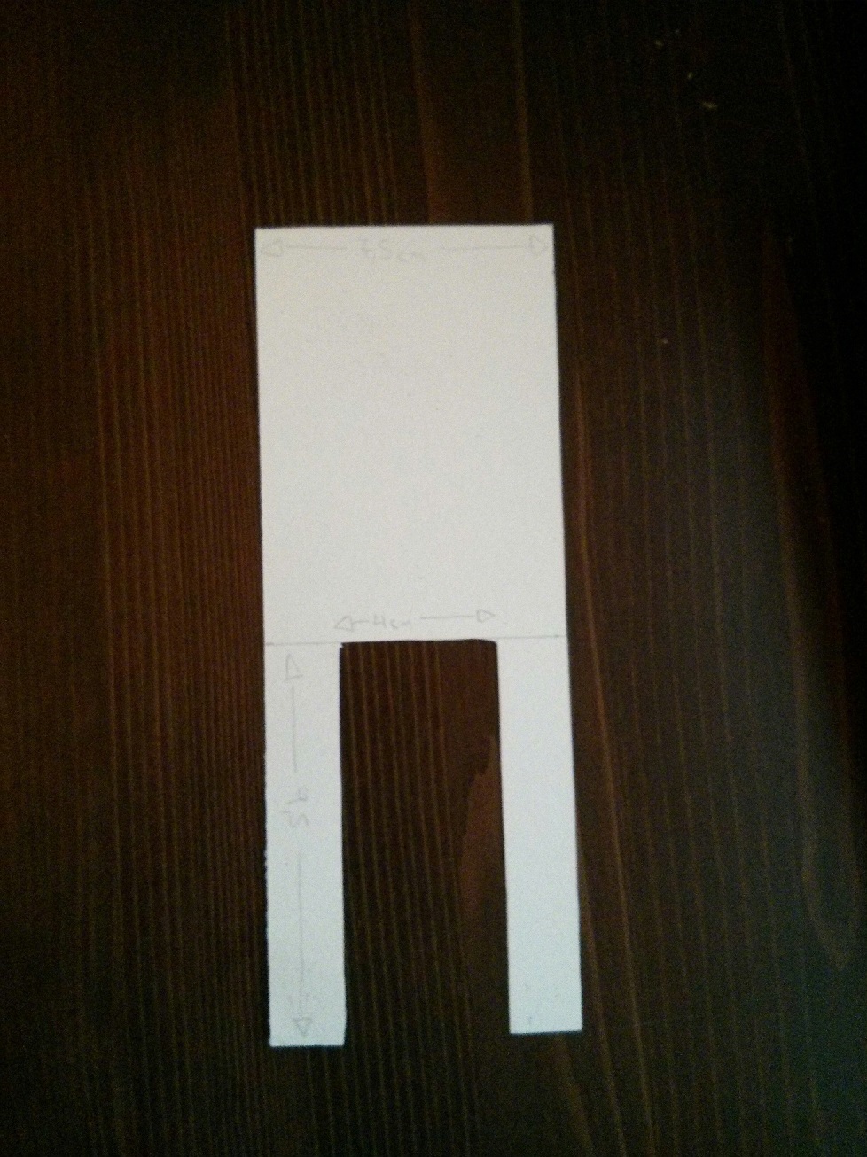

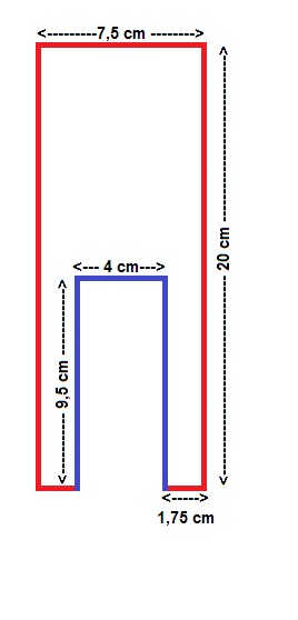

    i also designed a mini-chasis that i will use as a platform to fit the cylinder assembly on the pedals without damaging them.
    paper preview:
    and how it will fit the pedals
    its a multi purpose chassis that can be used for every pedal (eg for a realistic clutch pedal modification) and can be securely bolted to the oem screw holes.
    the tilt will ensure that a small amount of trapped air (which will be used as travel regulator) will remain permanently inside the cylinder.

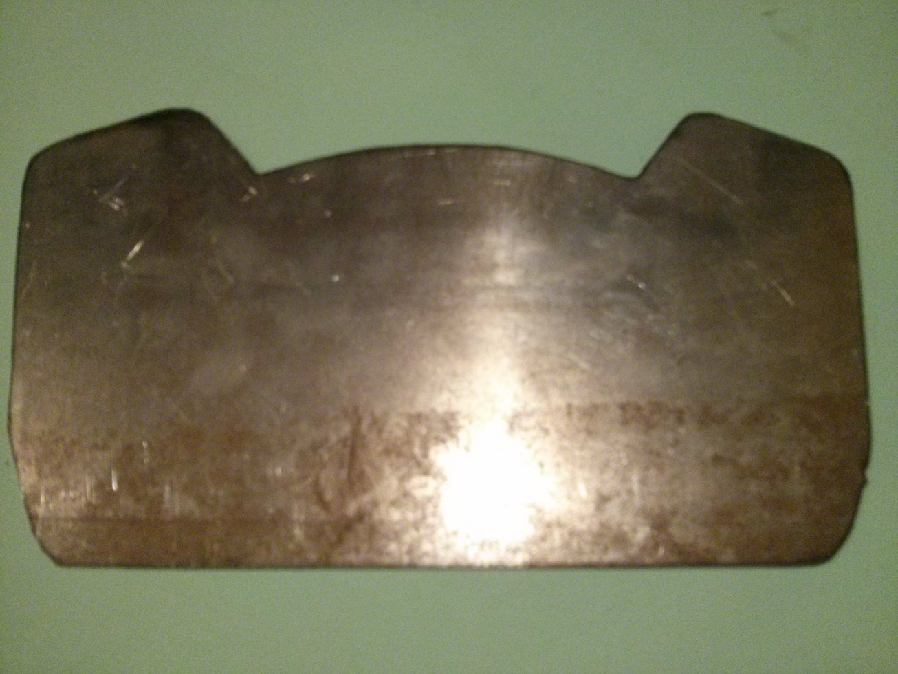

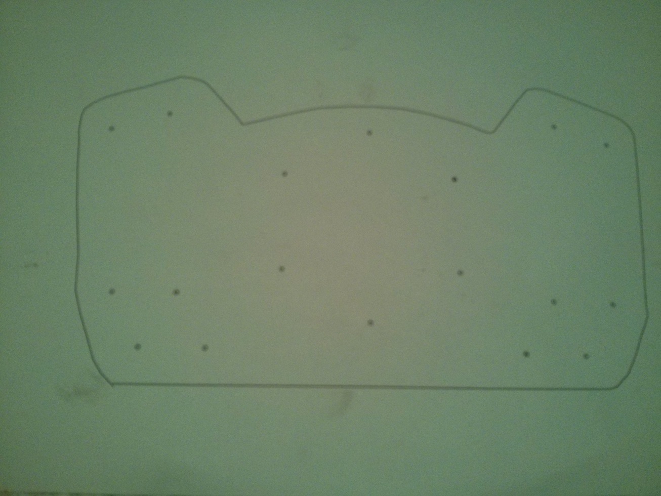

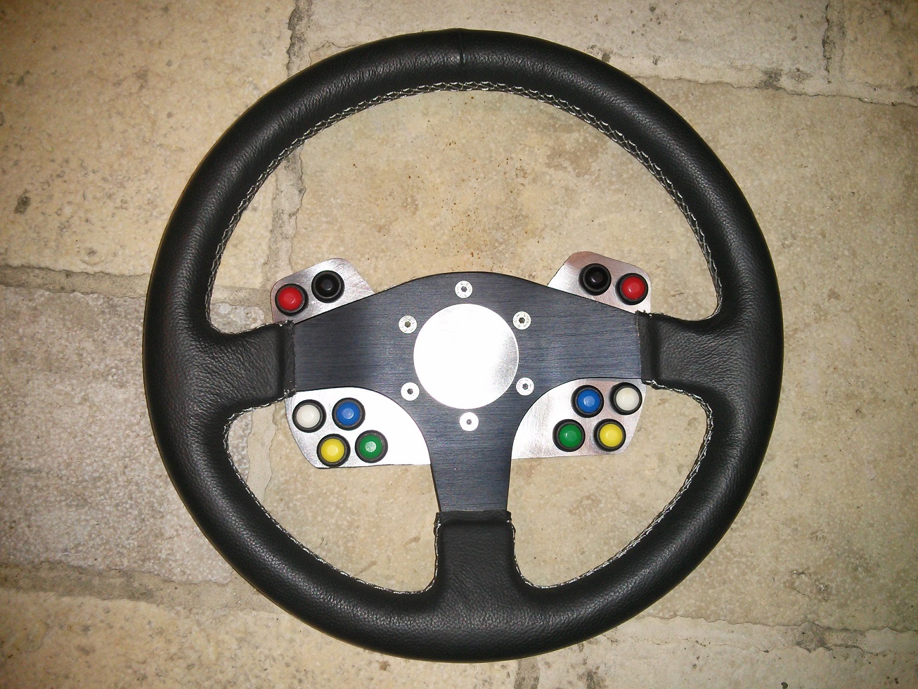

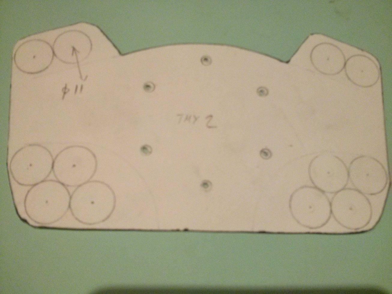

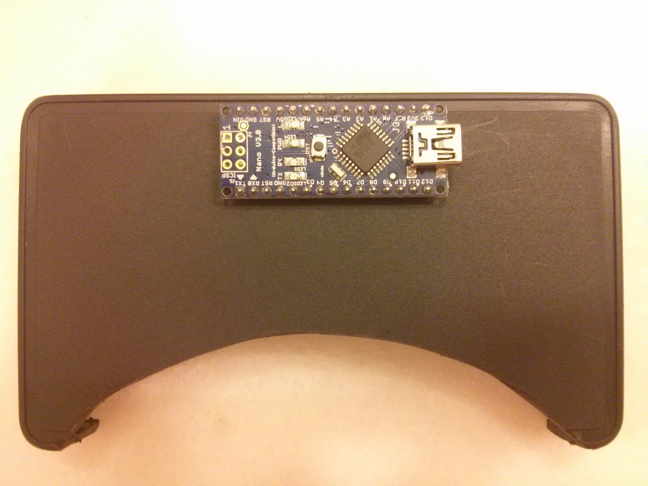

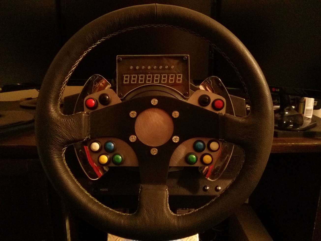

    I finaly had the time to finish my wheel button plate.
    Was an easy job.
    Some rough drawing...
    Some paperwork for fitting tests...
    A trip to the local workshop...
    Some drilling/sanding/brushing ... and voilà...
    when i get more time i ll paint the surface some matte black color...and start with the circuitry.
    Fitted...
    vs stock...
    The wheel is a 31cm (stock is 29cm) chinese knockoff from ebay (30 usd).
    Hand stitched fake leather...but...
    Very good value for money for a race sim.
  15. insanegr
    insanegr !N$@n€
    Jan 14, 2014
    503
    Athens
    16,724Coins
    +499 / 1 / -0
    nice wheel mod @pipis2015 . what's the diameter of the wheel?
  16. pipis2015
    pipis2015 over-boost
    Feb 18, 2015
    221
    Athens, GREECE
    10,248Coins
    +272 / 1 / -0
    The plate is 1,5mm thick.
    I think 1,0 mm would also be ok.

    i know its not that bigger than the stock one but does it have any difference in FFB perhaps some more clipping?
  18. pipis2015
    Feb 18, 2015
    221
    Athens, GREECE
    10,248Coins
    +272 / 1 / -0
    My early experience is this:
    1) The extra size-diameter (although only +2cm) makes for a nice difference in feel (Maybe a placebo?).
    2) The fake leather (which is also padded) feels better (and softer) than the oem rubber/plastic coating (I don’t use gloves so far).
    3) I didn’t feel any noticeable change in FFB.
