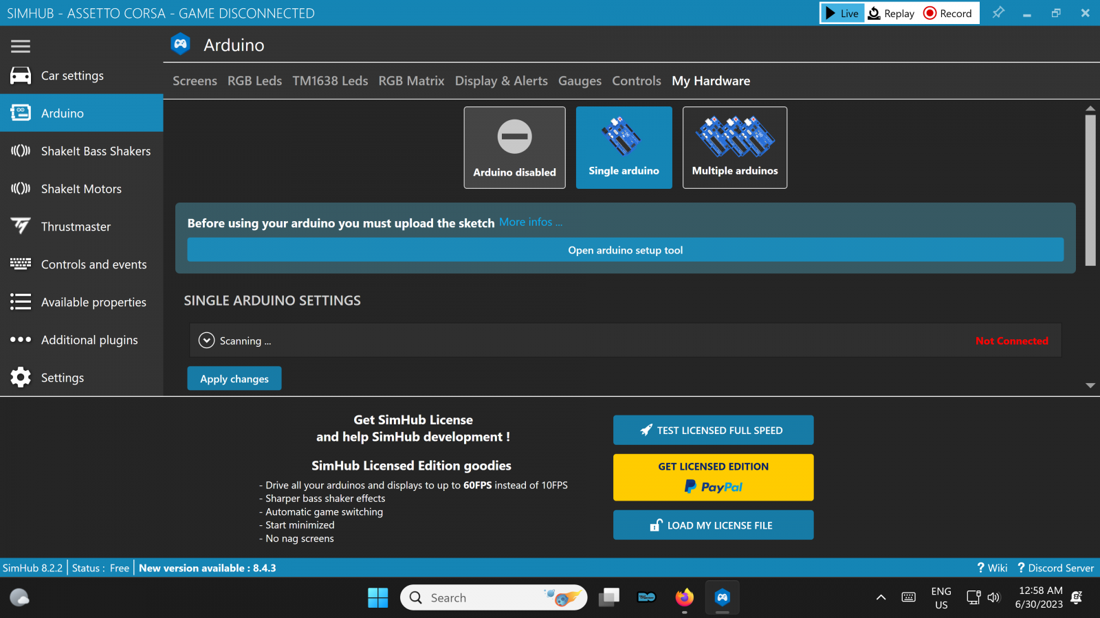

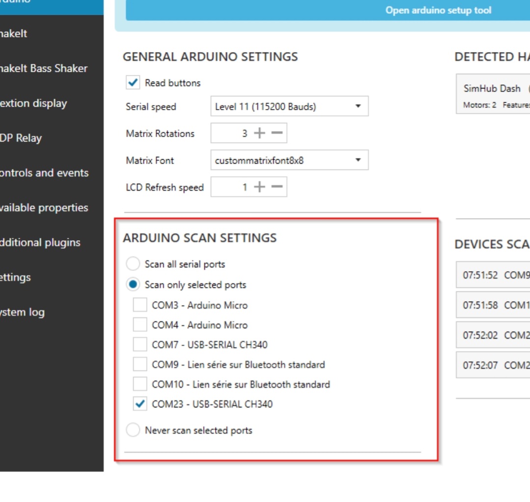

    disable arduino in simhub settings!

    go to simhub -adruino-my hardware and disable Arduino

    I tried it, but it didn't work It's a demo version now, so only LFS can be tested, so I'll try the DIY version again in a week

    Is this the right way?

    mine is different.

    Aren't you only setting Arduino connected to Simtool to be disconnected? Please explain in more detail.

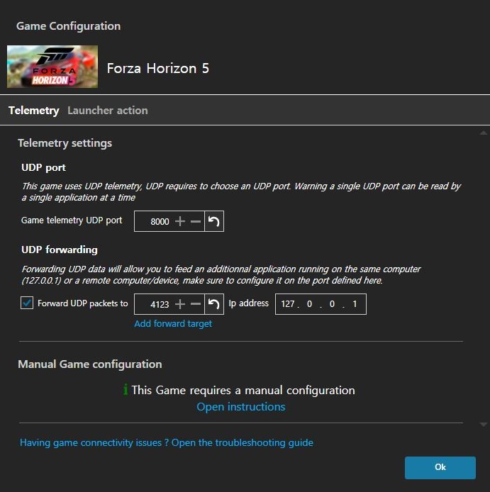

    Install the rear lamp::grin
    Port forwarding settings
    Test run
    I'm having a wonderful time
