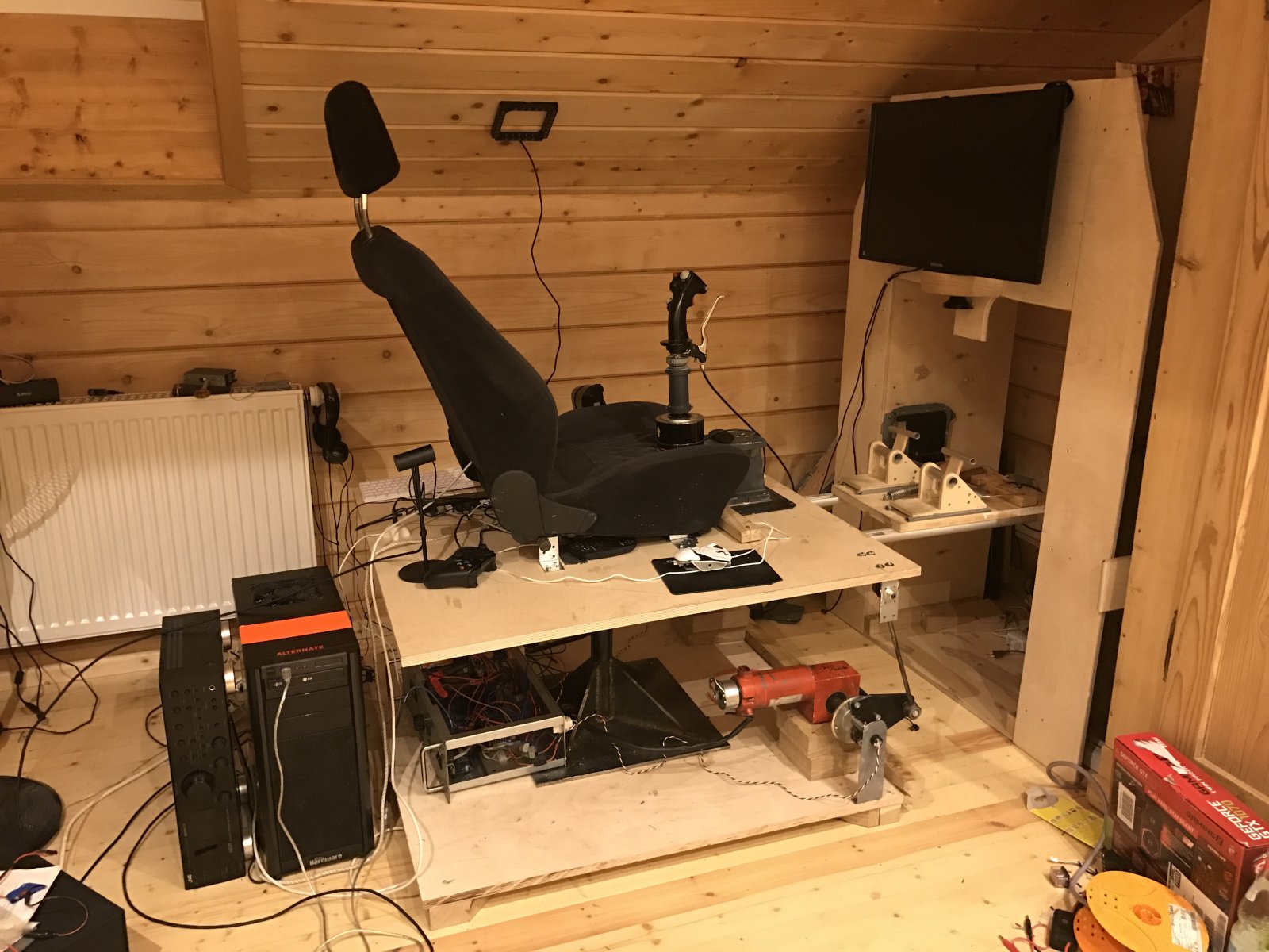

    Still no video but a quick feedback after the first longer flight and some tweaking:
    Regarding speed - I have had to turn down the power dramatically for flying, the hard g force Shakes doesn't give me a good feedback of what happened around me, it was just brutal and thrown me around on my seat, now it's much smoother and I can feel my banking (not in a turn) , positive g when pulling up or acceleration when pushing the throttle to the firewall.
    This helps me a lot in recognizing my attitude, especially in head down time for observing the radar or mfcd , for formation flying or in bad weather.
    So all in all , the bigger angel/less speed approach was the right for me.
    For driving I will need a faster shorter setting, that is right. But for flying this was what i wanted
    Remark: helicopter flying with rift and simpit is just pervert- 10 minutes till puke ;)

    The maximum angle is 15° in each direction, so 30° total - but moving 30° with full force is not a pleasure.
    Reducing power isn't the best term for it, but i turned my P parameter down and increased D to factor 4 to P in smc3, this gives me a slower less excessive movement. I have smoothing in simtools set to 20 on the heave function, it was necessary because by pushing down to negativ g after a pull up was way to hard. this surely would be better manageable on a real 3DOF platform .
    Hard maneuvers are still impressive but i do not fly acrobatics all the time. Surely, if i only had 4° which gave me the feeling of acceleration in a direction, i would miss the feeling of the attitude for precision flying.

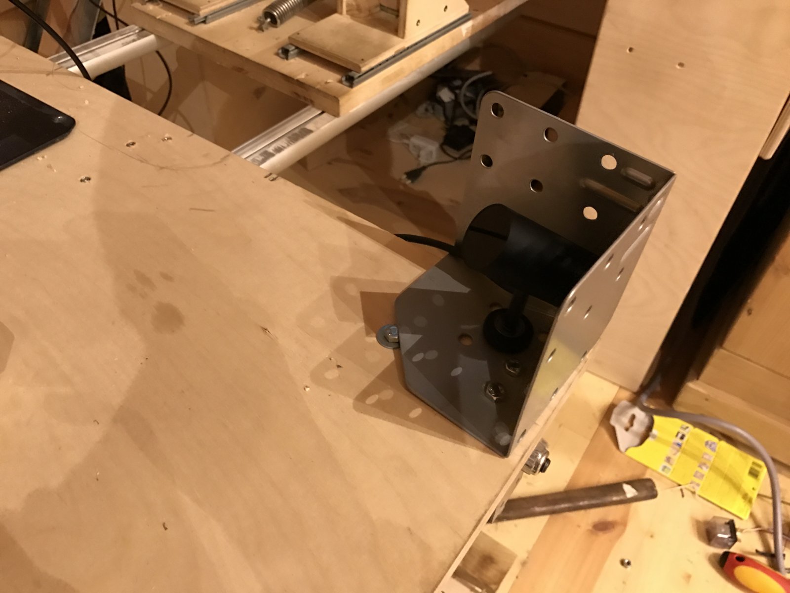

    Little update:
    Tidy up a little, changed sabertooth communication to packet serial, building box for the electronics, mount camera on platform- still much to do but it's absolutely usable at the moment

    Little video
    As you can see in the end, the right motor was pushed to the end limit and smc3 shutting it off, so the axis rotated back and down . But this little problem was solved by increasing the limits ;)
    Edit- the movement was reduced for racing- but for flying you need way more, in DCS I use the whole 15° in each direction
