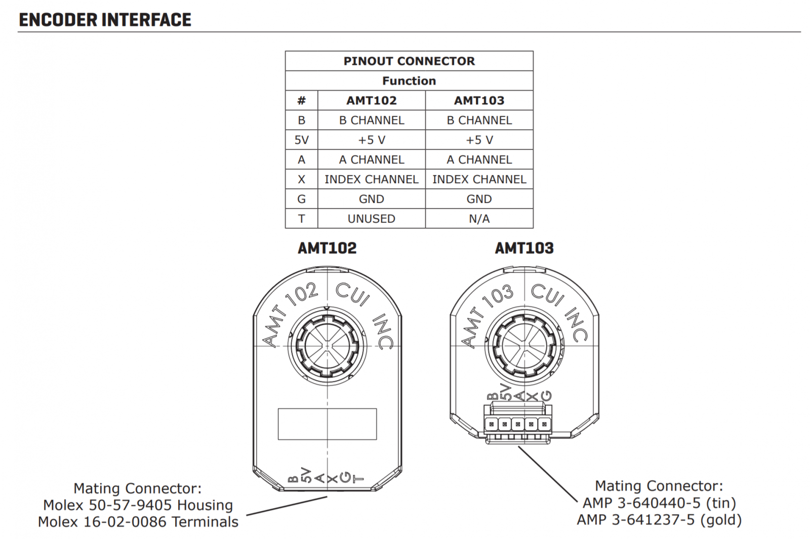

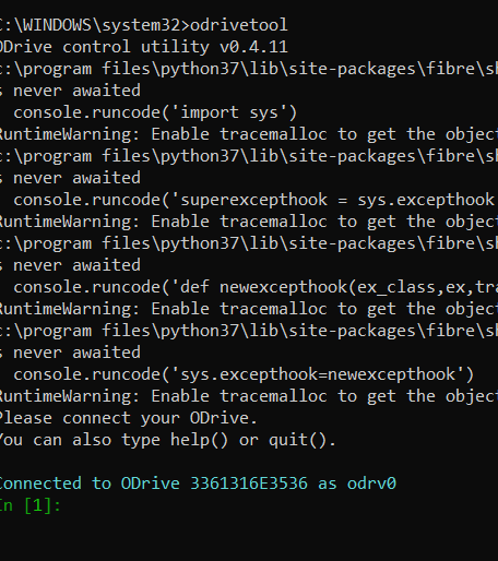

    • Python 3.7.1 installed and added to PATH
    • Python -m Pip install odrive (due to admin rights on windows 10 run cmd as admin)

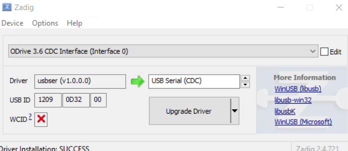

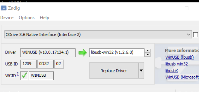

      The ZADIG TOOL http://zadig.akeo.ie/needs to be installed to ensure the USB drivers in windows is using the correct one for Odrive (here we can replace the existing interface drivers and set something which actually works..):
    • Use the Zadig utility to set ODrive driver to libusb-win32 (INTERFACE 2) Zadig config1.png
    • Check ‘List All Devices’ from the options menu, and select ‘ODrive 3.x Native Interface (Interface 2)’. With that selected in the device list choose ‘libusb-win32’ from the target driver list and then press the large ‘install driver’ button.
    For INTERFACE 0 - To be able to communicate to the Odrive via USB COM3; replace the winusb driver on Interface 0 with the USB serial CDC driver Zadig config2.png
    Run "odrivetool" and make sure it connects (WAIT 2 minutes!)
    It will use Interface 2 to connect there. From CMD: odrivetool + enter

    From datasheet AMT102-v:
    Resolution selected via adjustable DIP switch, pre-set to 2048 PPR. All resolutions are listed as pre-quadrature, meaning the final number of counts is PPR x 4, so in odrive:
    Again; no change is required, the encoder max steps will be 8192 (PPR x 4) so it is OK!
    Let us try to check on the position control
    Result: Motor spins in a calibration setup after a beeping sound.
    This procedure first measures your motor’s electrical properties (namely phase resistance and phase inductance) and then the offset between the motor’s electrical phase and the encoder position.
    odrv0.axis0.requested_state = AXIS_STATE_CLOSED_LOOP_CONTROL Enter. From now on the ODrive will try to hold the motor’s position. If you try to turn it by hand, it will fight you gently. That is unless you bump up odrv0.axis0.motor.config.current_lim, in which case it will fight you more fiercely. If the motor begins to vibrate either immediately or after being disturbed you will need to lower the controller gains.

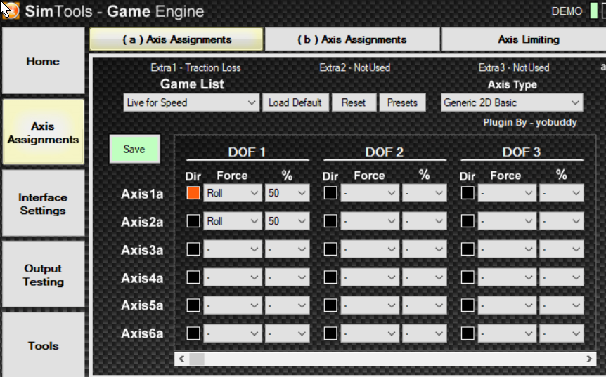

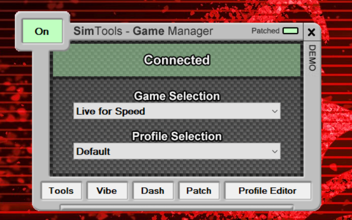

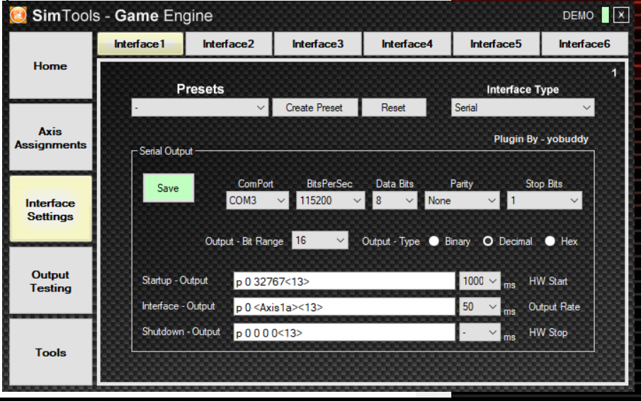

    SimTools:
    - Installed Live For Speed
    - Ran GameManager, patched up LiveForSpeed
    - Connected to COM3 using Interface 0 and the USB Serial CDC.
    Select game profile, patch the game.
    Assign some axis setup. Testing only motor for Roll movement first.
    Setup communication.

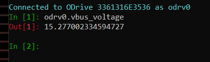

    More exiting news to come. The motor works at least! Running only 15V for test purposes, but working OK.

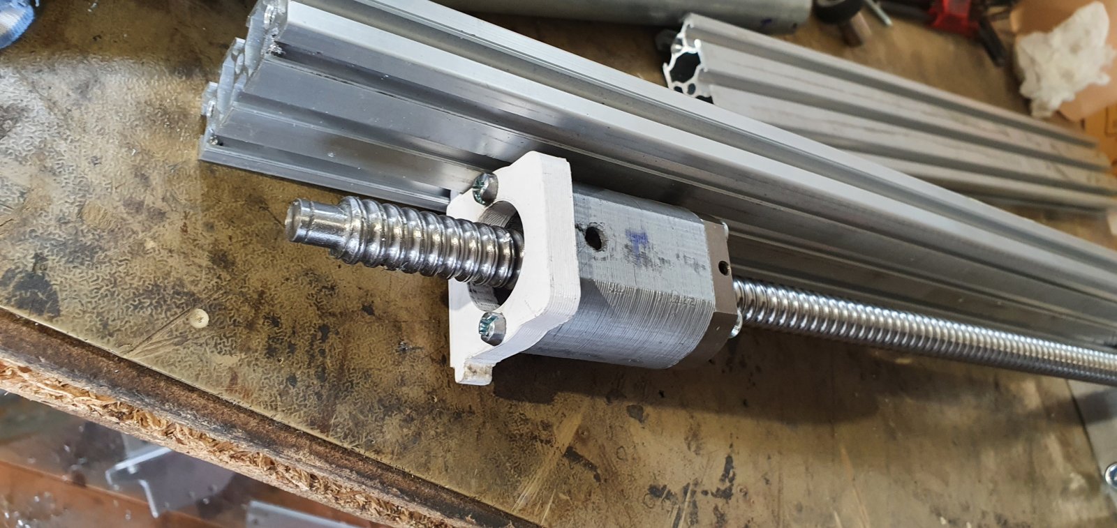

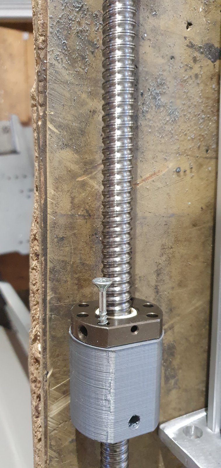

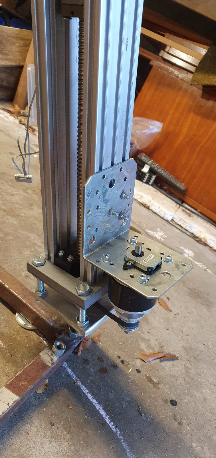

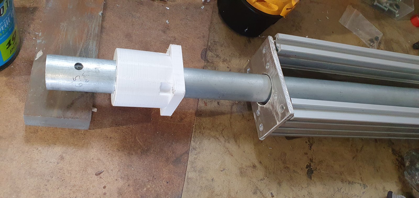

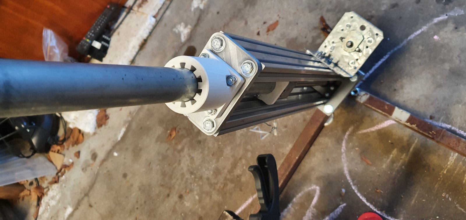

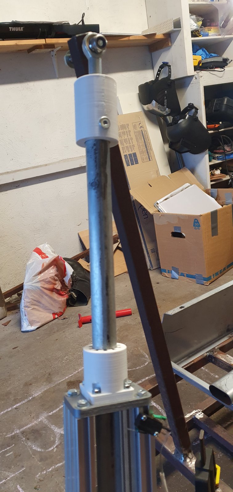

    Finally. Time for an update! This project has not been prioritized a lot so it has come together really slowly. I now have the basic upper and lower frame ready for initial tests and currently working on getting the second linear actuator built. Earlier in this project (late 2019 and early 2020) I had most of the work on the frame done and the first actuator built. Also I have put together the power supply for the motors, using three 12V 1200W HP server power supplies. I did some simple tests as posted in 2019 with the brushless motors, but that was with a different power supply. What happened when testing with the 36V supply (3 x 12V) was a ground loop via the USB cable of my computer. That put the project on hold for months and left me in need for replacing the computer. Going back to the project this year, I solved the ground loop issue using an USB-isolator. Turns out that the Odrive board was fried in the ground loop incident, so I had to order a new one (expensive!). So far putting together the actuators has proved to be the most difficult task in this project. Still some bits and pieces for the limit switches and possibly some rubber end-stop parts will be added but it is now all starting to come together. Enclosed some photos, enjoy, happy building and I can post some details when I have time
    . 20210717_204354.jpg Actuator 1 bottom end motor and mount.jpg Actuator 1 glider bearing top end.jpg Actuator 1 motor with sensor assy.jpg Actuator 1 top end joint.jpg Actuator 2 ball screw assy.jpg Actuator 2 ballscrew mount.jpg Actuator 2 bottom end in progress.jpg Actuator 2 top end.jpg Actuator 2 top internal with bushing.jpg Frame rear top view.jpg Frame top view.jpg

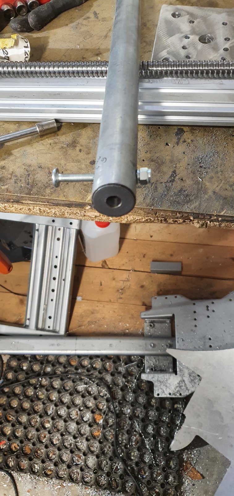

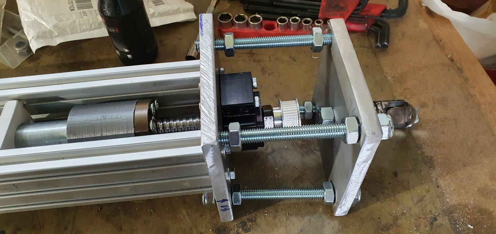

    Hello! After a long break (fried mainboard and Odrive due to ground loop, COVID, work and kids), finally some vacation and time off, so I am working with the project (with one of my sons as a helping hand). :)

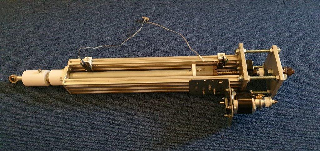

    Actuators:
    I have just about completed both actuators (some pinching in the movement on one of them, so need to do some re-alignment). I recently made some brackets for the limit switches, so these are now mounted and ready for testing. I have also replaced the end plates on the actuator which was originally 3D-printed, with new aluminium ones.
    Wiring for the actuators will then be:
    1. Motor power cables to the Odrive control unit Output power section
    2. Encoder signal cable to the Odrive control unit encoder input I/Os
    3. Limit switch cables to the Odrive control unit GPIOs

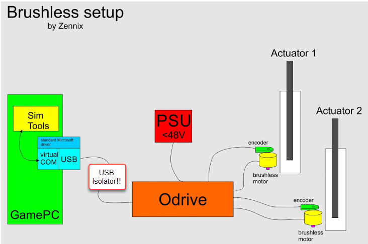

    Odrive and motor control:
    I purchased a new Odrive board after I fried the first one with a ground loop (floating DC supplies and grounding via USB without isolator). I purchased an USB isolator(! Use between Odrive and PC!) so when I got a replacement board, I could connect without problems. I struggled a lot with the replacement card as this would just trip on motor current limit. After a lot of trial and error, and after flashing firmware, I did another mistake, forgetting to reconnect the USB isolator, and fried board count = 2 (!!). Thinking, "this is it, I will not finish this project", I contacted OdriveRobotics explaining the situation. Due to my effort and details shared with OdriveRobotics support with configuring the second board, an agreement was made to send a replacement board for the cost of shipping & taxes only :) I made also a backup plan this time and ordered a "MakerBase" Odrive 3.6 clone. I have tested now running motors on both original and clone board, works fine.

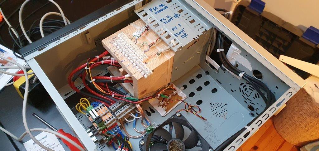

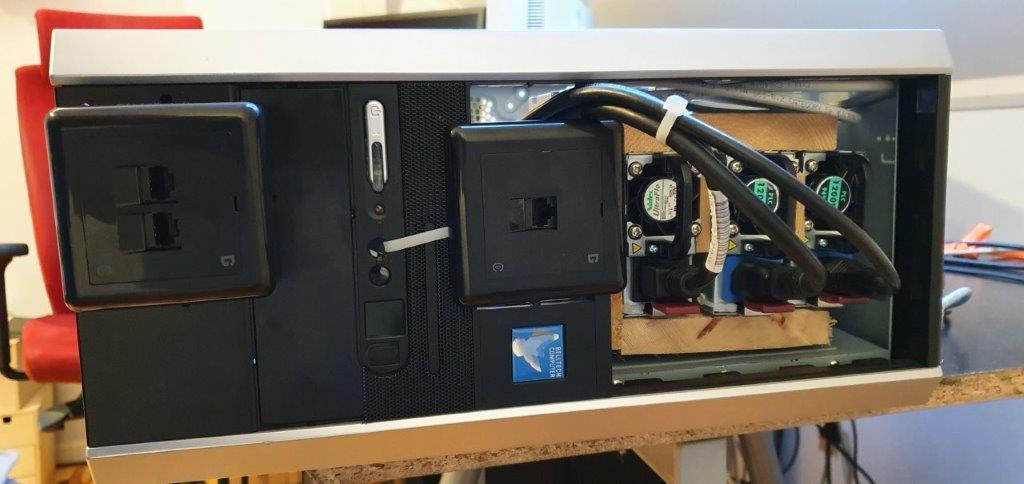

    Power supplies and control cabinet:
    I added relays for emergency stop button to cut 230V power. The relay coils are triggered with 24VDC via the stop button. Connecting this now. I did some clean-up on 230V supply to the PSUs. I was looking for a decent way to connect signal wires between equipment and at the same time easily disconnect. I chose RJ45 wall sockets and CAT5 cabling. Using the pairs I need and keeping other pairs as spare.
    Some pictures attached showing some of the work. More to come, soon I hope.
    2022-07-26_22-33-40 - Odrive with isolator.png 20220726_Actuator 2 assembled.jpg 20220726_Control box content 2.jpg 20220726_Control box front panel.jpg

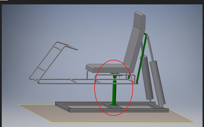

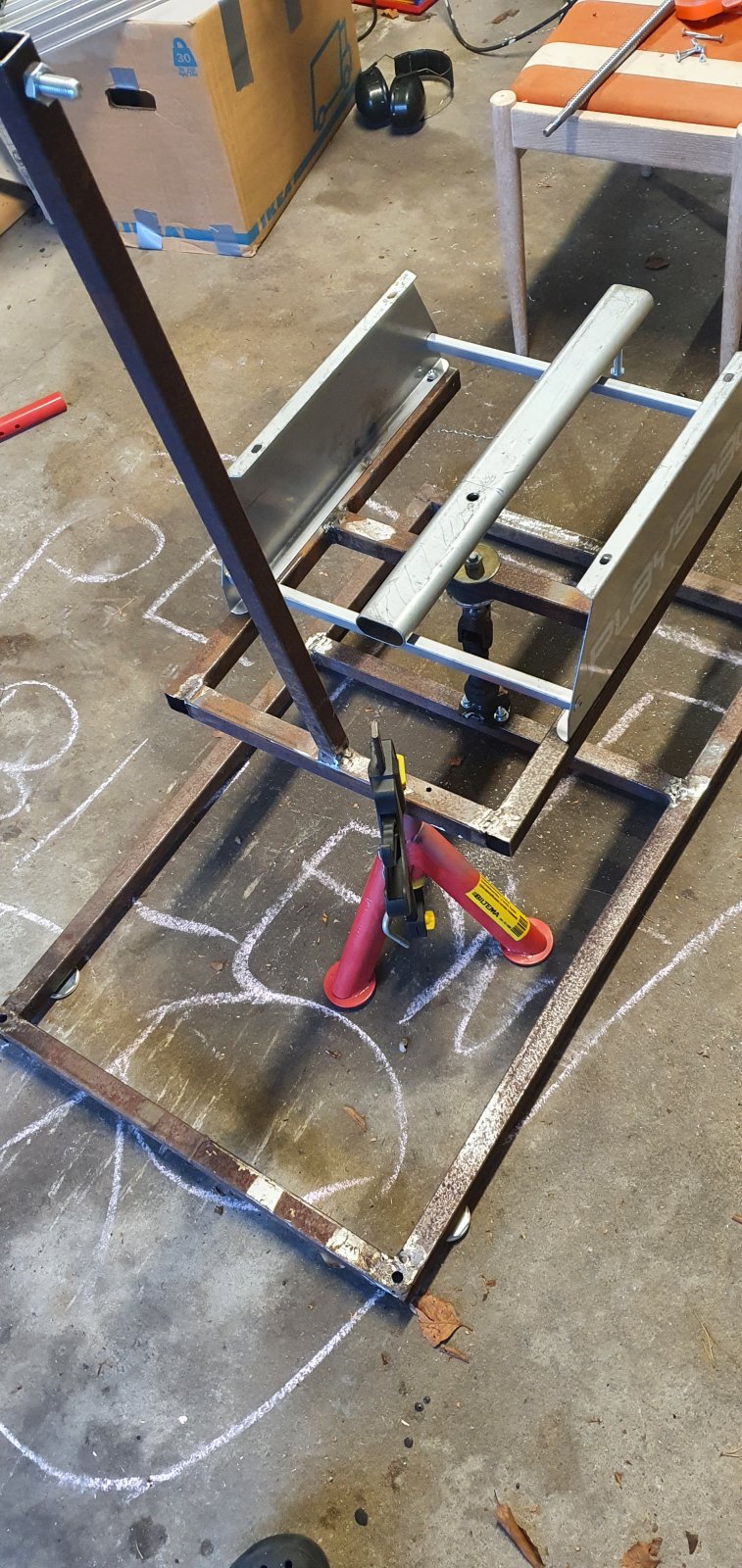

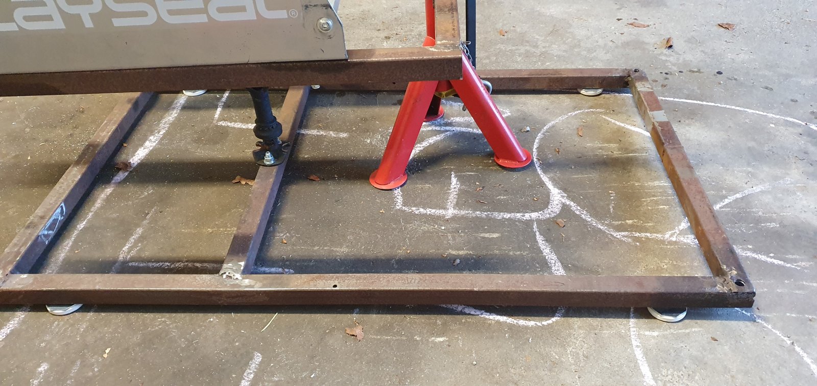

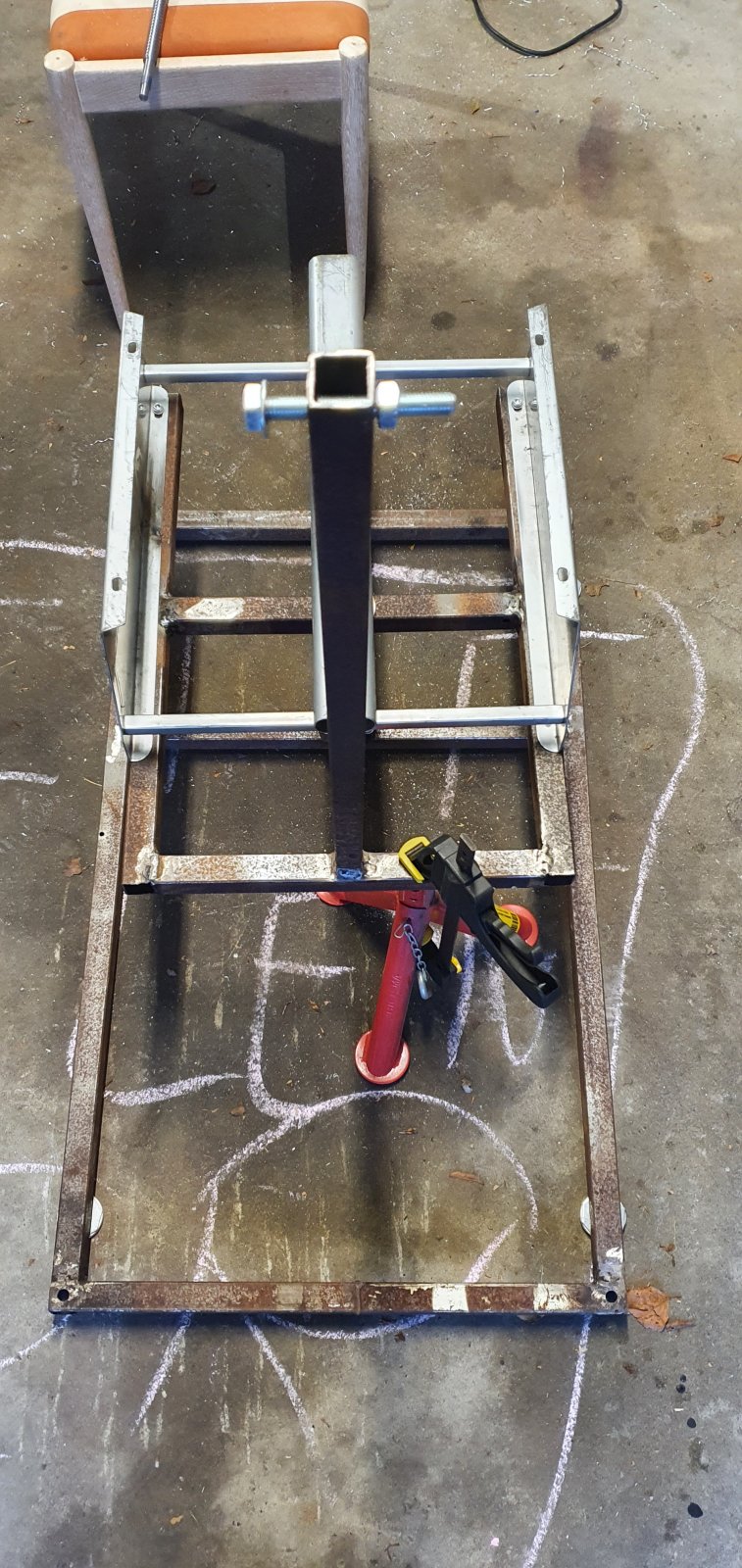

    Summer holidays and "busy" with vacation, but during holidays I managed to find a stronger joint for the coupling between lower frame and upper frame, so will do some welding shortly and use that instead of the old steering wheel coupling joint. I did the configuration on the Odrive for the limit switches and initial test, but I need to check why the logic is not reading the input correctly. I think it is correct in config and I measured the voltage across pull-up circuit when toggling the switches, so should be OK. On the side line I tested a full motion sim with the kids,https://newtonflightacademy.com/, More to come soon on the build.

    Quick update, I moved the Centre of Gravity on the rig 10cm forward (a bit of welding..) and now the rig balances much better. I am working on noise reduction (EMI) on the Odrive cabling, and added the ferrite core on the motor wires plus braided the motor wiring. Seems to work better. I now run the motor wires twice around the ferrite core which seems to be better. Still a bit of noise probably on the encoder wiring that causes the index search to fail sometimes on the encoder. To be investigated/improved. Moving further now with testing with the SimTools and FlyPTMover.
