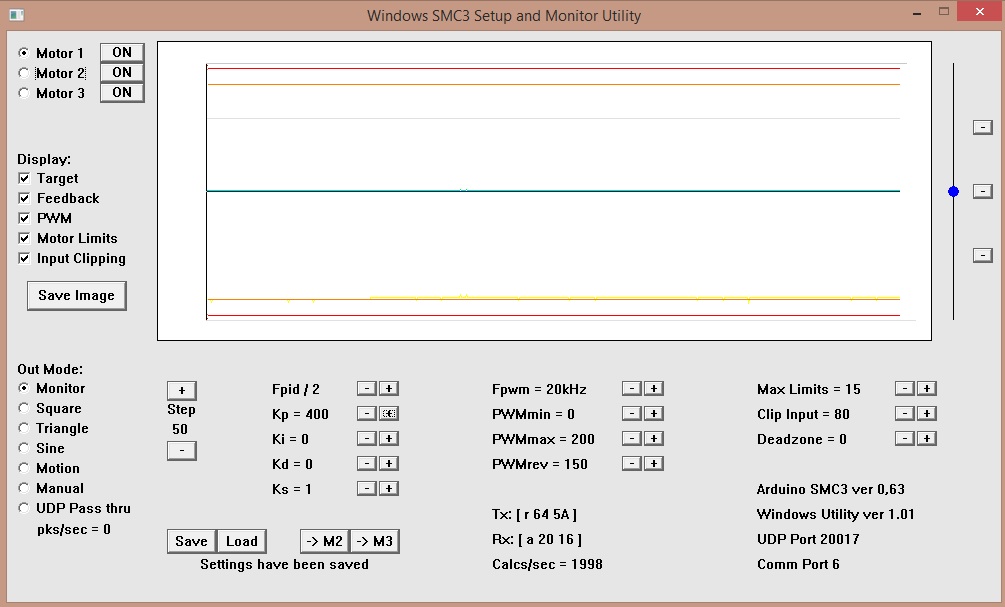

    Yeah!, and they are feeded with less than 12v as SMC3 settings:
    Maybe, it would be nice to see the car jacks added to the faq as another motor alternative to the wipers.
