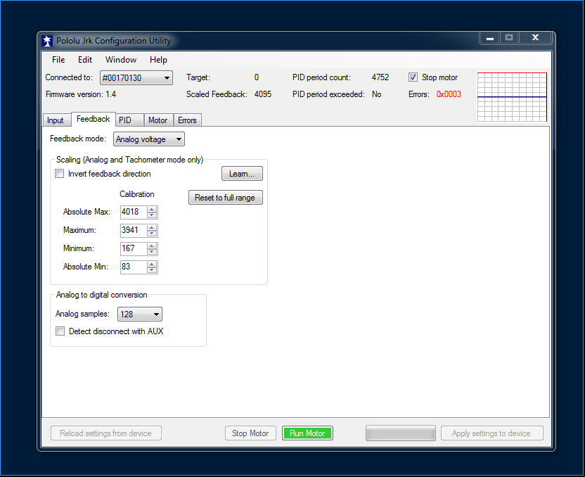

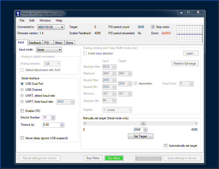

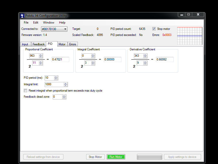

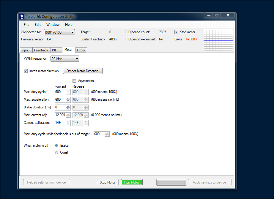

    here some screenshots of the JRK configuration, the only thing i touch was the PID parameters and feedback, the acceleration was with no limit as well as the duty cycle

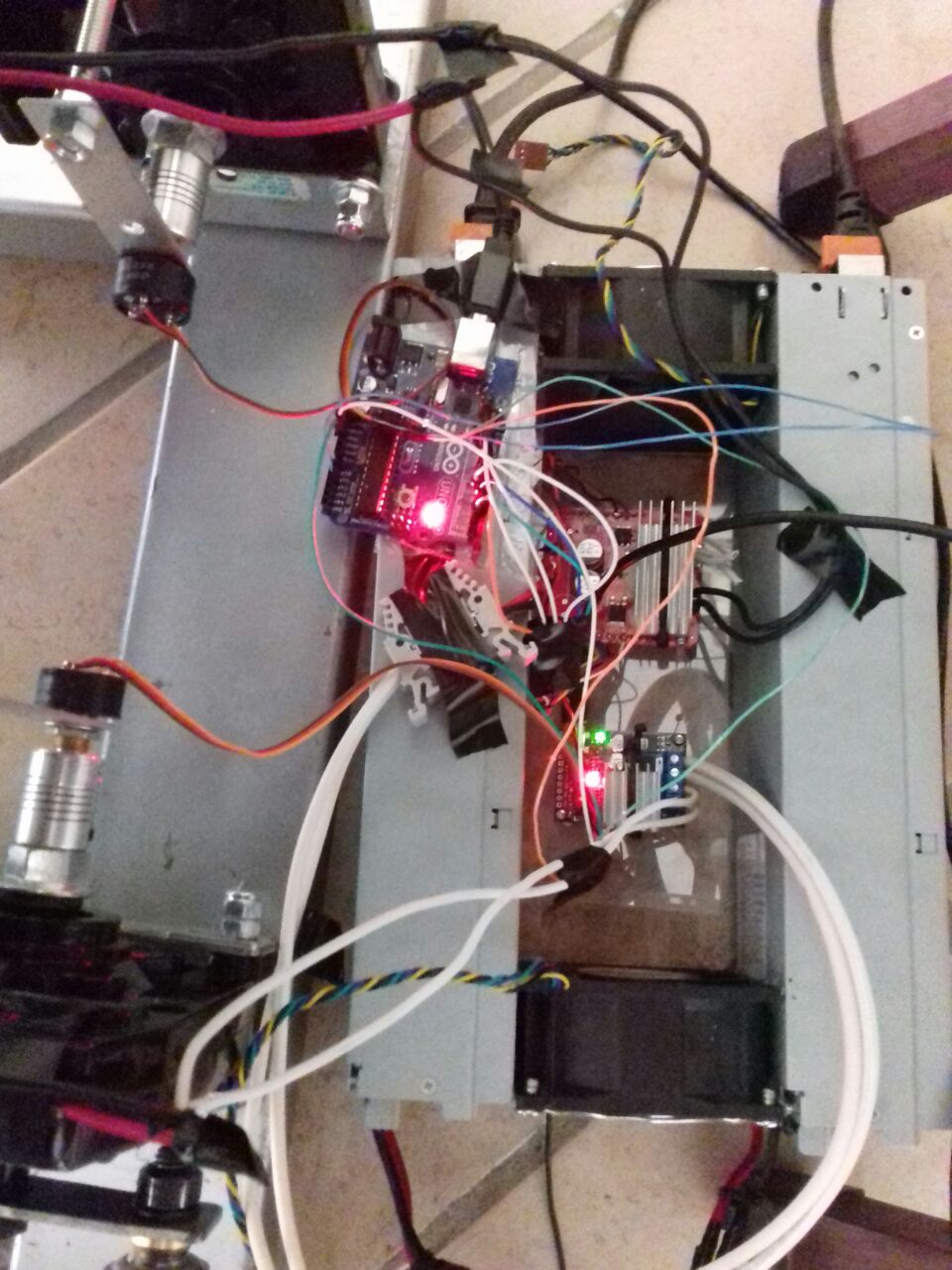

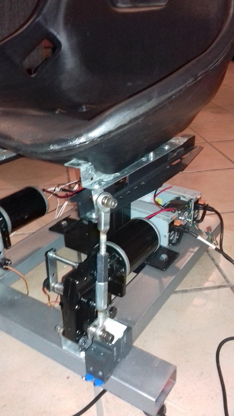

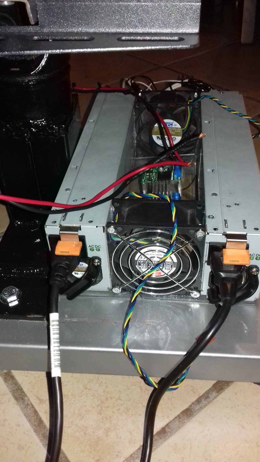

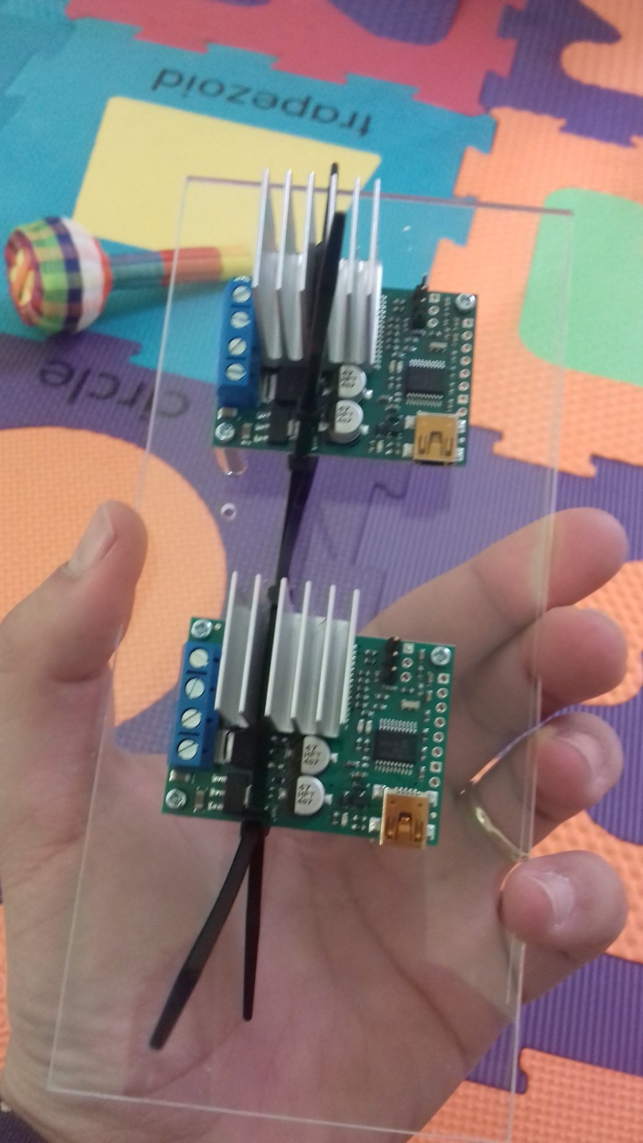

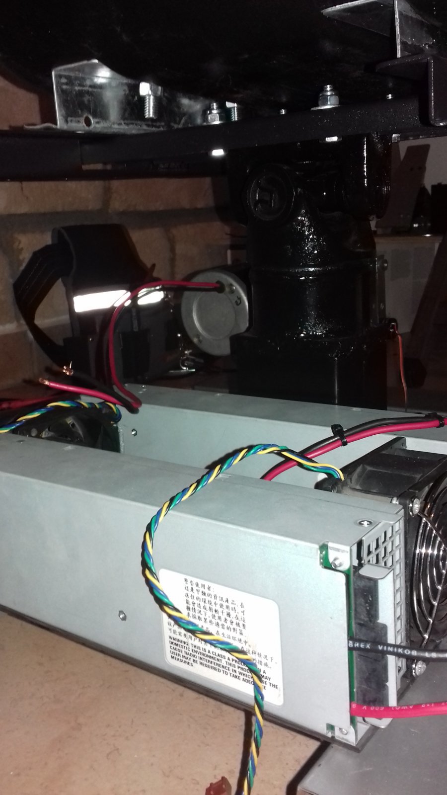

    here some photos of the installation, the idea was making a tunnel between the PSUs and one fan blowing at the inlet and the other at the outlet extracting and then everything covered with plexiglass (same i used for the JRKs base as it is shown in a picture above)
    I do not have pictures of the wiring, since I disconnected the JRKs but the servo connector that is soldered to the pots is directly connected to the JRK and the positive terminal to Vim GND to GND and the motor to the A and B terminals. 20170125_205636.jpg 20170125_205924.jpg 20170125_205650.jpg 20170125_205826.jpg

    @noorbeast I had the heatsink mounted when I run the JRKs, even with the heatsink one of the JRKs got burned in no time... and the seat was detached so the motor had no load at that moment, so i am still trying to figure out what is wrong... 20170122_100529.jpg
    22,183
    154,720Coins
    +11,193 / 57 / -2
    If you burnt a JRK out with no load then you have wires crossed or a short.
    My mistake re heatsinks, I was looking at this recent photo where there was no heatsink:

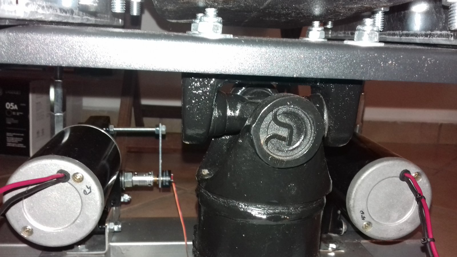

    And it is finally moving!!
    One motor is working with the JRK that is still alive and the other with arduino and a MM board
    thanks a lot @noorbeast and @ferlash for your help!

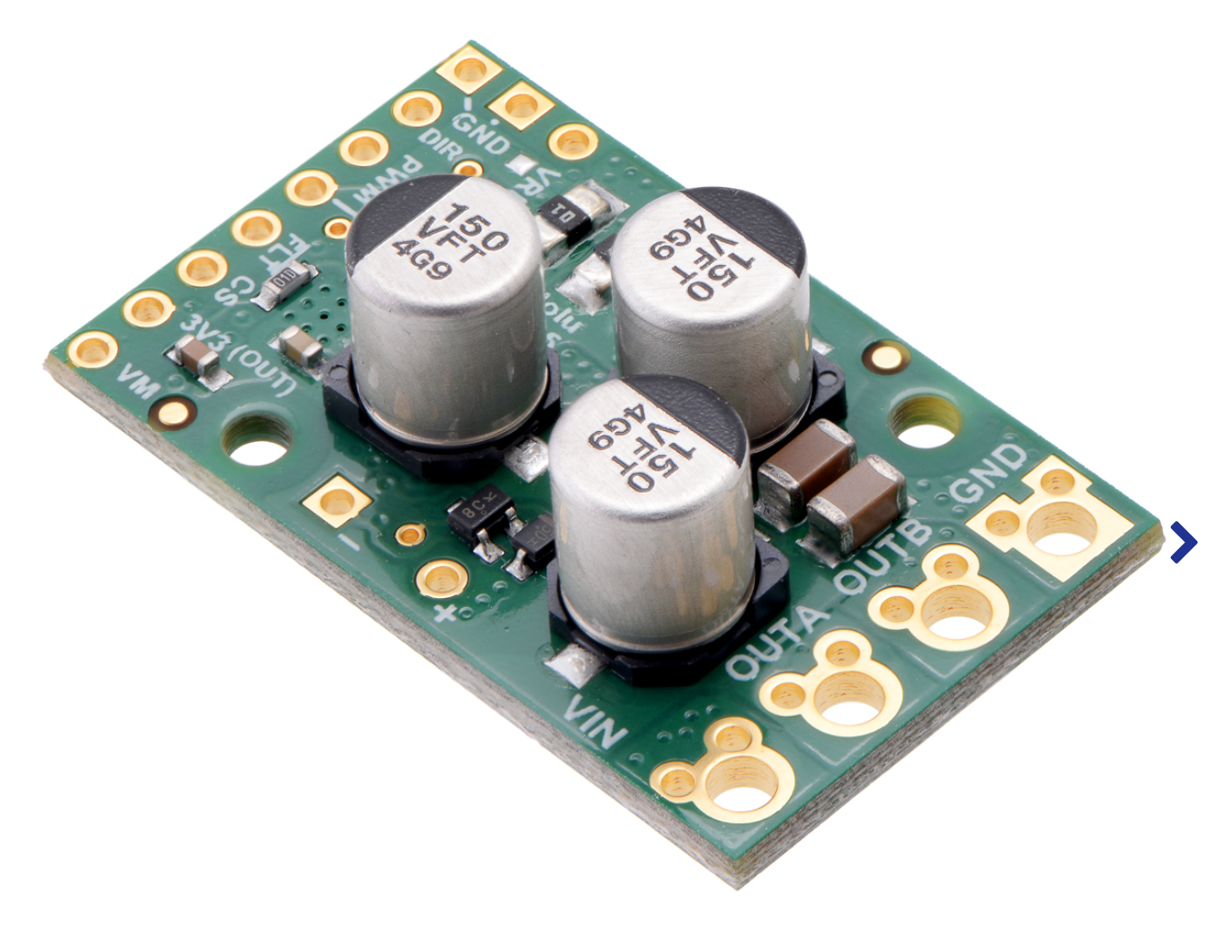

    Hi everyone,
    After burning a couple of Chinese MM now I am using this motor divers form POLOLU and they seem to be powerful plus no heatsink is needed
    https://www.pololu.com/product/2994

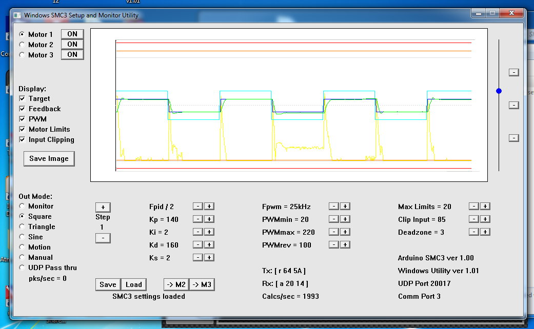

    Hi again,
    I am refining the movements on my sim, here is an screen shoot of the PID configuration, seem that I have still a bit of overshooting but it is no noticeable and feels good to me. I don know if could feel better since I have not found a way to eliminate it. Any suggestions?
