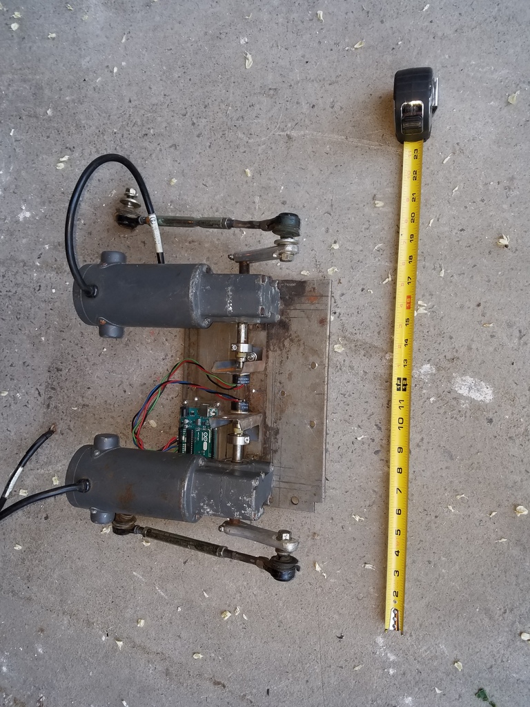

    Ok I need to rethink something. Chair moves great. Can't handle weight. Power supply keeps tripping. I'm gonna make a short arm and try that. It is a used power supply, kinda questioning as it's supposed to be 600 watt and one motor is tripping it. Batteries may be in my future, or a giant capacitor bank, I have those.
  4. matthew loomis
    matthew loomis Member
    May 18, 2017
    94
    rochester,ny
    603Coins
    +82 / 0 / -0
    Ok changed arms to 1.5"ctc now everything works. I can "ride" the motion sim in the smc3 tuner. And i can move the wheel arm to the forward position, had to move the seat up a click for cg.

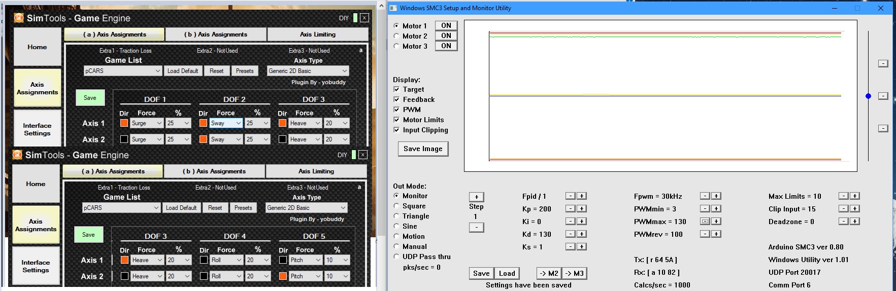

    Ok I'm going to share my SMC3 pid settings and sim tools settings here. I'm open to suggestions, most of the posts are for jrks and such and are quite different. I'll leave these here to show how they changed to fix the problems
    Fpid/1
    Kp 260
    Ki 0
    Kd 210
    Ks 1
    Pwmmin 5,3
    Pwmmax 134
    Pmwrev 0
    Dead zone 1
    These settings are pretty harsh. It needs to smooth out a bunch. Occasional short oscillation with empty seat with big step change but so far good with a rider. Graph shows almost no overshoot and a very very close green blue.
    And here are my current Sim tools settings for project cars.
    Pitch and roll are switched up somewhere. It works this way but is screwey.
    Axis a1. Axis b2
    Roll 60. 60
    Pitch i60. 60
    Heave i40. I40
    Surge i40. I40
    My roll and gear shift are great, can't seem to get a good lean back for acceleration, and curbs are too harsh.

    ok Gonna share my new settings here. I like these a lot. only recentered surge.
    PID
    Fpid / 1
    Kp = 210
    Ki = 1
    Kd = 130
    Ks=1
    Fpwm = 30
    PWMmin = 4
    PWMmax = 130
    PWMrev = 0
    Deadzone = 0
    Axis Assignments I = inverted i = not
    Surge Ii = 25 1/-1.3 m/m
    Sway ii= 40 3.1 m/m
    Heave Ii = 20 1.2 m/m
    Roll ii= 10 4 m/m
    Pitch iI= 20 5.5 m/m
  18. matthew loomis
    May 18, 2017
    94
    rochester,ny
    603Coins
    +82 / 0 / -0
    got some setup tips from the video, gonna share here. pitch and roll are still swapped but again it works this way. (Edit. One of these motors is inverted. As the graph shows this is bottom for this motor. I need to switch the polarity on a sensor)
  19. noorbeast
    22,185
    154,750Coins
    +11,196 / 57 / -2
    From the looks of those settings one motor is turning the opposite to what it should, so you may want to fix your wiring then Dir settings in Axis Assignments.
