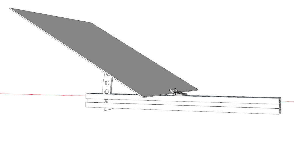

  7. RandomCoder
    Feb 19, 2017
    185
    Control Engineer
    UK
    1,674Coins
    +143 / 0 / -0
    Hi @mirkobastianini
    You've slightly missed my point. I wasn't suggesting to buy and adapt the bracket that I linked, but rather use the same principle with your aluminium extrusion. Just fit index plungers to locate into pre-drilled holes allowing you to easily set the pedal plate angle as required.

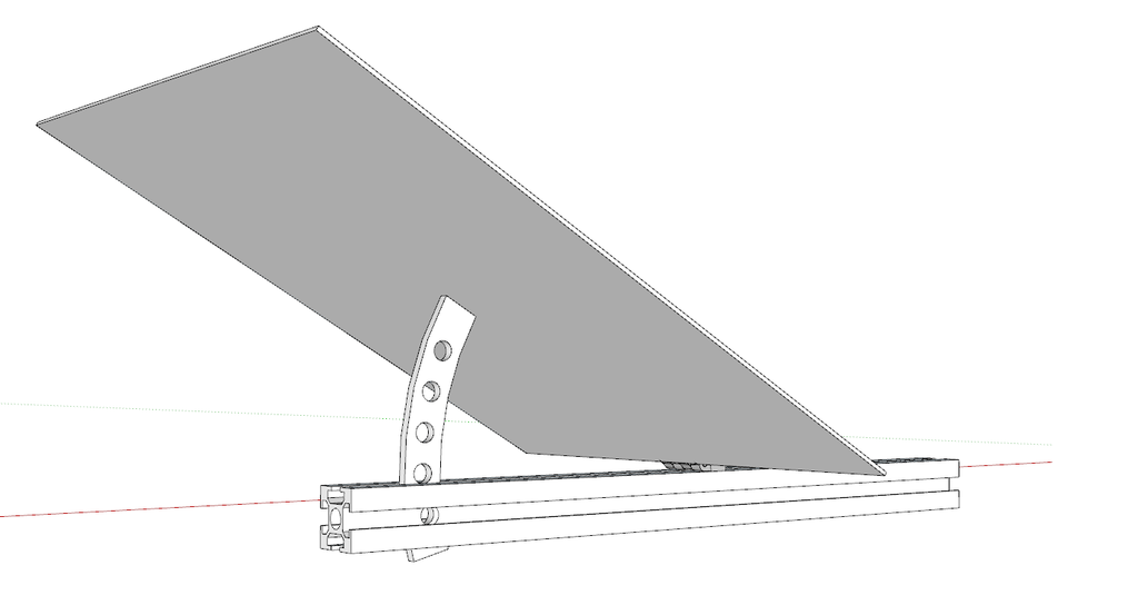

    @mirkobastianini I'm still learning to use SketchUp but here is what I had in mind if wanting to keep with the central pivot you already have....
    And from another perspective....
    I've not shown the locking pin in the diagram but for this I was thinking of something very quick and convenient like an index plunger...
    This design is more easily achieved if using an aluminium channel at each side of the pedal plate as shown in one of the previous posts. But hopefully you can see from the above that it is still possible to achieve if using a central strut and pivot.

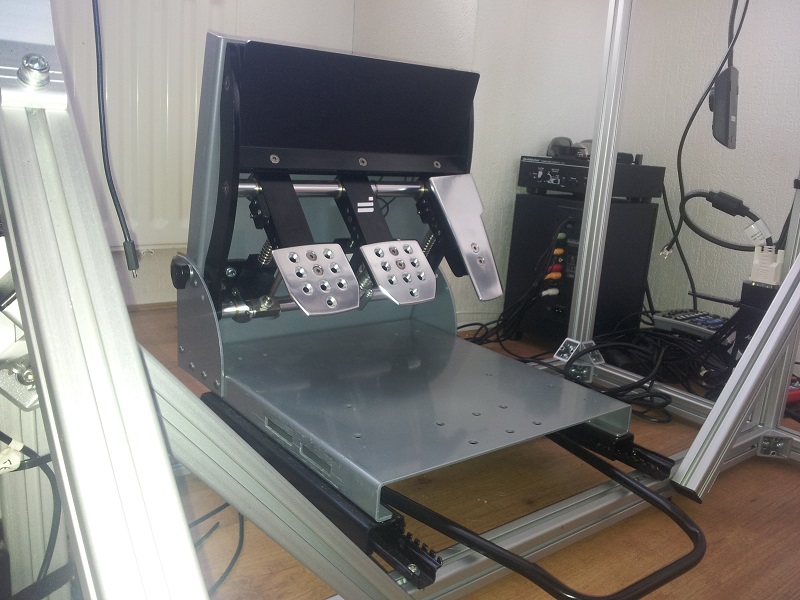

    Uff... this weekend passed away and I haven't worked to my simulator (i've changed my room...my house wants my blood :D), So in this incoming week I will try to make the order for 30x30 profiles.
    Anyway, I think this night I've found a beautiful piece that can be very useful for give a angle to pedal plate...this is the piece:
    http://www.motedis.it/shop/Accessor...serie-20-30-tagliata-al-laser::999993849.html
    And this is the working video:
    what do you think @RandomCoder and @noorbeast ?;)

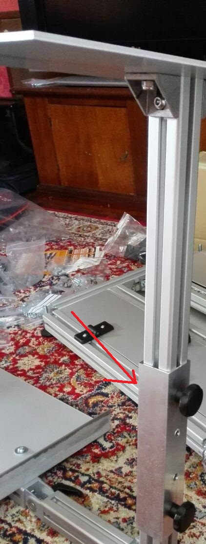

    Anyway, talking about something else, what do you think about my idea (photo attached at this post) to make base for steering wheel and pedal adaptable to different heights? It's a good choice? Because I don't how much this solution can be resistant.
    Or I can think to something different with this plate (I attach links) ?
    http://www.motedis.it/shop/Accessor...a-T-118x118-tagliate-al-laser::999993917.html
    http://www.motedis.it/shop/Accessor...nector-plate-120x70-Laser-cut::999995037.html
    http://www.motedis.it/shop/Accessor...88-tagliate-al-laser-serie-30::999993916.html
      File size:
      142.5 KB
      Views:
      606
  13. RandomCoder
    Feb 19, 2017
    185
    Control Engineer
    UK
    1,674Coins
    +143 / 0 / -0
    I like the height adjuster but I'm not so sure about the pedal angle bracket. Would it give enough angle adjustment and could you secure it tight enough with wing nuts or thumb screws as I'm guessing that you wouldn't want to use Allen keys each time to adjust the angle.

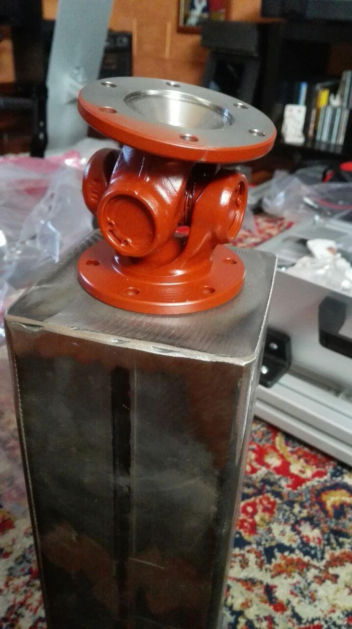

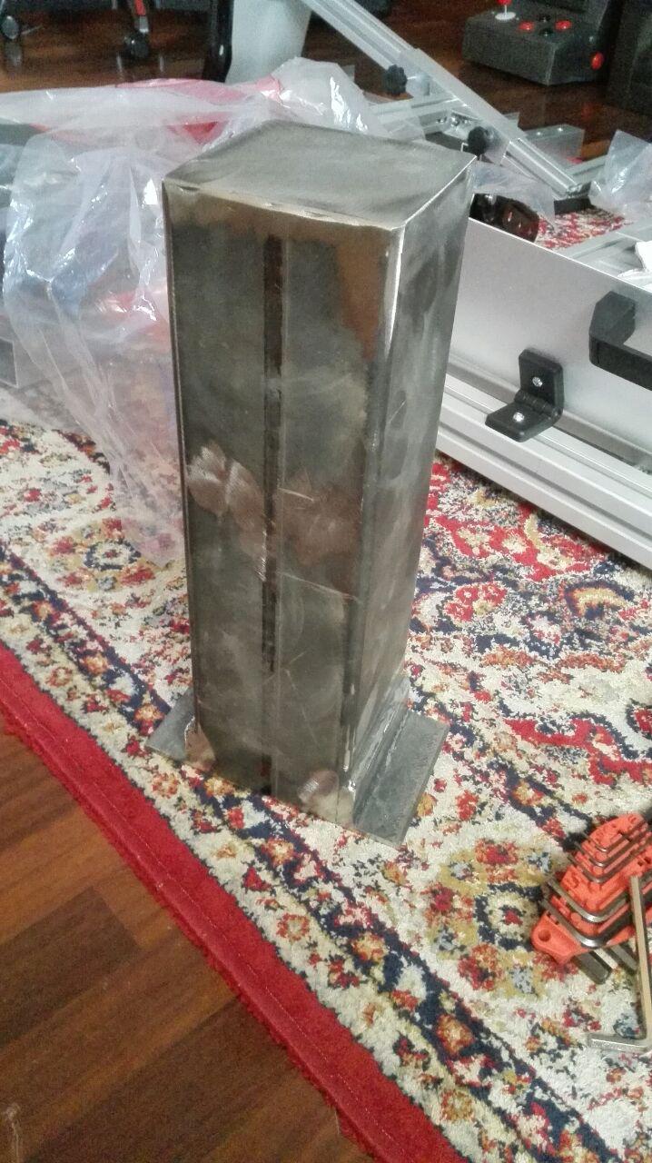

    Little bit update... today i've received Universal joint (it's very beautiful <3) and I've made the base for it. The measure of joint's base are 10cmx10cmx35cm. The pivot is 7,5cm, so the overall height is 42,5 cm.
    Now, while I'm waiting my orders to remake the structure for pedal and steering wheel, I can think about electronics part and motors... So, I ask your help.
    It's possible to have a design like the photo called "Immagine" in this post? I know that it's not in scale (in fact i've written measures on an existed photo finded on this forum). If I can, I want to place motor little back under the seat, and use the holes of seat. Anyway, I don't know nothing about CTC, levers, optimal angles, ecc, so if anybody can give to me any help or advice, or sintetic guide, i'm really happy :)
    For now, I'm sure that I want to use 2 JRK, so if somebody has advice about motors, it's appreciated
