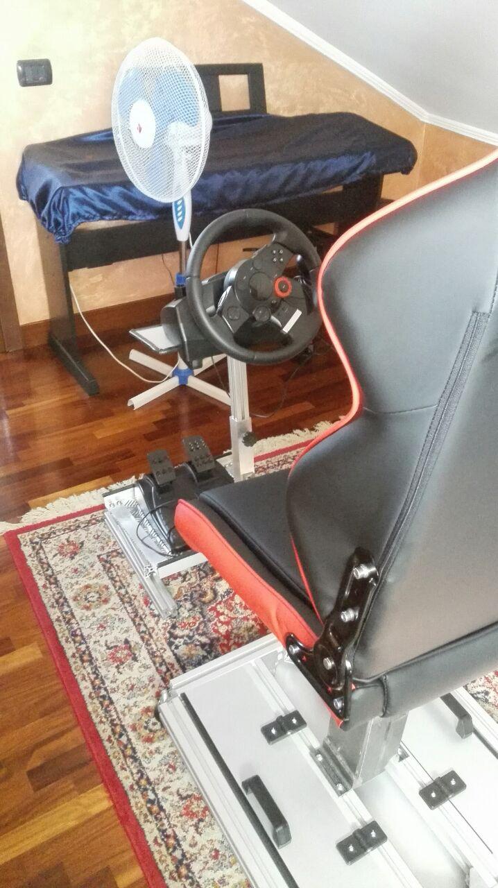

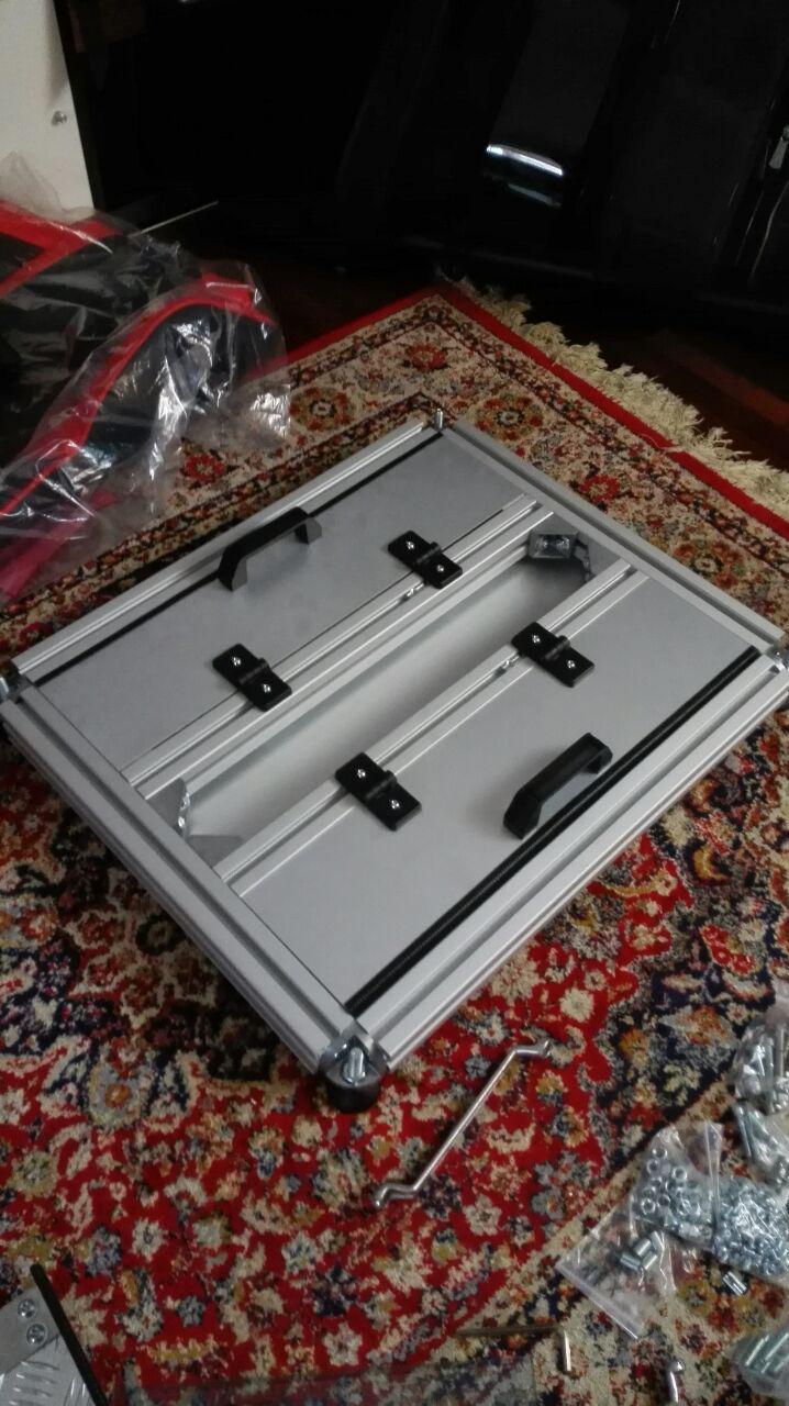

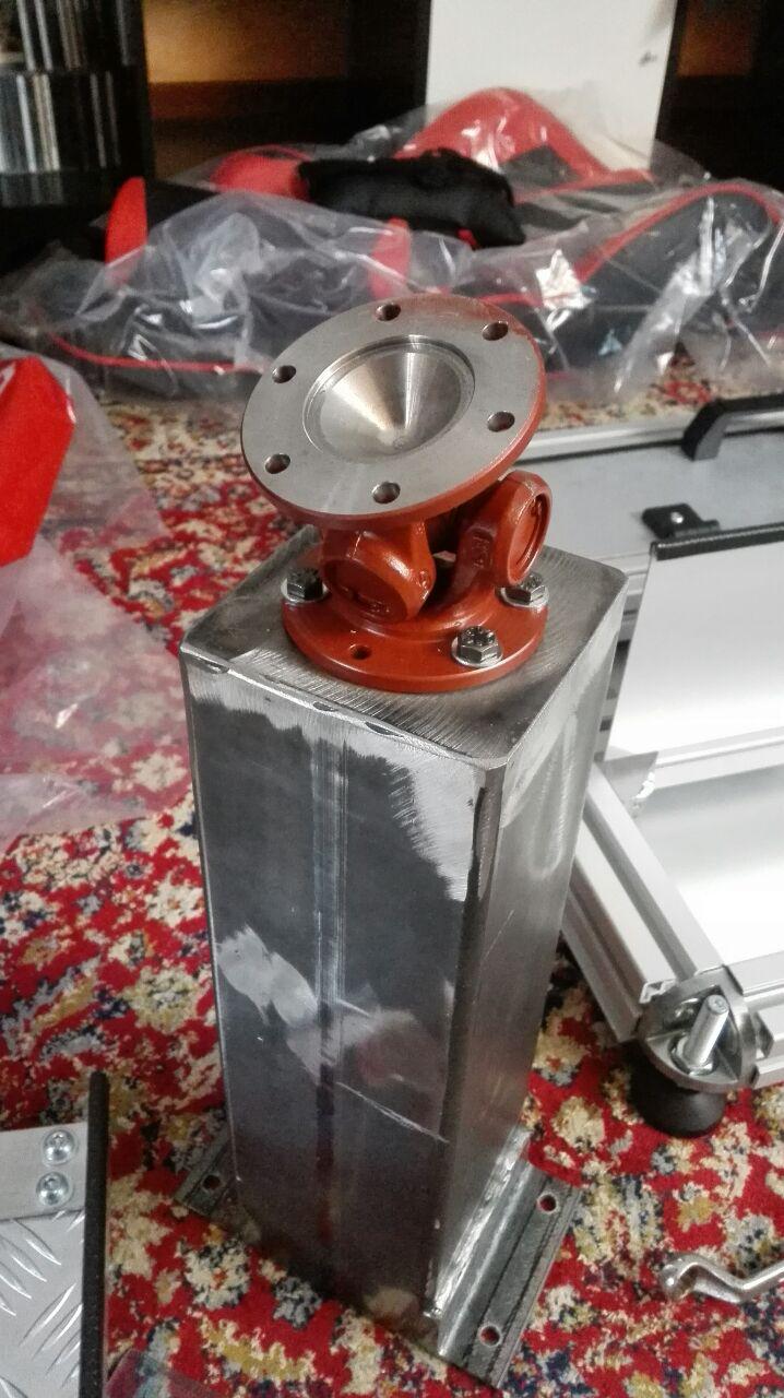

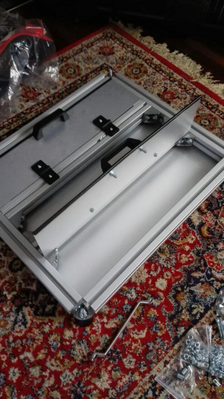

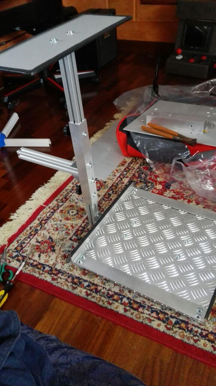

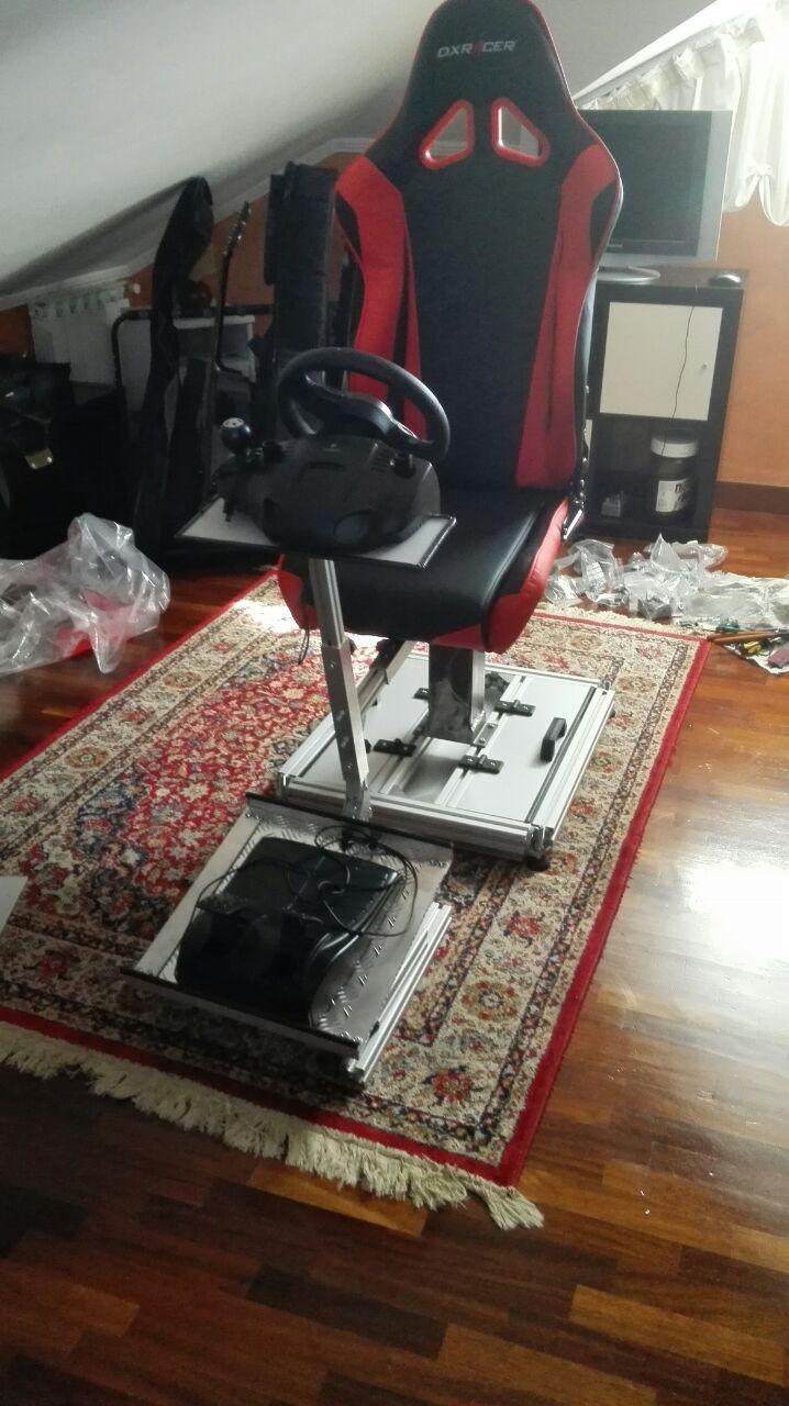

    Little updates...
    First of all, i've ordered motors from pgsaw and hall effect pot, like @Zed 's potentiometer. In the next weeks they are arriving.
    Next, I've mounted my structure. I have made it more light than before.
    I'm so happy about weight of structure under the pivot joint, but i'm not happy regarding the tube goes to the steering wheel/pedals frame. I'm thinking how to make the structure more resistant under the seat.
    Frame under the seat will be replaced by a steel frame (now is in alluminium), so I have maked a try to place joint. I think i've put it too much on back of the seat , in fact simulator goes on front.

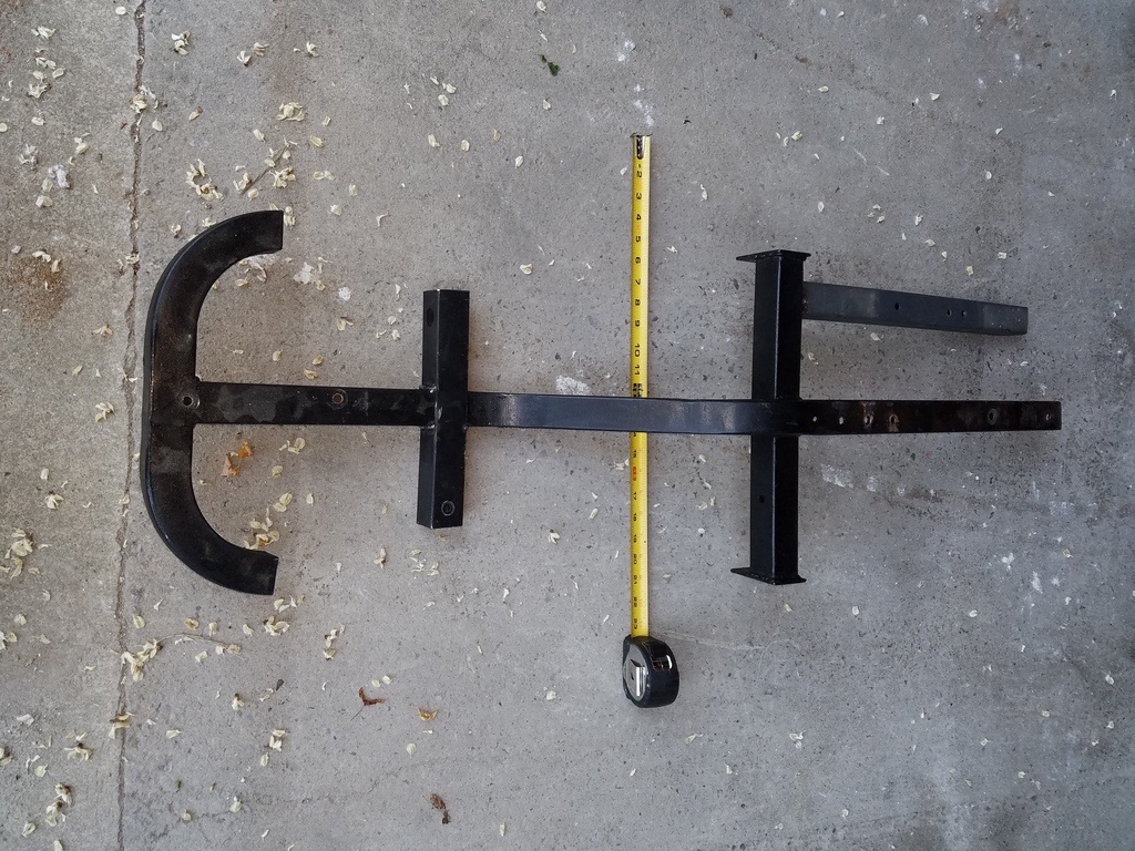

  8. matthew loomis
    matthew loomis Member
    May 18, 2017
    94
    rochester,ny
    603Coins
    +82 / 0 / -0
    I added an off center bar from the link arm back to the seat mount, on the wheel arm side, it removed the twist moment from the center bar and supports the wheel arm as well.

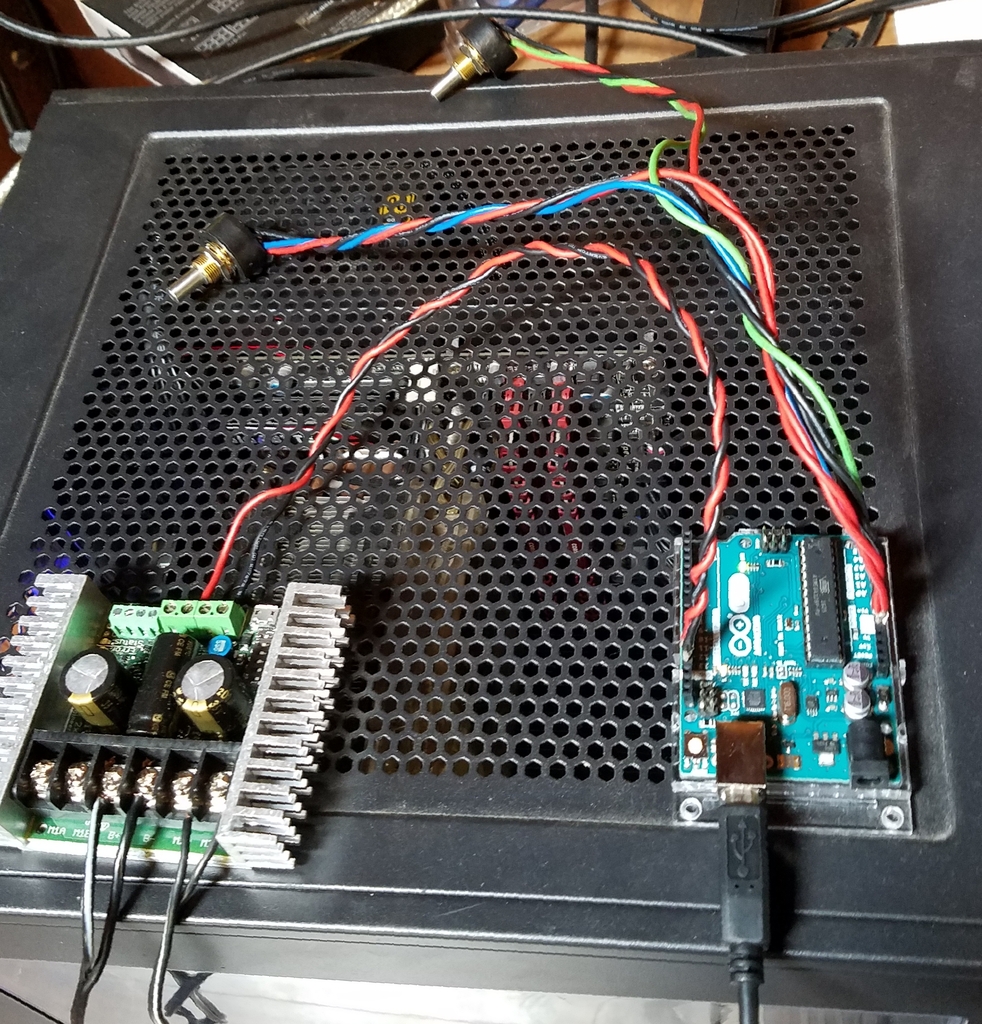

    I've decided to use Sabertooth with Arduino and HP DPS600. I've painted simple schema about electronic connection that I want to make. What do you think? It's ok? Or I have risk to burn all? :)
    I want to add a emergency switch, two amperometer (one for each motor) and a fuse box...where I should place them in this toolchain?

    Your fan switch is located in parallel with the fan when it should be in series. As you have it shown it will short out your power supply when the contacts are closed.
    There are two different pinouts on the Hall sensors depending on the part number you got. For E (European), your wiring on the Hall sensors looks correct. The pinout is 1-gnd, 2-Vcc, 3-signal, with the little keyway bar between 1 and 2. As long as you have E parts that looks right.
    You don't provide make or model of power supply so no idea of pinout to say there. Not familiar with Sabertooth and the legend near the power connections to the Arduino are hard to read but you might want to double check that. I think you are missing wires too. Someone else would know. It depends on the communication/command type between Arduino and Sabertooth, power connections for the Arduino (if there are any), etc.
    Ammeters go in series in the circuit you want to monitor so anywhere in the wiring to each motor should be good. Basically just cut the blue wires somewhere convenient and insert an ammeter.
    Fuses also go in series like switches and ammeters. Likely places would be between house and power supply on the hot leg, between the power supply and Sabertooth (and other circuits like your fan), and possibly one in each motor circuit. You want them in the part of the circuit that can supply power and as near that power source as practical. That's why I said in the hot leg of the house supply.
    Since you don't sound especially confident with circuitry, and I bet you are on 220 volt house wiring, keep in mind those voltages and available currents can easily kill. As we move to summer in the northern hemisphere, hands may get sweaty which drastically lowers skin resistance and let's currents through the body hit deadly levels fast. Please don't try to work on live circuitry, make sure your line voltage connections are shielded, and just be very careful. Even better would be to find someone local who knows electronics and electricity to help and be present when you first fire up. Not trying to spook you or anyone but house wiring voltages (including USA 110 volts) can kill and you might not get a second chance. People who work with it need to know what they are doing.
    The 12 and 5 volt circuitry is much more safe though the power supplies we use can dump significant current. SLA helper batteries can too - even more, generally - and even though voltages are considered safe, the currents can heat rings and watch bands, etc, to high temperatures and you can lose hands and fingers. As an aside, even 12 volts can kill under the wrong circumstances. Some kids thought it would be fun to connect a car battery to buckets of salt water with jumper cables and see how long they could stand holding their hands in to complete the circuit. They dropped their skin resistance low enough to allow enough current through and across their chest that one went into cardiac arrest and died. The point is that if you don't know what you are doing, things that might seem safe just might not be safe at all. Please learn more about circuitry before you attempt this part of the build or get someone local who knows what they are doing to help you.
    It's probably stating the obvious but you need to be extremely and overly cautious if you don't understand this stuff. Some practice the "one hand in a pocket" technique around live circuits to keep from becoming a part of the circuit.

    The sabertooth arduino combo is super easy. It's easy to add an emergency switch to the sabertooth as well. This is a fully working setup

    What a mess...sorry, i'm so tired, but yes, i've made a big mistake in my paint, thanks :D
    Yes, I have E version.
    I've writed I want to use HP DPS 600, wich is this model: https://www.xsimulator.net/community/threads/how-to-modify-a-server-power-supply-for-12v.5774/
    And this is pinout: http://www.rc-network.de/forum/attachment.php?attachmentid=1009189&d=1371029528
    Sorry, I can't understand what is "hot leg of the house"... anyway, where it's better to put a fuse box, from power supply to motors? I have motors like yours..maybe 20A fuse (even the board is Sabertooth 2x32)?
    This can be good? It supports max 30A (my motors are rated 12A on normal using).
    https://www.a mazon.it/MICTUNING-Portafusibili-Capocorda-Circuito-Indicazione/dp/B01GRAOUHK/ref=sr_1_4?ie=UTF8&qid=1497717874&sr=8-4&keywords=fusibili+scatola
    Thanks @Zed for your lovely suggestions, and thanks @matthew loomis for photo :)
