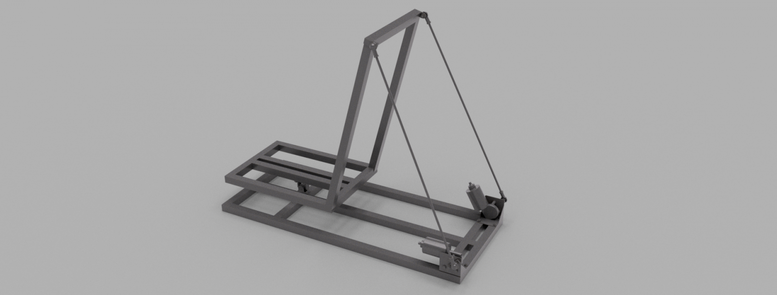

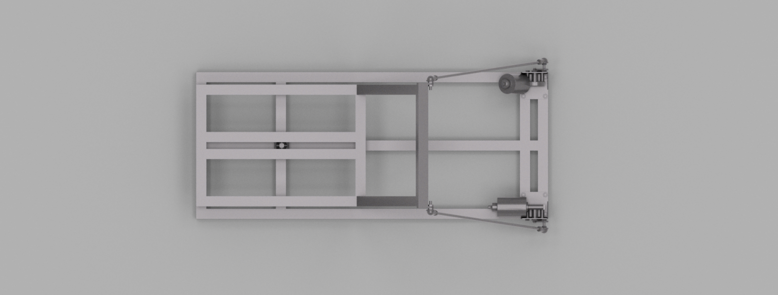

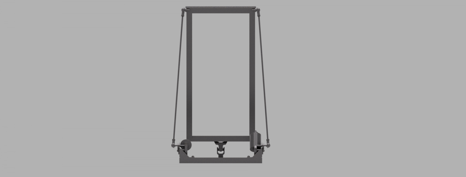

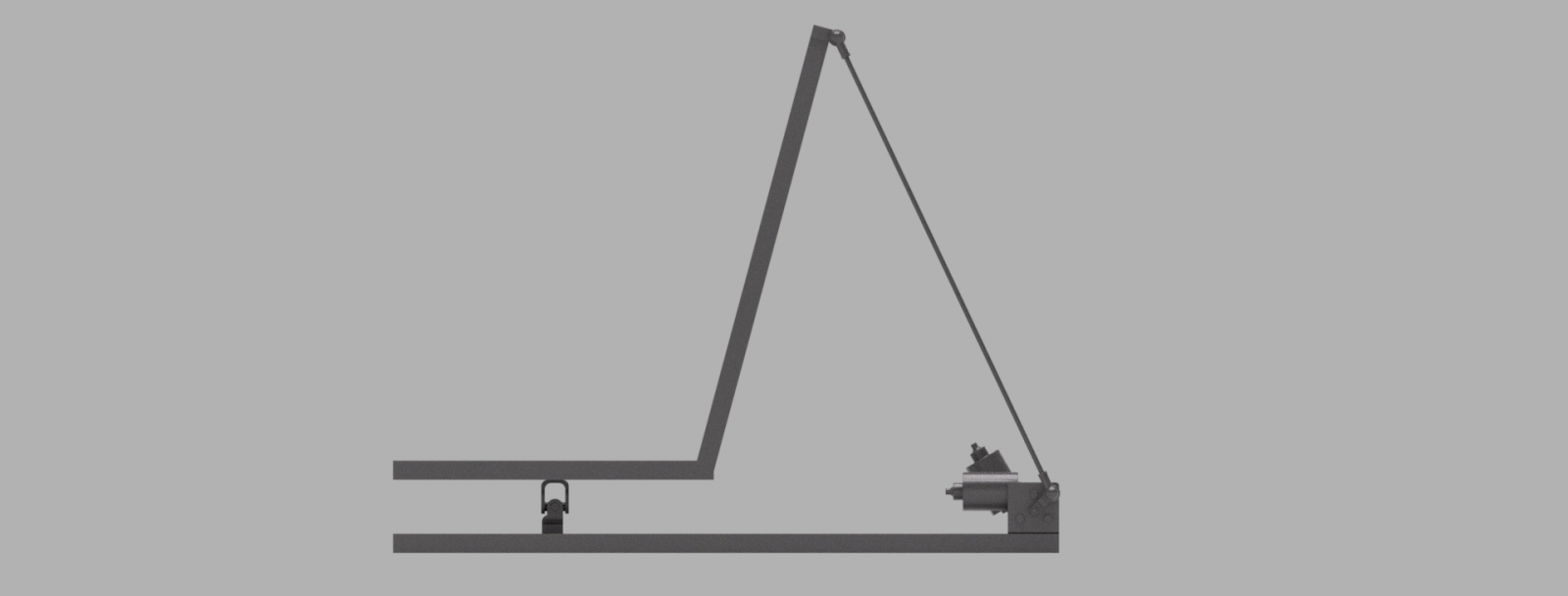

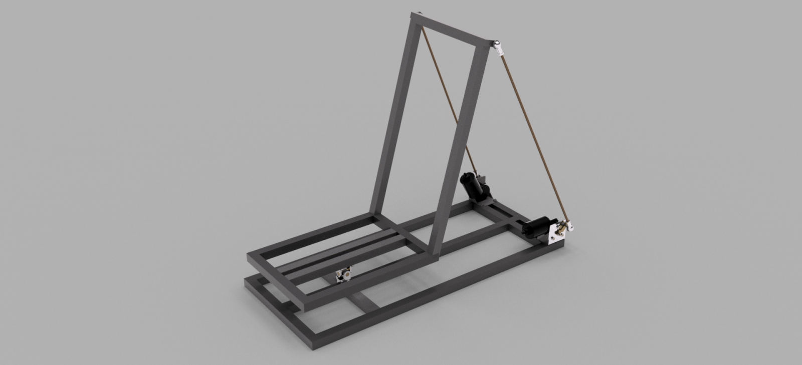

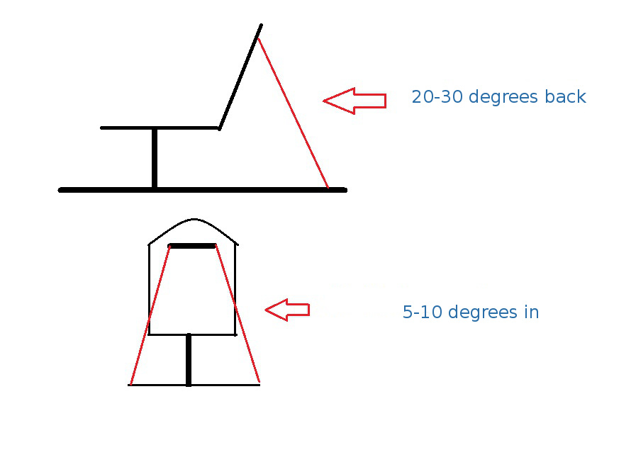

    Designing the frame, i know that the further away the motor is from the U joint, the less effort the motor has to do when moving the seat but would like to know if i really need this inner angle of my rod as this picture of @noorbeast and for what reason it is
    22,185
    154,750Coins
    +11,196 / 57 / -2
    Within the parameters of any particular design the closer to 90 degrees the greater the effective use of torque. The effective use of torque falls off rapidly over about 38 degrees, so staying within those parameters helps trade off effectiveness against practical design.
    Tools such as SimCalc can help experimentation and tradeoffs between design and physics: https://www.xsimulator.net/communit...e-linear-speed-and-forces-of-your-design.270/
  4. poumpouny
    poumpouny Member
    Jun 27, 2023
    58
    102Coins
    +26 / 0 / -0

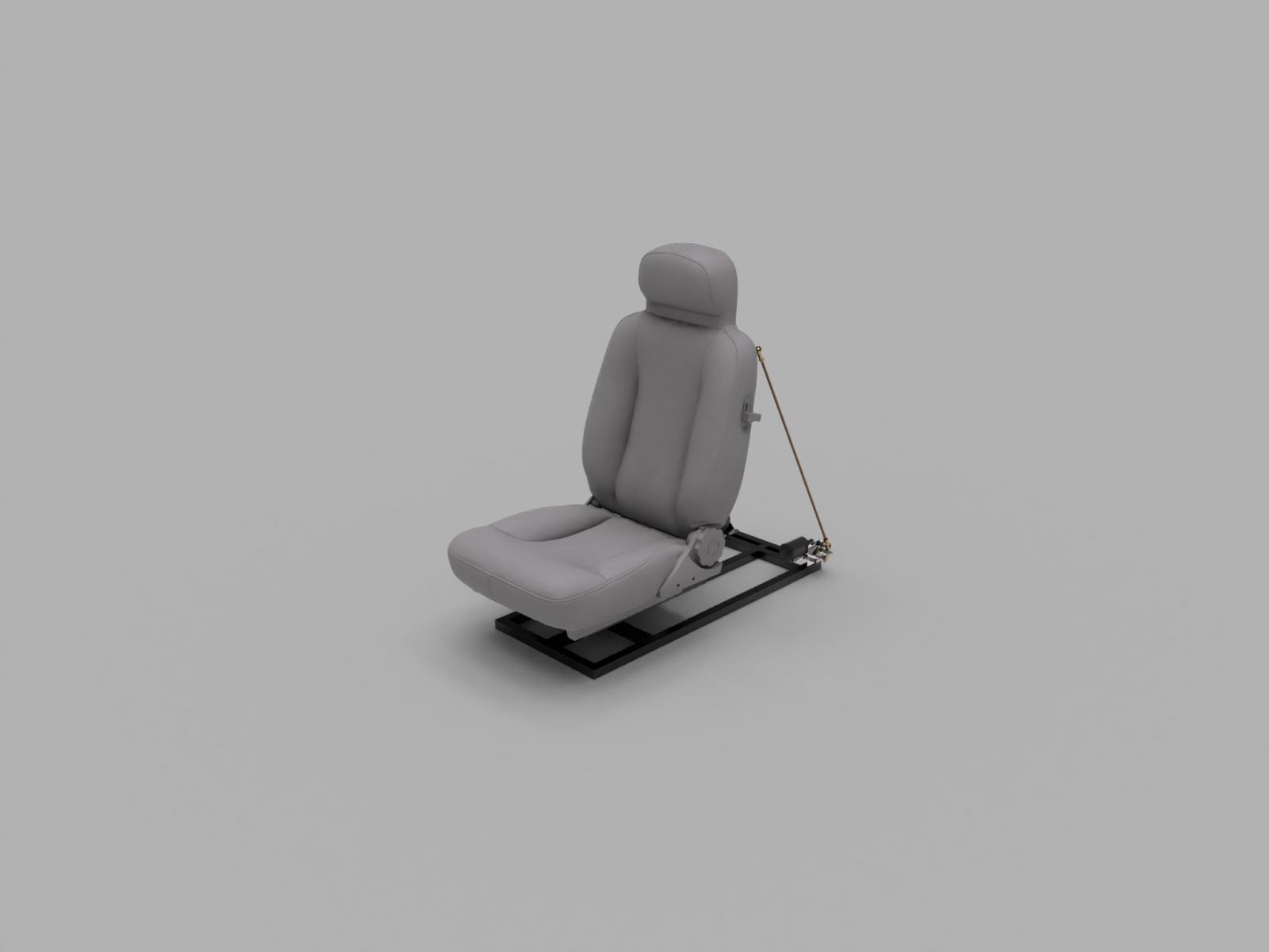

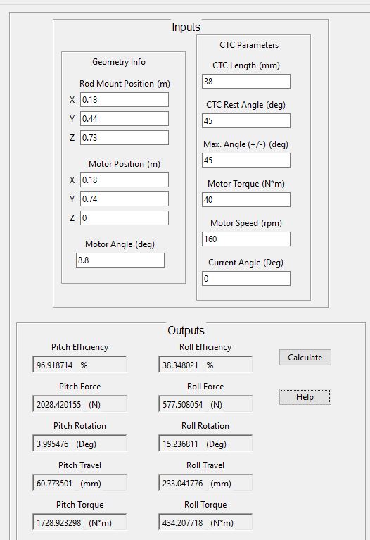

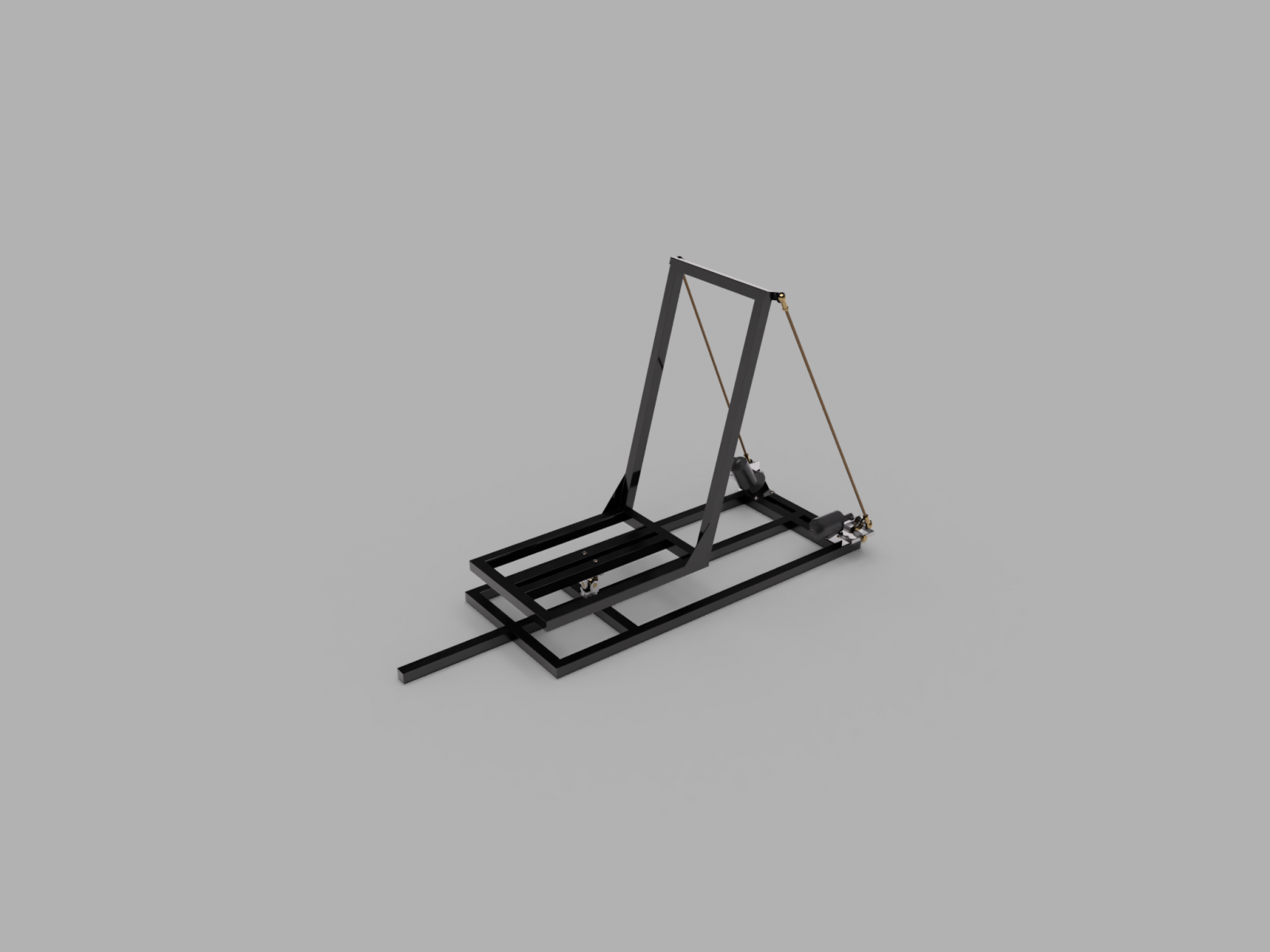

    So here is the CAD modeling for the structure, it is not yet finished (pot holder / seat ) ... Also the simcalc result base on the structure measurement, i think it's OK according to simcalc help.

    For the Motor torque, i leave it to default as i don't know what is the torque of my wiper motor

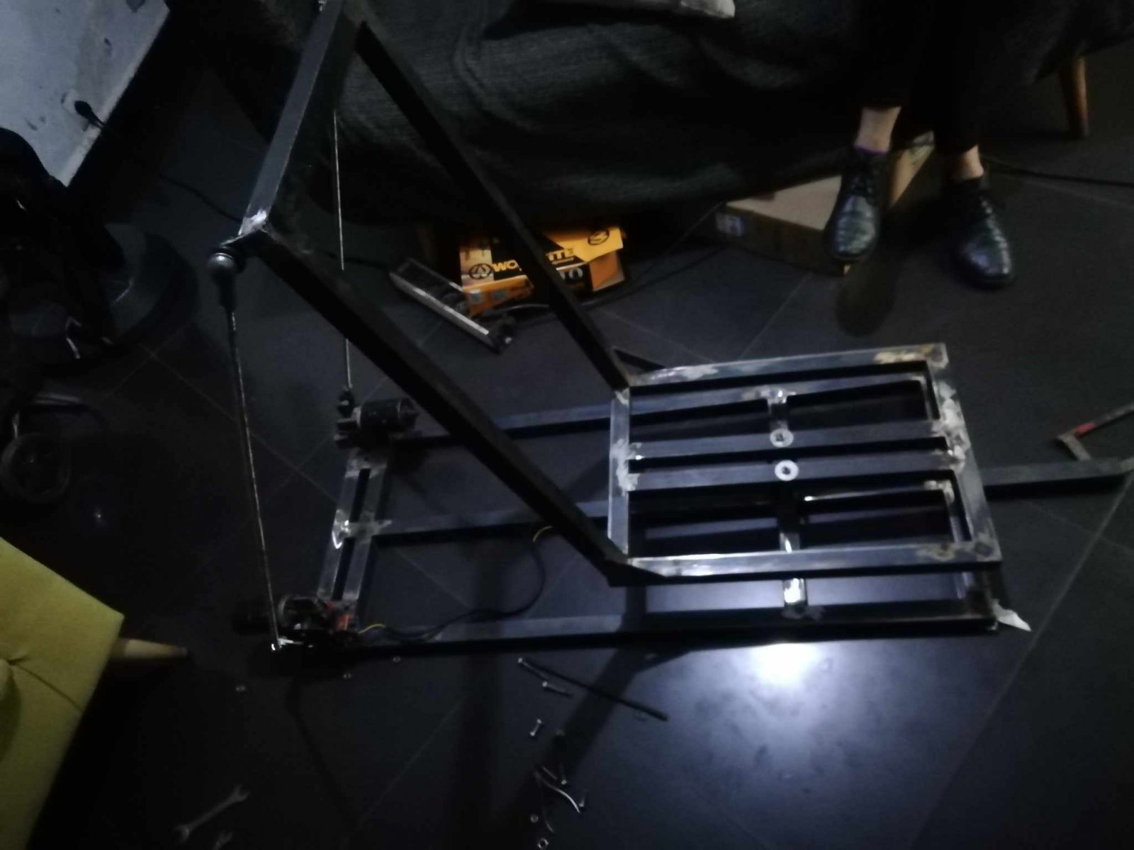

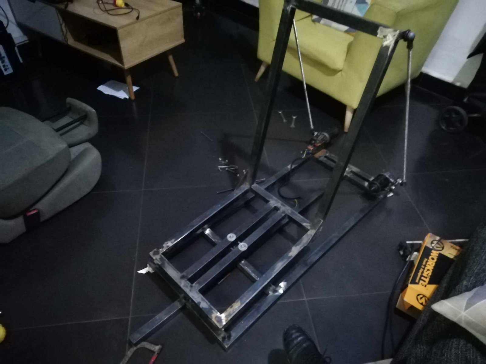

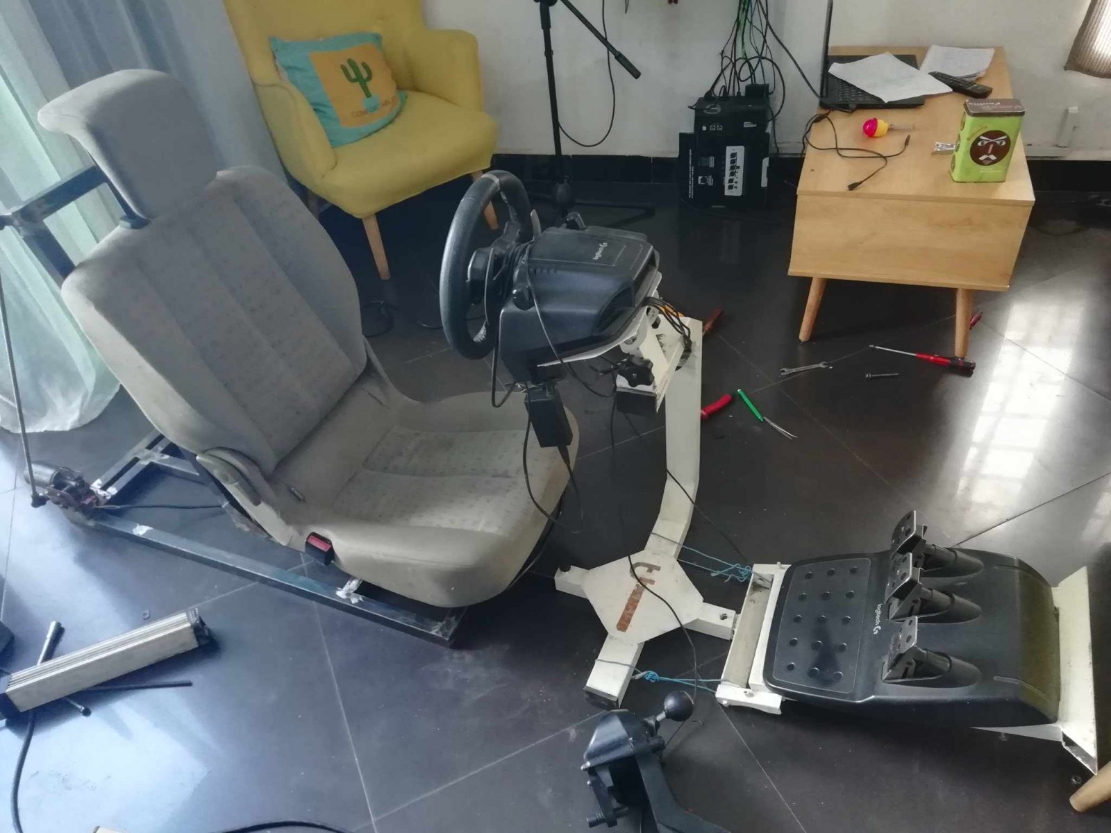

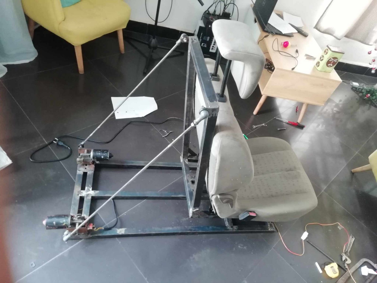

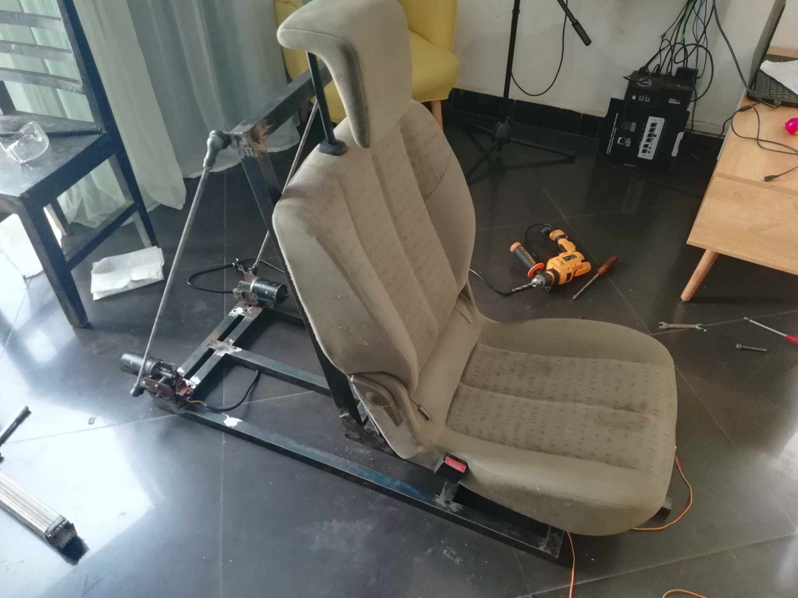

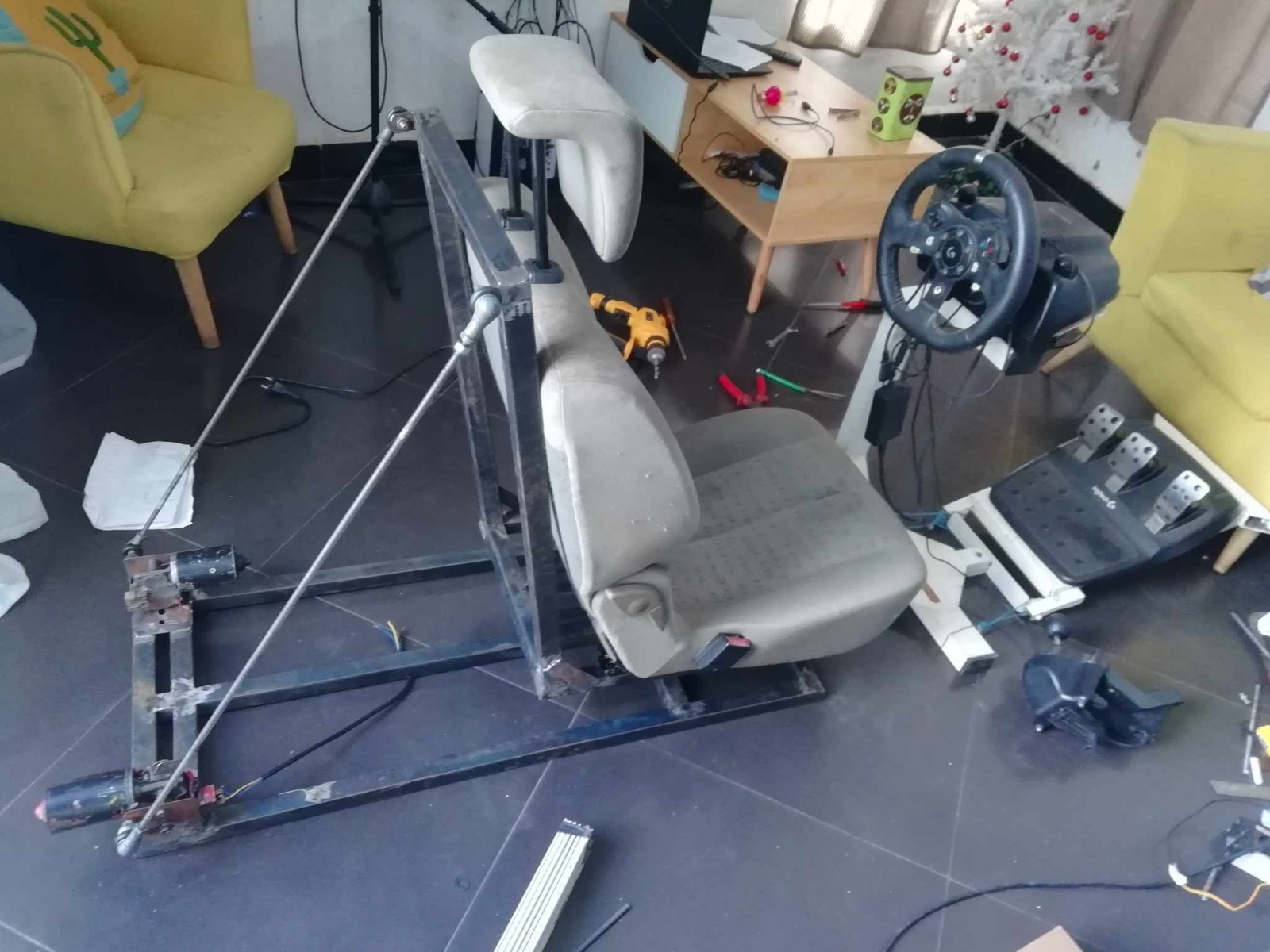

    Frame built, mounting it for test and all works as expected, dismounting it again to go for painting, meanwhile i'm modeling the arduino + 2 IBT enclosure, i will make the stl and the fusion 360 available once i printed and test it. Also modeling the pot holder.

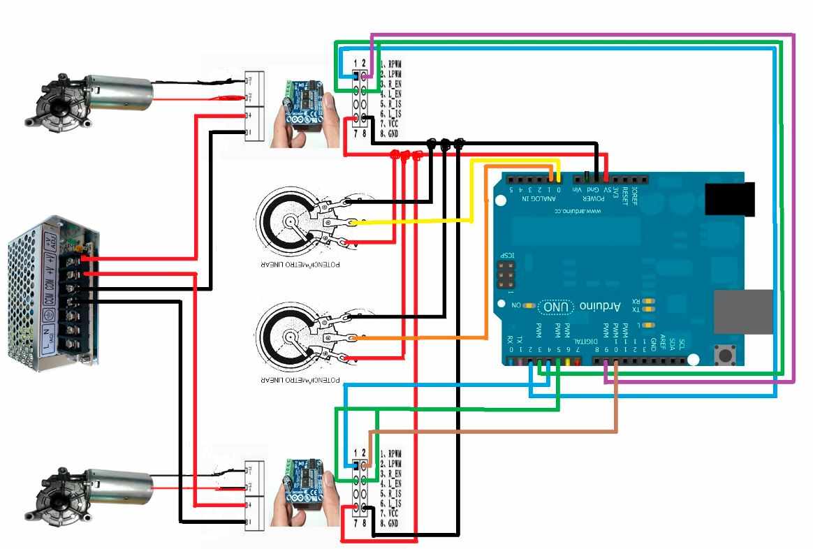

    Please help, I'm using this schema to wire my electronics, but i don't find where should i wire the emergency button. I'm using 12V30 amp PSU and IBT 2.
  10. Chris_Beeves
    May 31, 2019
    380
    2,196Coins
    +259 / 4 / -0
    I'd run one combined enable signal to both IBT and run that through the emergemcy button.
  11. poumpouny
    poumpouny Member
    Jun 27, 2023
    58
    102Coins
    +26 / 0 / -0
    Thanks Chris but I don't understand what you mean, you mean combining the 2 minus wire from the two IBT's to the PSU and put the emergency button between ?
  12. Chris_Beeves
    May 31, 2019
    380
    2,196Coins
    +259 / 4 / -0
    Personally I have run them with both EN-pins pulled high with 5V. Maybe that doesn't work with your code.
    5V to emergency button, from emergency button to all EN-pins on the IBT's.
  13. poumpouny
    poumpouny Member
    Jun 27, 2023
    58
    102Coins
    +26 / 0 / -0
    Ok Thanks i'll check that !

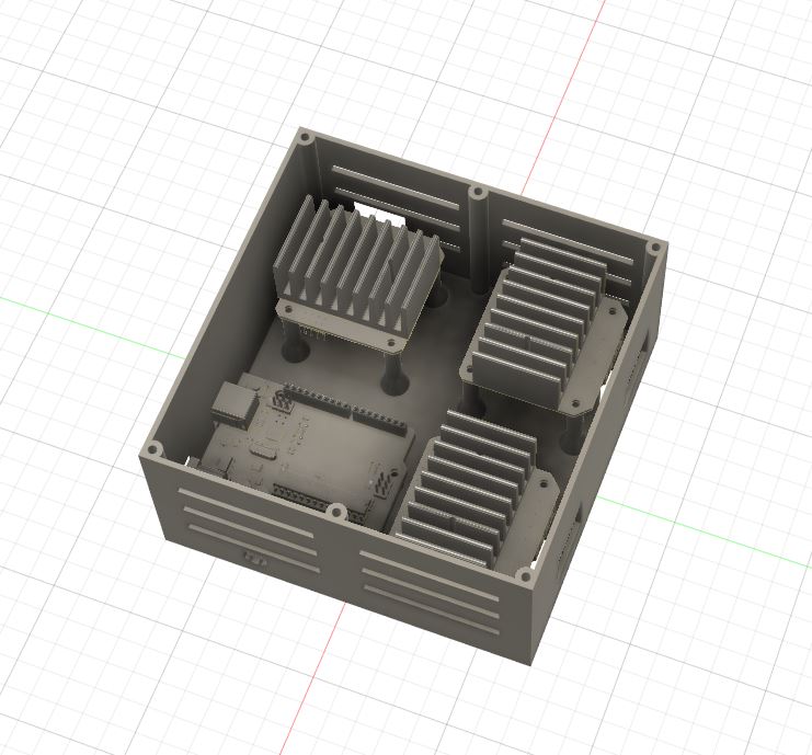

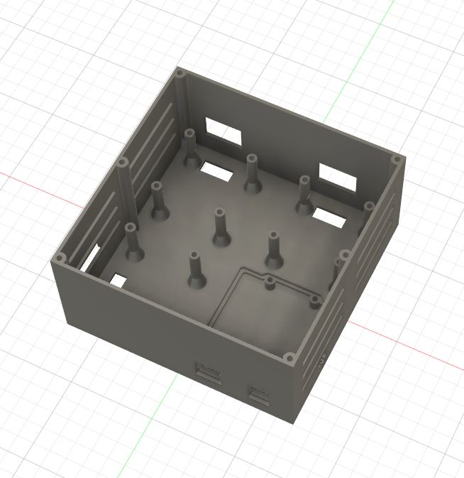

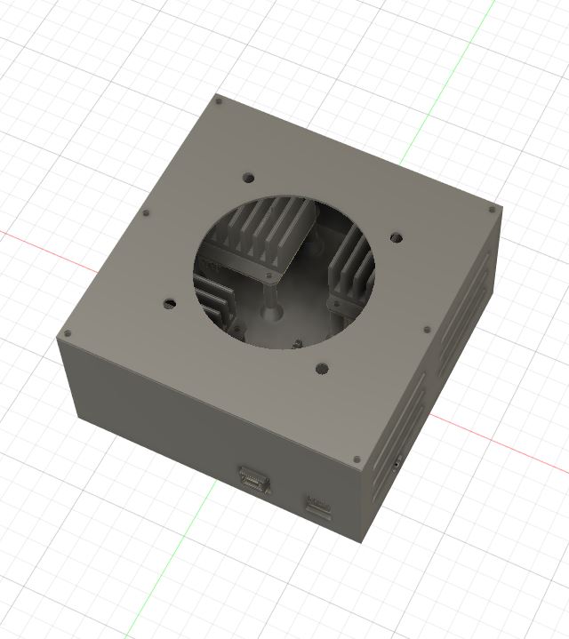

    Finished designing the enclosure, i've designed it for 3 IBT since i will surely add traction loss to my rig later. I'll upload the stl once i verified it is working, i'm printing it right now :

    So big problem today hihihi, i finished painting the frame, and printing the enclosure, i temporarily wire all electronics to be sure everything is working, and it is.
    The seat move accordignly to LFS replay since nobody is seating on it, but as soon as i 'm on it, the motor number 2 is very weak, very slow, i've put my 10 years old daughter and it's the same. The other motor work normally, even if it is weaker than i would think.
    I recalculate the center of mass of the upperframe, and balance it very well. IT is working a little better but still not enough, it seems the motor is weaker in one direction than the other.
    So i dive into SMC 3 tools and tweek the pwm max to something like 200 :D .the weak motor the works instantly better but 15 min after, the PSU fried :eek:.
    Fortunatelly , i have an electronician friend, and he found 2 transistor P13009 and a 1ohm resistor fried, we replace that and the PSU is up and running again.
    So my question is, is that just cause i pump up the PWM to high who cause the PSU to die or is it something else.
    PS : I've already remove ground from the motor so now only the ground is beeping when doing a continuity test with the ground and the motor plug.
