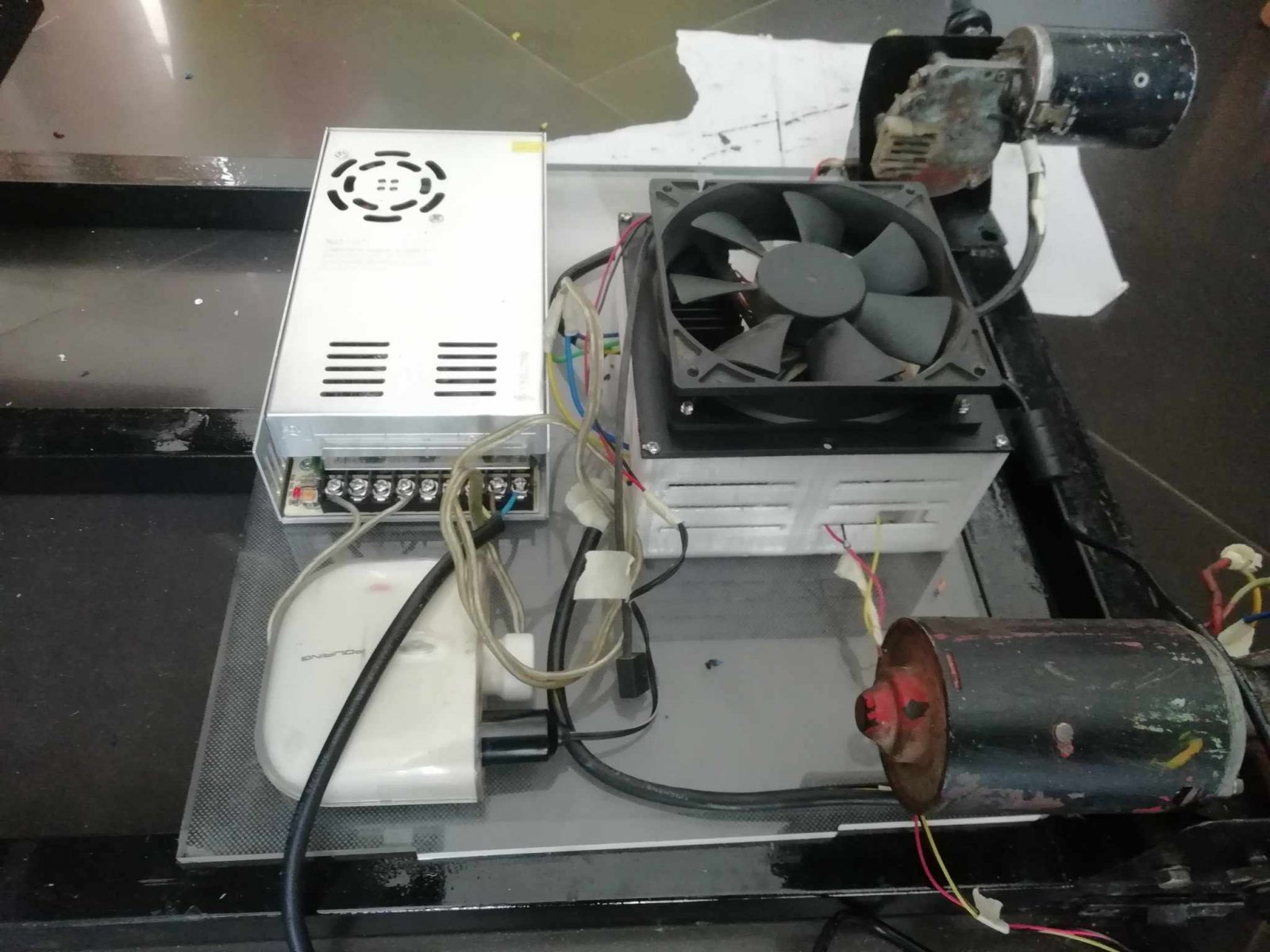

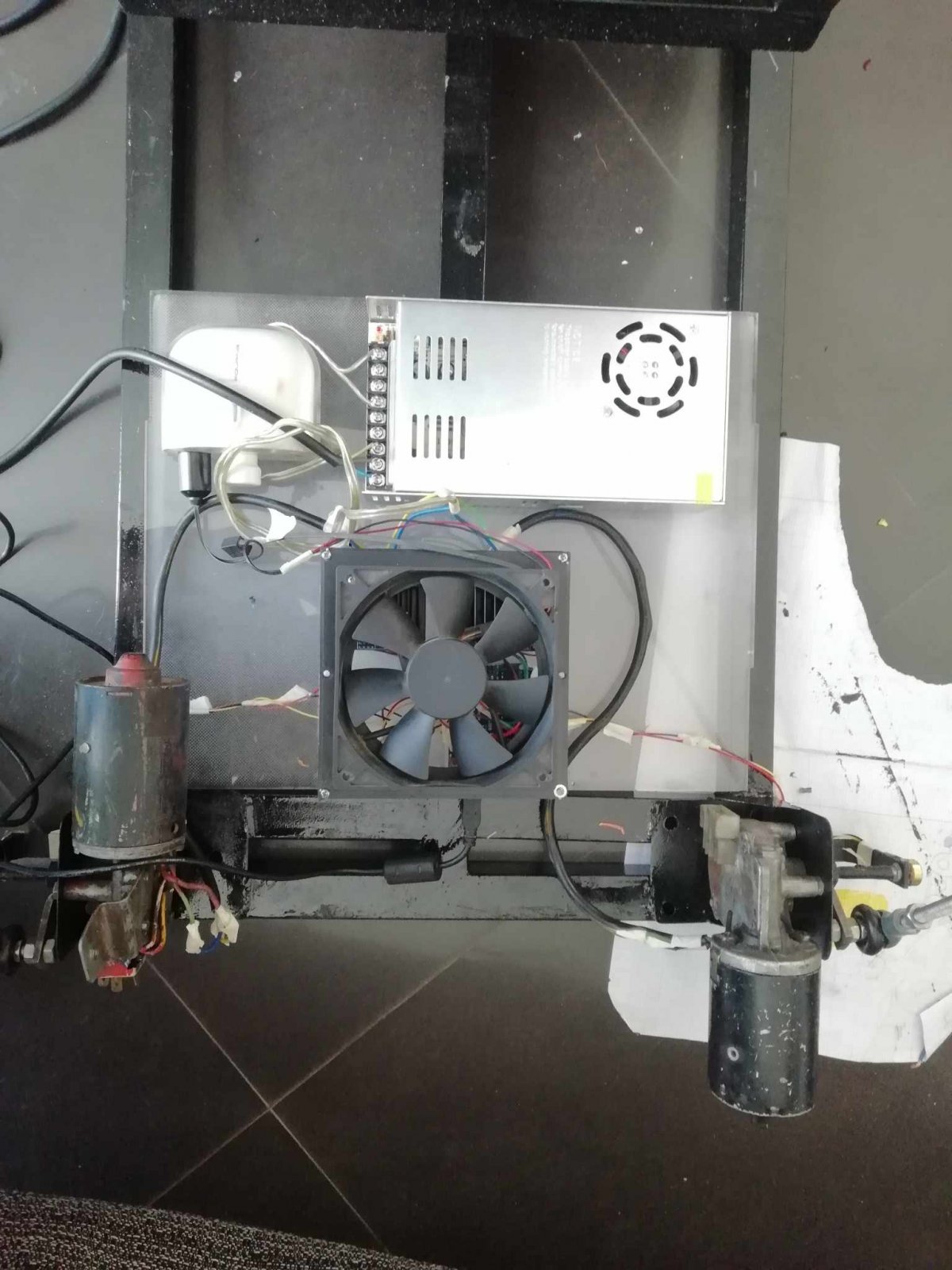

    Merry Christmass to all, finished the final wiring, defenitely need a thermo retractable gain to enclose all the cable but no store open until monday, so it will be tape now hihihii

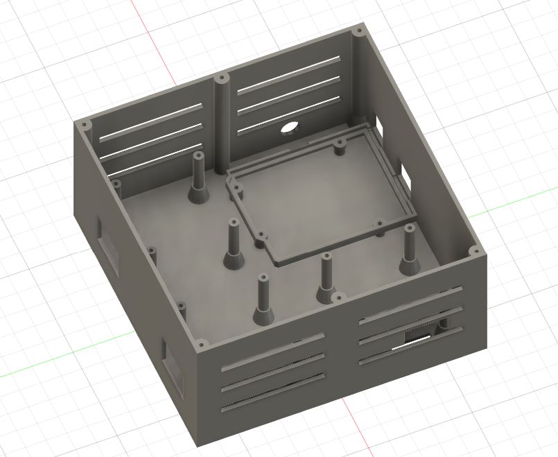

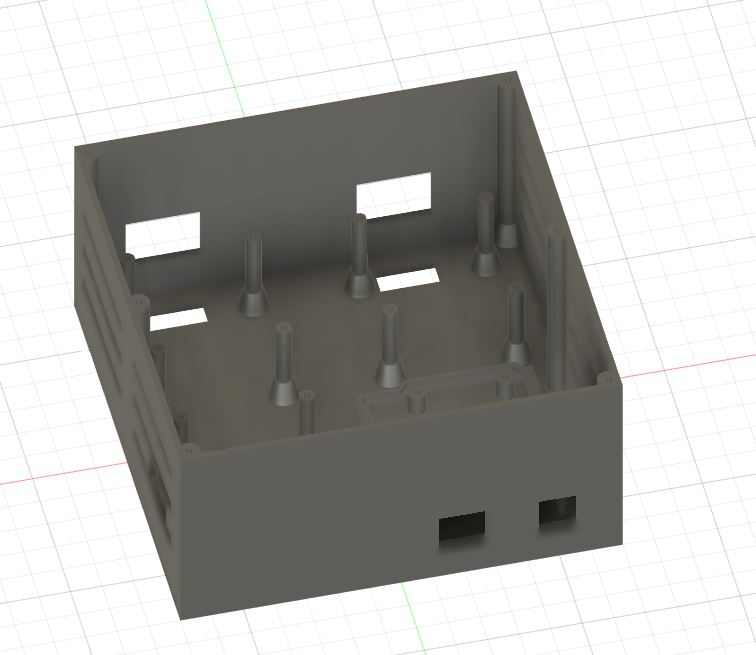

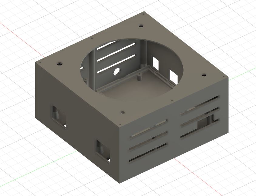

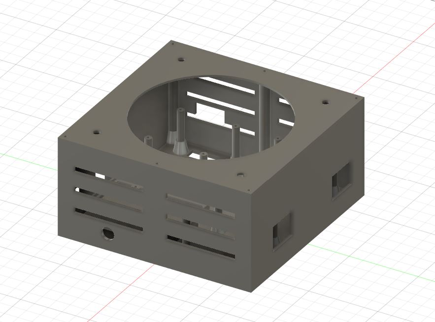

    As promised, here are the stl and fusion 360 files of my enclosure for Arduino Uno R3 + 3 IBT 2 BTS 7960 motor driver. The cover is for a standard 120 x 120 mm PC case fan.
    Feel free to add it to the FAQ 3D printable item if that could be usefull for other. 409548496_737318684522509_8746343806430757062_n.jpg 410917006_645733044429249_8115057774158532570_n.jpg 1.JPG 2.JPG 3.JPG 4.JPG

    Hello, my wiper motors is definitely not powerfull enough, so i think i'll buy a 12 DC motor, my problem is that in my country i can't access to the common store to buuy motor, i can only buy on amazon.fr and when i search for 12v worn motor this is what show up, and i'm really confused what can suit for my need.
    https://www.amazon.fr/s?k=worn+dc+m...efix=worn+dc+moteur+12,aps,433&ref=nb_sb_noss
    My rig is a 2DOF seat mover shoulder mounted with IBT 2 and a 12V30Amp

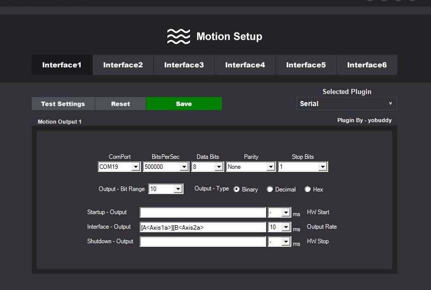

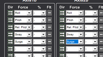

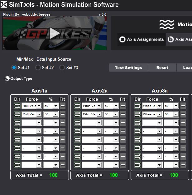

    I'm trying to configure gp bikes with simtools 3 beta but i don't have correct motion it just randomly roll on one direction and randomely go to center, nothing to do with my bike, here are my setting :
  12. Chris_Beeves
    May 31, 2019
    380
    2,196Coins
    +259 / 4 / -0
    Oh, good! Then you got it moving! :D
    You are using roll velocity rather than roll. (I'd use sway instead of roll though.
    And Pitch instead of Pitch velocity. (Here I'd use surge instead)
    I'd use this as a start:
    (Rel. pitch is the same as wheelie)
    Put values in one at a time and make sure they are in the correct direction.
    Don't use Axis 3 yet. That'll have to wait until your third motor :)

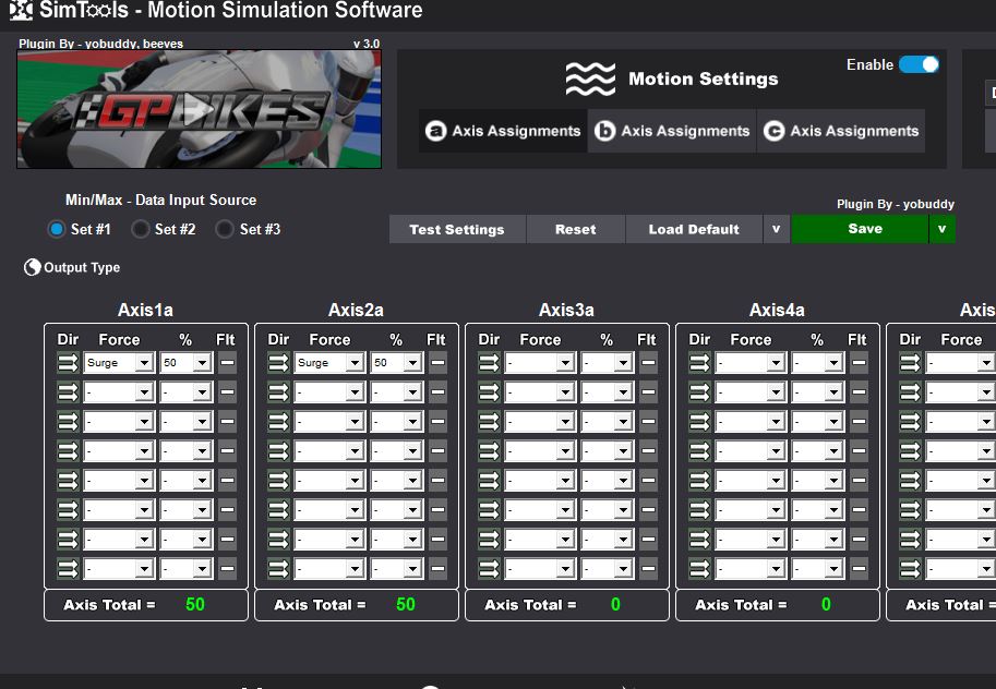

    Now it isn't moving anymore :D, i've test just surge and there is no motion
  14. Chris_Beeves
    May 31, 2019
    380
    2,196Coins
    +259 / 4 / -0
    You have to set min/max values first.
  15. Chris_Beeves
    May 31, 2019
    380
    2,196Coins
    +259 / 4 / -0
    Easiest way to do that is just click capture and write the values manually.
    For roll you can use +-60
    pitch +-10
    Sway and surge +-1
    Then click save. Then it should move. :)
  16. poumpouny
    poumpouny Member
    Jun 27, 2023
    58
    102Coins
    +26 / 0 / -0
    Thanks Chris, in fact I forgot the "]" in the interface outpout, now it's moving correctly, time to tune it now, it's lot of fun even if im still riding a bike with a car wheel and pedal, hihihihi :grin
