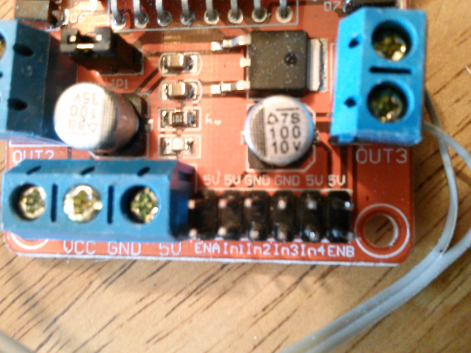

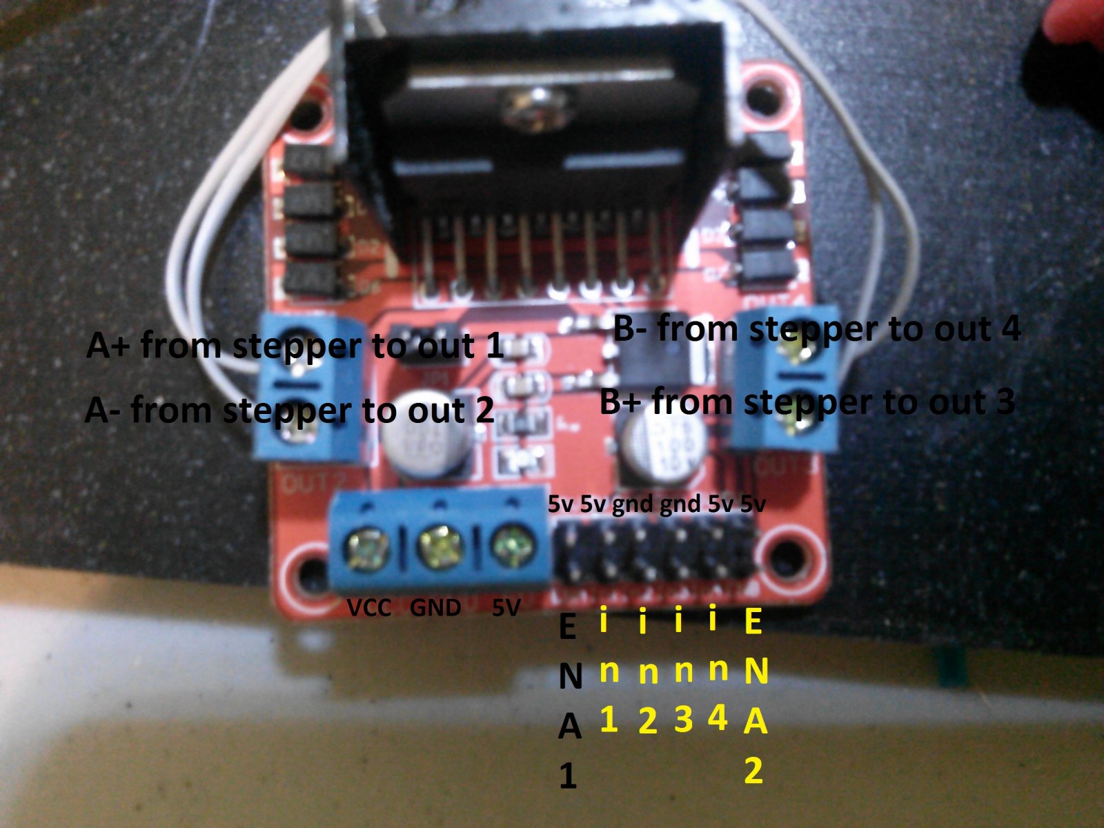

    I got the Arduino uno R3, a motor shield, 3 x stepper stages, and 3 x l298n dual h bridges the other day. I added 2 of the stages to my model for pitch and roll( I have one left for yaw) and I have been trying to make it all work. After days of reading and trying to understand the code, I am able to control one stage at a time with the motor shield, but I only get them to shutter, or run one direction with the h bridges. I'm just not sure what does what coming out of it.
    Here is a video of one stage sort of working. LoL
    When I connect the H bridge
    A+ from motor - to - out 1 on H bridge
    A- " " " out 2
    B+ out 3
    B- out 4
    Input:
    This is where I am a little confused, I know 2 are for direction and 2 are brake. I've tried it various ways and it either doesn't reverse or just shutters. Now granted, my sketches probably are a lot of the problem. Do they correspond to the outputs?
    ena1 pwm1
    in1 =?
    in2 =?
    in3=?
    in4=?
    ena2 pwm2
    I have also tried it with the jumpers on ena1 and ena2 and just operating it on the four pins with about the same results.

    @eaorobbie , Sorry it's taken me so long to reply. I bought it off ebay, They were cheap and I thought they would work for testing. There are no specks other then it will operate one stepper or two motors.
    This is what I have. Thank you for any help

    @eaorobbie thanks for that link. If I understand it, It looks like the in's and outs are are matched up through the l298n. That helps a lot.
    In the sketch on that page it shows ccw and cw on pins 2&3. Clockwise and counter clockwise. What are they connecting here to operate it? #define CW 2
    #define CCW 3
    #define ENA 8
    #define ENB 13
    #define black 9 // In1
    #define brown 10 // In2
    #define orange 11 // In3
    #define yellow 12 // In4
    I will see if I can hook it up and try it again in the morning.
  13. eaorobbie
    20,508Coins
    +1,687 / 23 / -2
    The code contains the pin out, basicly the ard pins 2 & 3 will control direction of turn, ie if pin 2 is high and pin 3 is low the stepper should turn Clockwise.
    The driver needs to be enabled (turned on) that's connected to pin 8 and 13, basically if pin 8 is high only stepper 1 will move if both are high both can move.
    last but is the stepper connection, colors refer to a std that most 4 wire steppers have. If not need to work out which pair is connected to which coil.
    So this should show you where to hook it all up too.

    Thank you again for all your help. I haven't had time to sit with this much.
    Since my steppers do not have colored wires, I only know A+A-B+B-. I did a little searching and found.
    A+ = Yellow
    A- = Orange
    B+ = Black
    B- = Brown
    I hope this is correct.
    When I look at the schematic on that page, it shows Brown going from out 1 through to in 1, and black from out 2 to in 2, but in the sketch, it shows them reversed. Black in 1 and brown in 2. Is this a mistake?
    Sorry for all the questions, Just trying to understand all this.
