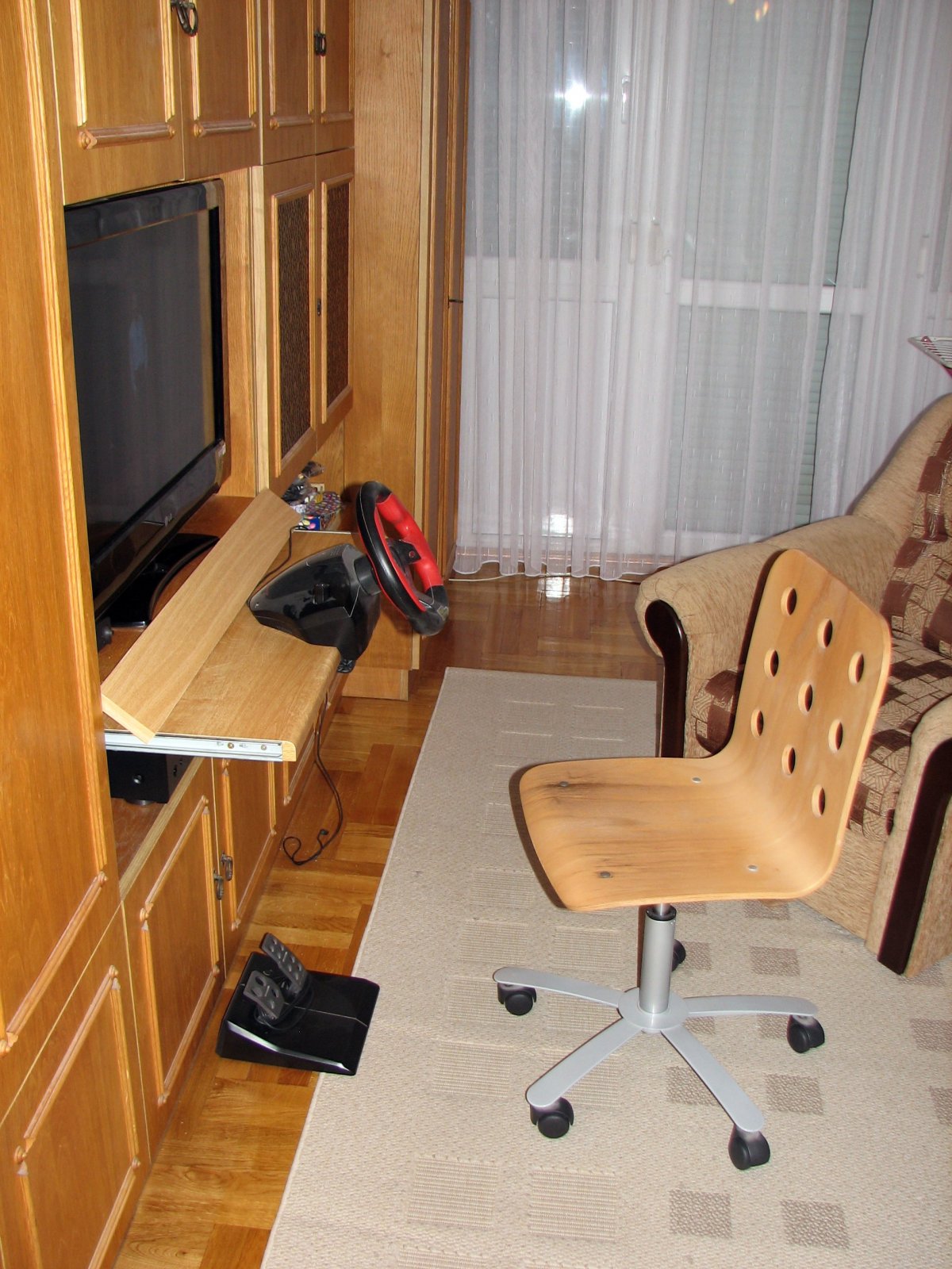

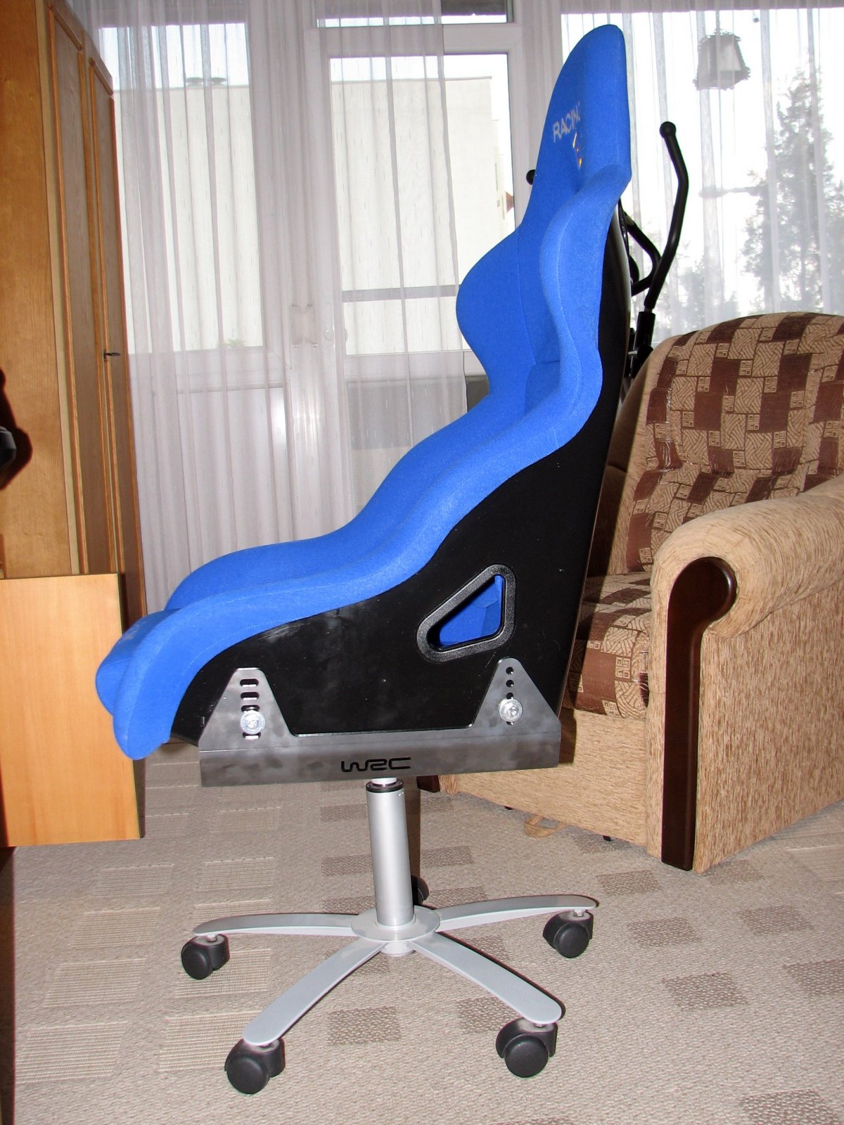

    There is a little photo album with comments about my 2DOF motion seat building process.
    The beginning was assembled an Ikea office chair (for young guys) and my old race seat in the end of year 2010.

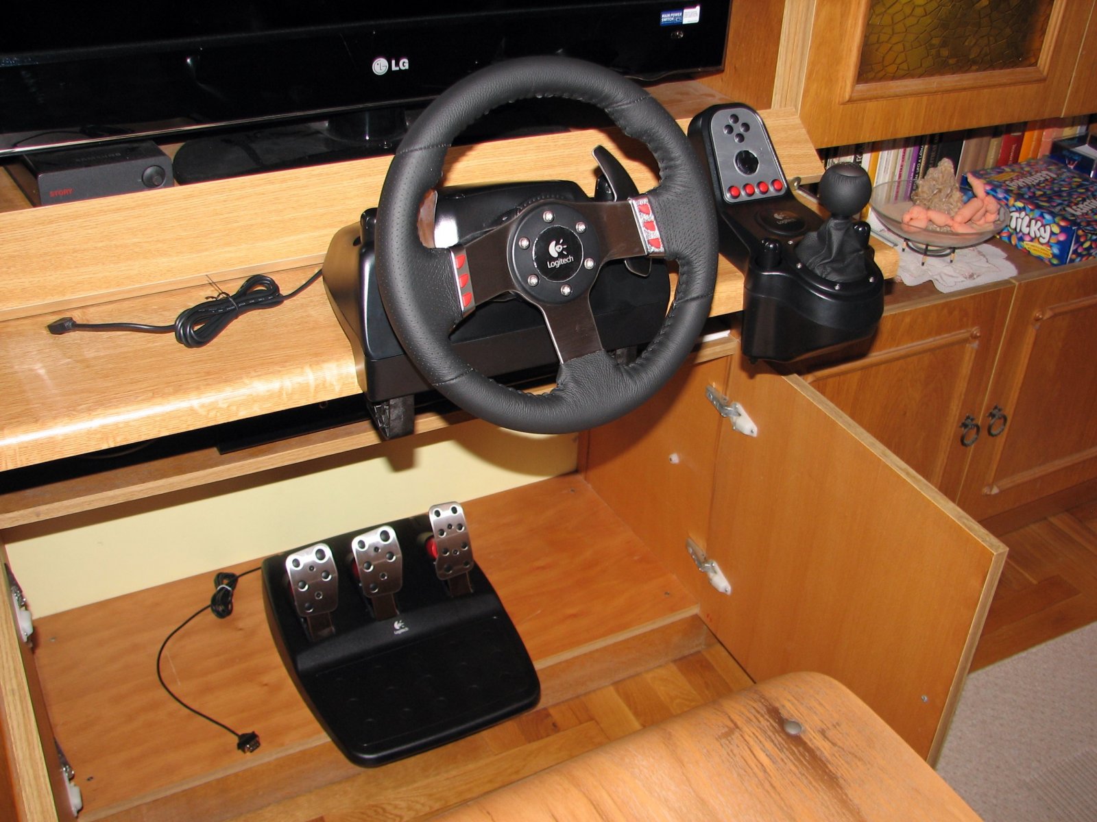

    And I had modificated my furniture for the pedals and steering wheel in 2010.

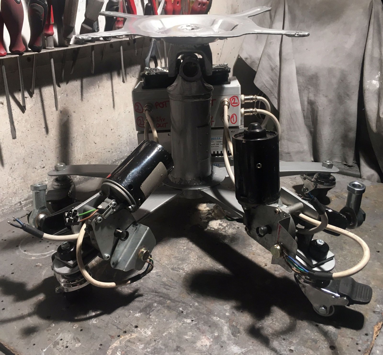

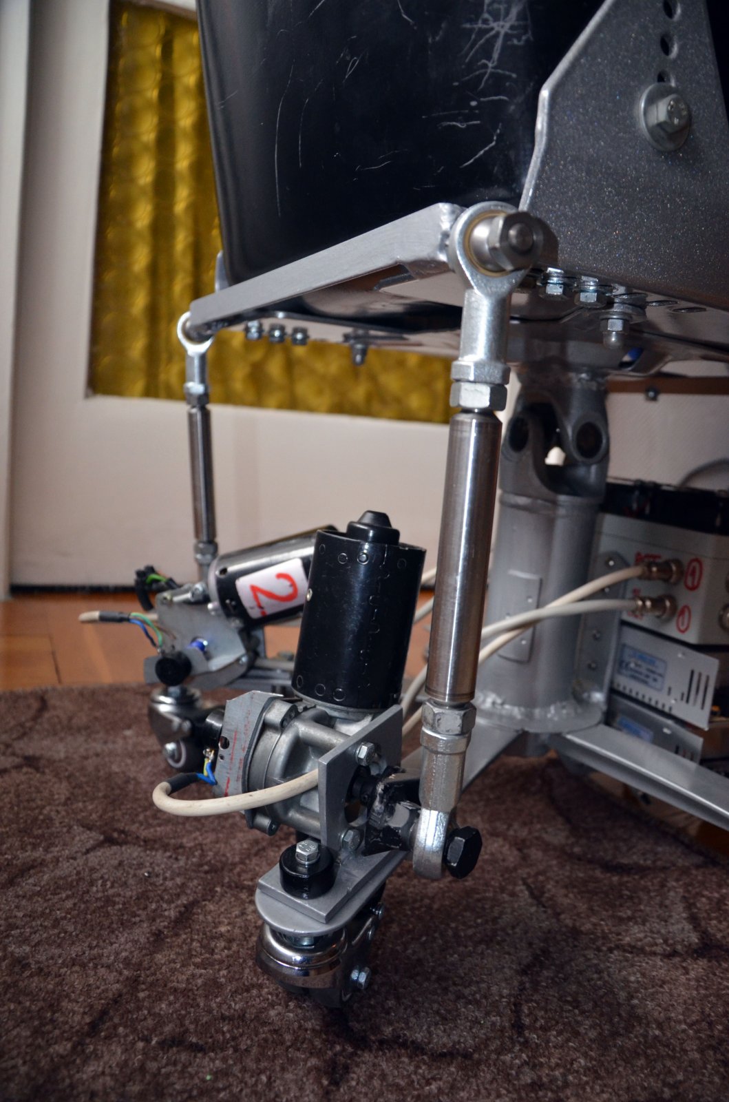

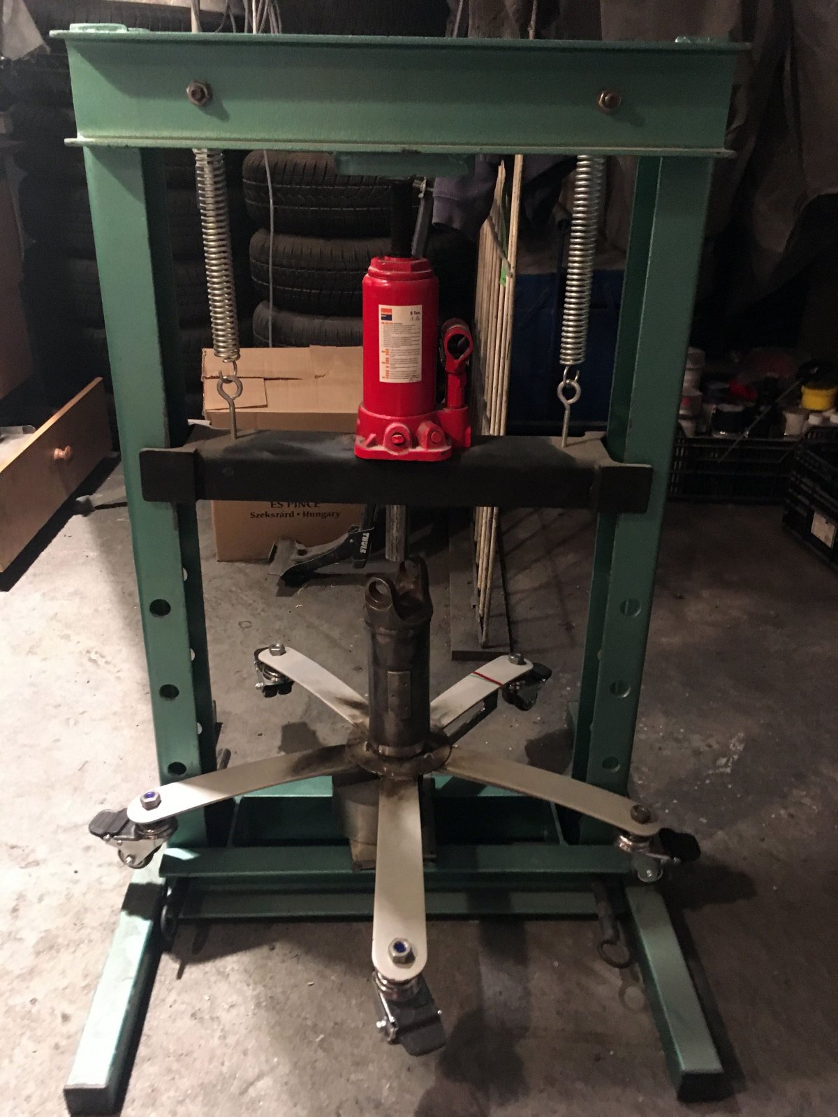

    Unfortunately for me I had seen a youtube video about a factory motion platform
    which was very compact but very expensive.
    So I have decided I will build one in 2022.
    My purpose was a very compact motion seat and I wanted that every parts of it will be there under the seat. After a lot of planning I have collected every parts what I need to.

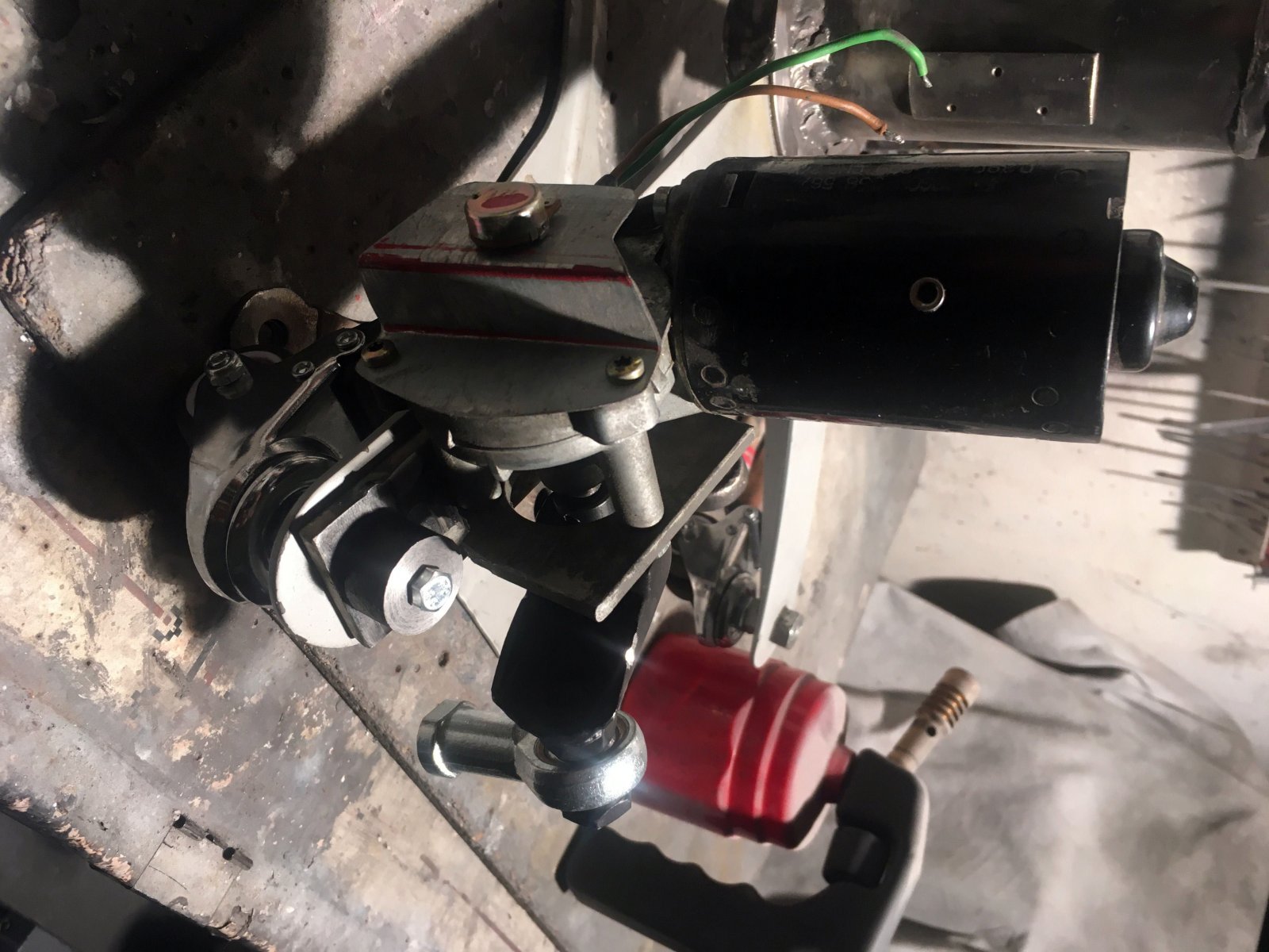

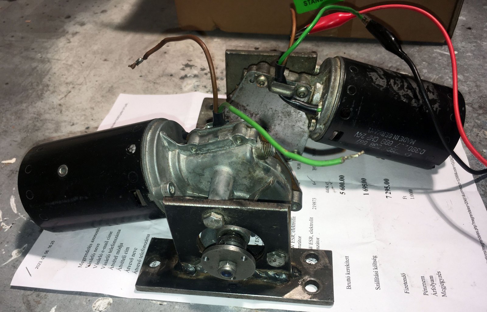

    Two Bosch 24V wiper motors:

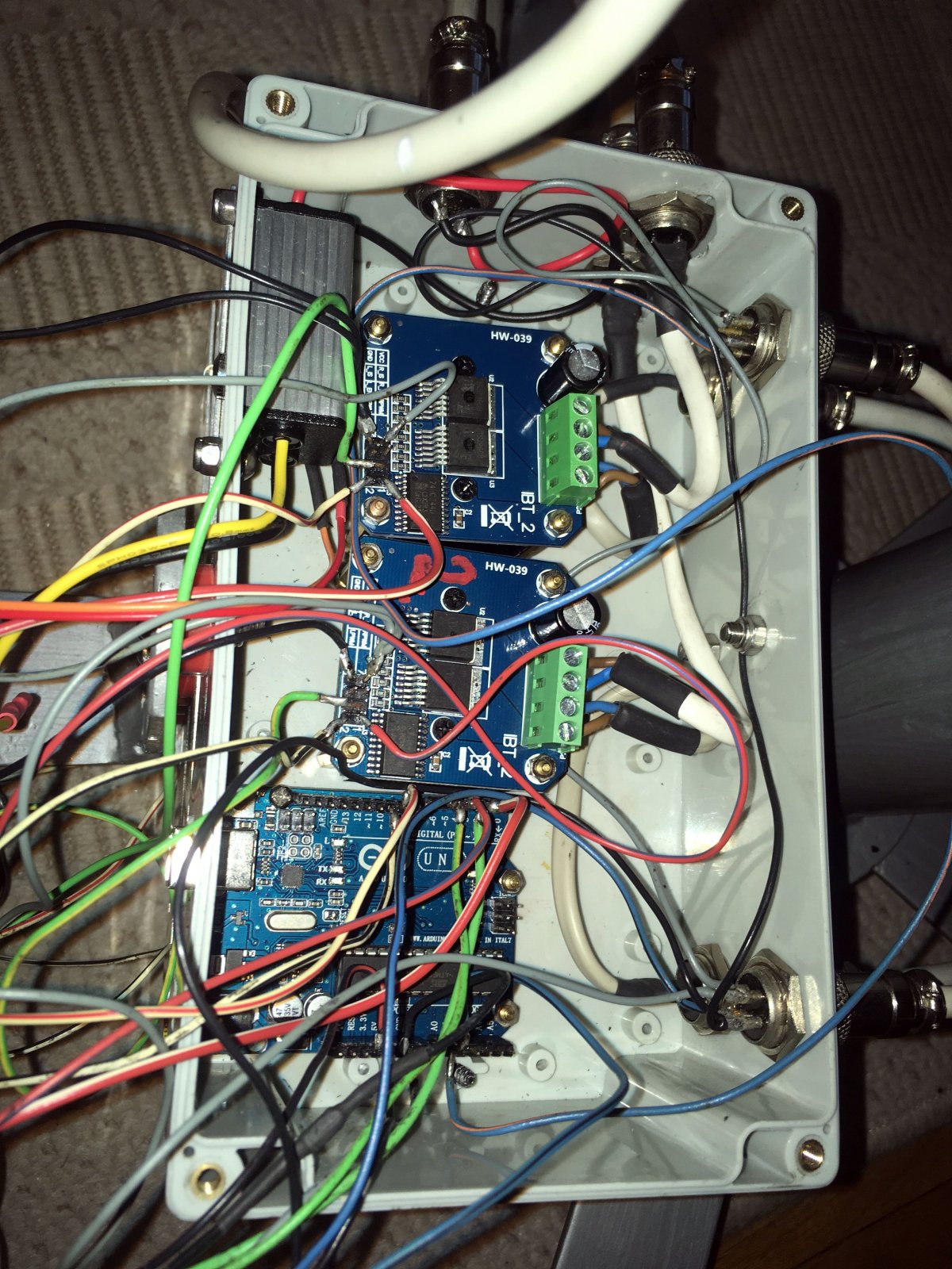

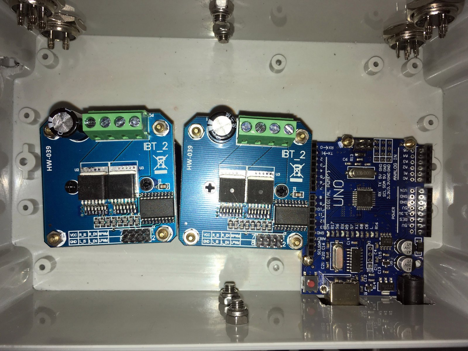

    Arduino and IBT-2 controllers:
    A rear wheel drive cardan shaft:

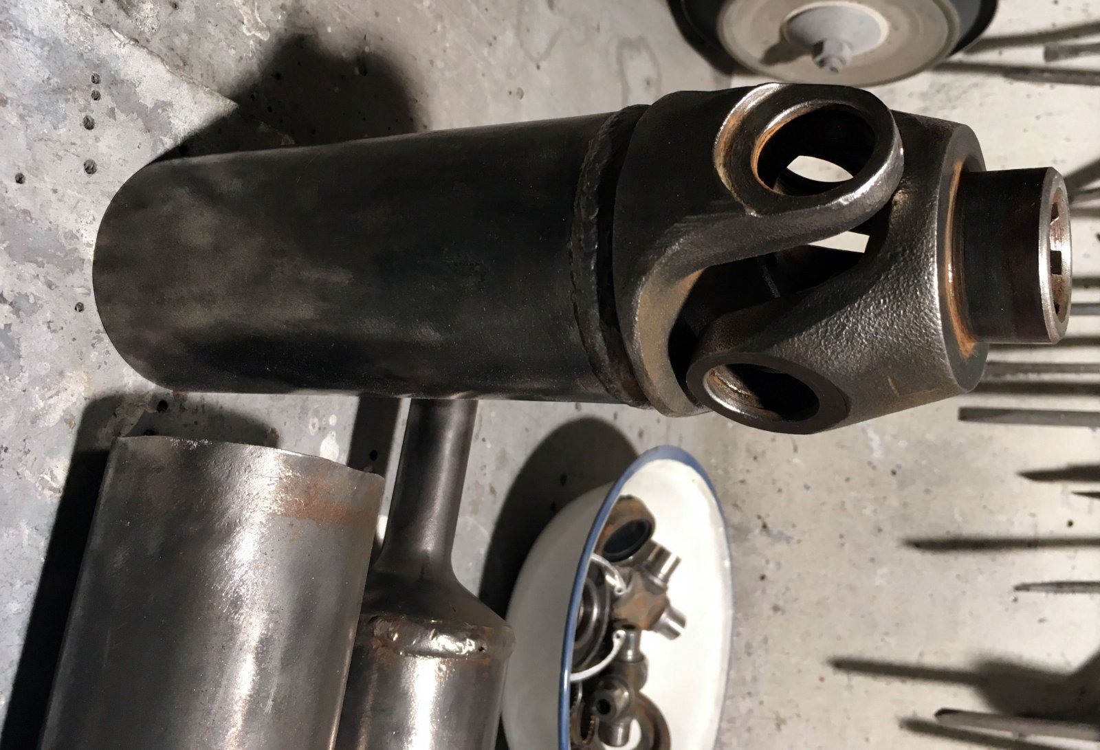

    A huge amount of work there was in front of me. :)

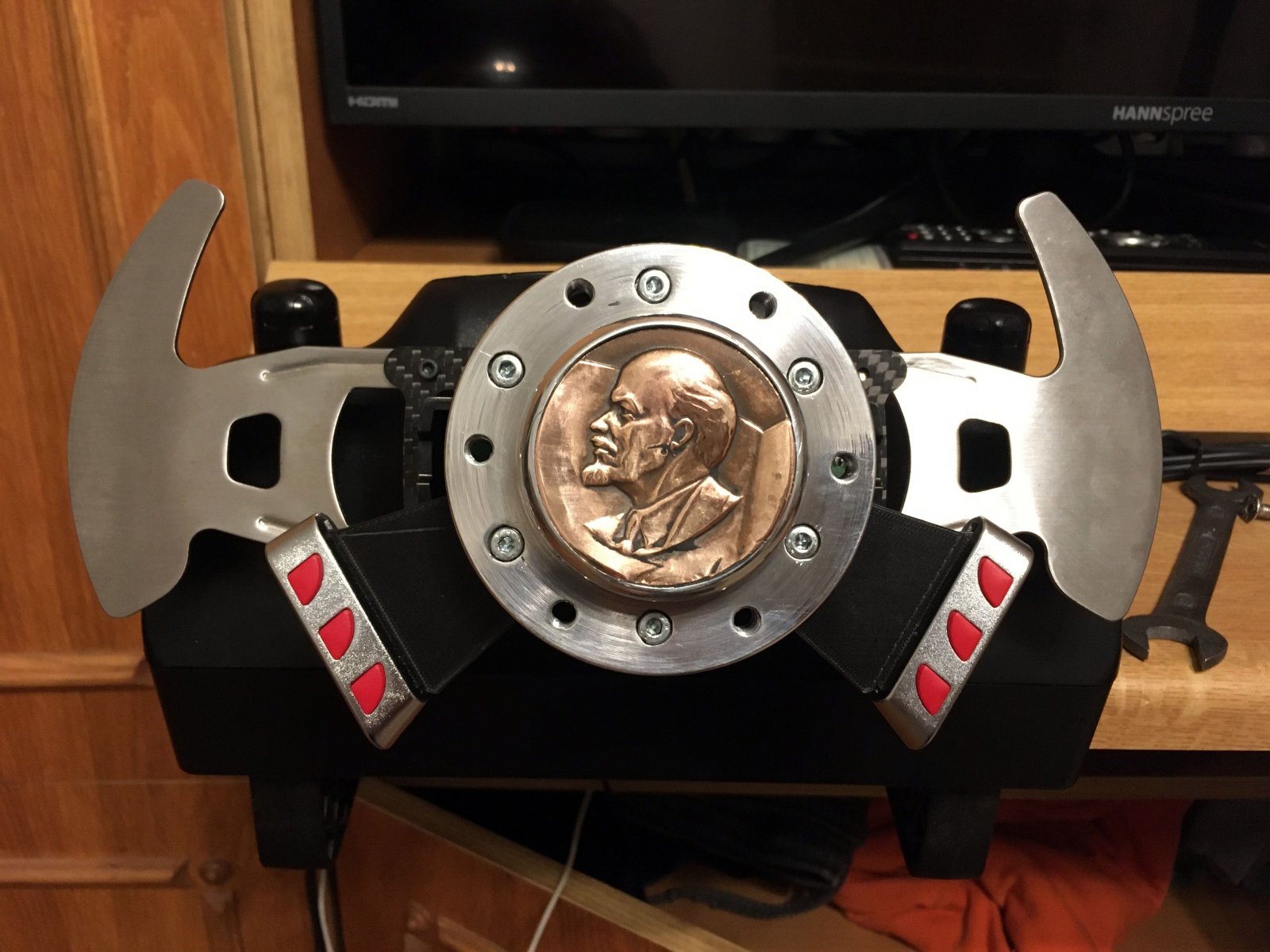

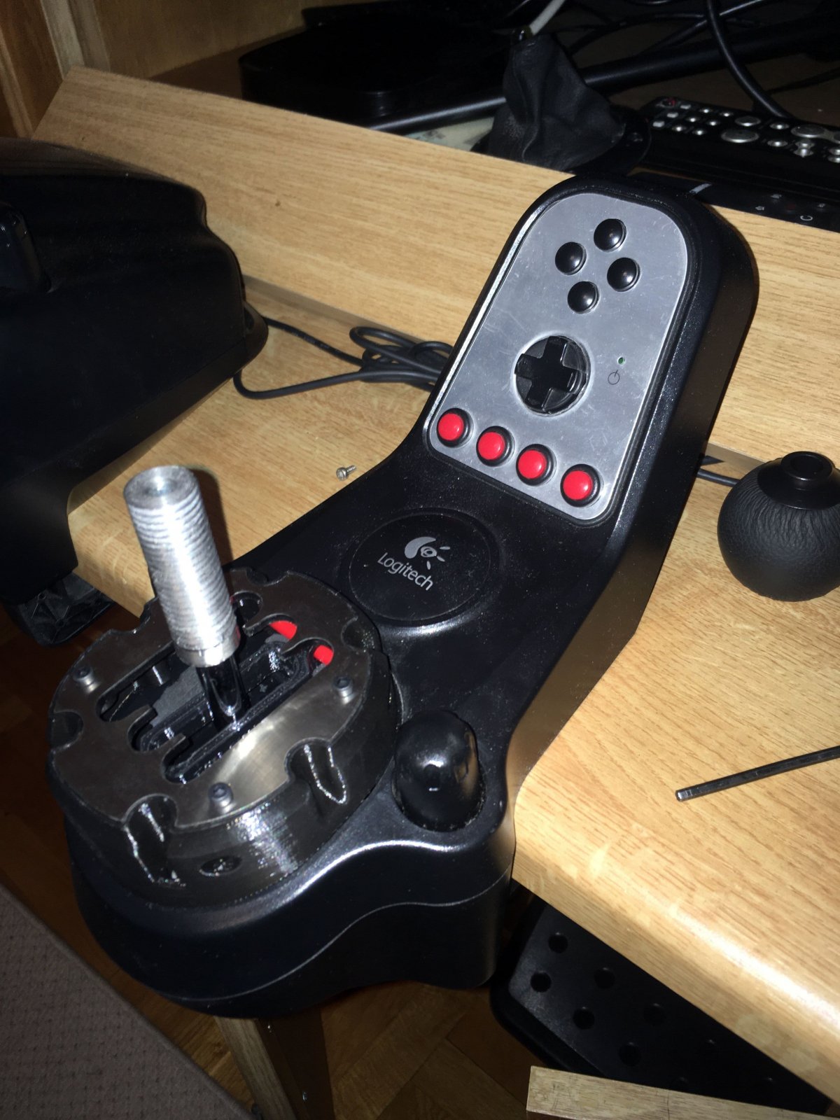

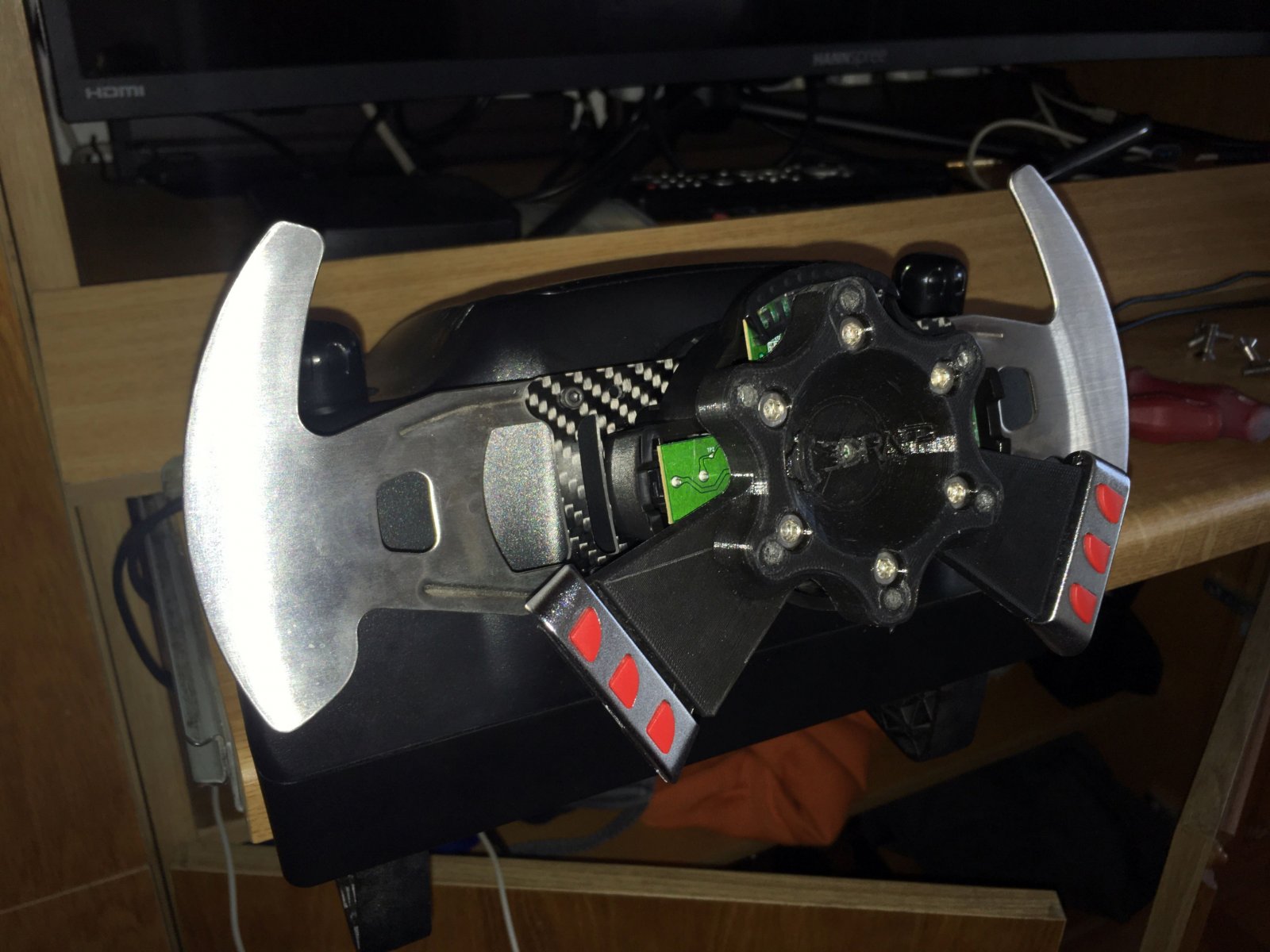

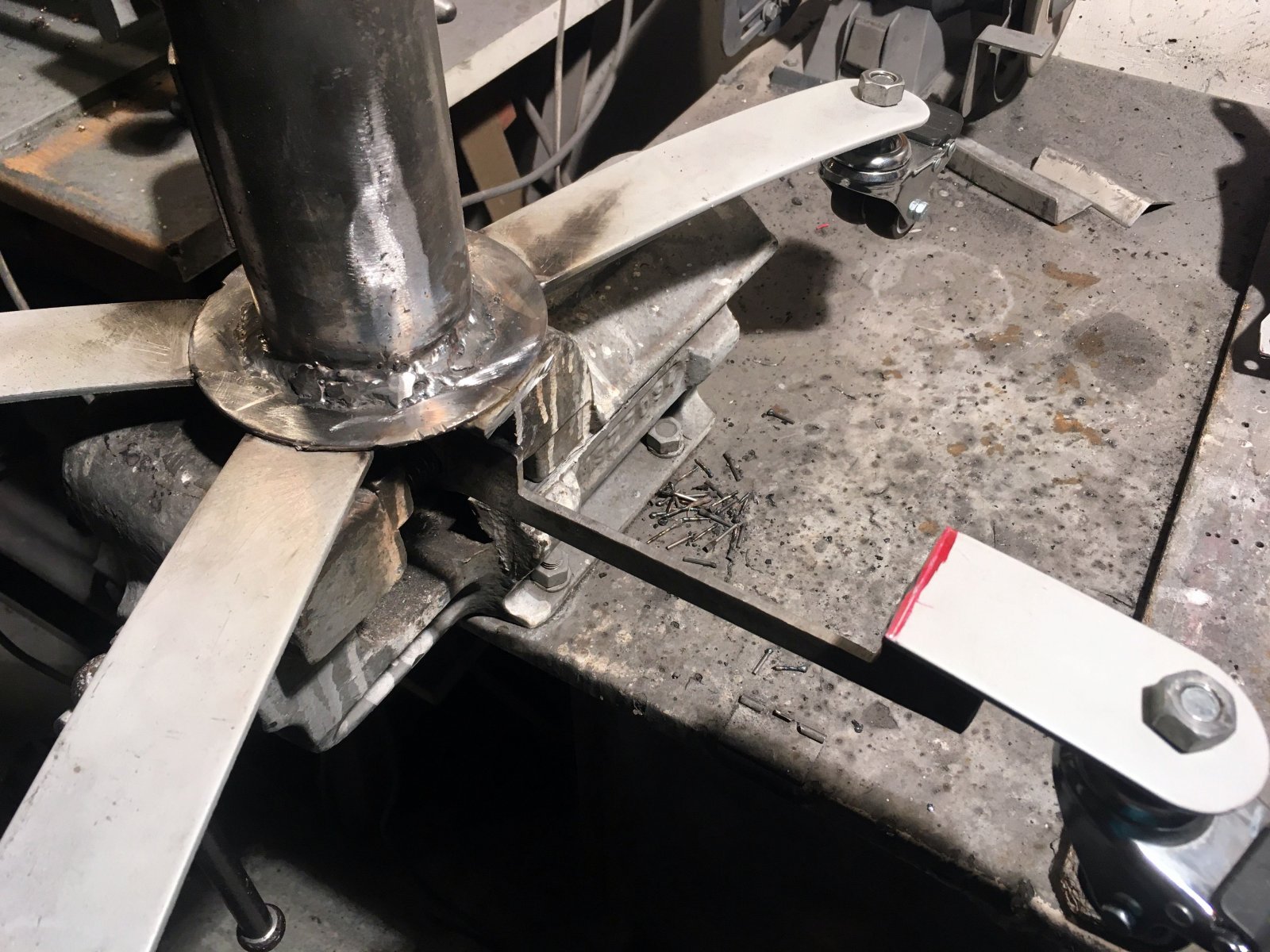

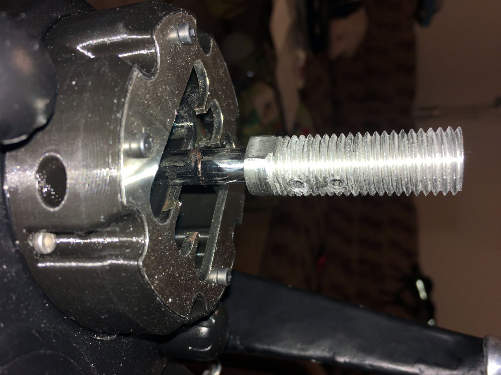

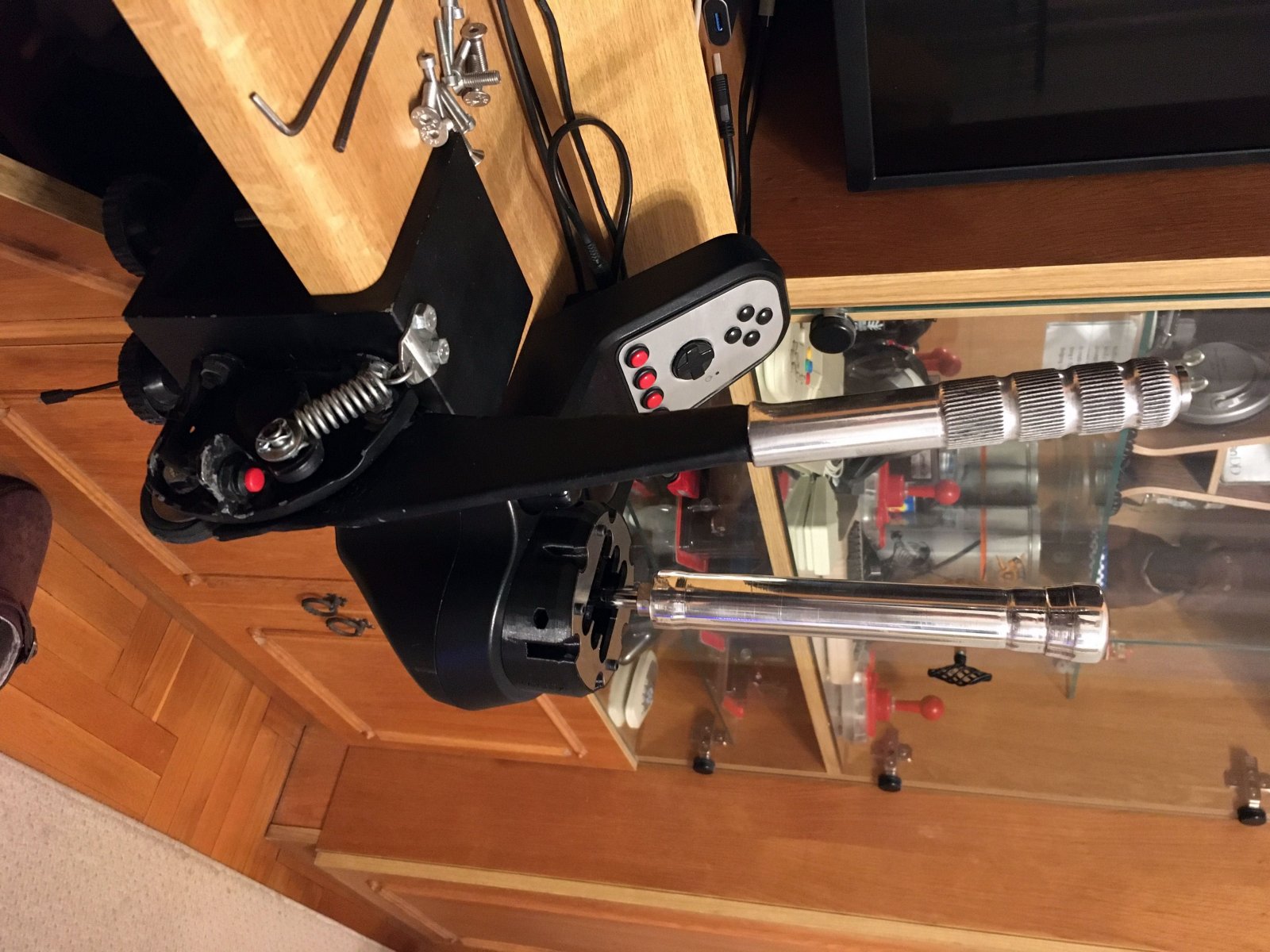

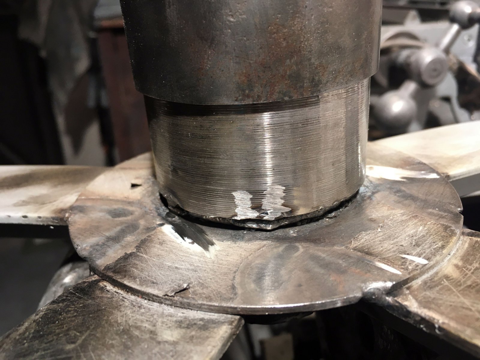

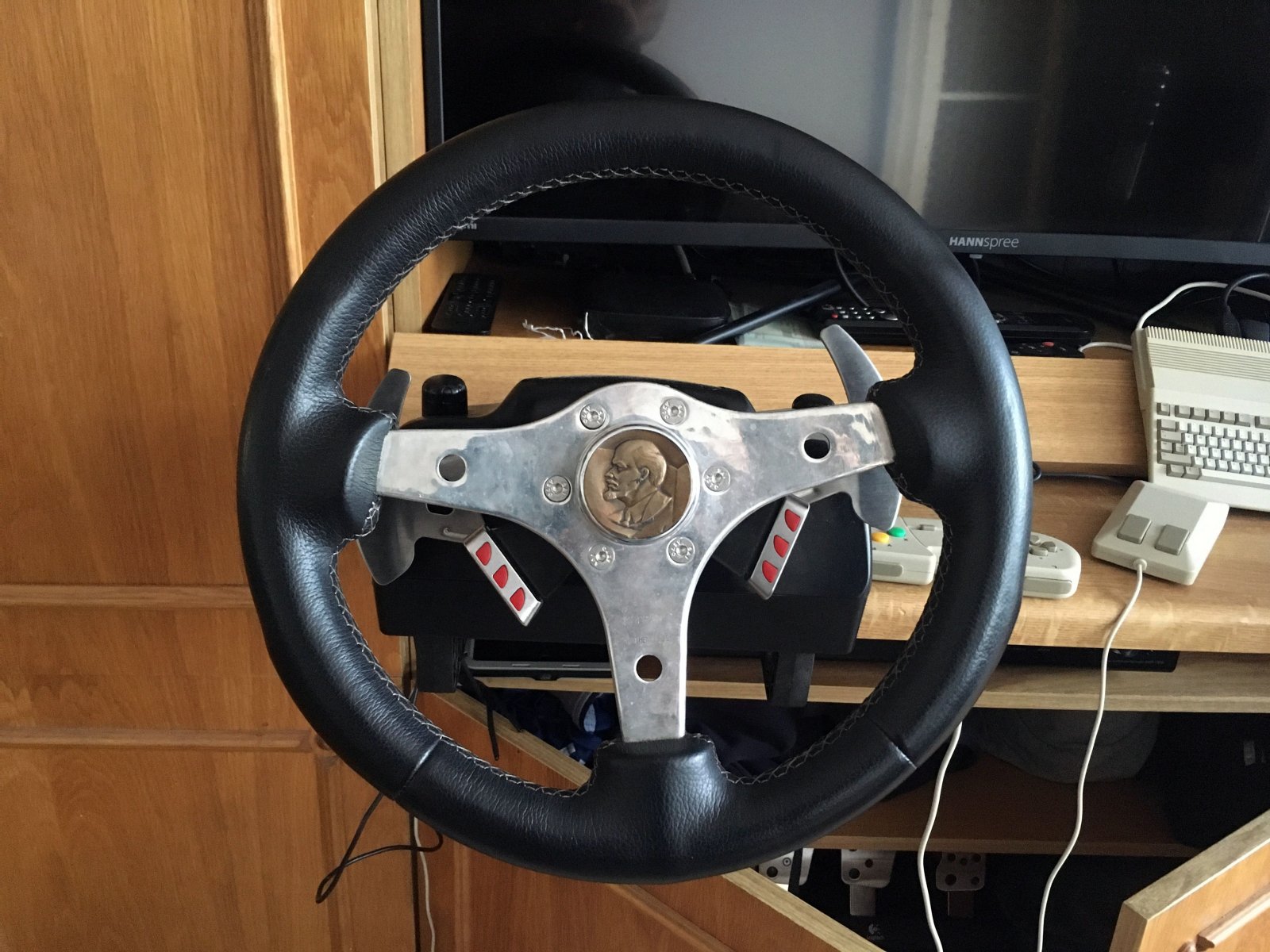

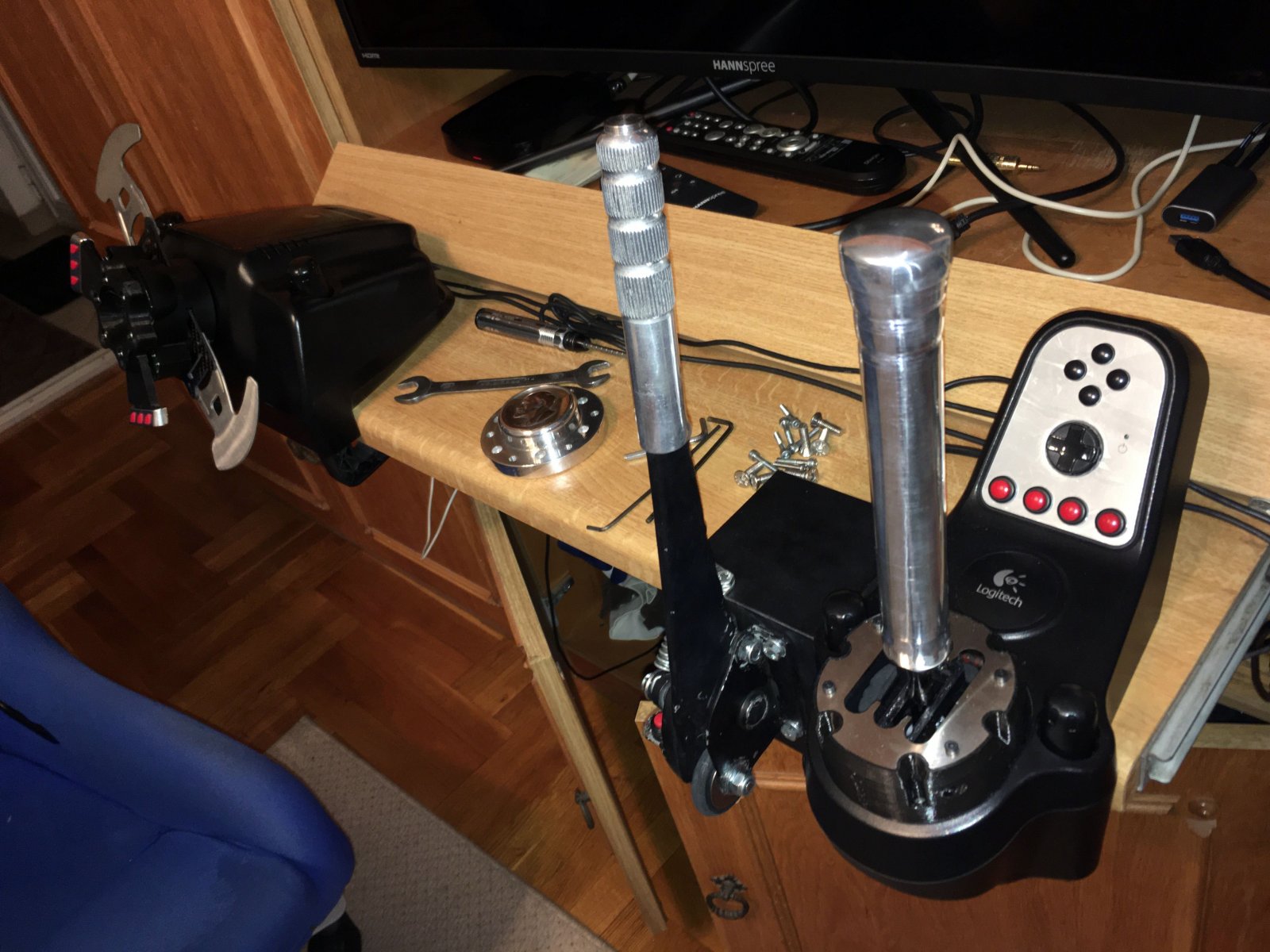

    During a lot of welding, turning and milling work
    I had modificated and upgraded my old Logitech g27 steering wheel.
    The little factory steering wheel was exchanged a
    real sport car steering wheel exactly the same as is there in my historic sport car:

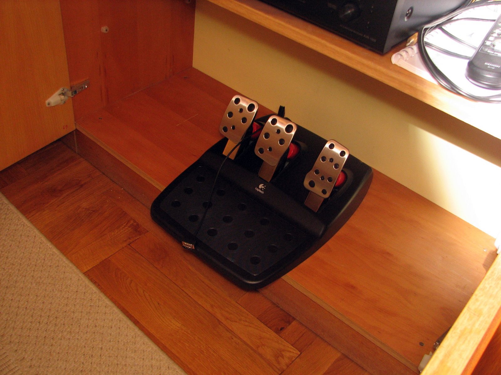

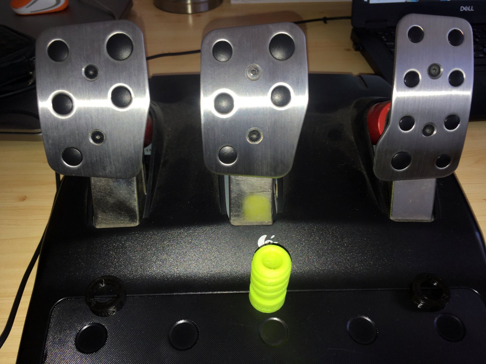

    Pedal upgrade:
    Steering wheel exchange:

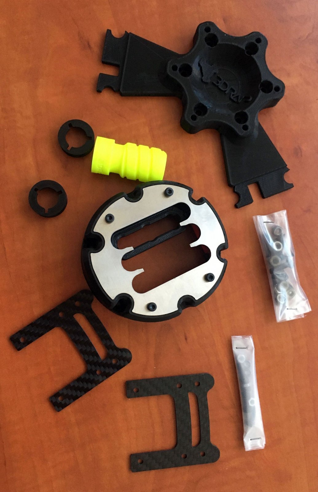

    And the modificated gearbox:
    Yes there is a home made handbrake too. :)

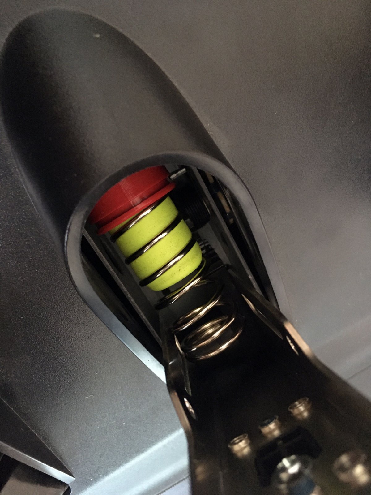

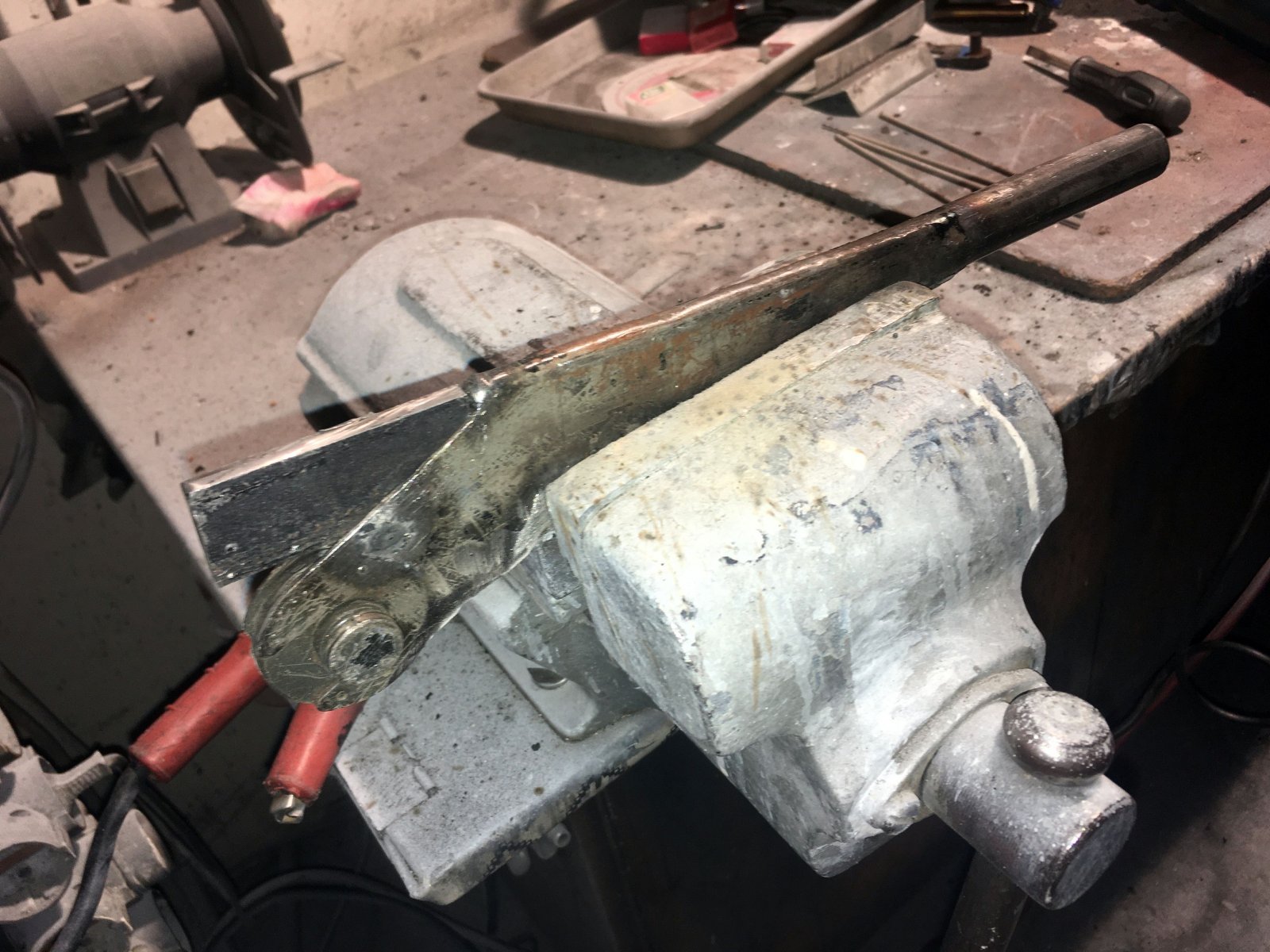

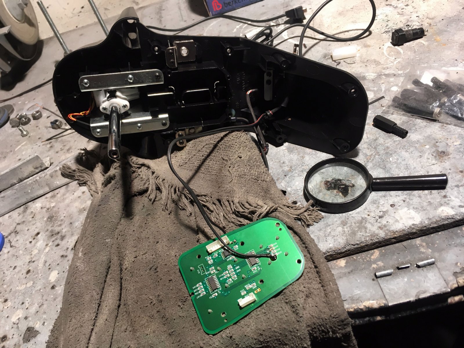

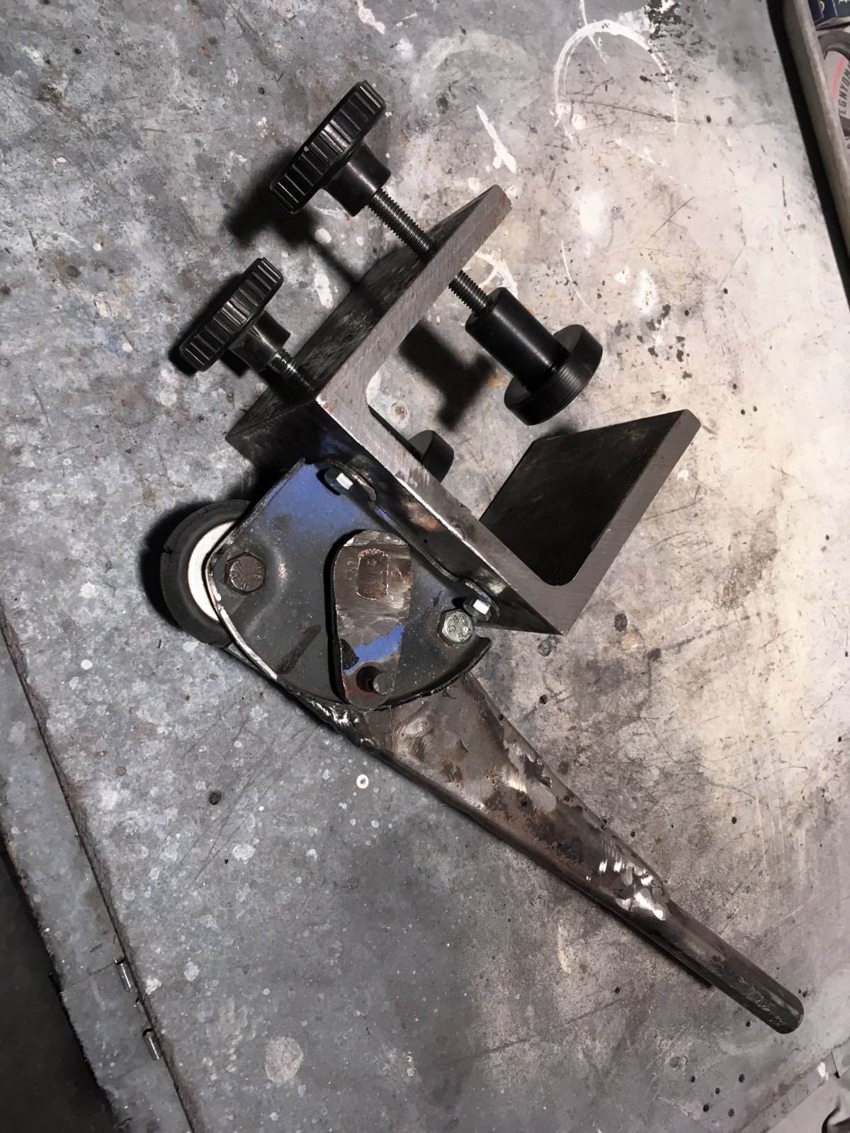

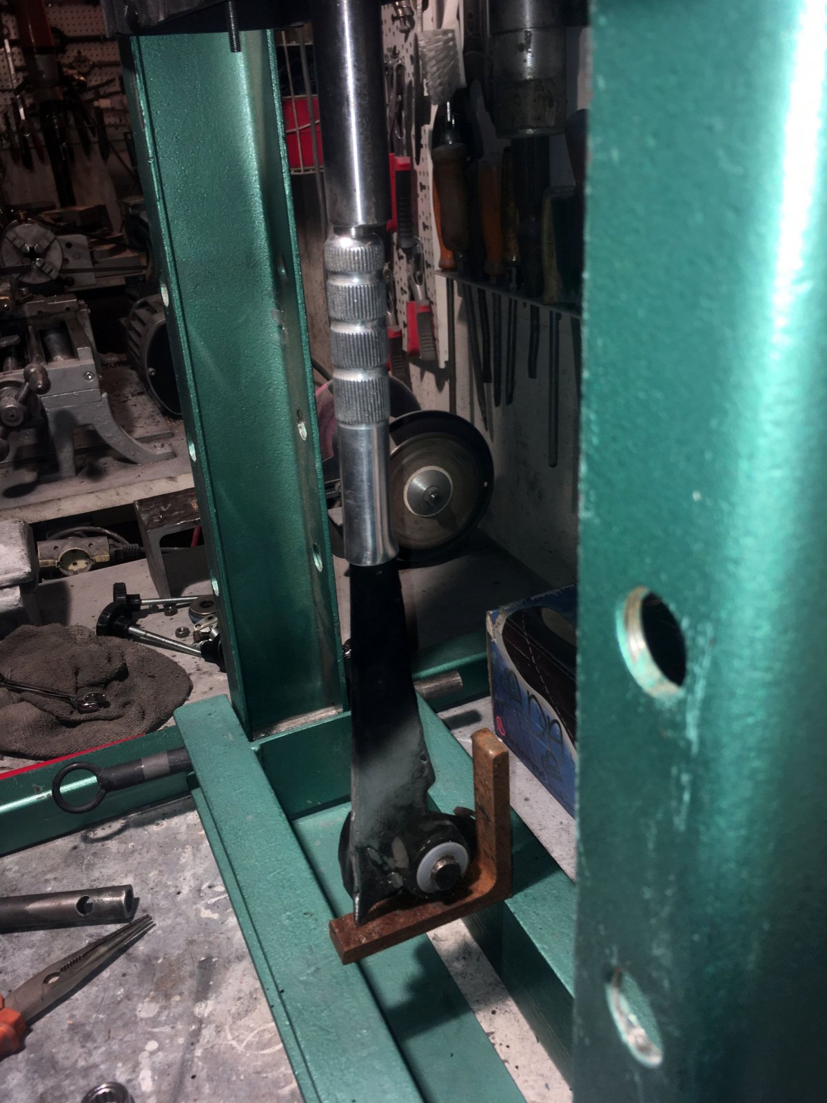

    I started to use again my simulator system and I really missed a handbrake.
    So I built one from a real car handbrake and some iron:
    It is only a push button handbrake now but I will upgrade it to a load cell-arduino axis working handbrake.
    I hope my plan will work. :)

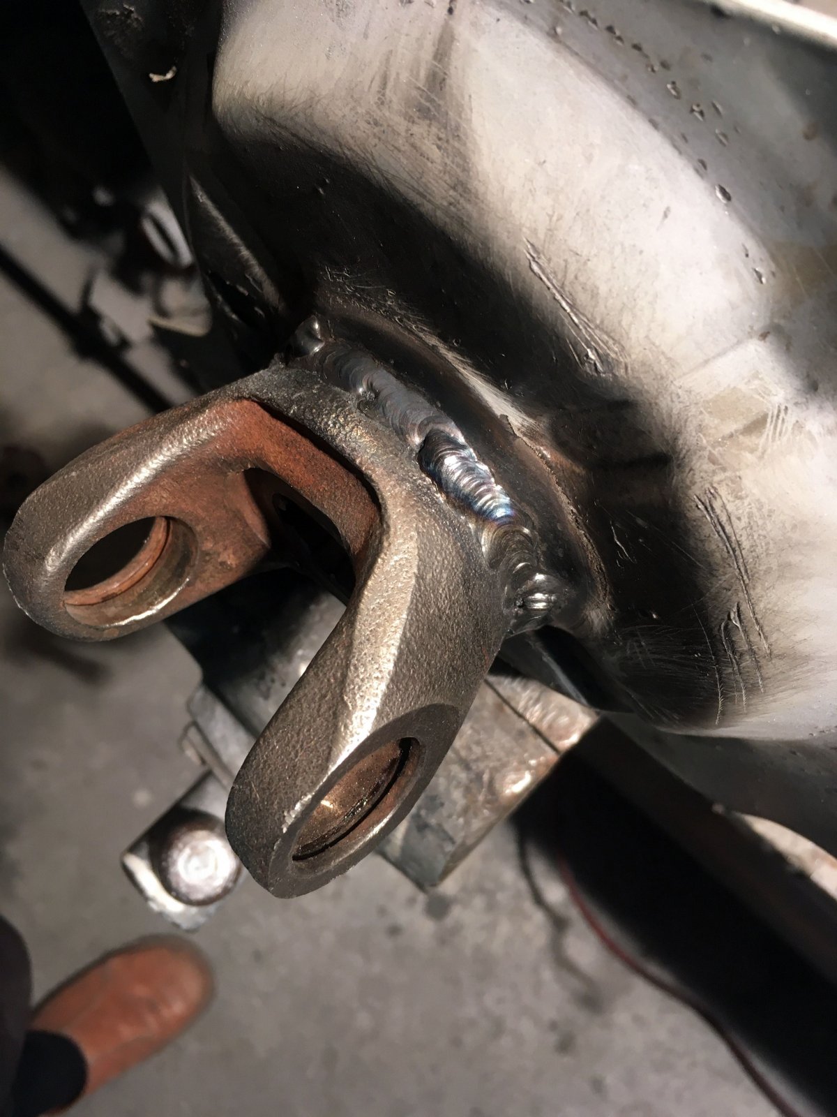

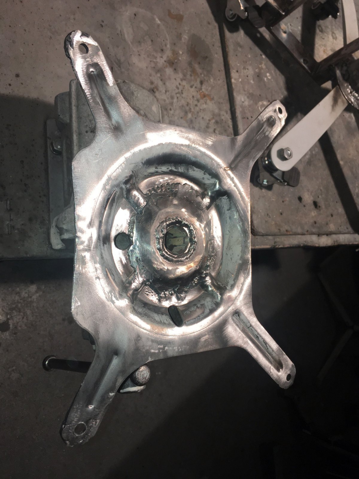

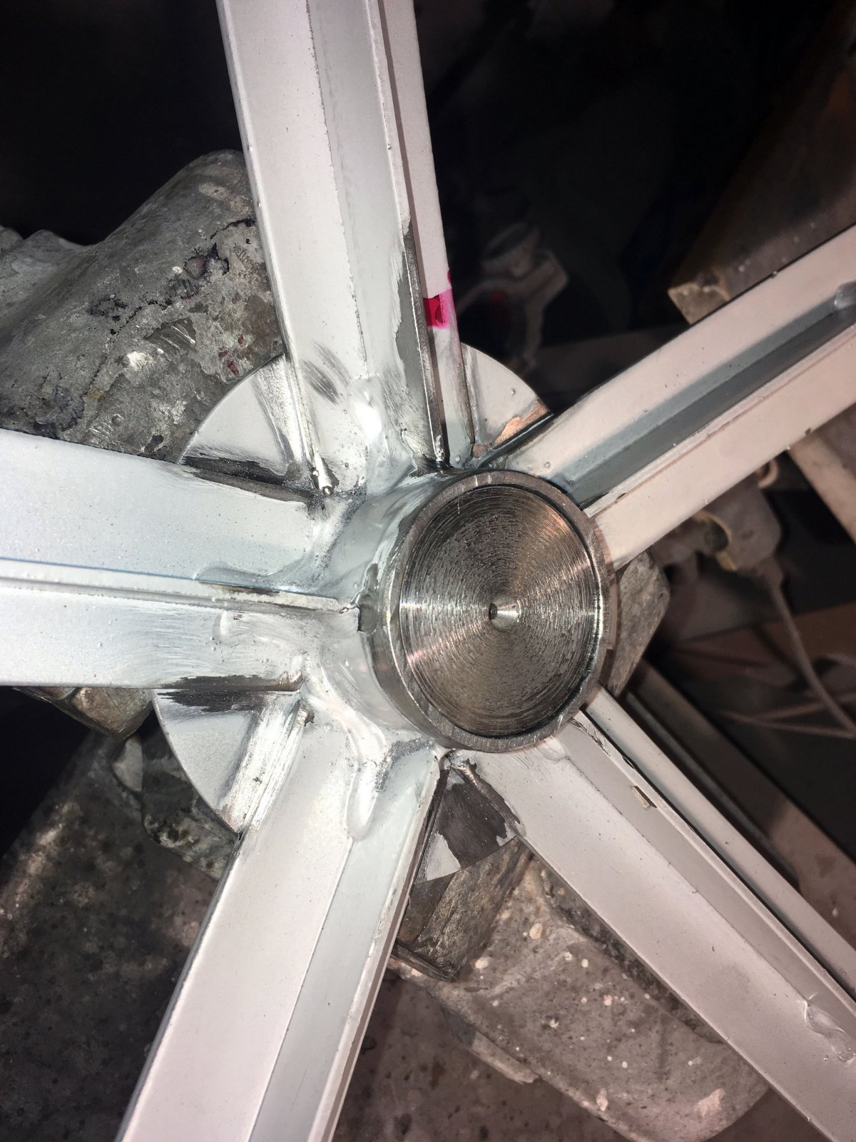

    Back to my motion seat.

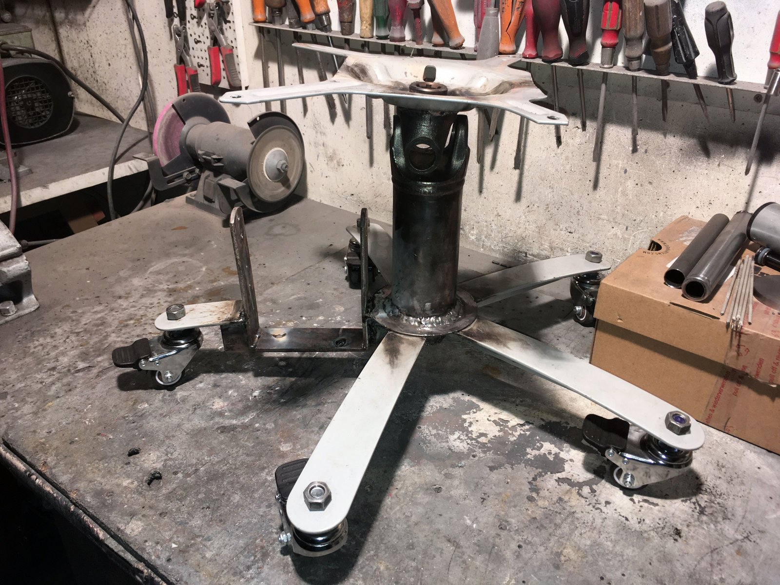

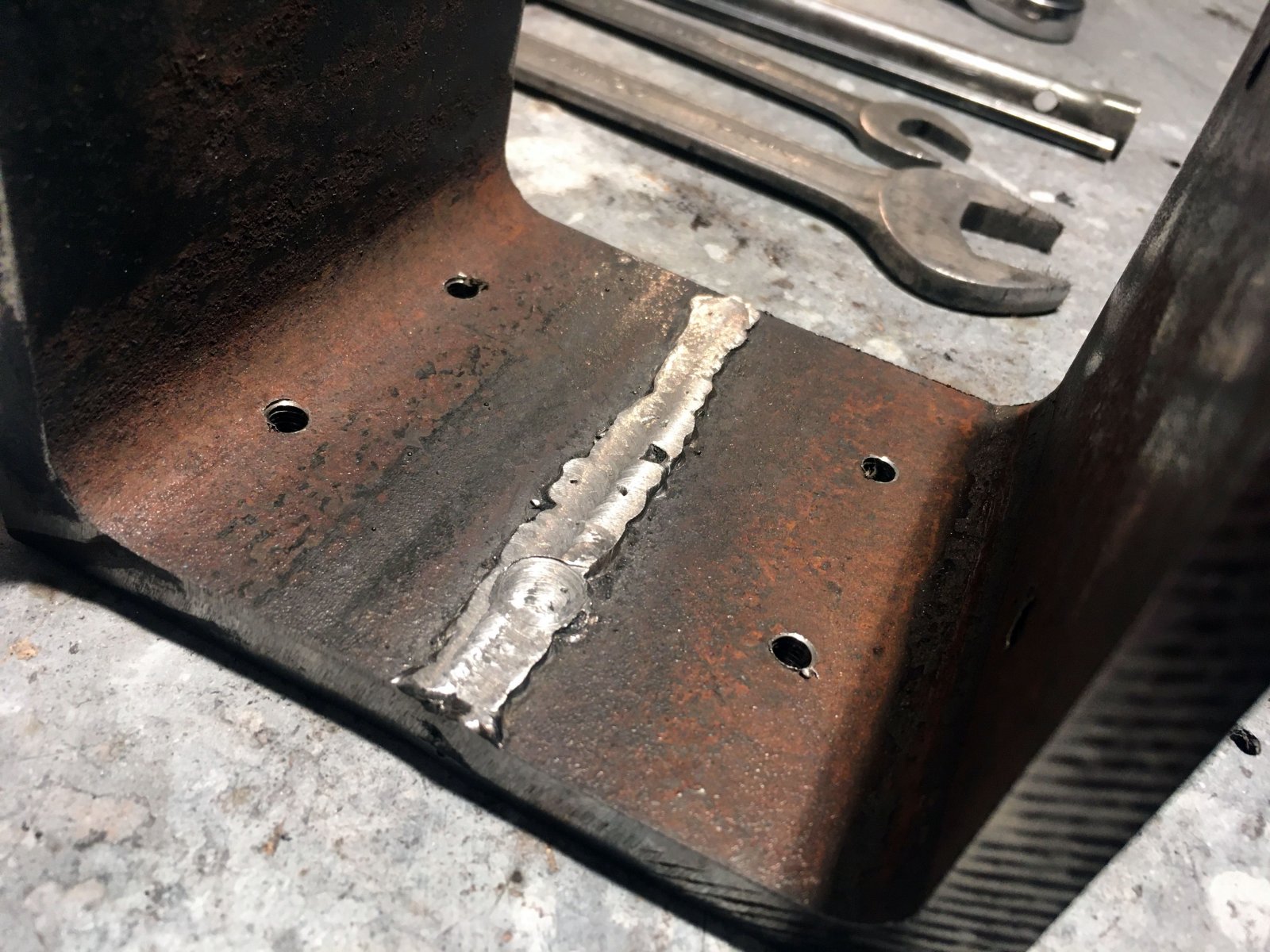

    There were a lot of welding work:
    After uncountable assembly and disassembly, painting was the next the electricity.

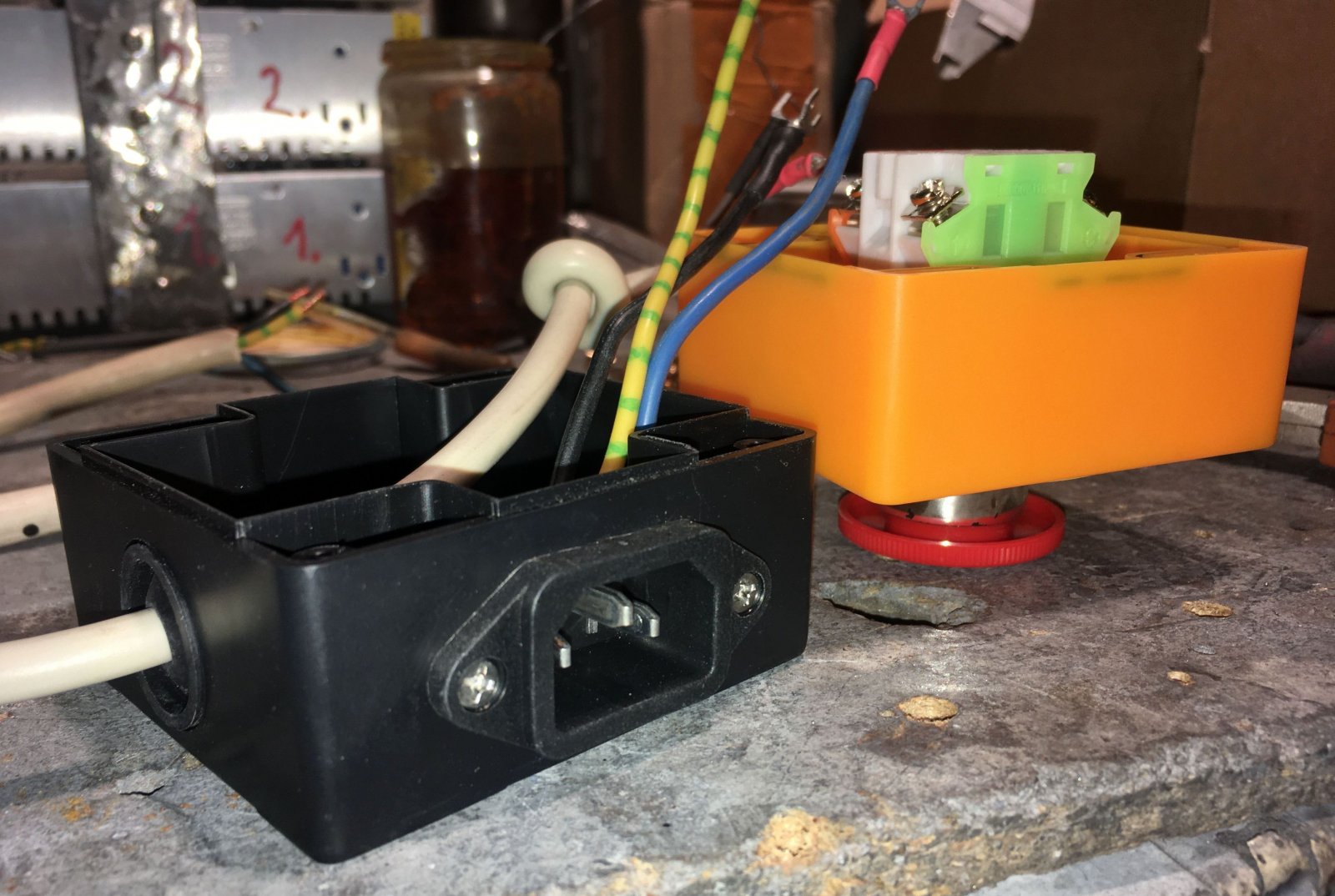

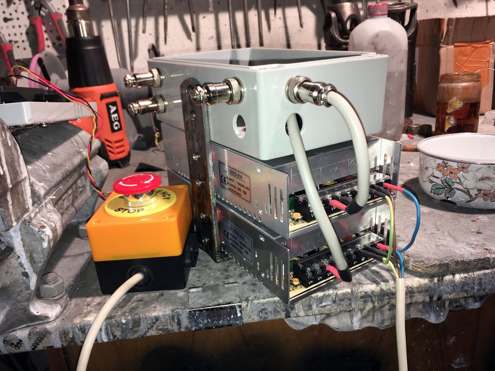

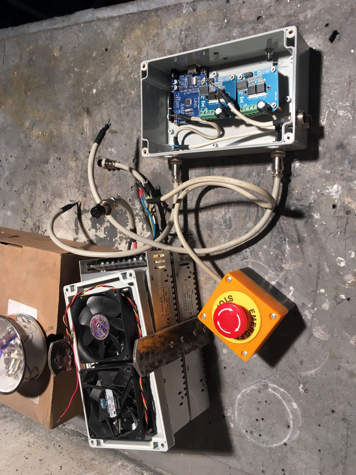

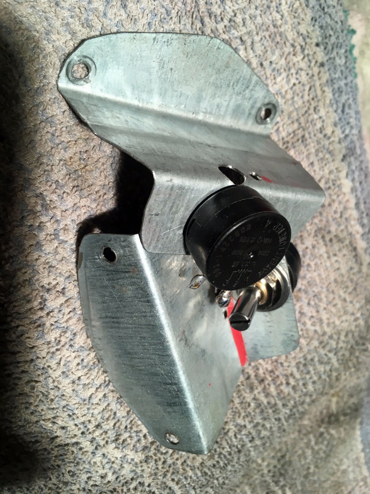

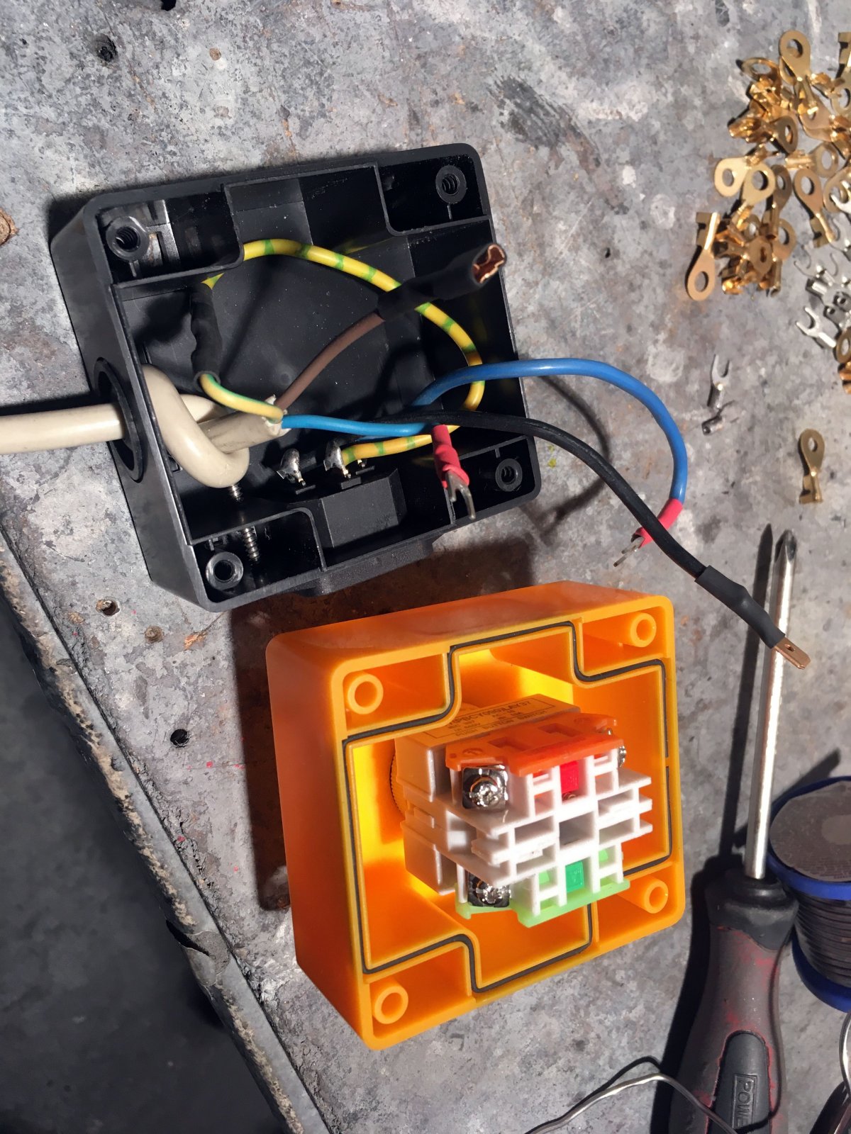

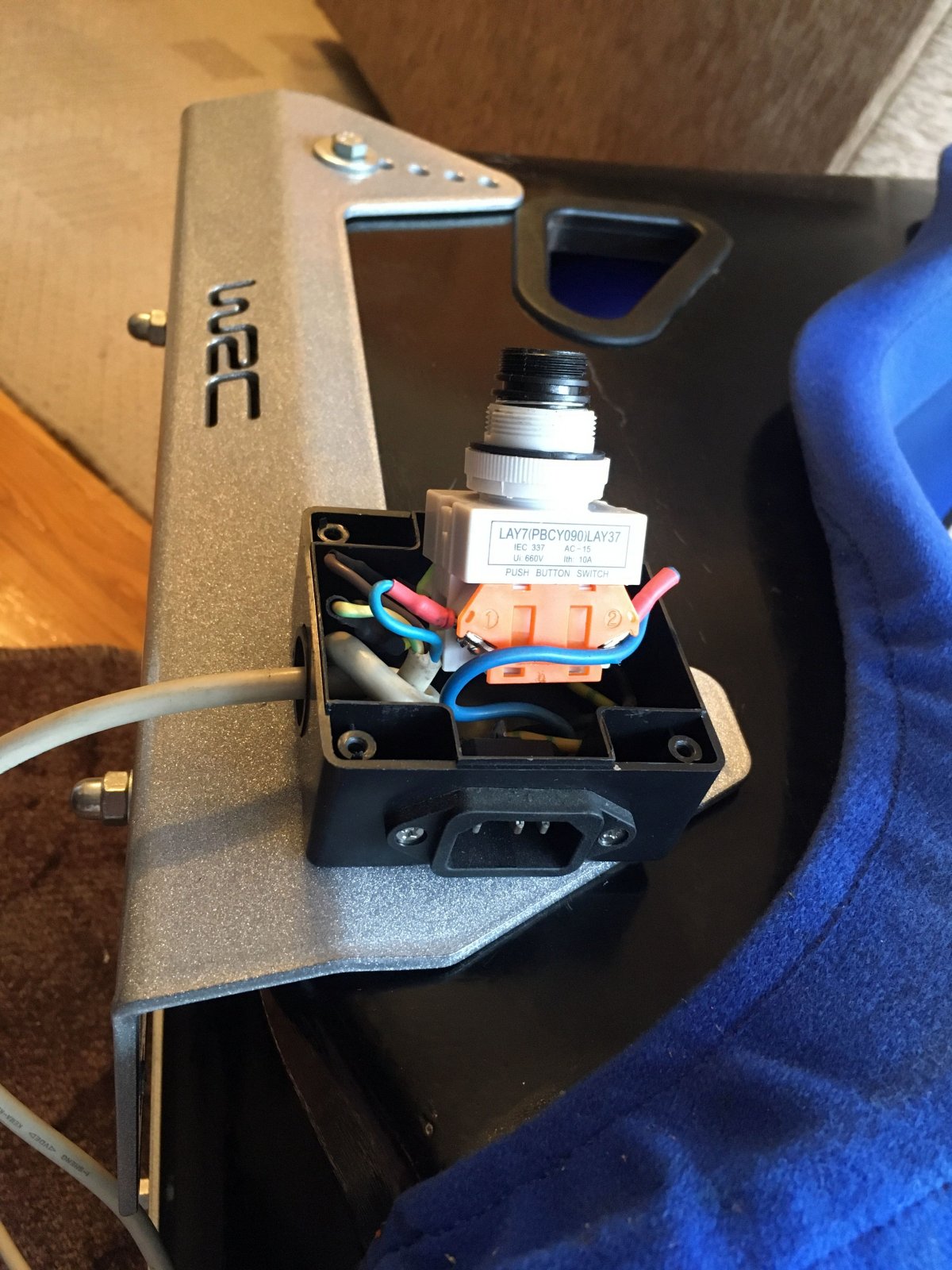

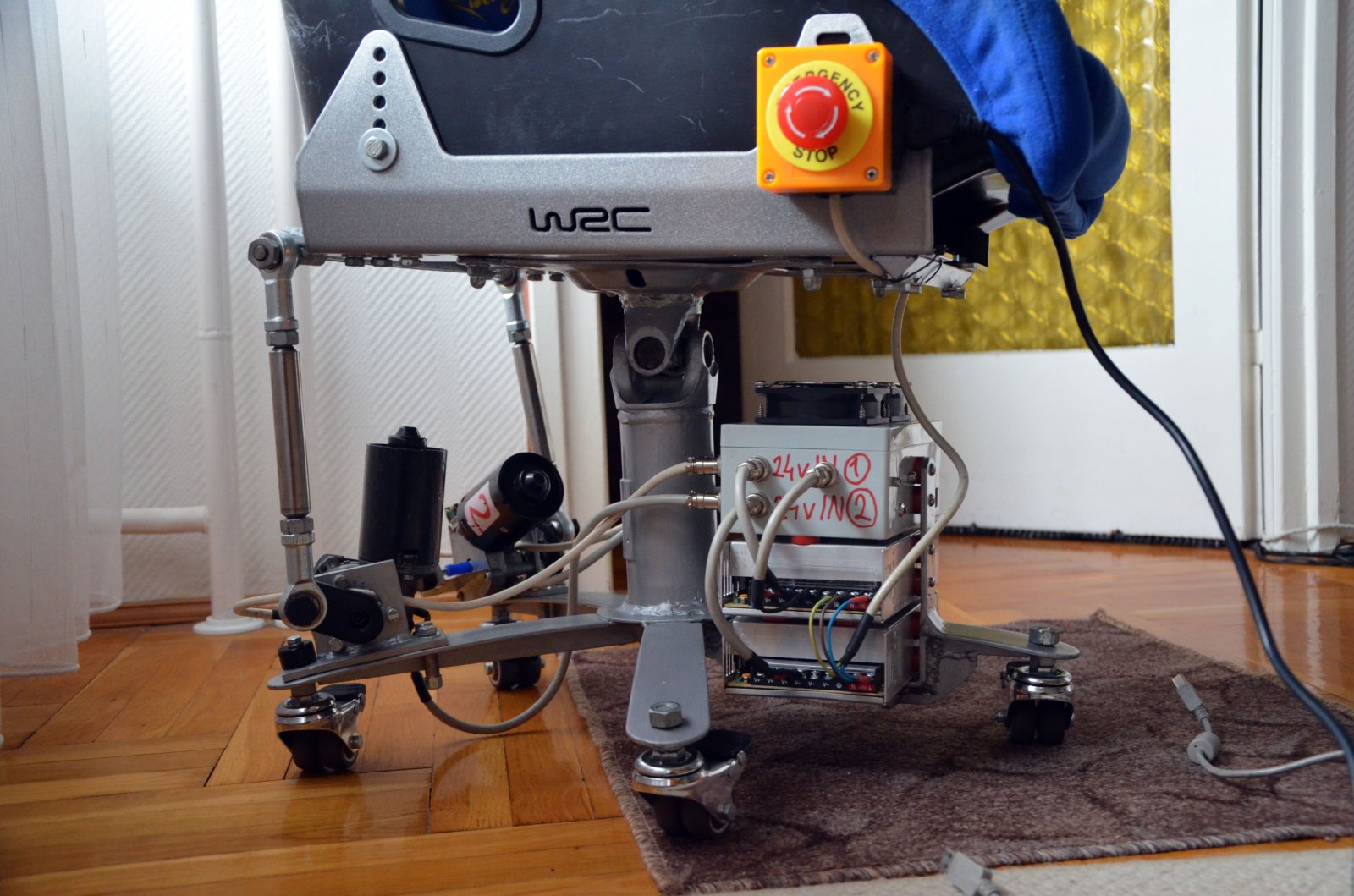

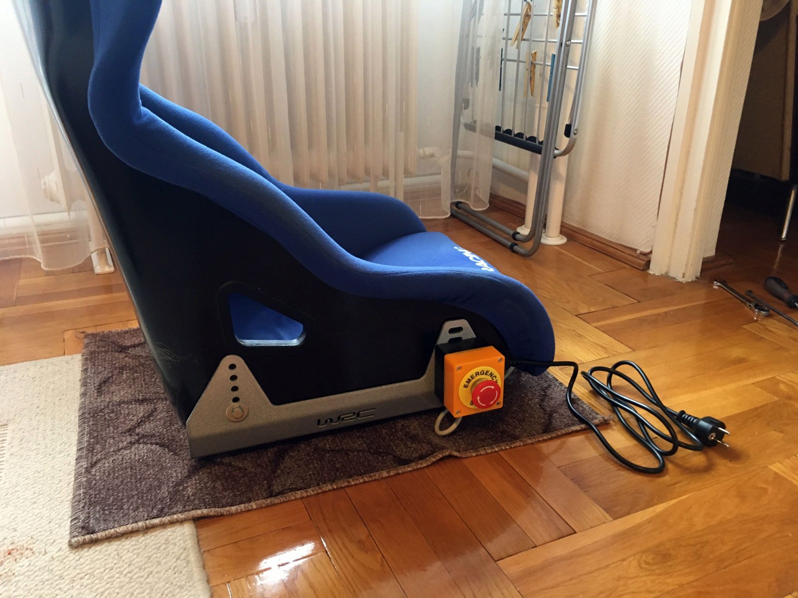

    Build an emergency switch off:
    Power supply and the control box:
    Wiper motors install:
    Hall sensor potentiometer and its console:

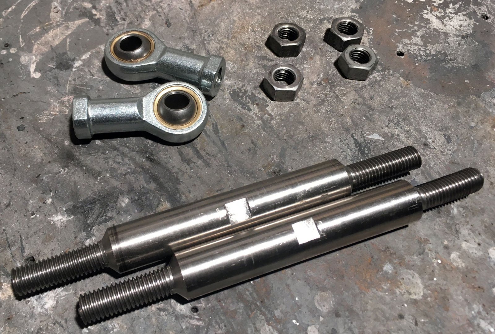

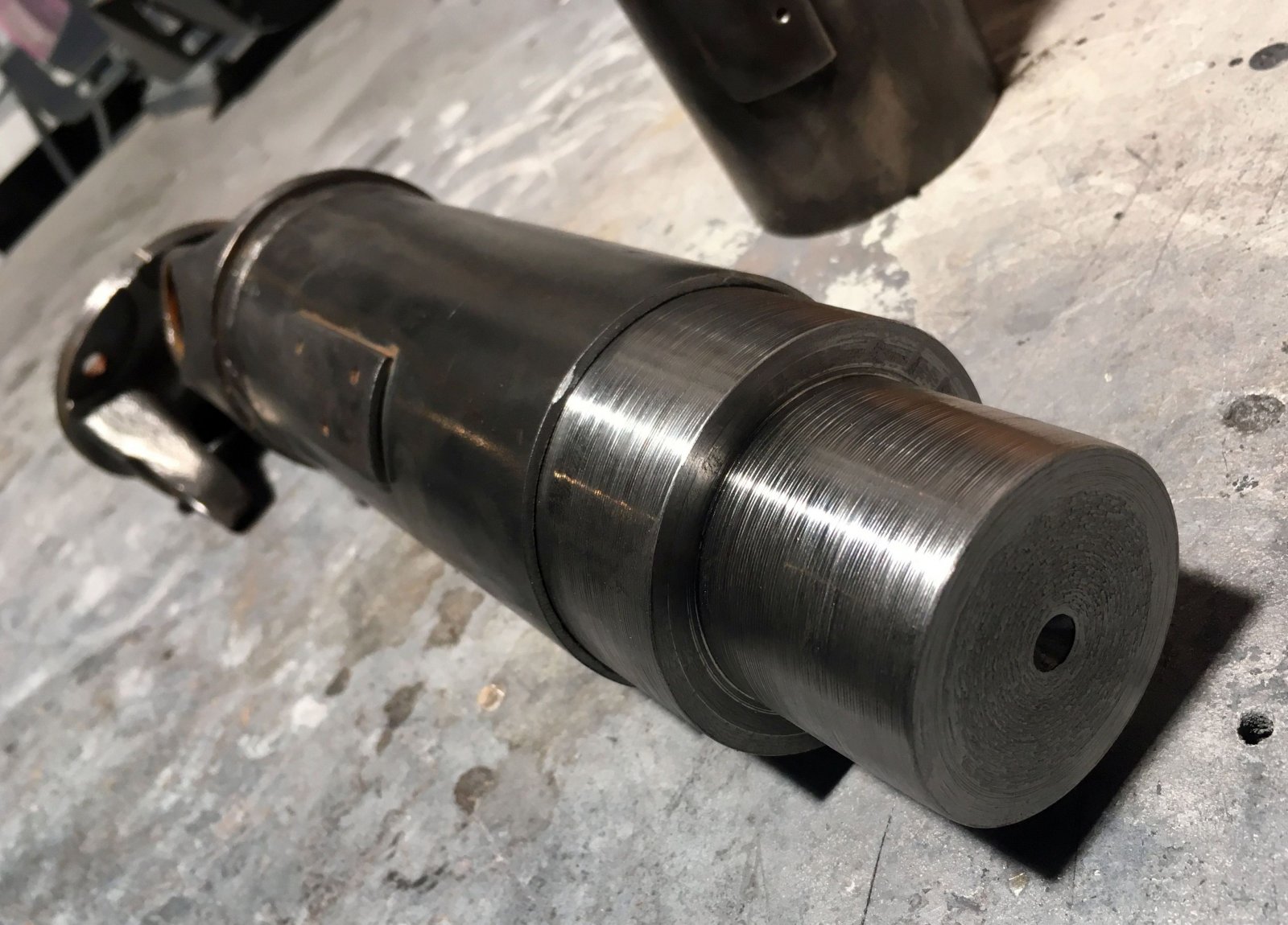

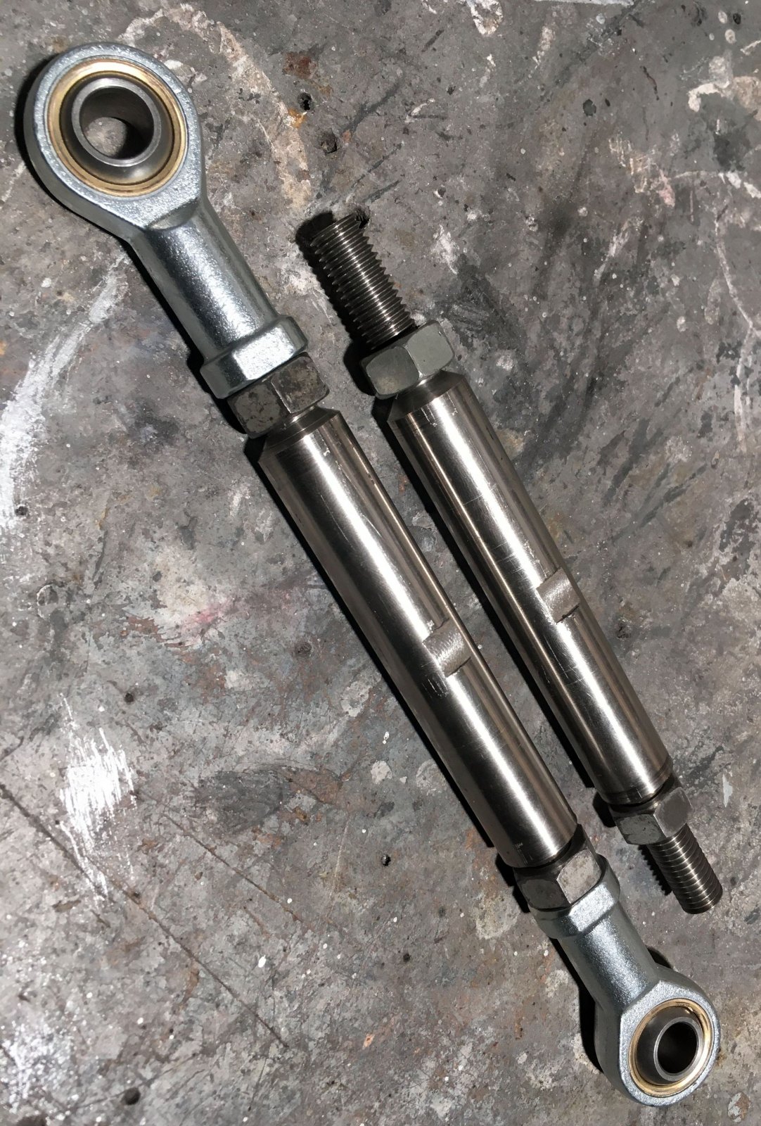

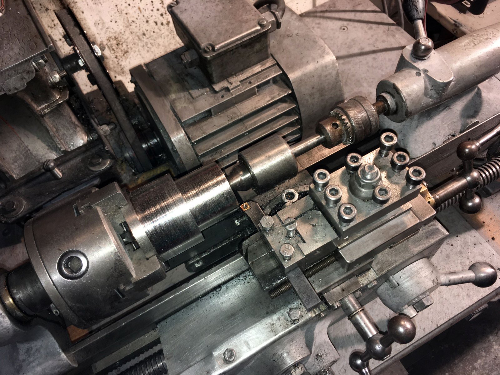

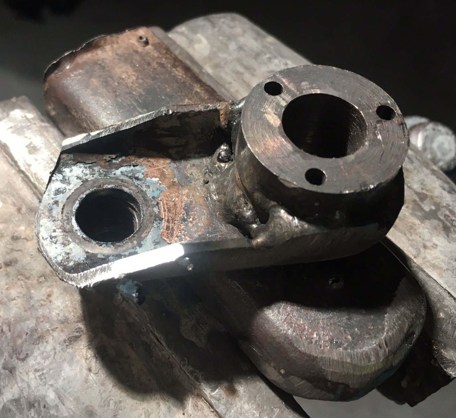

    Some turning works for example pushrods:

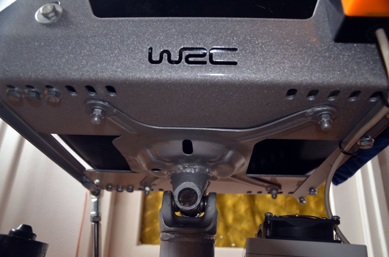

    And the cardan shaft mounting:

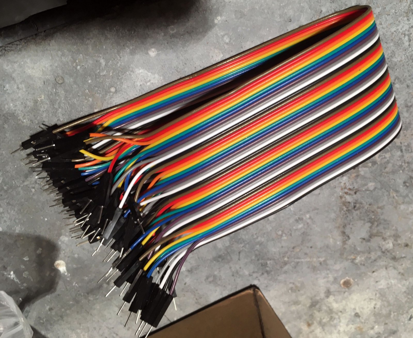

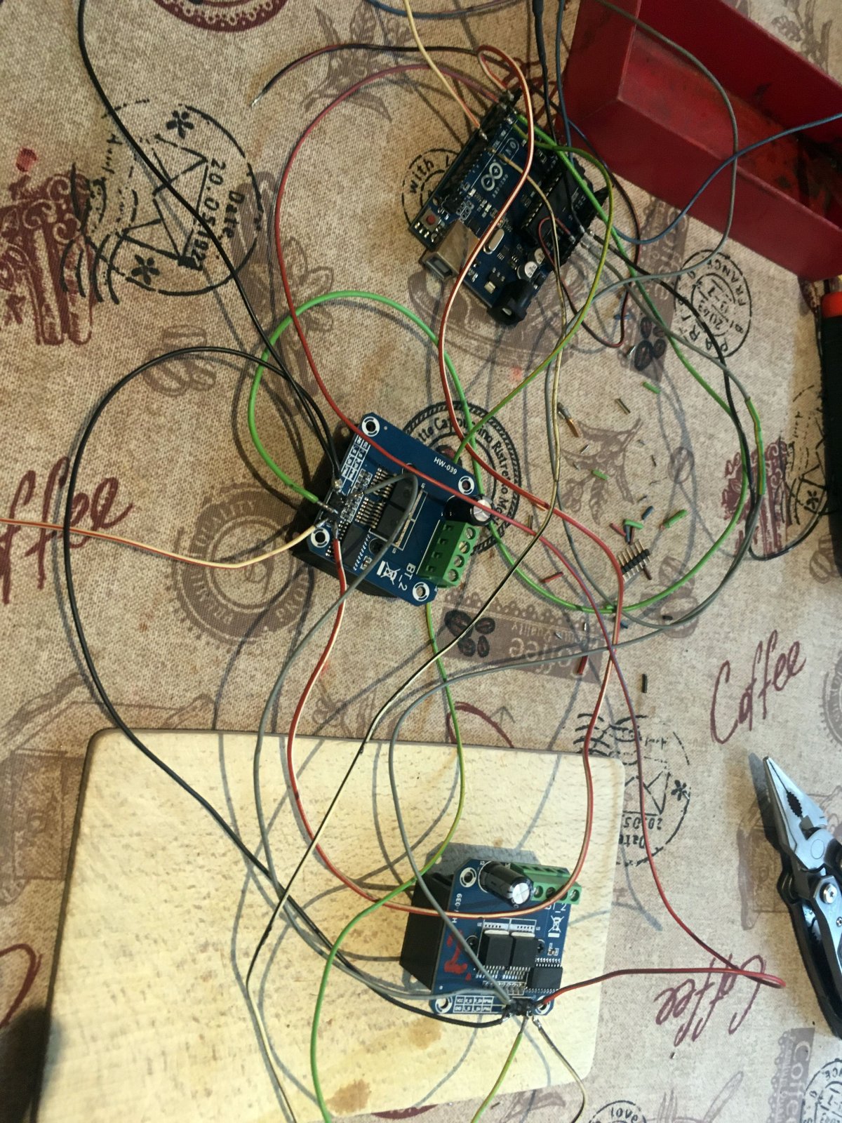

    Finally I had assembled the whole seat and the next step was the set of problems what there is the begining in my post (thank you for your help and your time @noorbeast).
    I had to go back to the begining and rewire the whole system....
    This type of chinese wire is a piece of shit:
    There were broken internal wire and one of my motor did not work...
    I had to replace all the wire from a car cable set.
  9. szczgyula
    szczgyula New Member Gold Contributor
    Feb 22, 2023
    23
    117Coins
    +9 / 0 / -0

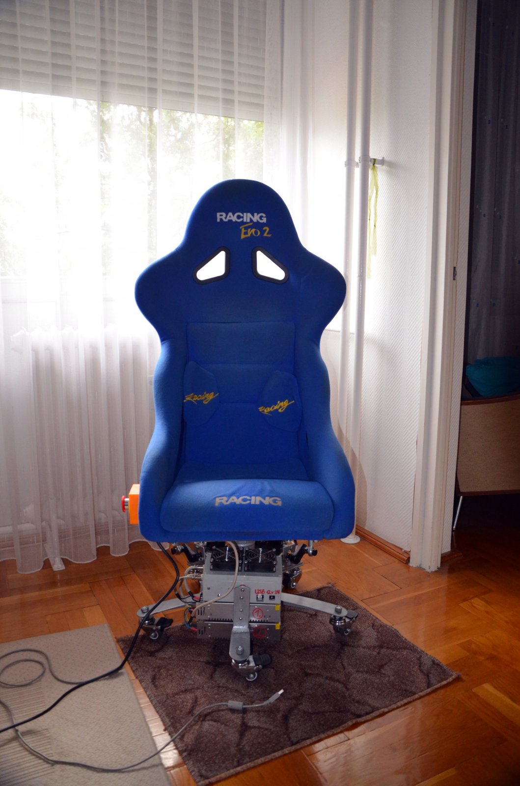

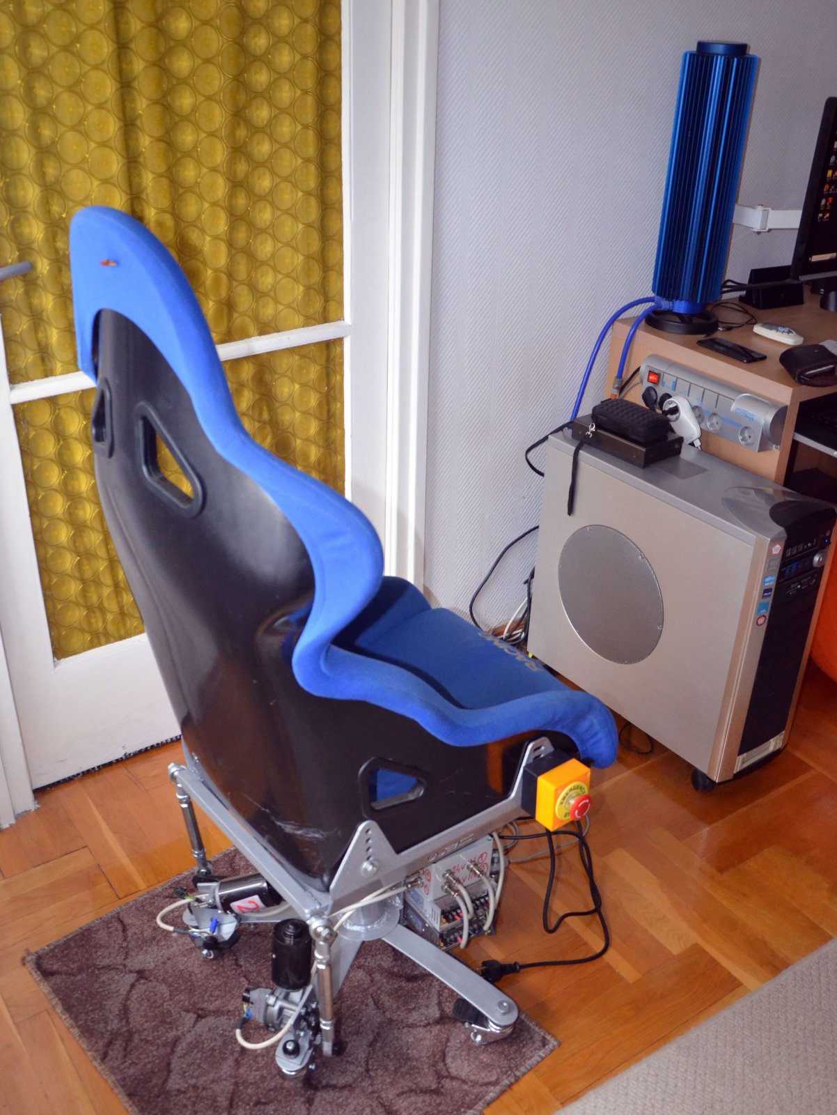

    This is the actual state of my very compact 2DOF motion seat:
    Now I am playing a lot in this seat, however, I am planning to develop it to a 3DOF motion seat. :)
