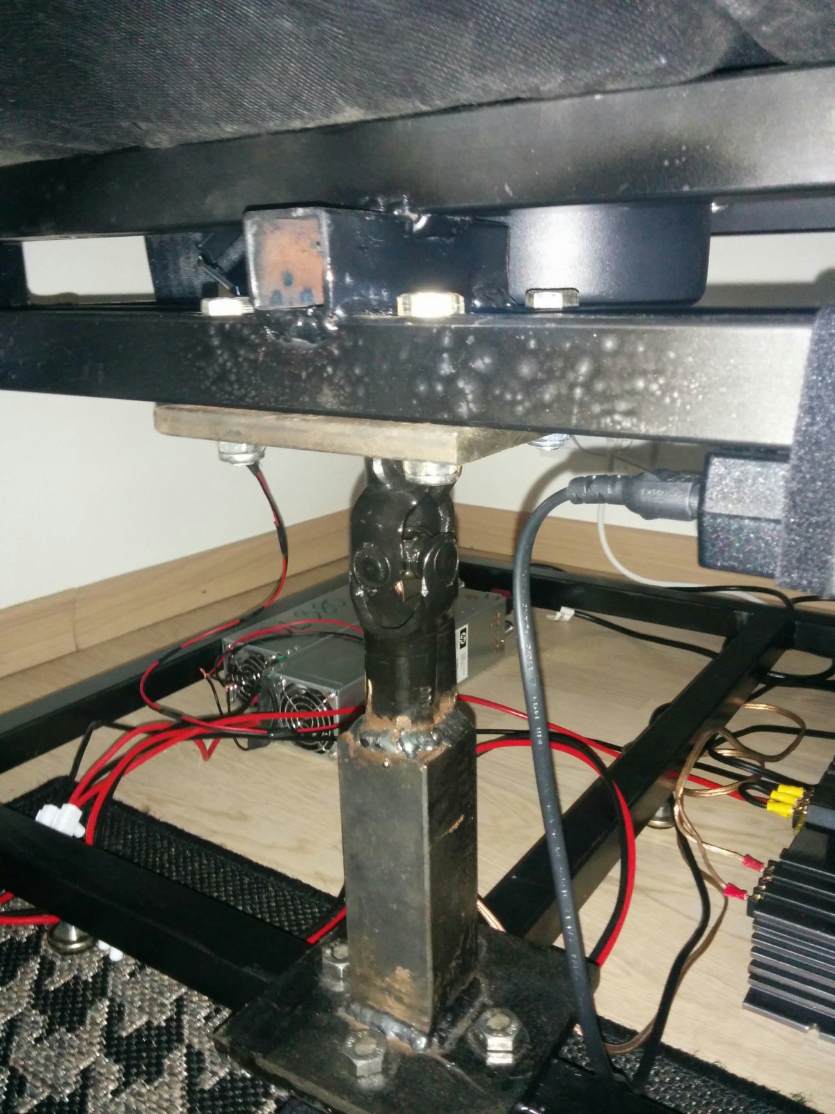

    I really need to get bigger U-joint as the sim is swinging side to side really badly.

    It sort of looks like the existing uni joint post is twisting under load.
    I found with the Rift that small but more defined axis movement gives the best experience, so now you have it moving you can work on refining your motion profile.

    The u-joint post is solid steel, but the U-joint itself is pretty small. It's from a steering wheel column. It is the part that allows the swinging. I'll have to pay a visit to a scrapyard to see if I can find one from a cardan.

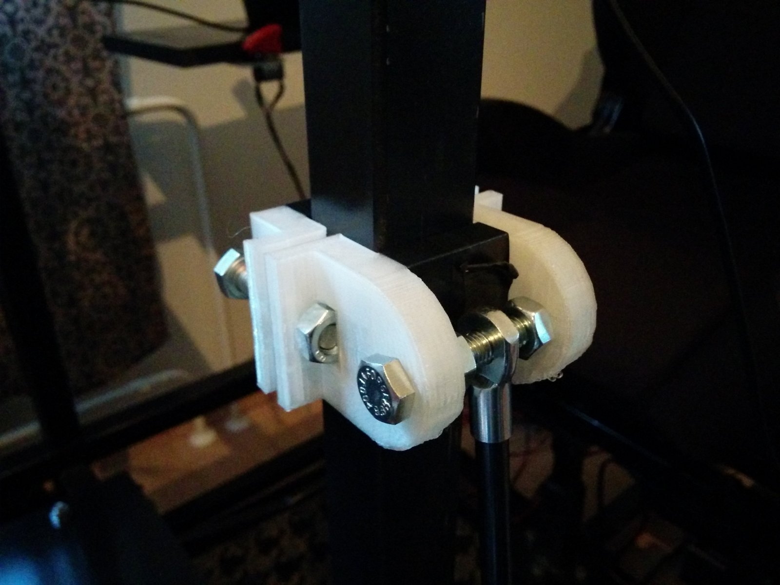

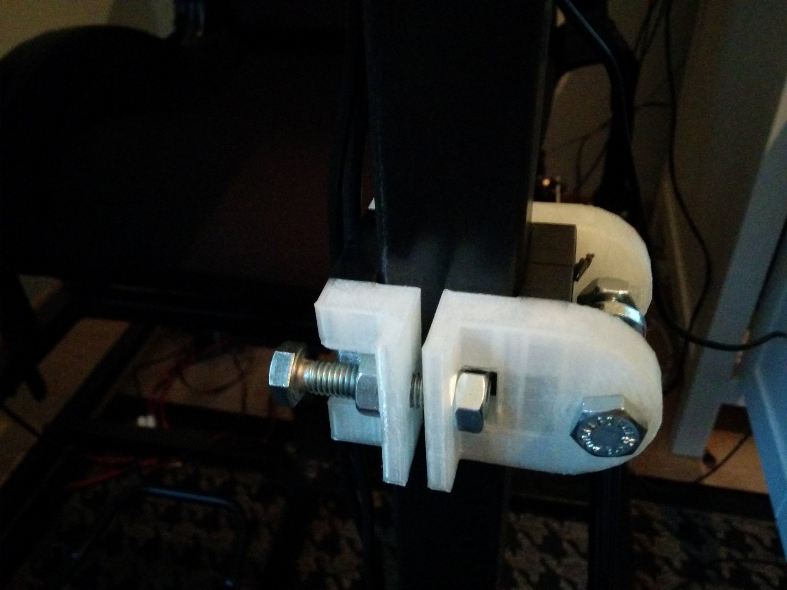

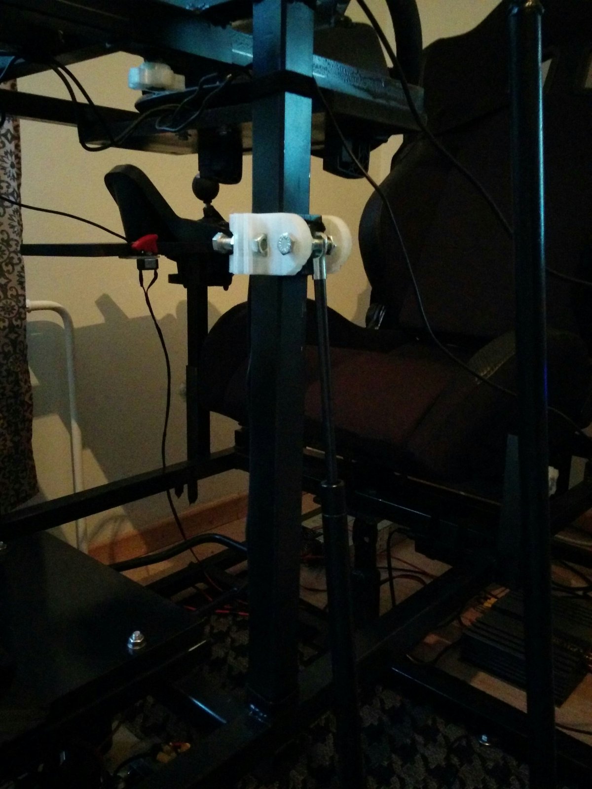

    @tombo had some success with adding gas springs to help with the gear slack so I decided I'd give it a go, so thank you for suggesting it!
    He used 70N ones but the minimum gas springs that I found from the local shop were 150N. I've only attached one spring at the moment as the mount for the other one is printing as I write this. Initial tests with only one spring attached seems to remove some of the jerkiness from the sim, so I'm excited to add the other one and test it.
    If someone has use for the mounting part, I have attached it to the post. There's skp (sketchup) and stl files included.
    The part clamps around 30x30mm tube.

    So why exactly did you add gas struts ? ok so I went back and seen the Gear box slop your talking about, But as far as i know All of That Style gear box have the same amount of mechanical play Built into it....The worm gear cant be THAT close to the main gear or they will wear A LOT faster and wont have as much efficiency due to sheer friction. YES i have experienced it this osccilation, but Not with Myself in the driver's seat, Only if i jump out and give the seat a whack on one side will it start to do a little wiggle but then stop on its own after maybe 1-2 seconds.
    This is a Balance issue your having, You need to have Some weight on the motor's, Not be PERFECTLY balanced on the U joint. If you had a little weight on the motor's this would 100% prevent this problem.
  10. bsft
    or it could be for looks to keep the frame upright when power is off......
  11. Ville Pesonen
    Ville Pesonen Active Member
    Jan 13, 2015
    136
    867Coins
    +200 / 0 / -0
    I managed to fix the oscillation problem by tuning the PID in smcv3, so that's not a problem anymore.
    As you said, the problem is that my sim is pretty well balanced when I sit in it. I get backlash movement when the sim moves in either direction. The gas struts are there to add "weight" to make the sim little unbalanced to fix this. I also could just have added some weight as you suggested, but I decided to give the gas struts a go.
    I'm not 100% sure about this, but in my head the gas struts helps more with the backslash movement opposed to adding some weight to the sim. My reasoning is that the gas struts have ability to resist fast movements in either direction. It will not remove the gear slack / backlash completely, just smoothens it. just adding weight to the front of the sim would still leave the jerky movement in one direction. I have no idea if I'm correct about this, but I'll see pretty soon.
  12. Nick Moxley
    17,057Coins
    +2,507 / 30 / -2
    Incorrect, you dont feel the backlash when the motor's are loaded a little bit. Also removing the ability for the motor's to oscillate or have Quick direction changes isn't exactly ideal, You want the motor's to be able to do what they can without anything working against them

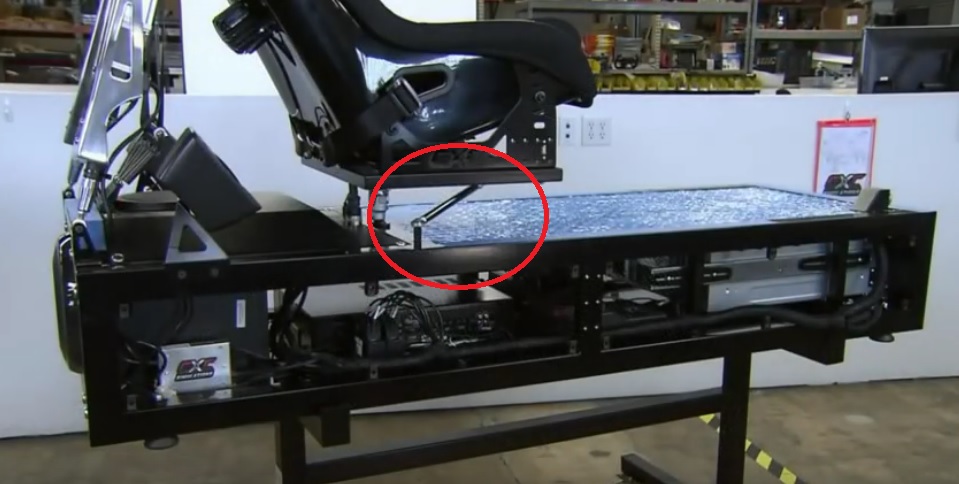

  13. SeatTime
    2,572
    You can also brace the steering column Uni like this to stop it twisting (see below), as used on many so called 'high end' (expensive) commercial sims. It basically is a steel rod which has couplers on each end that only lets the seat move in two planes and not twist.
    22,127
    154,388Coins
    +11,179 / 57 / -2
    Off topic but it seems ironic that a 90K commercial sim uses a workaround for lateral twist rather than an appropriate uni joint in the first place :confused:

    I tested the gas struts and they were too powerfull, so it did not work. The H-bridges just gave up after a while. I'll have to try to add some weight to the sim to make it a bit unbalanced and see if that helps.
    I bought dirt rally and it is working like a charm with the current setup. probably because the sim is constantly moving. The problem is with flight games where the movements are long. In those movements the movement becomes jerky.

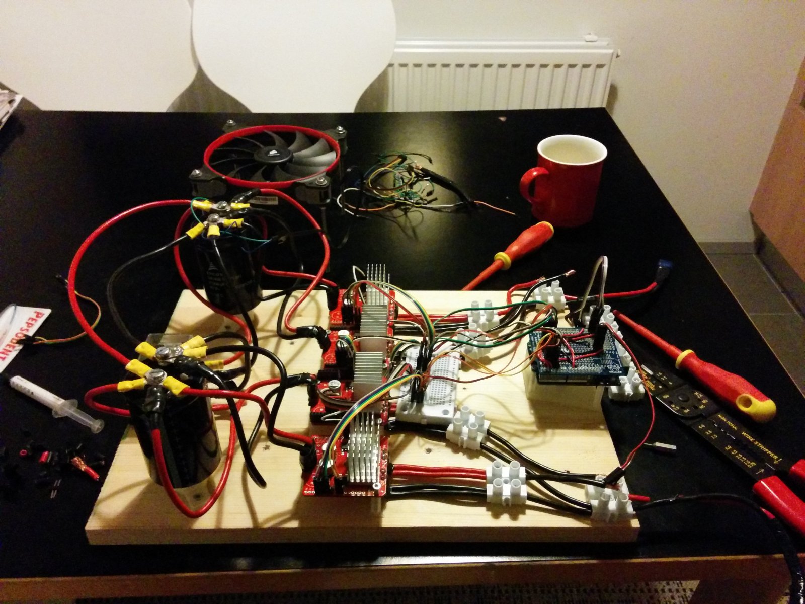

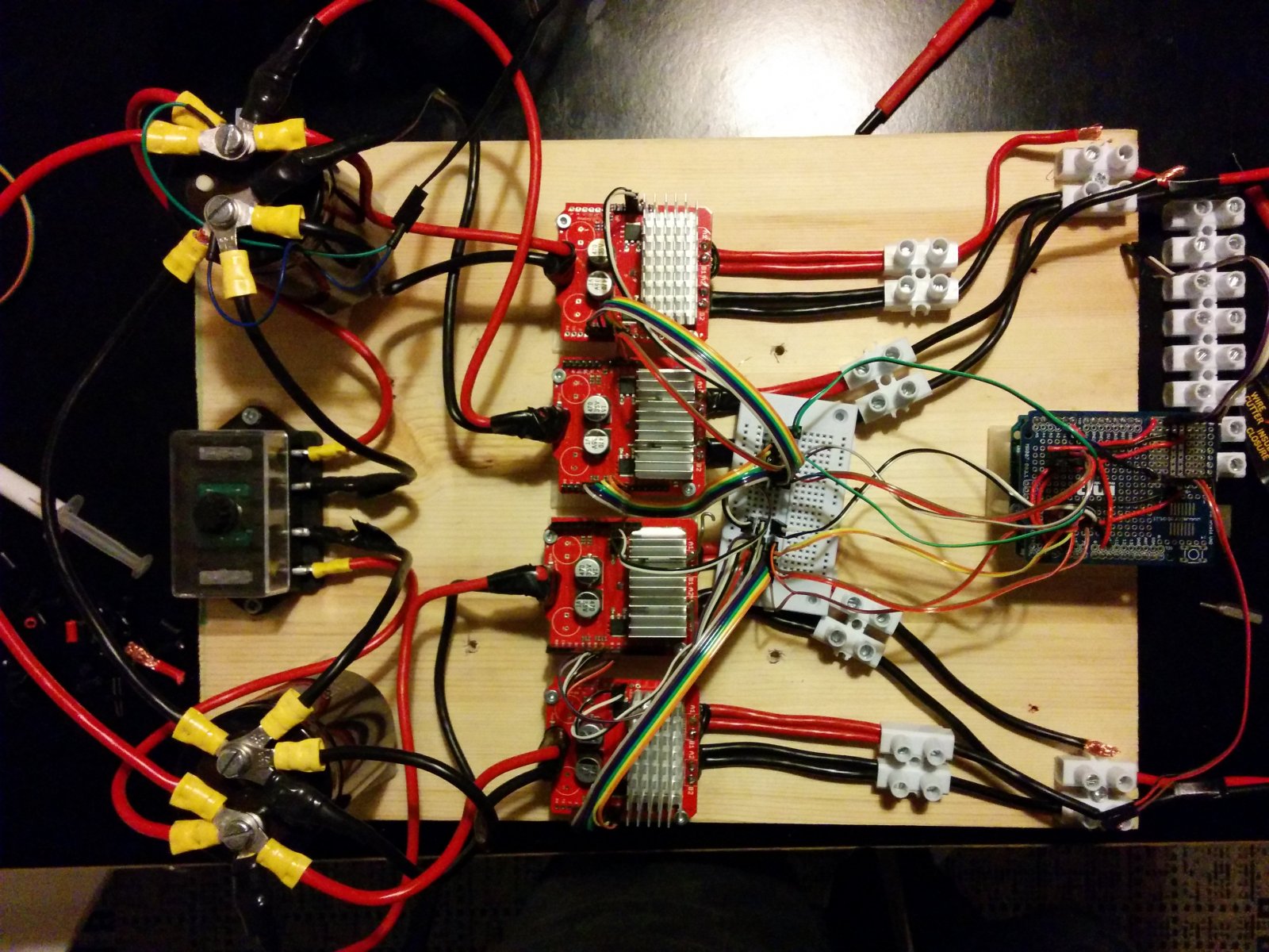

    I ordered 2 MMs some time ago to add to the ones that I already had. They arravied earlier this week and today I finally got them installed:
    Now I have twice the power and twice the FUN!!
    It's time to test my newly acquired power in dirt rally.

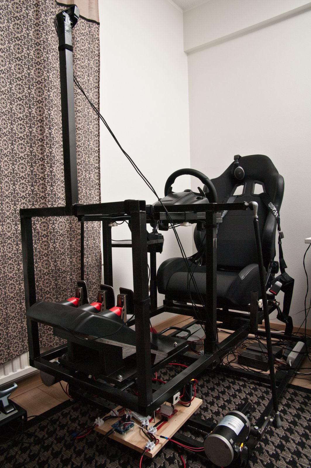

    I did some cable management today. Now it is much easier to get into and out of the sim. Earlier I had to make my way to the sim through a wire jungle.
