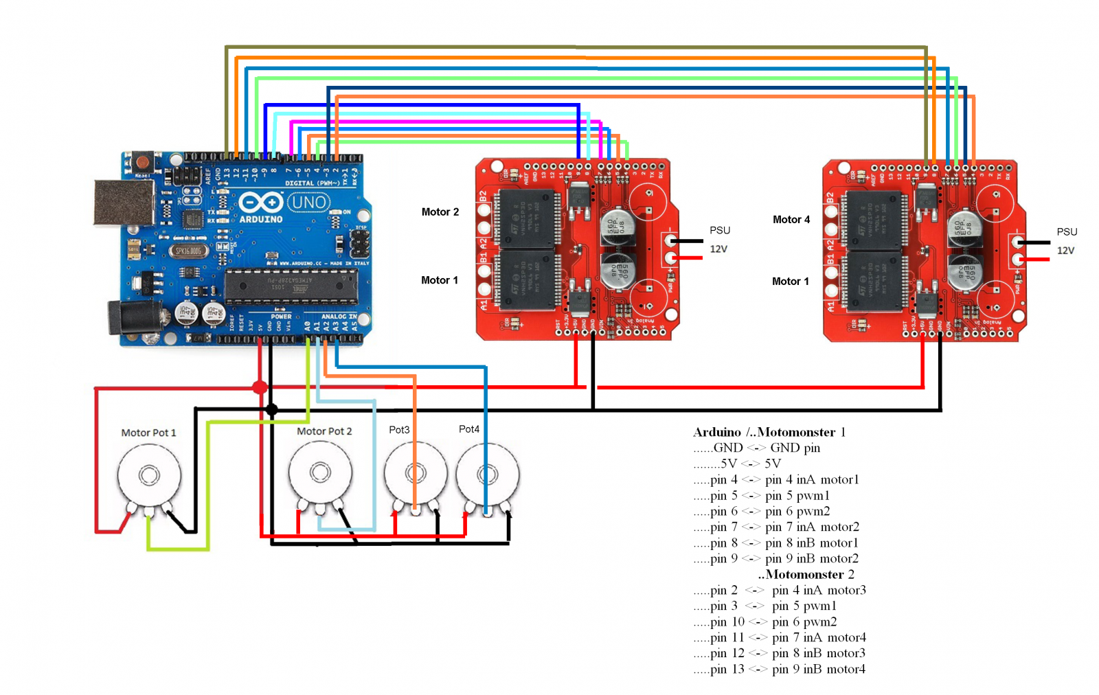

    nkghk.png Thanks @RacingMat ! your design was my main inspiration. Thanks for that information sir. I am really interested on your design that uses 2 moto monsters with 4 potentiometers.. My design was originally 2dof with 2 motors on each side..the two motors must be synchronized so that it will act as 1 big motor. This picture of your design really caught my attention..can you please give me the code for this kind of setup? any help would be much appreciated.. :)

    I believe synchronizing with wiper motors is going to be a big issue, but you wont know unless you try.
    Hope it works.

    good day guys! This project will be resumed around june 2015! I'll be sure to keep you guys updated! Synchronizing the motors is surely tough and I'm still in the process of thinking and designing a circuit that will do the job.. Thank you guys for your support! :)

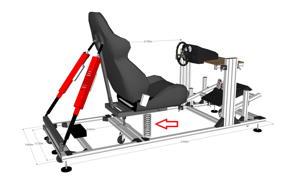

    @Jomar_Sarto i whish you success. If you will (hopefully not) fail by synchronization thd motors you could think about using linear springs which support the motors by lifting the weight. Springs are not advised in most cases but if nothing helps springs would be good and functional enough. I did some experiences and these result in a positive way.

    Thanks for the input @Pit! please tell mo more about these linear springs and on how to implement them.
    If synchronization fails, i'll put the two motors in front, add another set of h-bridge and an inverter to invert the signal from the master h-bridge input so as the back motor pulls, the front motor pushes..this my plan B if the initial won't work.. :)

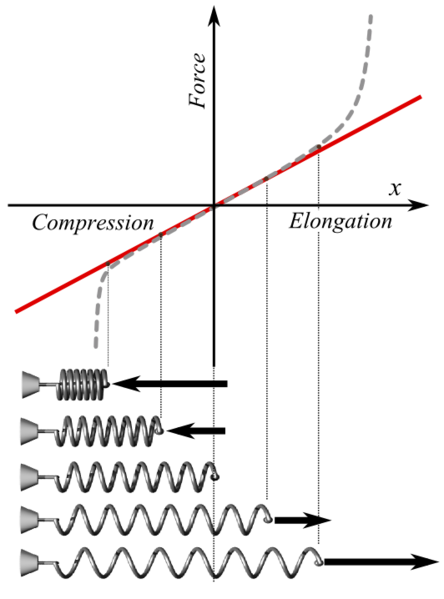

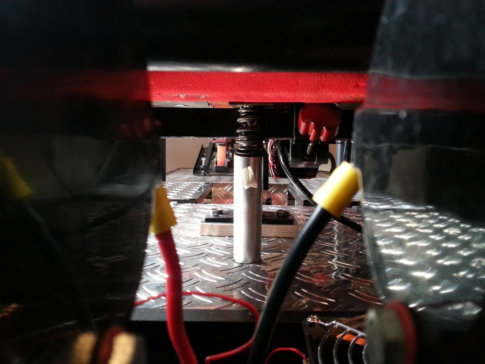

    If the motors are too weak you can help the motors by reducing the total weight of the seat by adding some linear springs (or one if possible) as a solution if "nothing" more helps (does not matter whatever the reason is). Why linear? "Linear springs are the easiest to understand. When you think of a spring, this is typically what you are thinking of. As the load on the spring increases, the spring compresses an amount directly proportional to that load. So, if the spring is rated at 100lbs per inch, in will compress 2 inches when 200lbs is applied. "
    Now you mount "somewhere" in the middle under the seat (needs some calculations where to be placed) the spring like I did for testing purposes:
    I did so because at the beginning of my experiments my motors were too strong in opposite of the motor drivers. IMO I was very happy about this experience, it helped a lot :)
    PS: I found an old picture of my spring:
