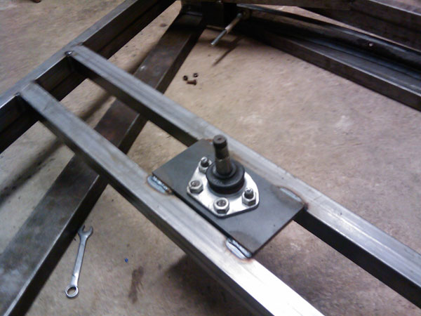

    I used a car suspension ball-and-socket joint as pivot. I think that is well written in English. In Spanish is la rótula de suspensión de un coche. It moves in all directions.
    I attached a photo
    Regards,
    David

    WOW! That thing might be able to hold a ton! :)
    Did you manufactured the plate yourself?
    I need to see what I can find locally, a damper / isolator rated to 200Kgs should be more than enough... Suggestions are welcome!

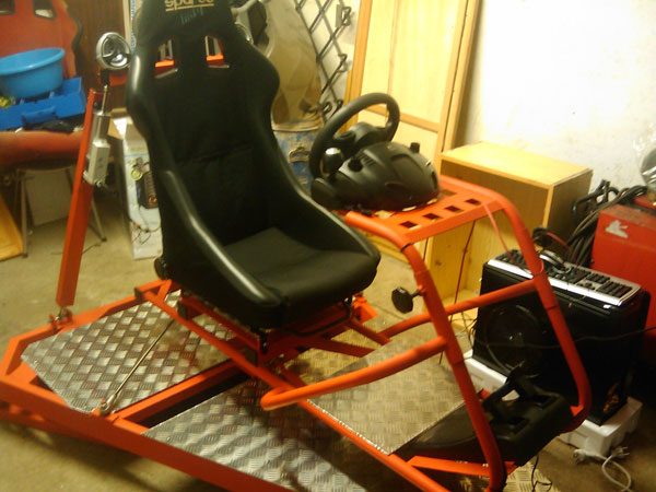

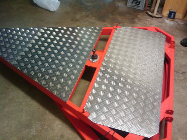

    A friend and I are building the motion simulator. He works a welder and he is responsible for the structure of motion simulator
    I attach a video of pivot movements
    http://www.youtube.com/watch?v=vhXq7q0z9QU
    And two photos of motion simulator recently painted and mounted
    Regads,
    David

    WOW! It looks really sharp!
    And, the pivot seems to work smoothly...
