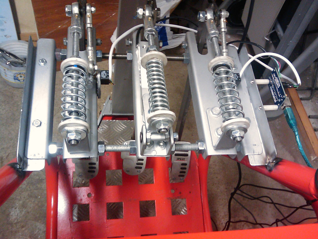

    Hi all,
    after many hours playing we have a new evolution or improvement to our simulator.
    We have built a DIY Pedals based on Todd Cannon system. The brake pedal is more realistic, we get more feeling... :highfive:
    http://www.youtube.com/watch?v=bSZsWMQPW6Y
    Bevins, up to now the SCN5s are right. Perhaps SCN6 actuators could be better because our structure is heavy but we bought the SCN5 before making the structure. It is about 2 meters long by 1.5 meters wide.
    Regads,
    David
