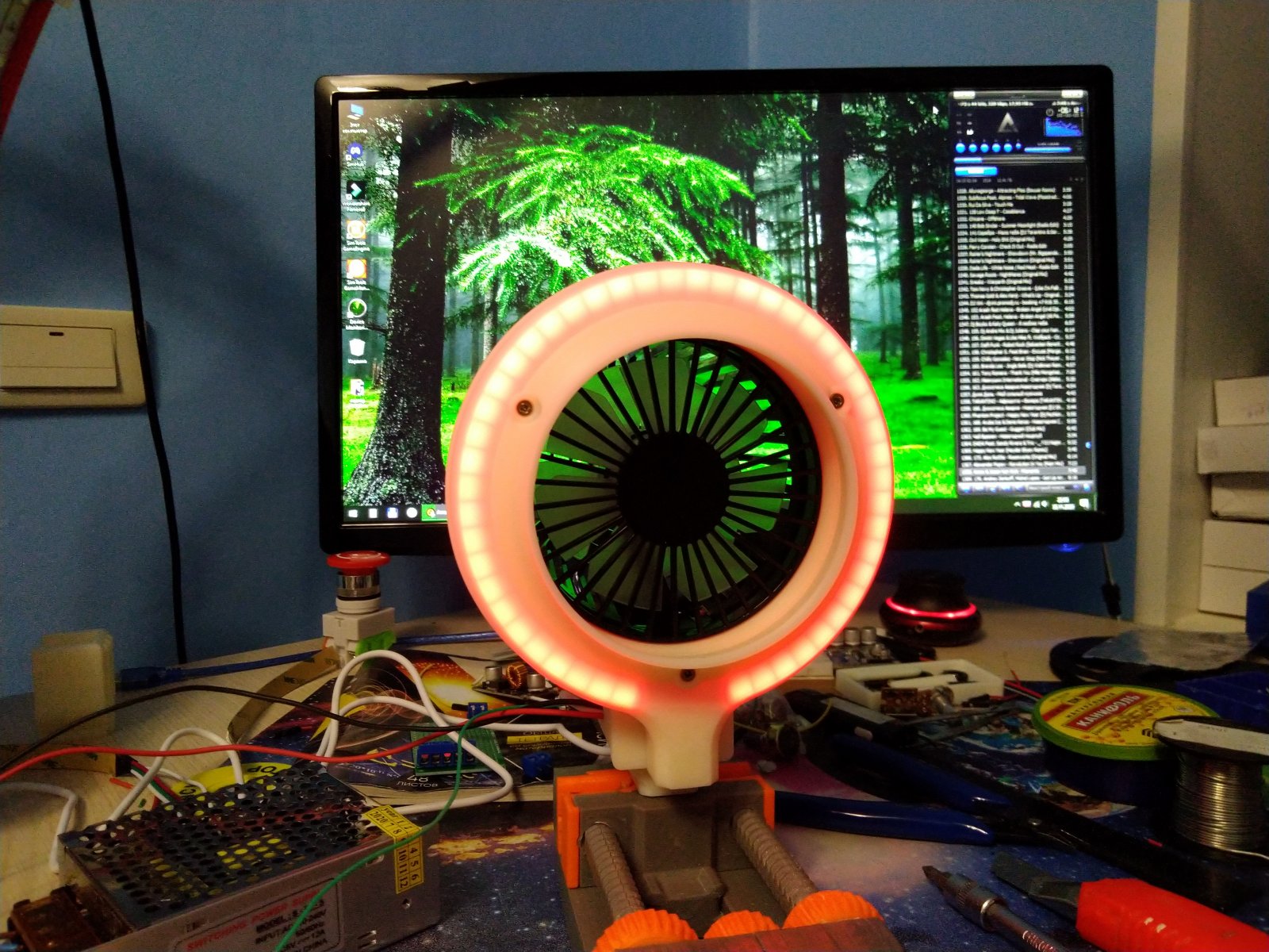

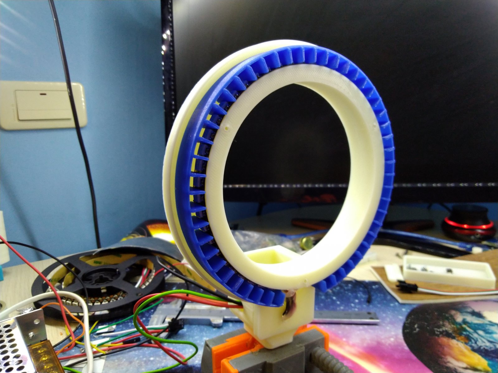

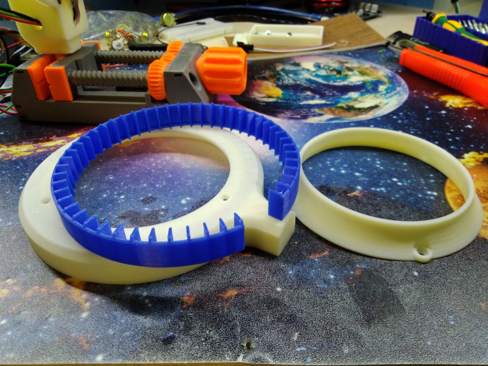

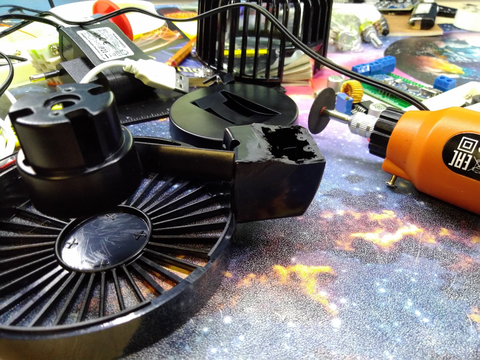

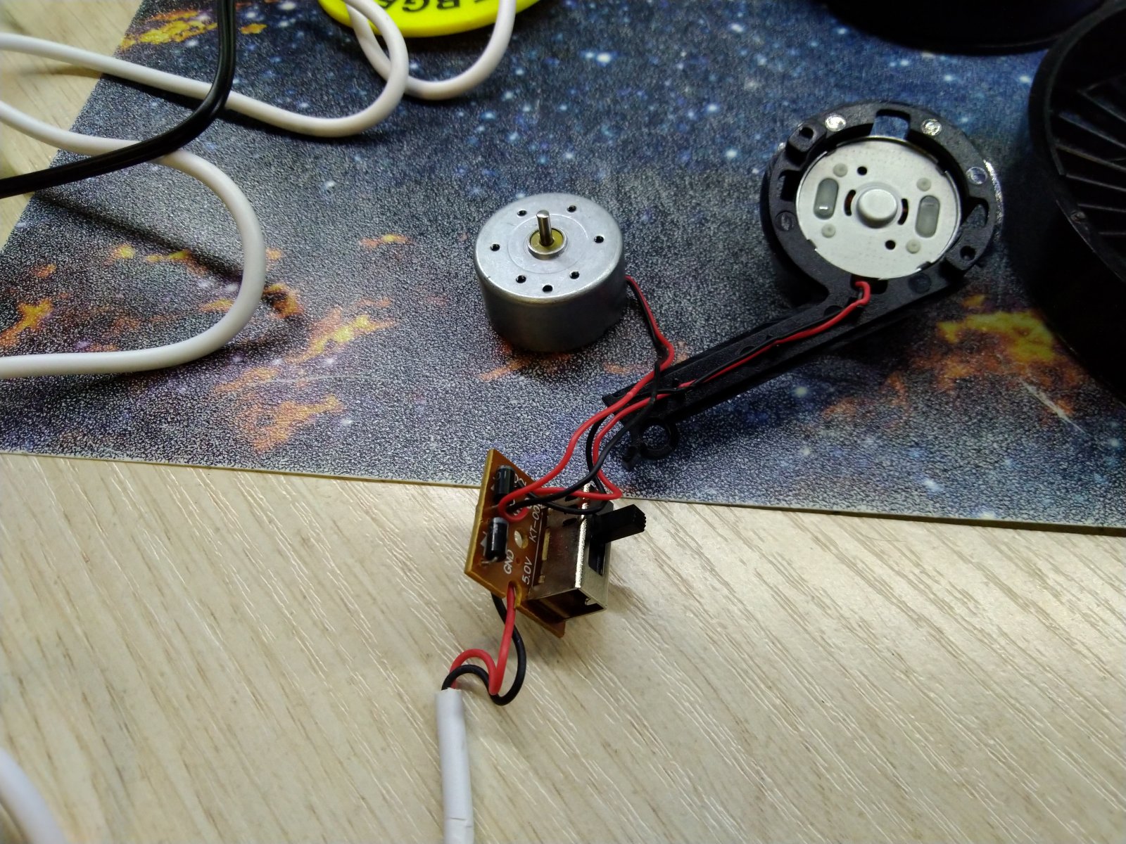

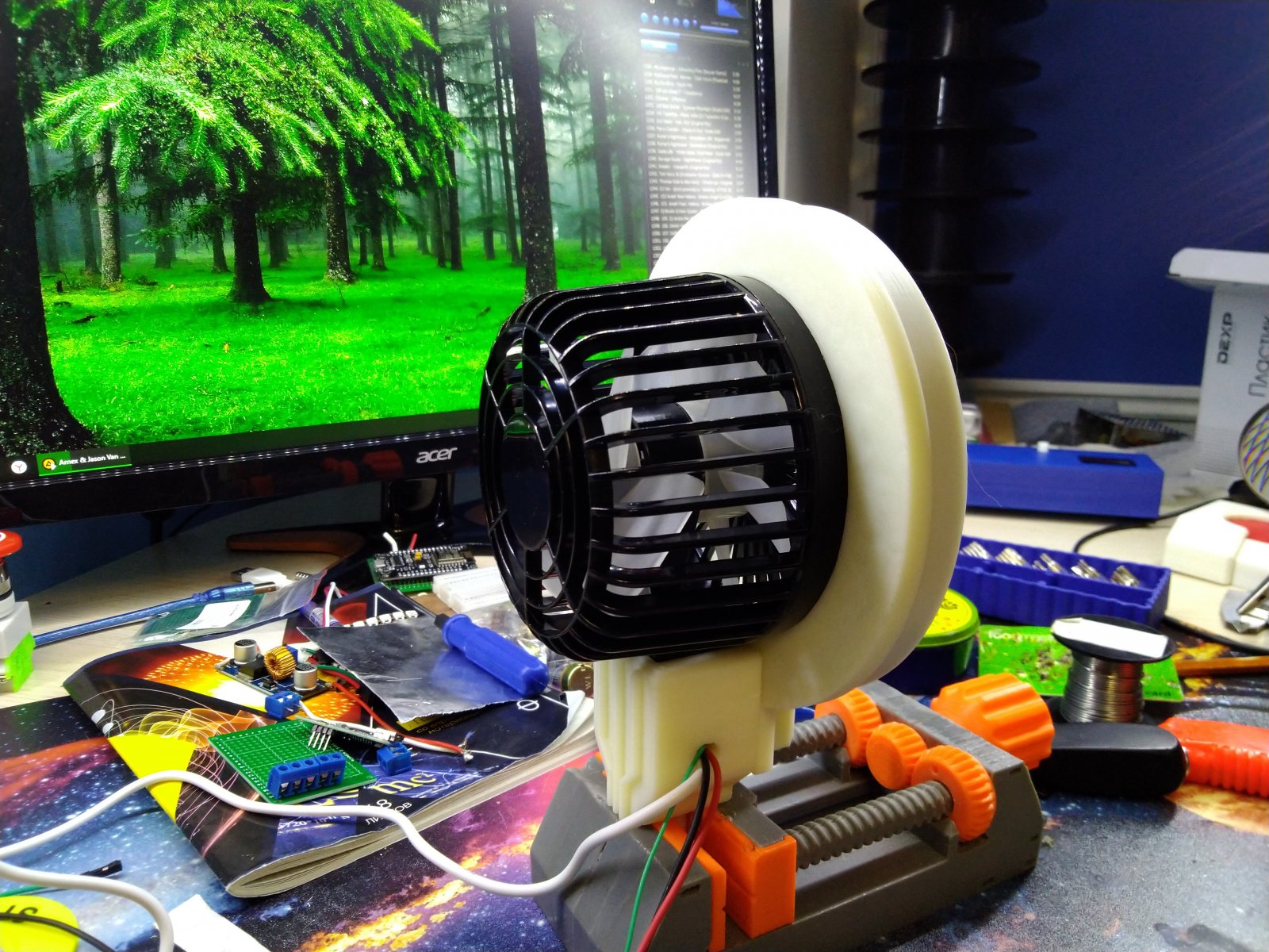

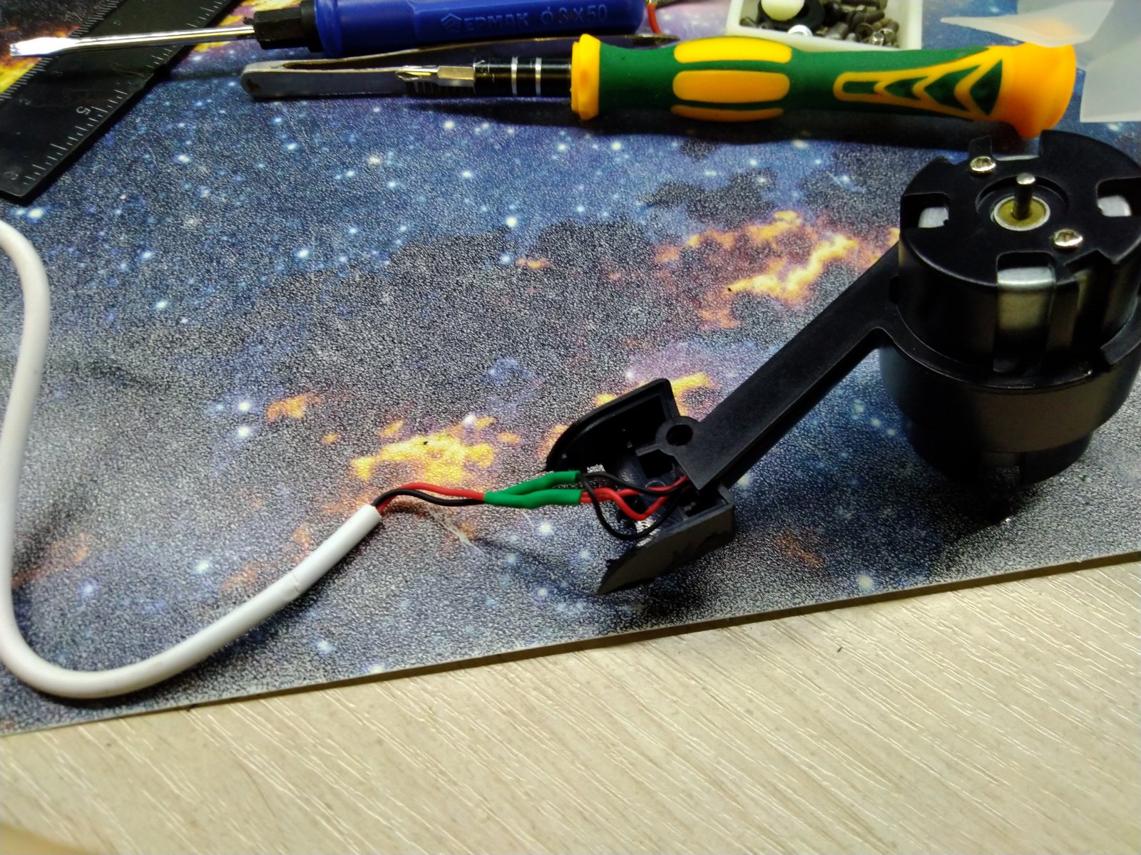

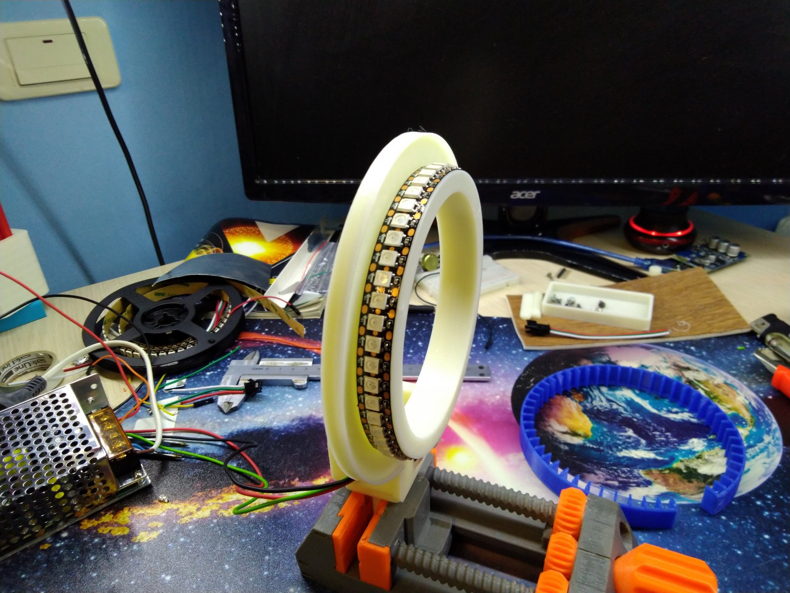

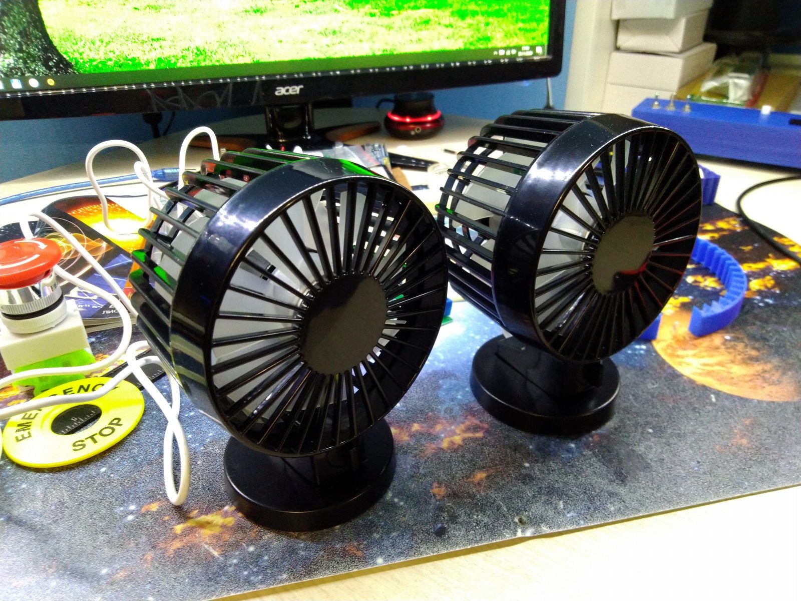

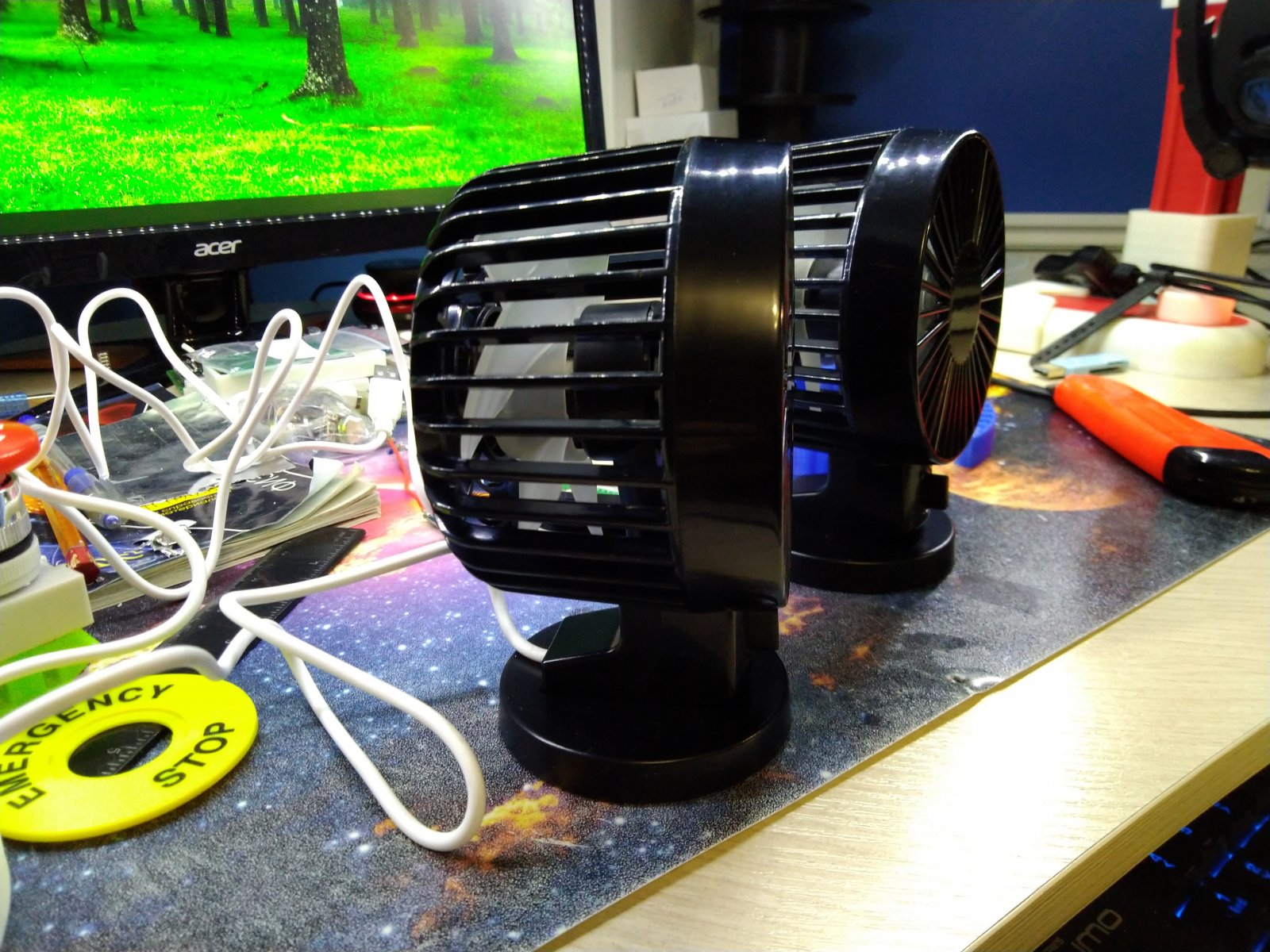

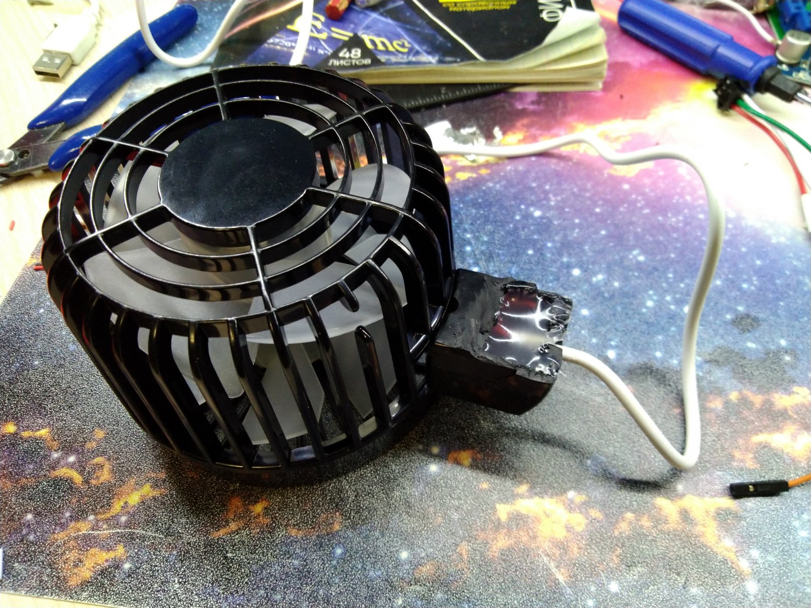

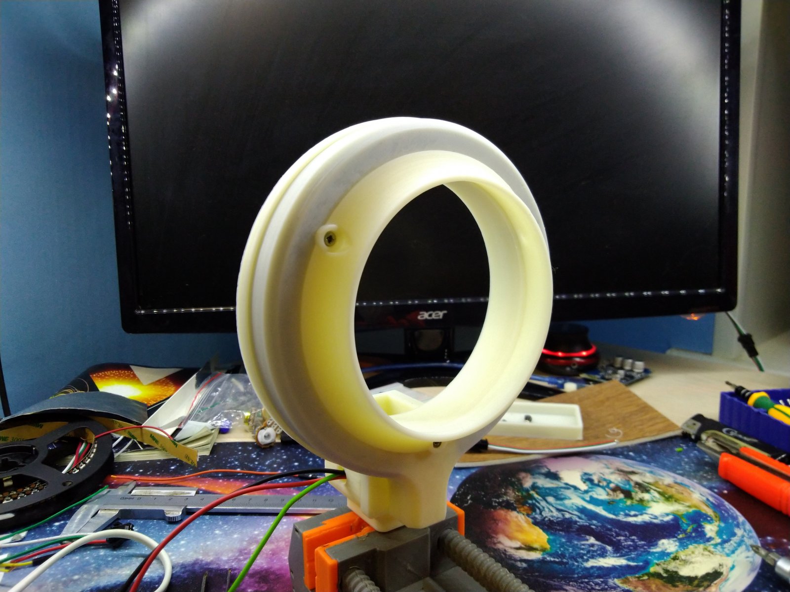

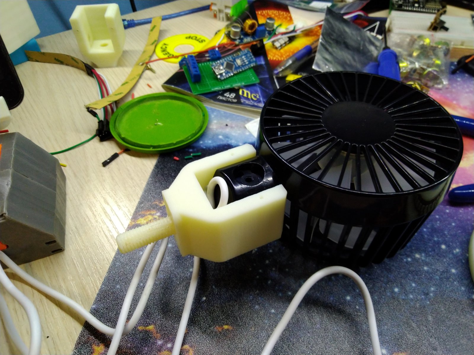

    Bought two fans and combined one of them with a light ring. Here's what happened IMG_20201130_174630.jpg IMG_20201130_174720.jpg IMG_20201128_191343.jpg IMG_20201128_191357.jpg IMG_20201128_191429.jpg IMG_20201128_192046.jpg IMG_20201130_184036.jpg IMG_20201130_184133.jpg IMG_20201130_185947.jpg IMG_20201130_200816.jpg IMG_20201130_215322.jpg IMG_20201130_220152.jpg IMG_20201130_220203.jpg IMG_20201130_220636.jpg

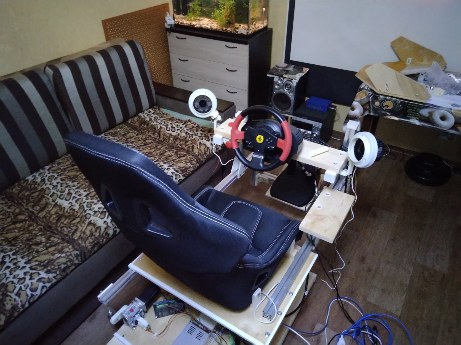

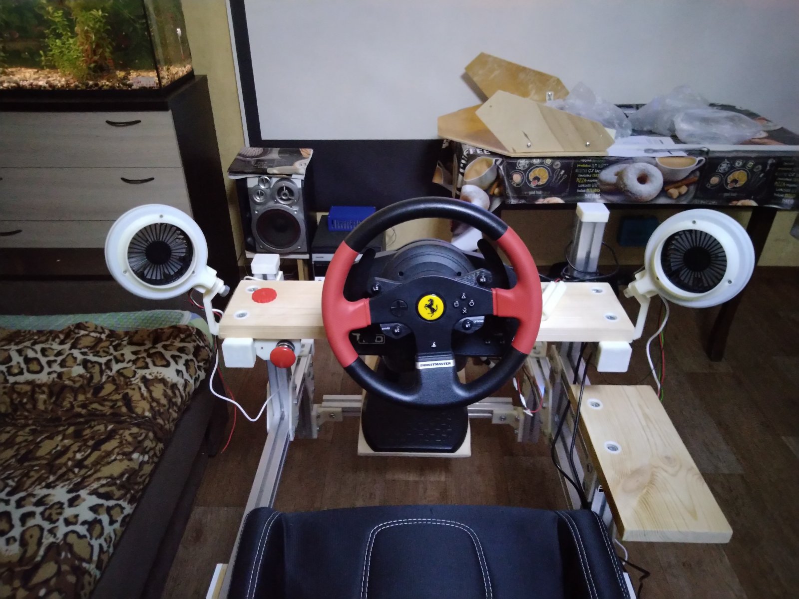

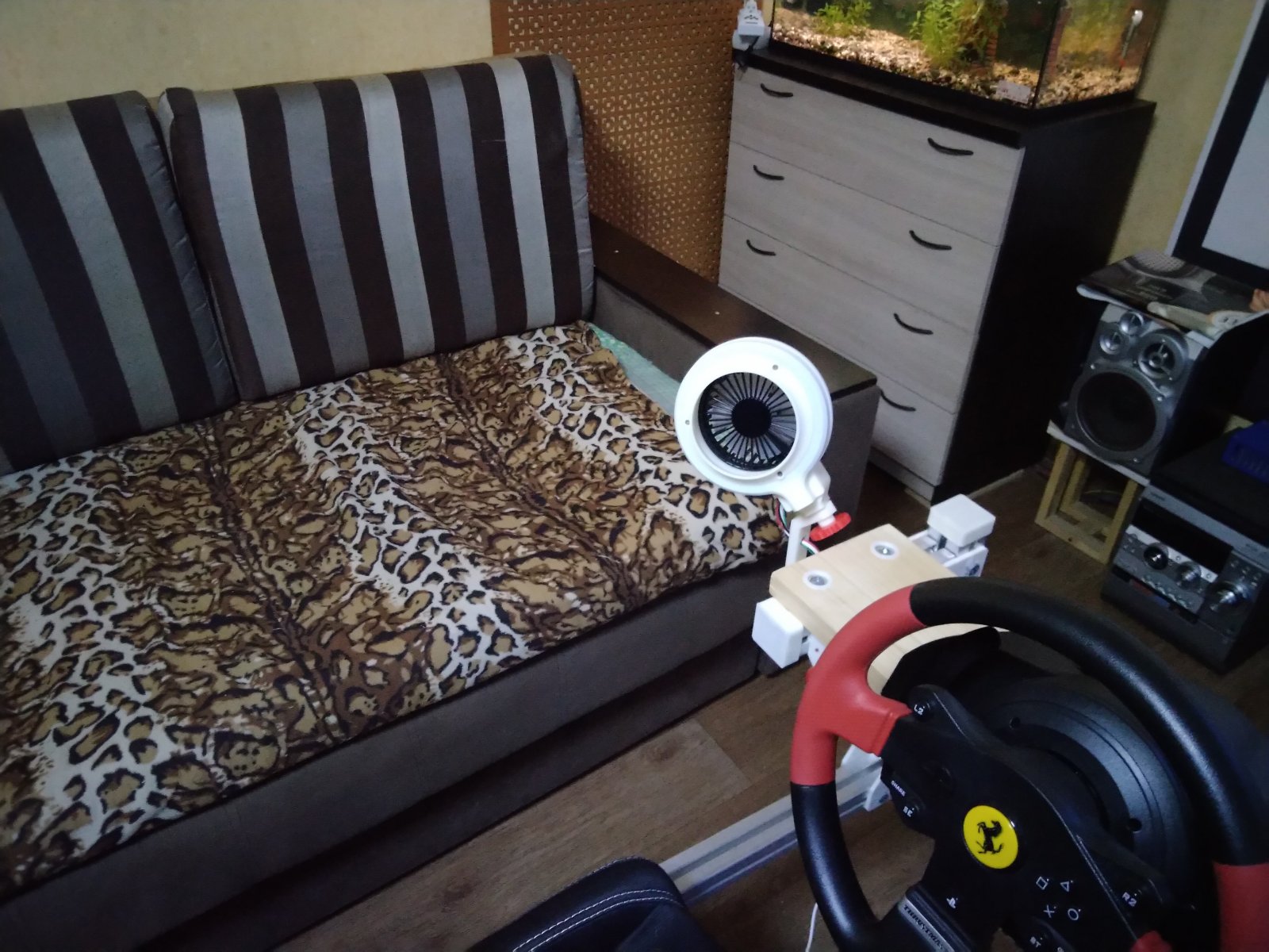

    And this is how it looks on the car. Left airflow with speedometer ready! Will soon be the same on the right with a tachometer:)

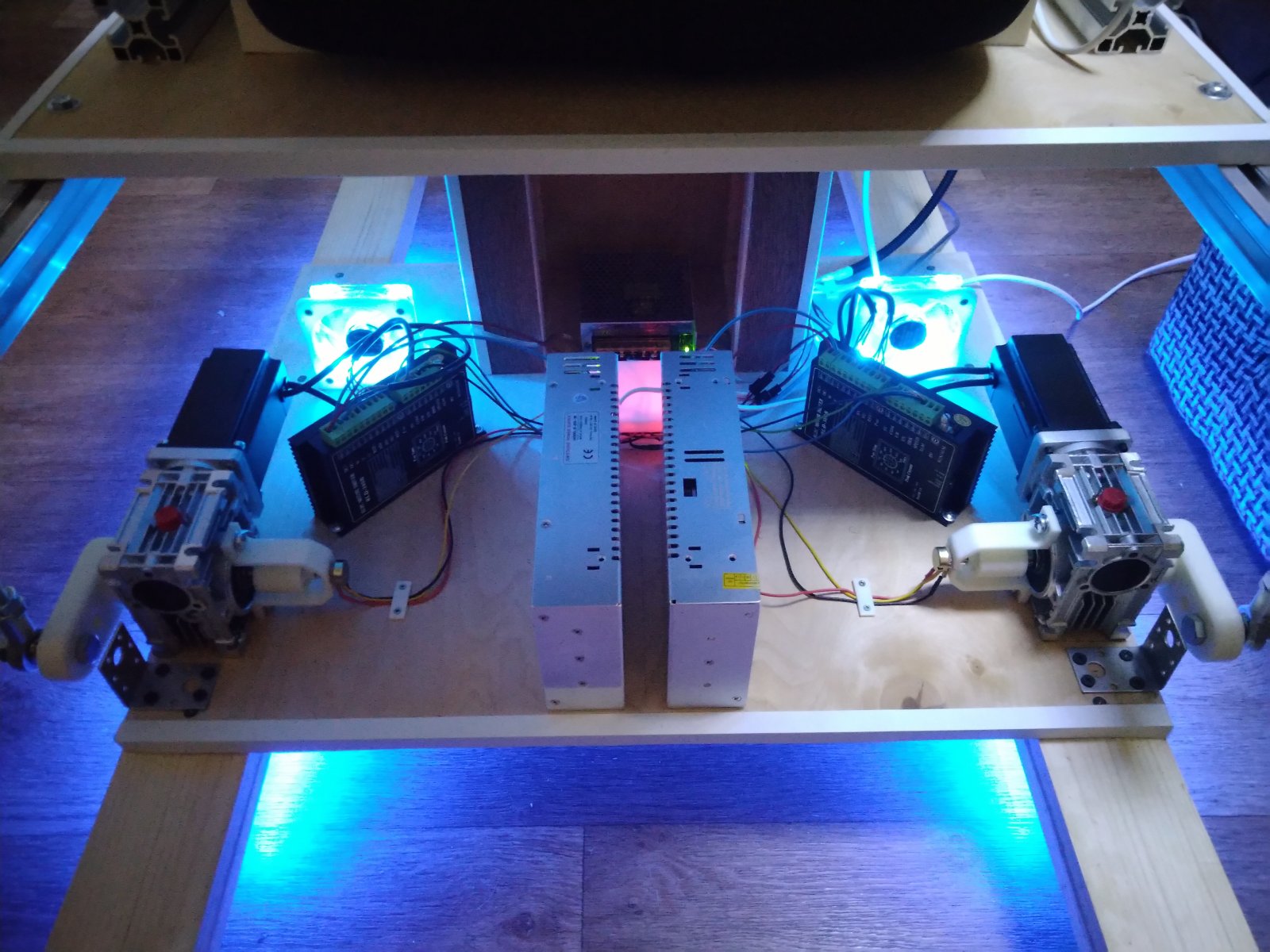

    Tomorrow I will mount the second power supply unit and continue testing.
    Here are some more photos

    Installed 2 power supply. The problems are gone

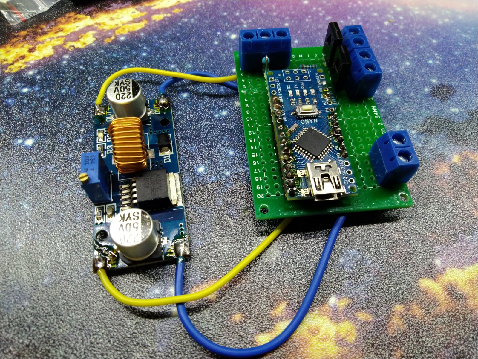

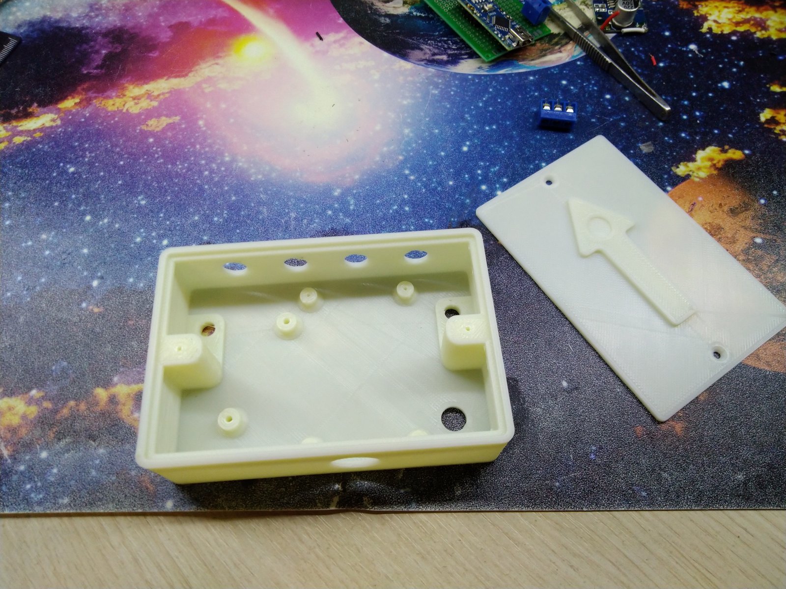

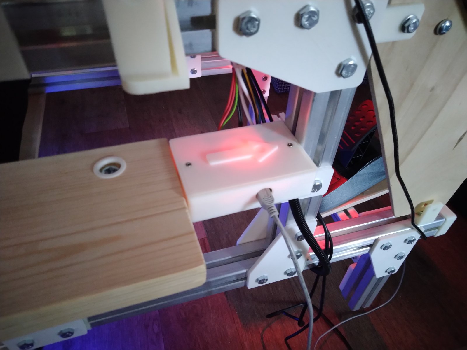

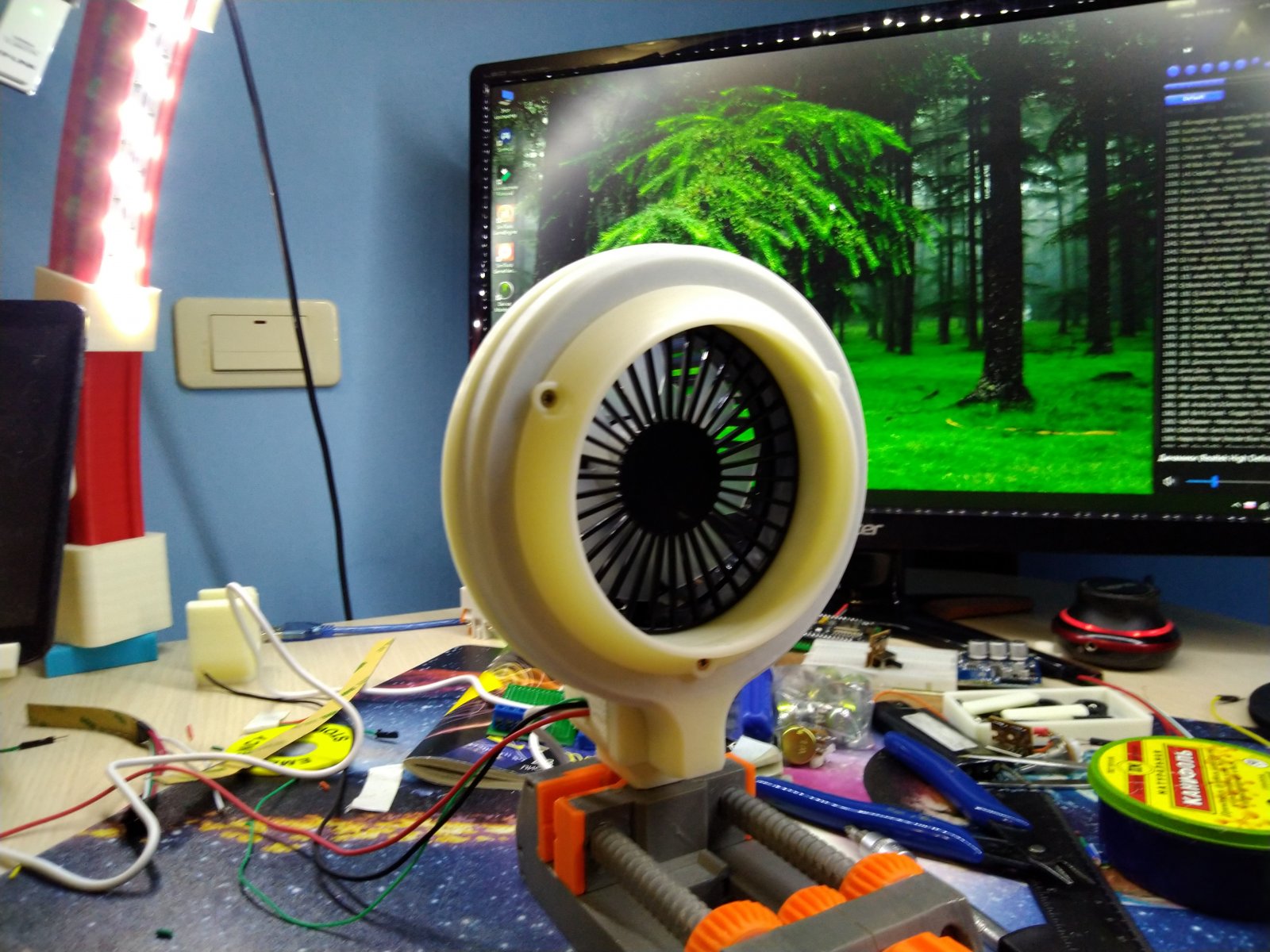

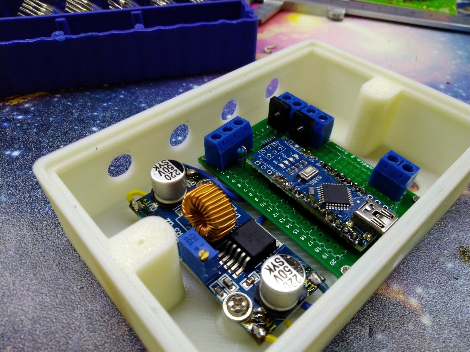

    Printed box for 12V to 5V step-down module for fans and LED strip and arduino nano
    IMG_20201203_222546.jpg IMG_20201204_193429.jpg IMG_20201204_194134.jpg IMG_20201205_123820.jpg

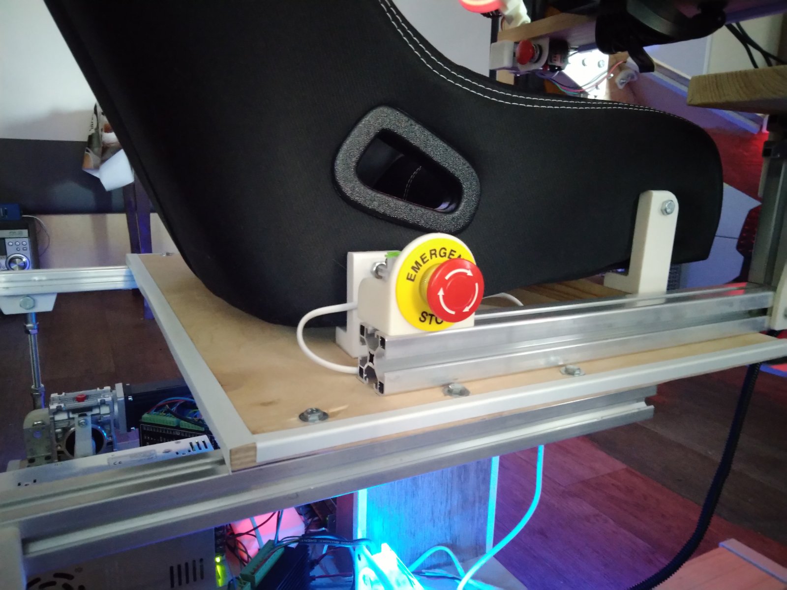

    Installed emergency button

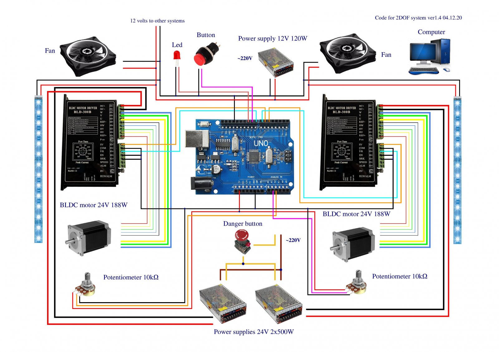

    Wiring diagram

    Code for 2DOF system (arduino, drivers BLD-300B , BLDC motors)

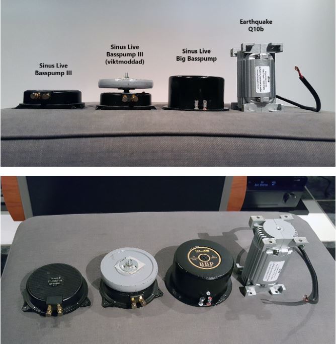

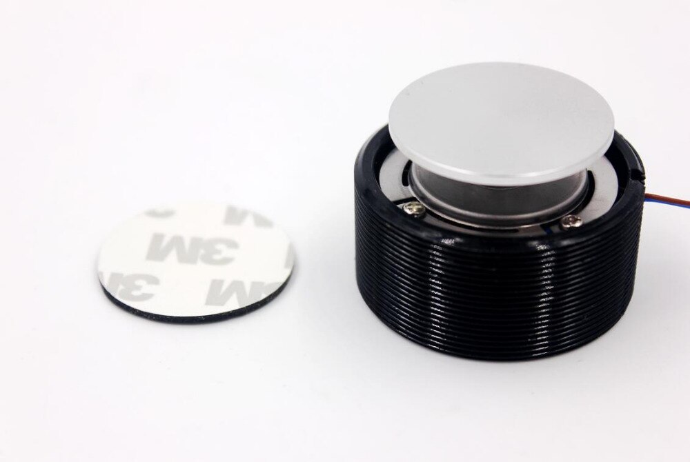

    For small vibrations (road surface, engine shaking, curbs) I want to put vibration speakers as in the photo. Will increase the dead zone for motors so that they only work out medium and large movements. So I think it will be easier for the motors to work and the sensations will be more believable.

  16. RacingMat
    2,233
    21,066Coins
    +2,092 / 21 / -2
    good idea!
    beware to choose a bass shaker (its aim is to give vibrations) and not an exciter (its aim is to produce sounds by vibrating a surface).

    I think you can put a low-pass filter on vibrodynamics. Vibration speakers reproducing sound will give not just vibration, but vibration with a changing tone of the engine roar, for example

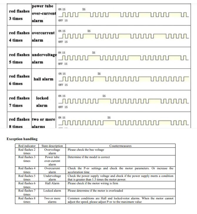

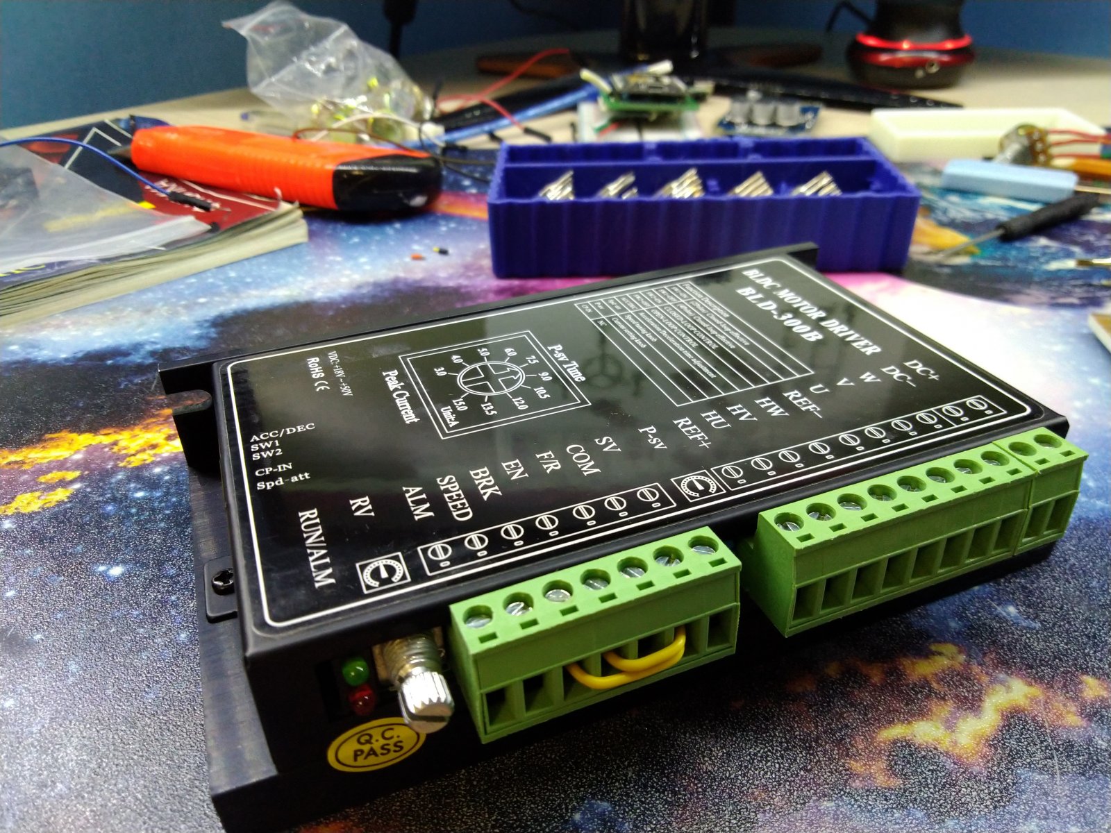

    Who will use the BLD-300B driver here is a list of errors. Very useful information. The driver indicates errors with a red LED or you can output an error signal via the ALM pin
