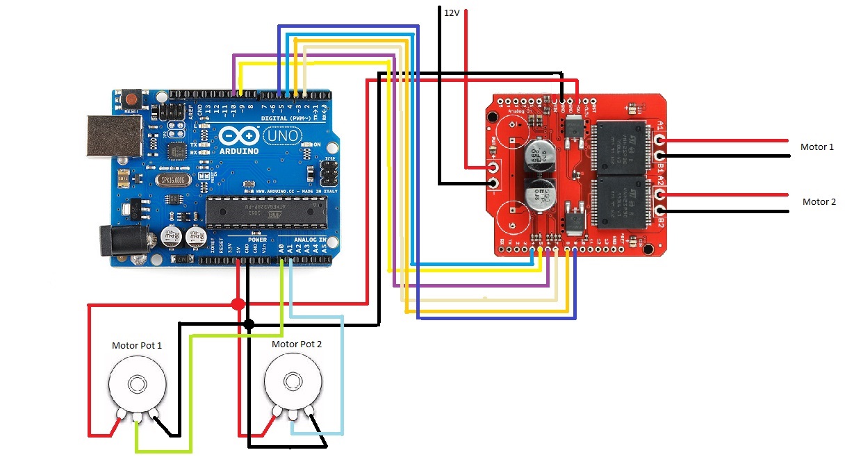

  5. ericson
    ericson New Member
    Mar 27, 2020
    53Coins
    Hello Marcos, how are you? Again, nice work so far!
    About your pinout (arduino <> monster), can you explain why have you connected in this way (example: pin 5 of monster with pin 9 of arduino)?
    Cheers!
    Olá Marcos, tudo bem? Novamente, ótimo trabalho!
    Sobre sua nova pinagem (arduino <> monster), porque você conectou nesse padrão (exemplo: pino 5 do monster com o pino 9 do arduino)?
    Abraço!

  7. Marcos73
    Marcos73 Member
    Feb 14, 2020
    77
    99Coins
    +55 / 0 / -0
    Hello, all right and you? Thanks.
    I just followed the pinout that is demonstrated here in the forum. Because I don't know exactly. I know little about electronics.
    Hugs.
    Olá, tudo certo e vc? Obrigado.
    Somente segui a pinagem que é demonstrada aqui no fórum. Porque exatamente não sei. Entendo pouco de eletrônica.
    Abraços.

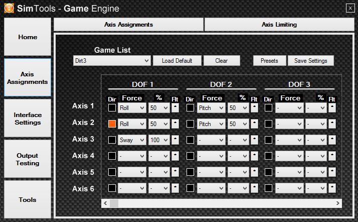

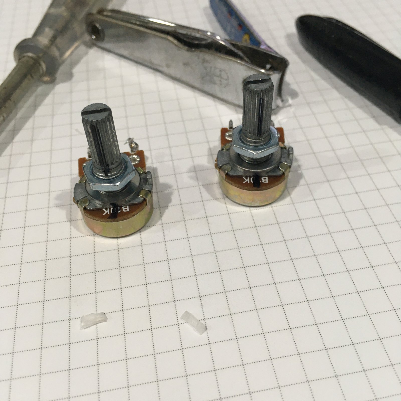

    My test with SMC3 worked correctly.
    But I can't move the motion simulator through Simtolls DEMO.
    It follows configurations that I observed in several articles. What am I doing wrong?
    Meu teste com SMC3 funcionou corretamente.
    Mas não consigo mover o simulador de movimento pelo Simtolls DEMO.
    Segue configurações que observei em vários artigos. Oque estou fazendo de errado?

    The baudrate in Simtools has to be set to 500000, and the output to 10 bits binary
  11. Djalma Ribeiro

    There should be separate pitch and roll in each column.
    Não deveria ser o pitch e o roll separados em cada coluna.

    Hello, Thank you I'm doing it. :)

    Does it work now?

    +55 / 0 / -0
    Yes! Now just configure the axes and forces. Even testing on LFS.
    Sim! Agora é só configurar os eixos e forças. Até testei no LFS.

    Hello, I'm waiting for a new Arduino board and the H Bridge, because I burned the one I was using when I was going to do the engine strength test. :(

    I had managed to get everything right, I even tested it on the LFS game, but I touched wires from the pot and caused a short circuit and burned my electronics! Now my new electrons have arrived and I will do the assemblies again. ;)
    Hugs.
