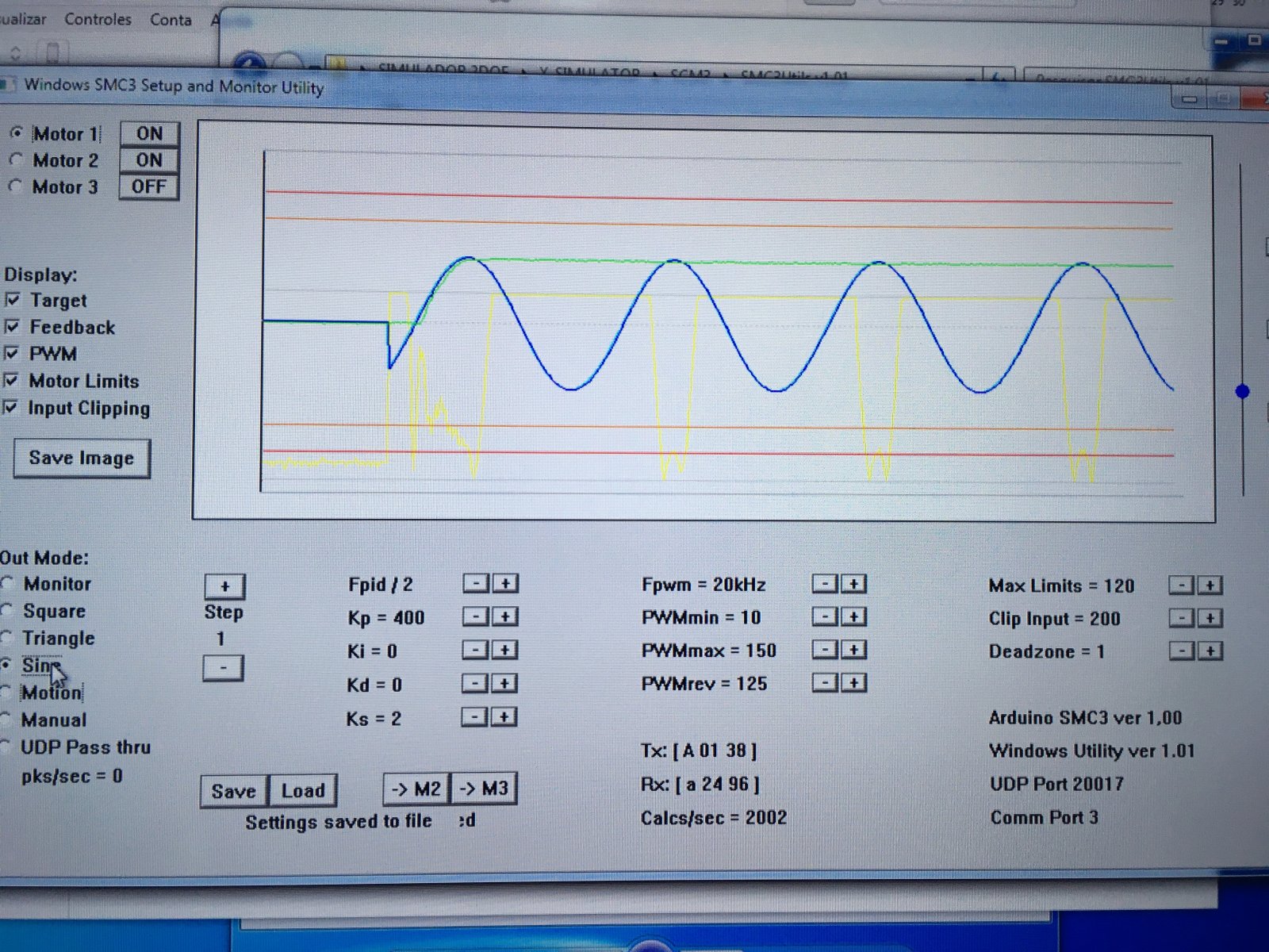

    Just looking at your green line.. That is your potentiometer reading.. It looks like it's losing rotation with the motor shaft or the analog in for arduino may be loose?.. I'm sure you have this working by now but I was just building another rig and if I saw that reading, I would suspect a loose connection first, then maybe somehow the pot is not turning correctly DMAX
