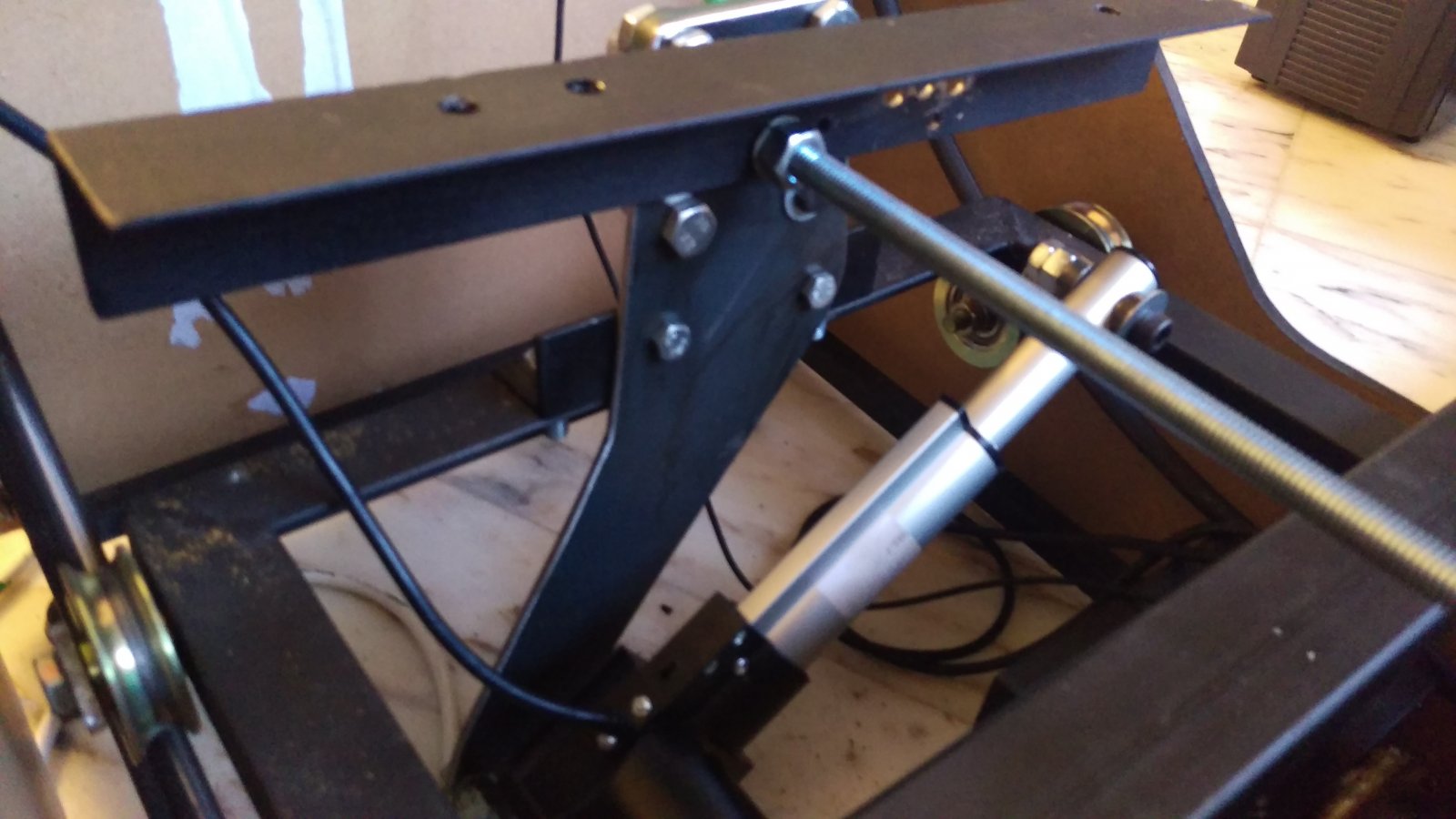

    Thanks @Ned and @ferslash
    @ferslash bending was the easy part: 12mm filled steel pipe ,on a pipe bender made a circle D86cm and cut it in half

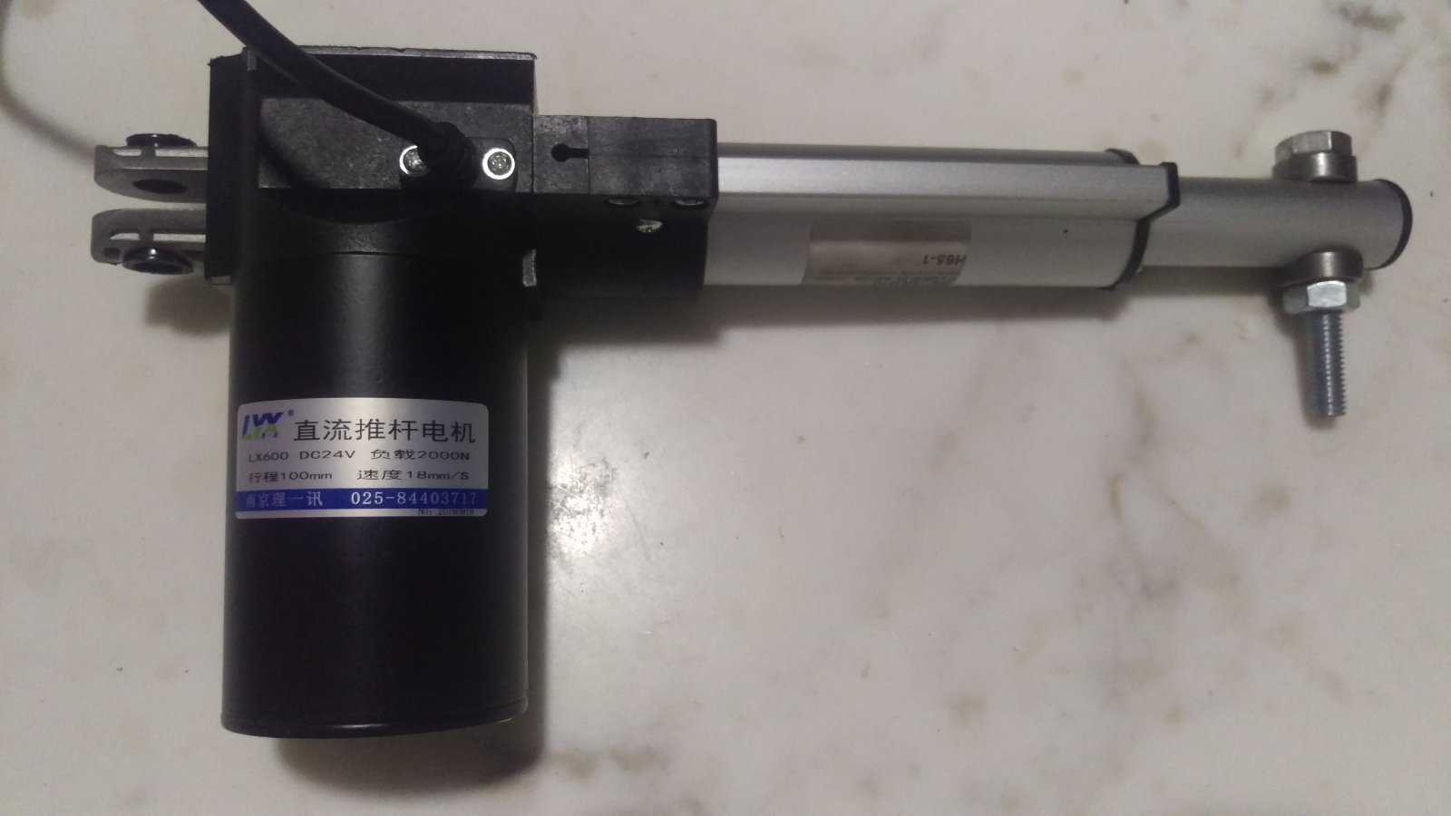

    Bought this actuator today
    Wanted to fix it as heave but instead going to use it as a replacement for surge because my old motor is heating up after 15 min and reduces more than 50% of the motion
    21,714
    151,929Coins
    +11,061 / 56 / -2
    What are the specs of the actuator?

    Hi noorbeast
    It's 18mm/'s not 25 as they say in the documentation
    I know that it's slow but with the right leverage I think it will provide the motion intended

    Each 10mm on the actuator = 10 degree of surge/pitch
    Will have to test it more though to check if the actuator motor will heat up

    :oops: it didn't work
    Under 80kg load the movement was soooooooo slow didn't even react on time
    21,714
    151,929Coins
    +11,061 / 56 / -2
    Member experimentation is a good thing and while that was not an unexpected result it is useful confirmation for others about the speed necessary for good motion.

    @noorbeast The specs of the actuator tricked me it couldn't even lift 100kg and at 75kg the speed was 4mm/s
    you were right :cheers

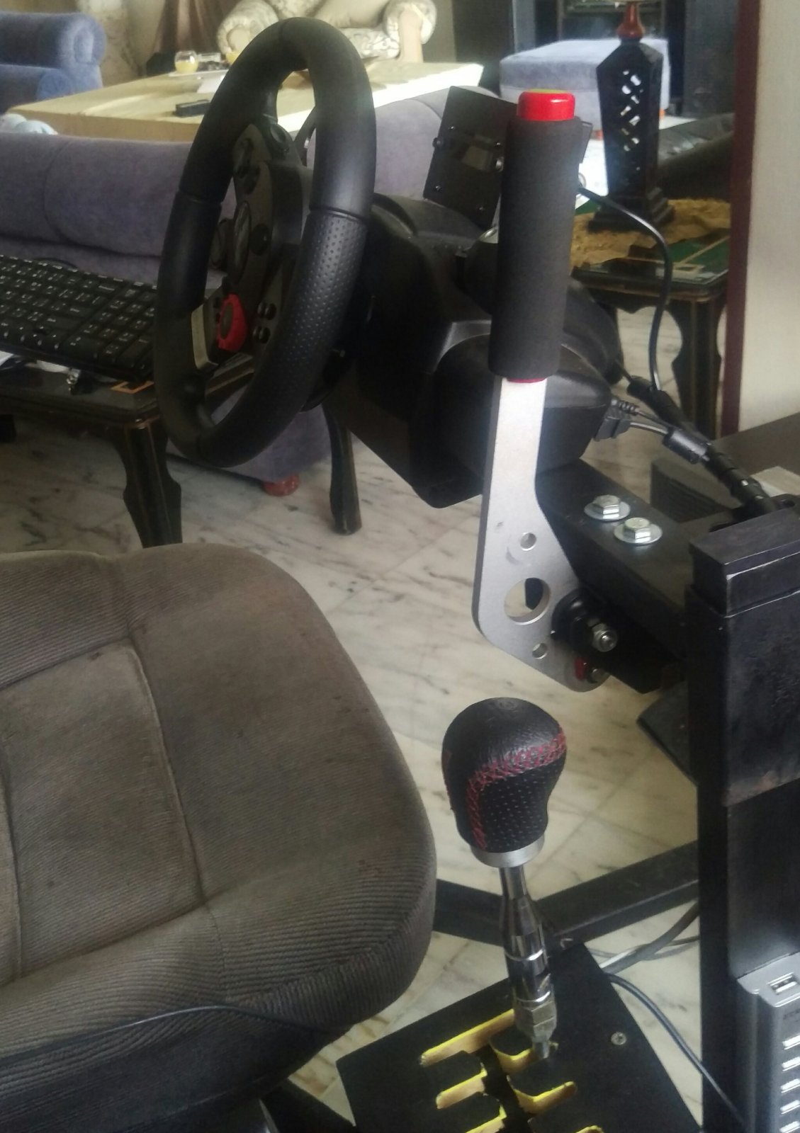

    Changed the DIY analog handbrake

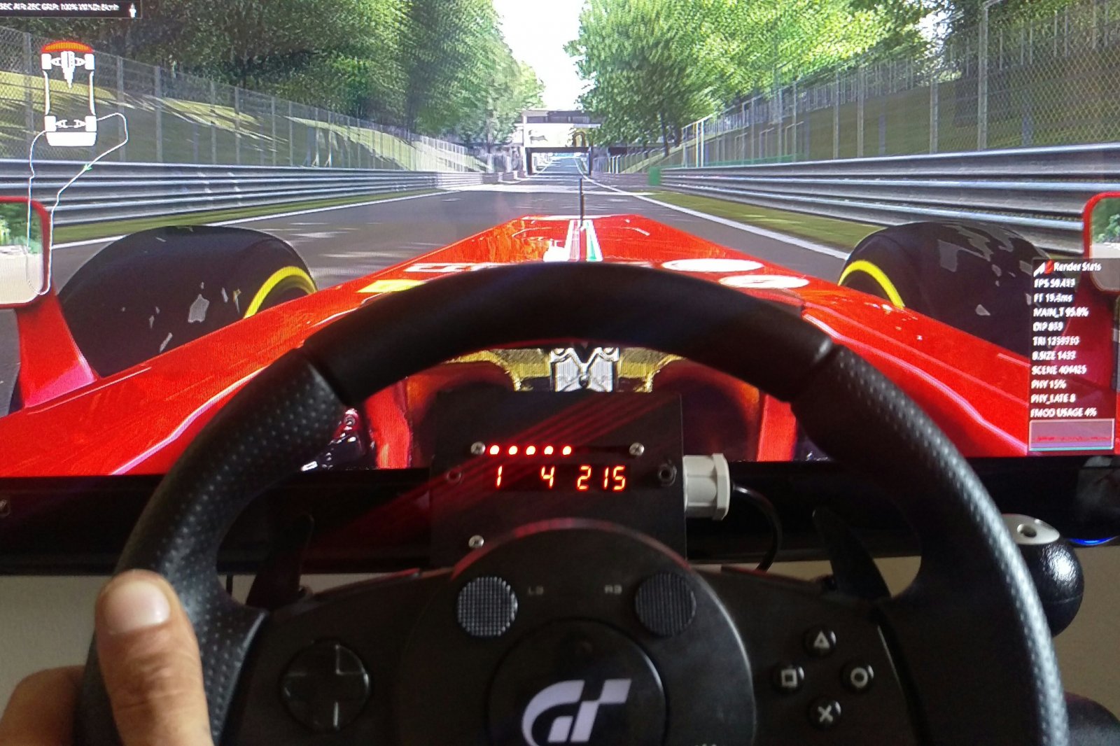

    And a new lap, gear, rpm and speed display
