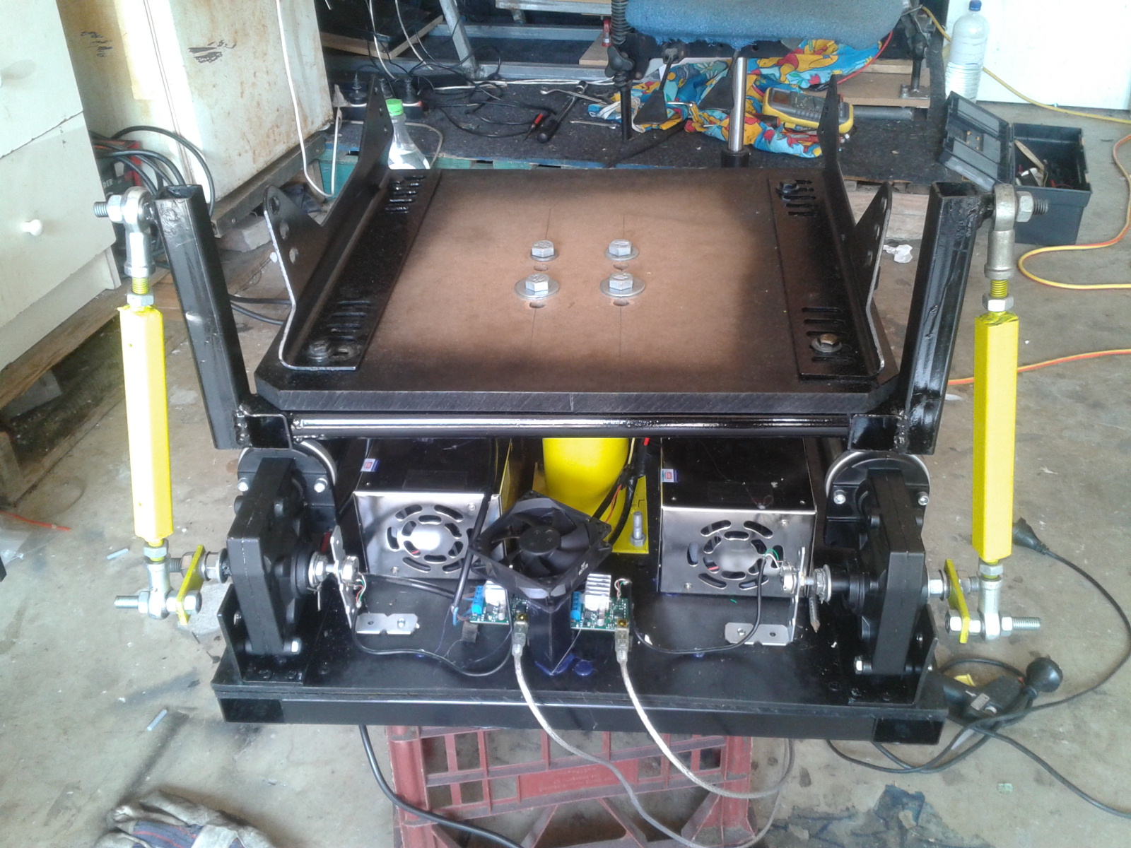

    Oh WOW is that alot of flex in Everything. I dont foresee thing's lasting terribly long with that amount of movement.
  4. Cataron
    Cataron Member
    Jan 14, 2015
    61
    305Coins
    +39 / 0 / -0
    Uhuh, isn't it ?
    Two things are wrong : the bottom plate, and the squares of the motors (thought it was reinforced but no)
    First thing, will have another plate 34mm thickness, should be alright
    Second thing, I'll try to find other squares, or put two squares together to avoid the moves seen on the video
    I also think about making something to fix the potentiometer directly to the motor, so that it will follow the moves (but I have to reinforce anyway)

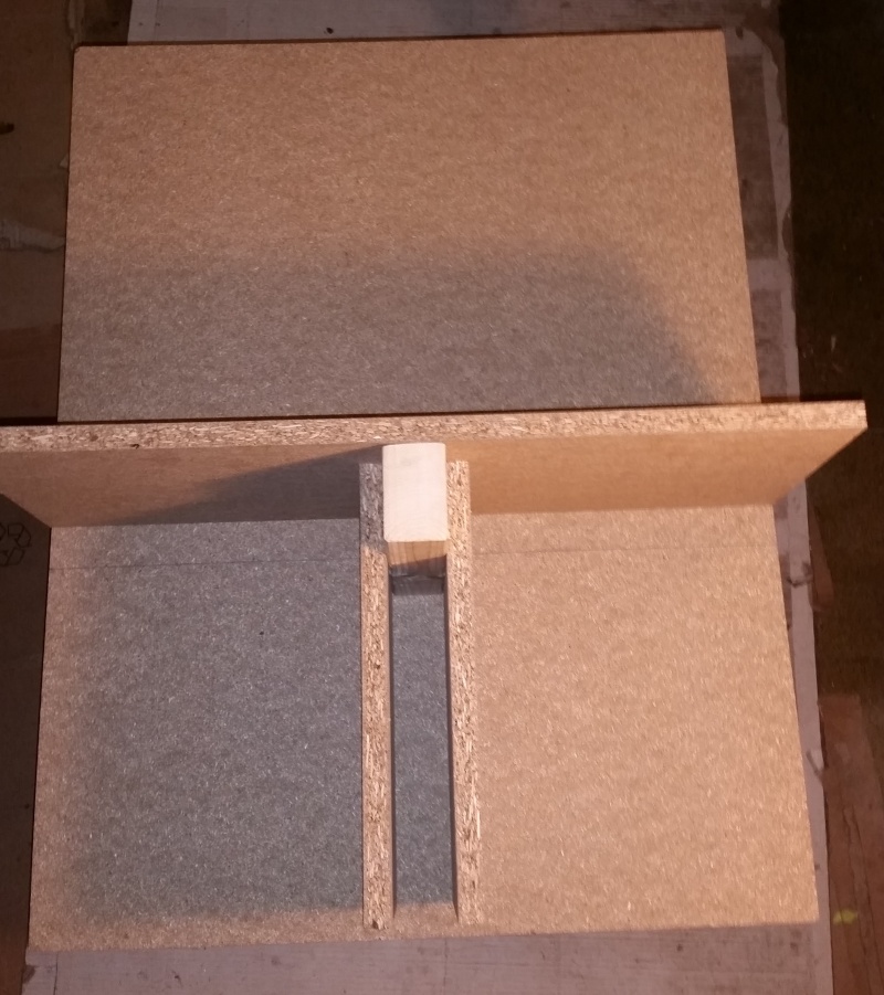

    or maybe make a base like this instead

    @Cataron
    Thanks for posting this up! I have also bought the Wanegain SimuKIT and trying to find a few quiet days to start it. Hoping I can next week.
    I saw the flexing in your board. Wow! Is that because of the 18mm wood? You said you also reinforced it? And it still flexes like that?
    Do you think the wooden brackets Wanegain used helped give structural support to disperse the force?

    Yes I think this way of building is much better but I'm not 100% sure
    The thing is you have to find reinforced squares for the motors.
    This is what is wrong with my building, the potentiometers lose some information.
    I glued two pieces of wood for the plate together to be sure it won't break, but it has made the whole piece to be very flexible
    But I think the main problem is the fixation of the motors

    @Cataron
    I have the same brackets(squares) for the motor. What do you suggest for reinforcing it?
    It doesn't look bad in Wanegain's video. Do you think the flexing of your base is adding to the effect? If the base was stable, it would probably be more secure?
