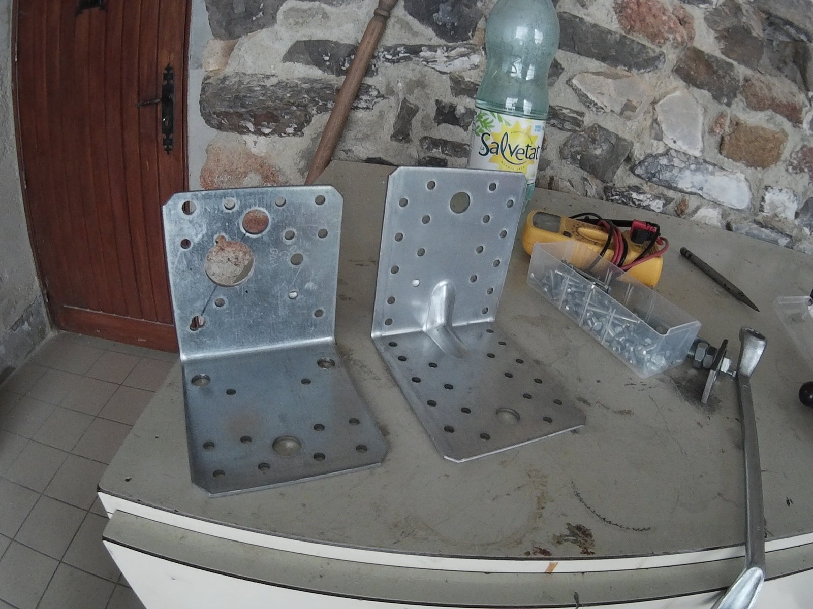

    I'll post some photos this evening to show you what I mean by reinforced brackets, I can't this morning

    So this is the difference I wantd to show you :
    The one on the left is the one I used to begin, and you saw the results in the video.
    So I found a reinforced bracket (on the right) and used it

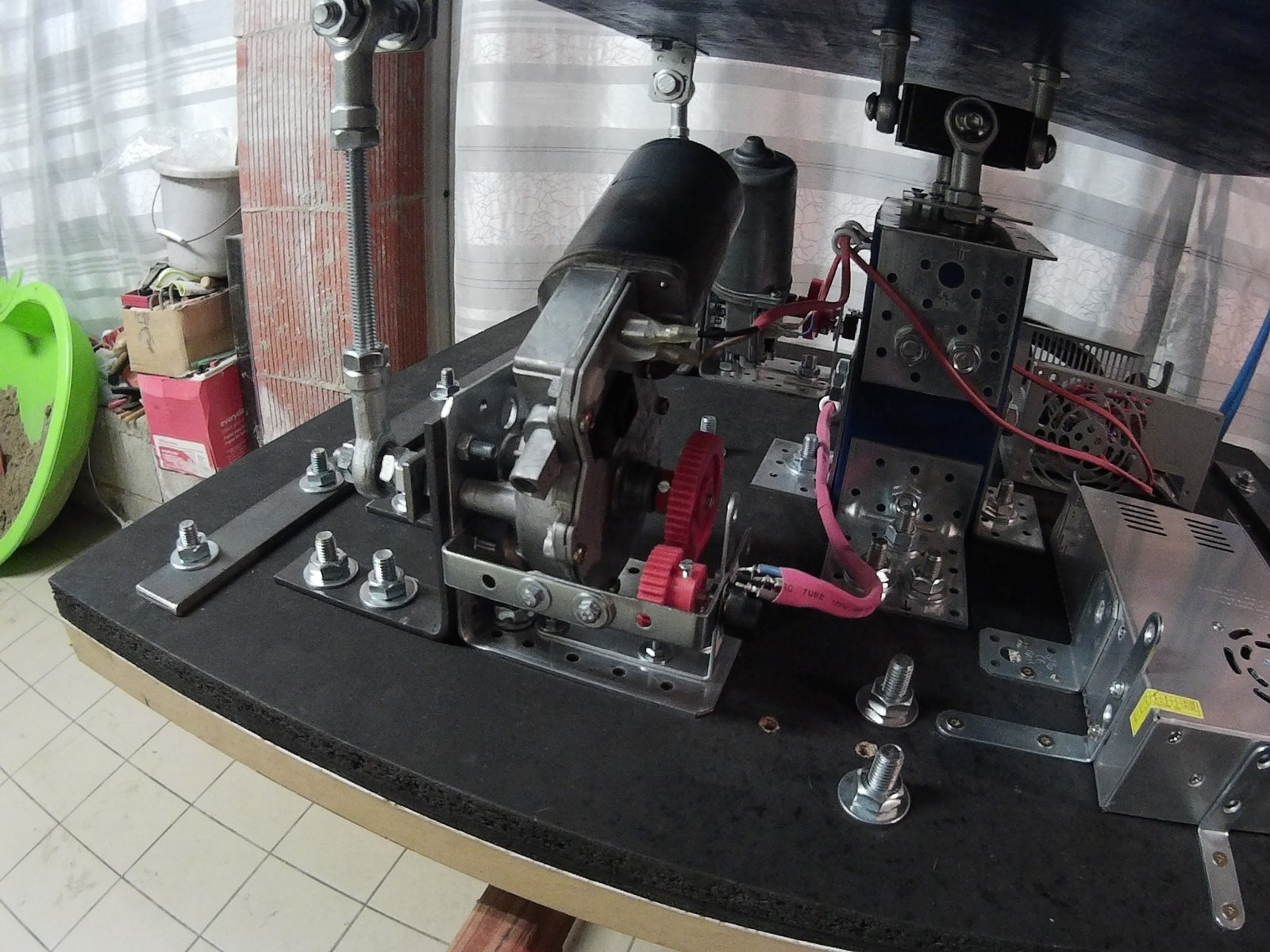

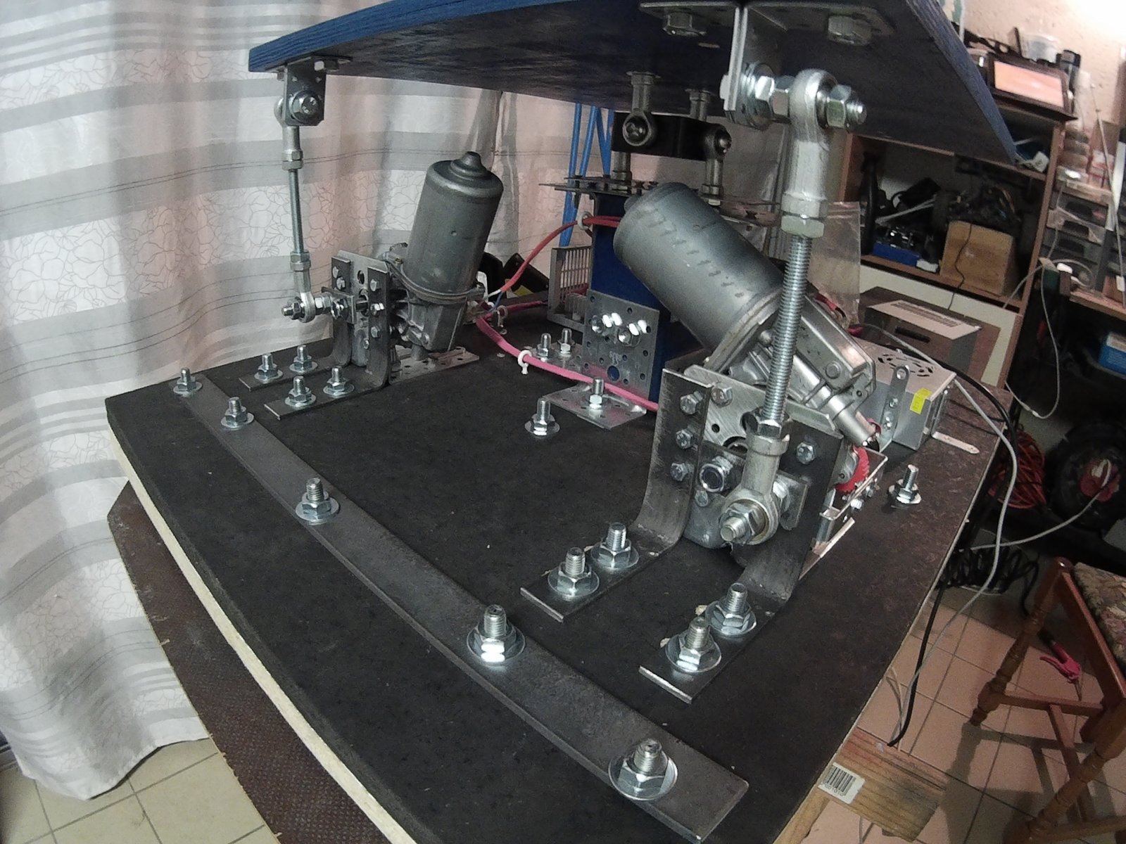

    And this is how it looks like, now :
    I strongly reinforced the fixing of the motors, AND I changed the position of the potentiometers, in order to make them follow the eventual moves of the motors (which I hope not)
    The first tests without any charge, seems better than previously, and every changes I made seems to be accurate.
    Next test tomorrow, with the seat and the main problem on it : me :D

    Looks much better lets hope the problem is solved, if Not i can see one area that could help but would require re drilling or remaking your L brackets you bent up.

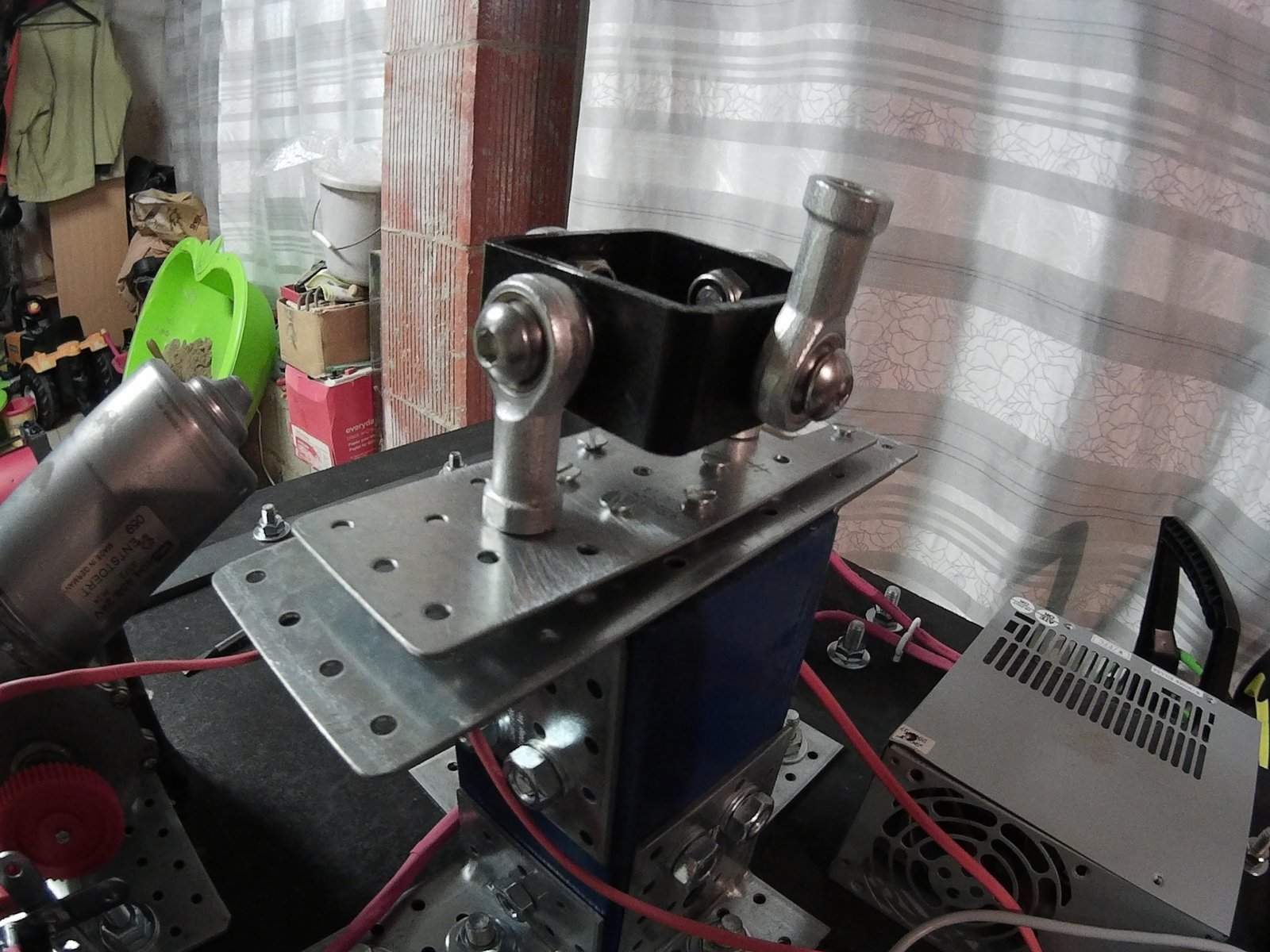

    I also tried to modify one other thing that was quite flexible :
    I'll post tomorrow what I've done, it's enough for me today

    Oh my, I hope that's a shot of what it looked like Pre modification, as that does not look very sturdy at all. (sorry to say) :blush
  8. SeatTime
    2,572
    +2,854 / 40 / -0
    Have never seen a uni joint setup like that before, does it work OK?

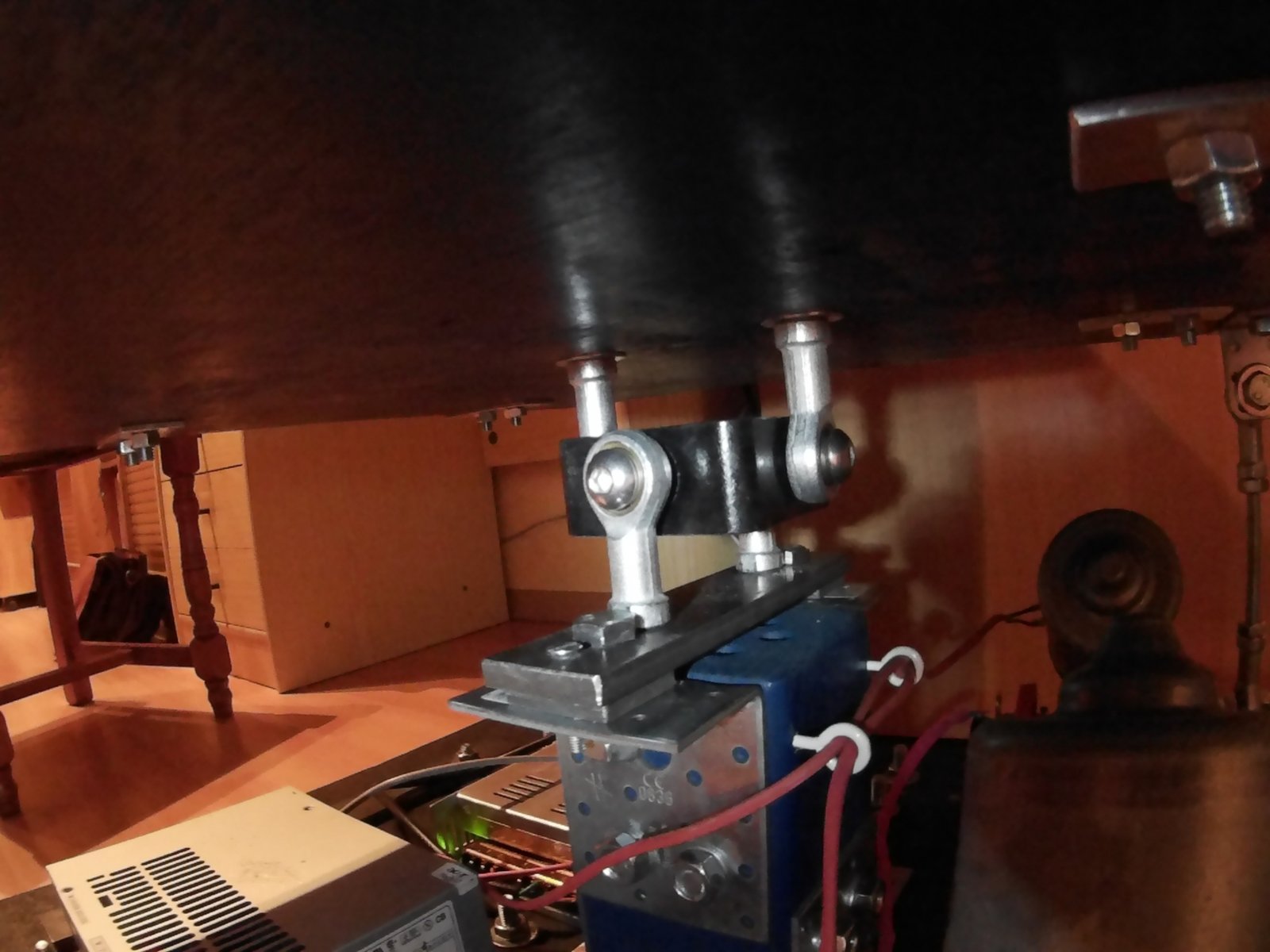

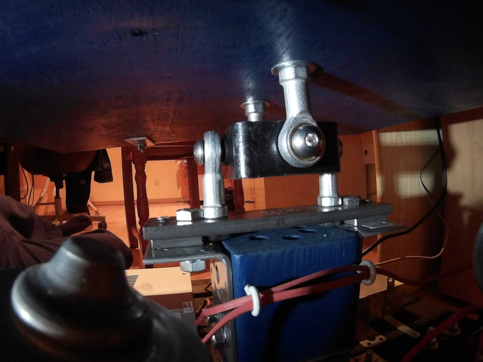

    This is how it looked like before ;)
    But it used to work, although I wonder if it's another cause of the flexibility when working

    the only thing that could be wrong is that when on the seat, if we were moving, most of the time , it was rotating (can't remember the exact name)
    22,208
    154,711Coins
    +11,212 / 57 / -2
    That sounds like you are describing lateral twist @Cataron, if you mean the seat tries to turn clockwise and anticlockwise around the pivot point when it is in motion.

    +39 / 0 / -0
    That's it noorbeast.
    When I disassembled the connecting piece between the seat and the post, it was twisted, think I made the good choice before evrything broke

    Well, I was watching this thread as well, I think this will be my future project.
    If it works this evening, I will leave it like that for the moment, and maybe in few months, begin another one with 3 or 4dof
    I'll put a picture of what I've done, I think it will be enough for now, and, I have to build a structure for my wheel now.
    I don't want my wheel and pedals to follow the moves of the seat so I have to imagine a way to fix evertyhing to the bottom plate
