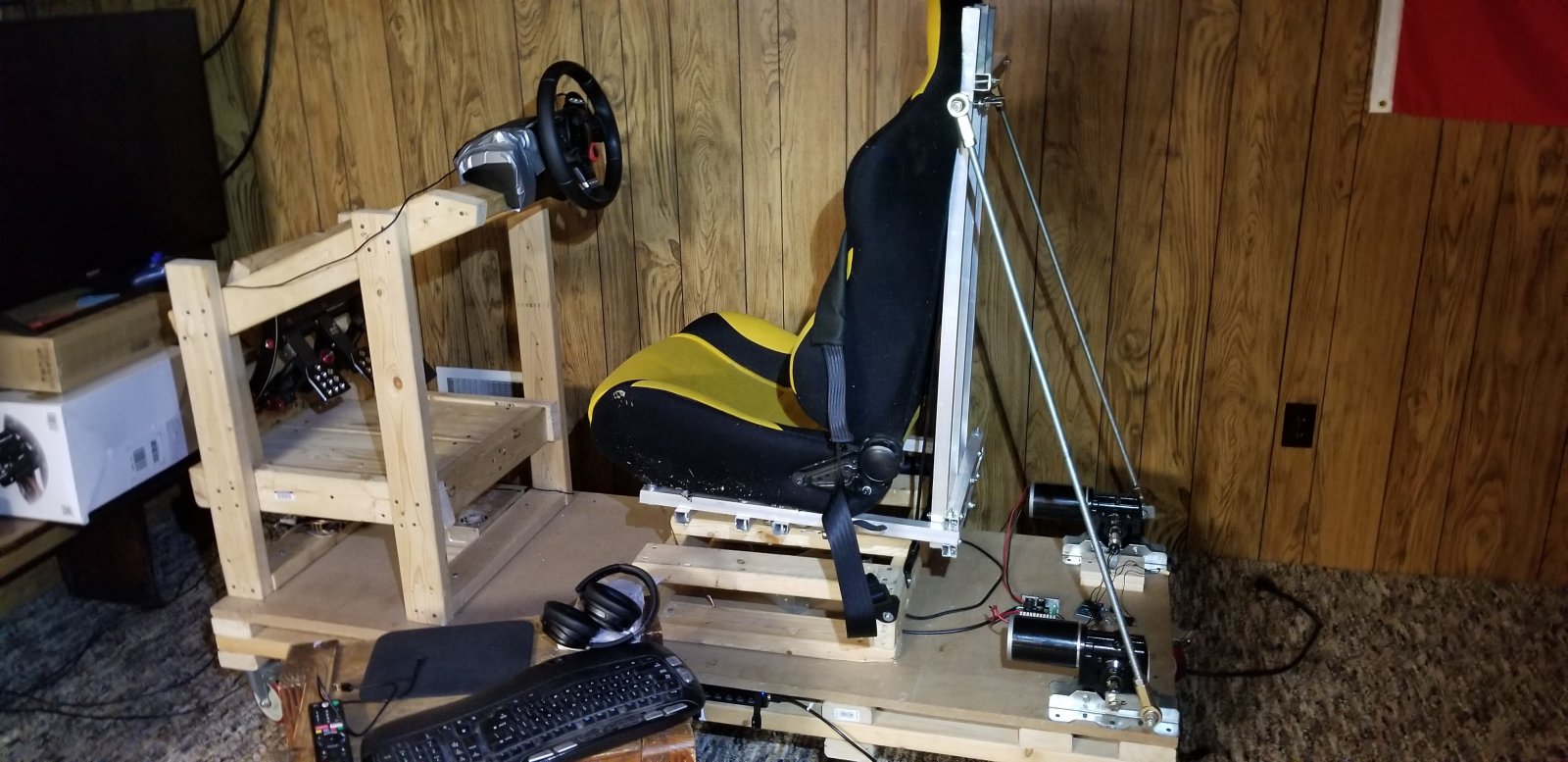

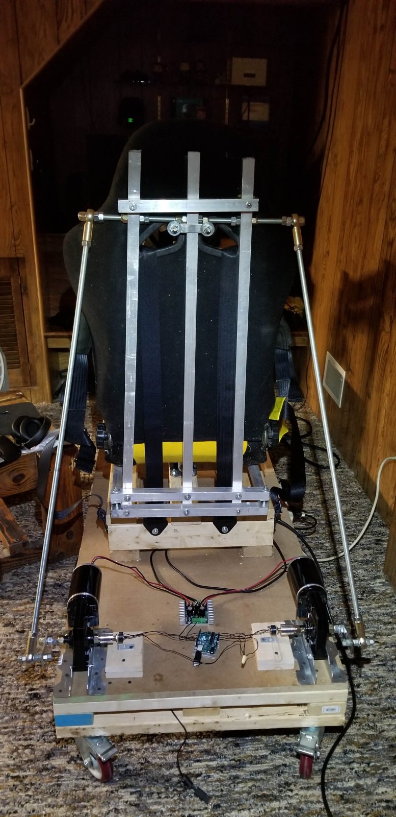

    Small Update:
    I added support to the back of the rig where the arms where connecting to the rig. Originally I had a single vertical support shaft in the center of the rig. It was not sturdy and caused a lot of play.
    I took some time to connect a USB hub and a power strip to my rig so that I connect all of my devices easily. The hub connects to my gaming pc with a 15 foot Usb cord.
    My rig is on a platform that has locking caster wheels, this allows me to push it into my furnace room when not in use. The idea is that I roll my rig infront of my oculus cv1 cameras, connect the usb hub and plug the power supply into the wall and I am ready to play. It works in practice and haven't had any issues with they "moveable rig" design. Ignore the duct tape on the DFGT. It's long been time for an upgrade, a fanatec csw v2.5 is what I've set my sights on.
    One of power supplies burnt out while using the rig at the end of the first day of testing.
    I had two of these cheap switching power supplies and intended on running them in parallel. After the first one burnt up, I had the choice to buy another cheap one(under $20) and then connect them in parallel and hope that it was sufficient or look for a tried and true power supply.
    I ended up ordering one based on this conversation: https://www.xsimulator.net/community/threads/the-ultimate-power-supply-thread-for-sim-builders.6793/
    Here is the power supply. If I would have went with this one originally it would be about the same price as the 2 "cheap" ones I started with.

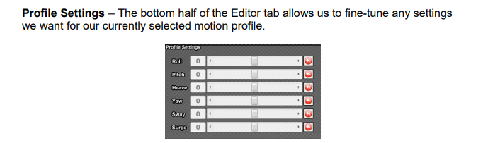

    2) I feel a bit dense reading this section in the manual:
    When I accelerate, the surge and pitch forces should be the same right? The weight of the car gets shifted to the rear and the front end lifts due to acceleration. So, the surge force should push me back into the seat AND the pitch force should push me back into the seat. The way that I read that section, it makes me think it would do the opposite.
