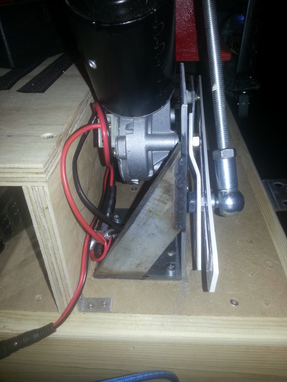

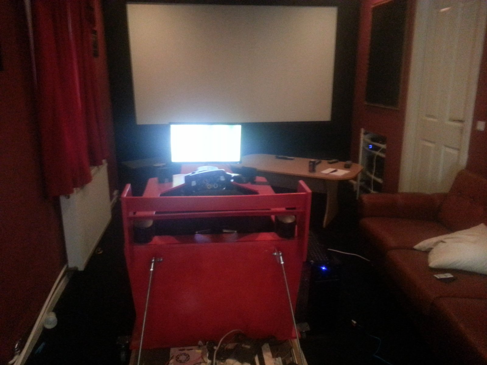

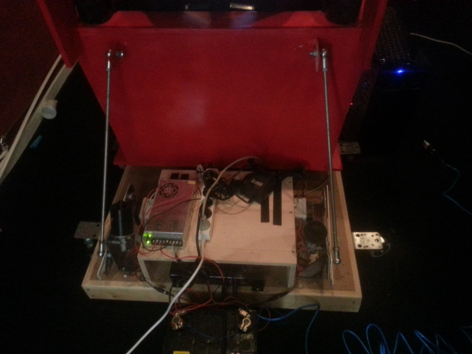

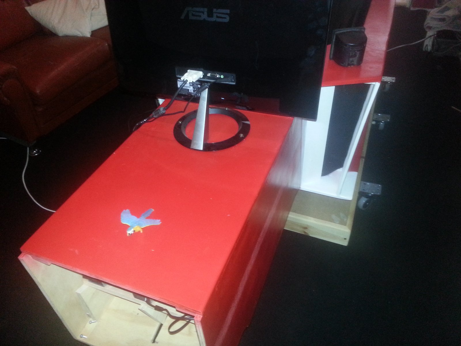

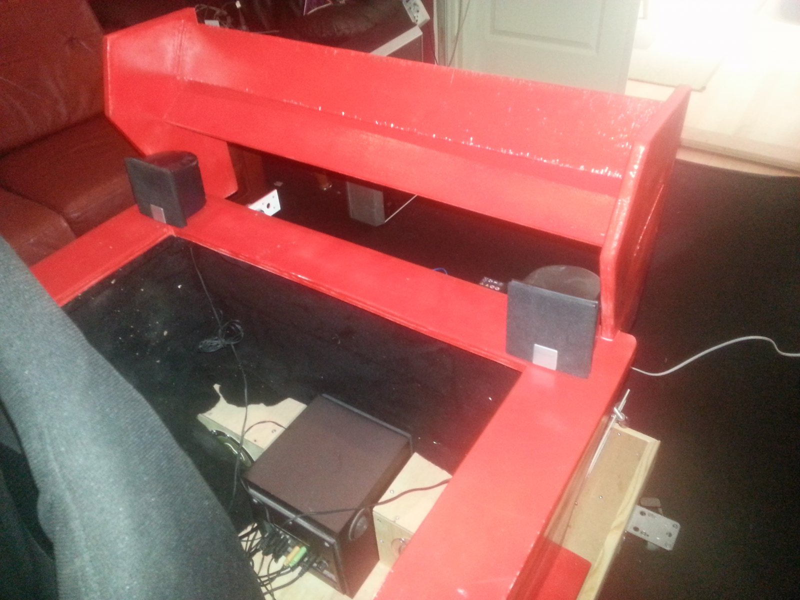

    Made some welding on the motor brackets and i must admit what a diffence it makes the noise is gone and much more smooth motion.
    Bought simvibe yesterday had it run once. nice feeling. didnt had the time to test much.
    Thinks still to do.
    Cleaning up the mess behind the cabinet, cable´s etc.
    Actuator for pedals, need to mount this to the pedals.
    a bigger screen
    and maybe alot more ;)

    Great work...and don't forget the video :)I like the detailed finish, I know this needs so much time to complete.
  15. bsft
    looks good man
