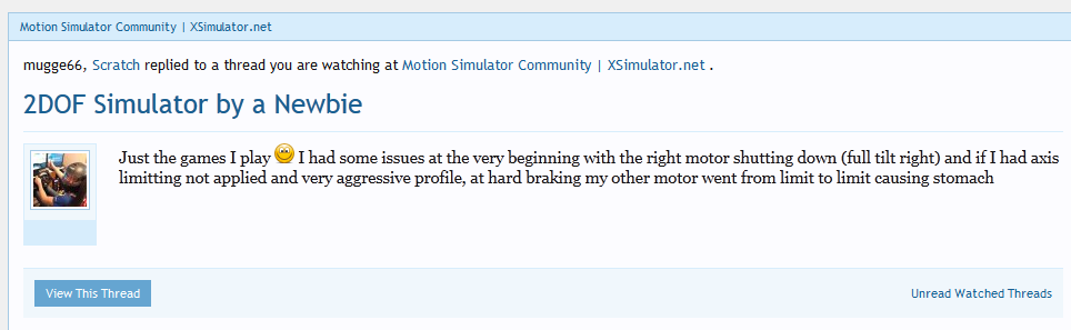

    It´s not that im sure of this. In AC i can drive at monza no trouble here good sim feelings and motion, but if try Spielberg i have severel of these dropouts where the sim just throw me sideways this is both happening with old and new installation. In iracing i didnt have any problems at canadian with old win but with this new installation i have. i will try to post video later or perhaps tommorrow. this is only happening at some tracks it´s very wierd.

    Scratch this is exactly what my sim do, Full tilt right. how did you come around this ?

    Oh, sorry messing with this post, I was writting a reply, unintentionally send it while writting it, deleted it and then lost it, was going to post you again properly.
    Solution: Try to decrease axis limits, i decreased it from 100 to 90 and I think that solved it. At least my rig does not do it anymore!

    Big thanks., It help by setting the axits limits to 90 :)
