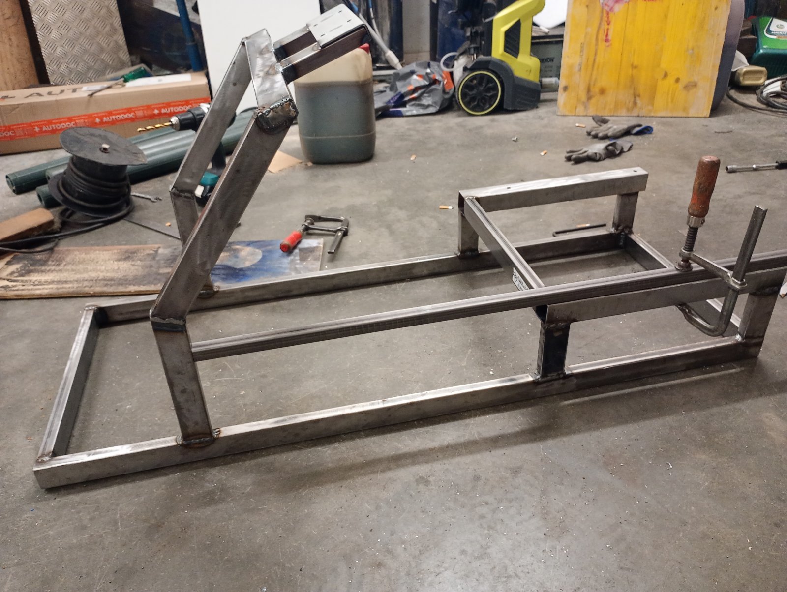

    Nice. That shaft is a monster.

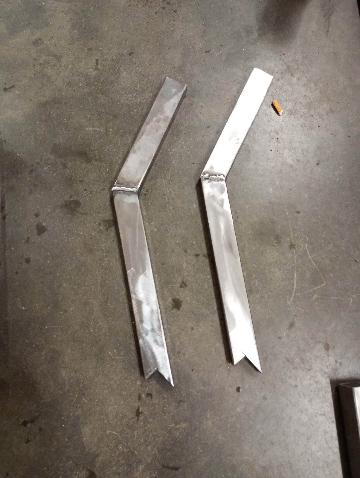

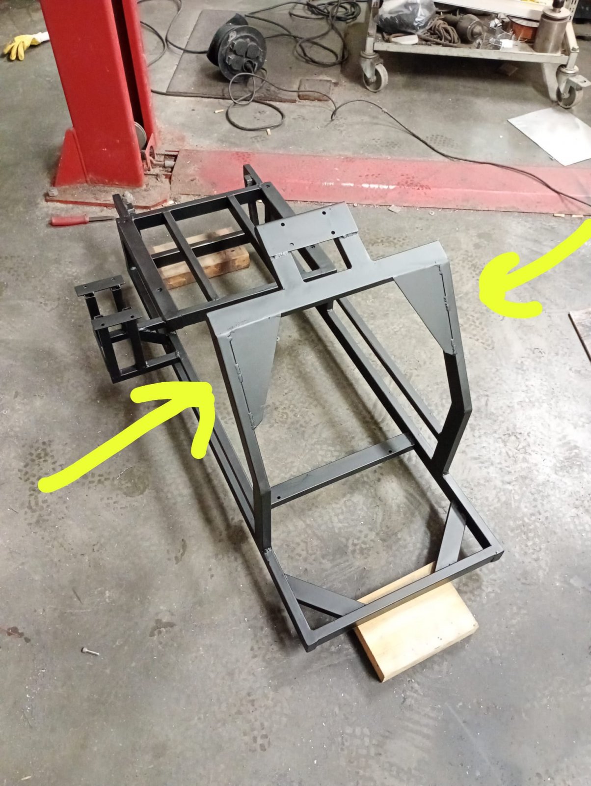

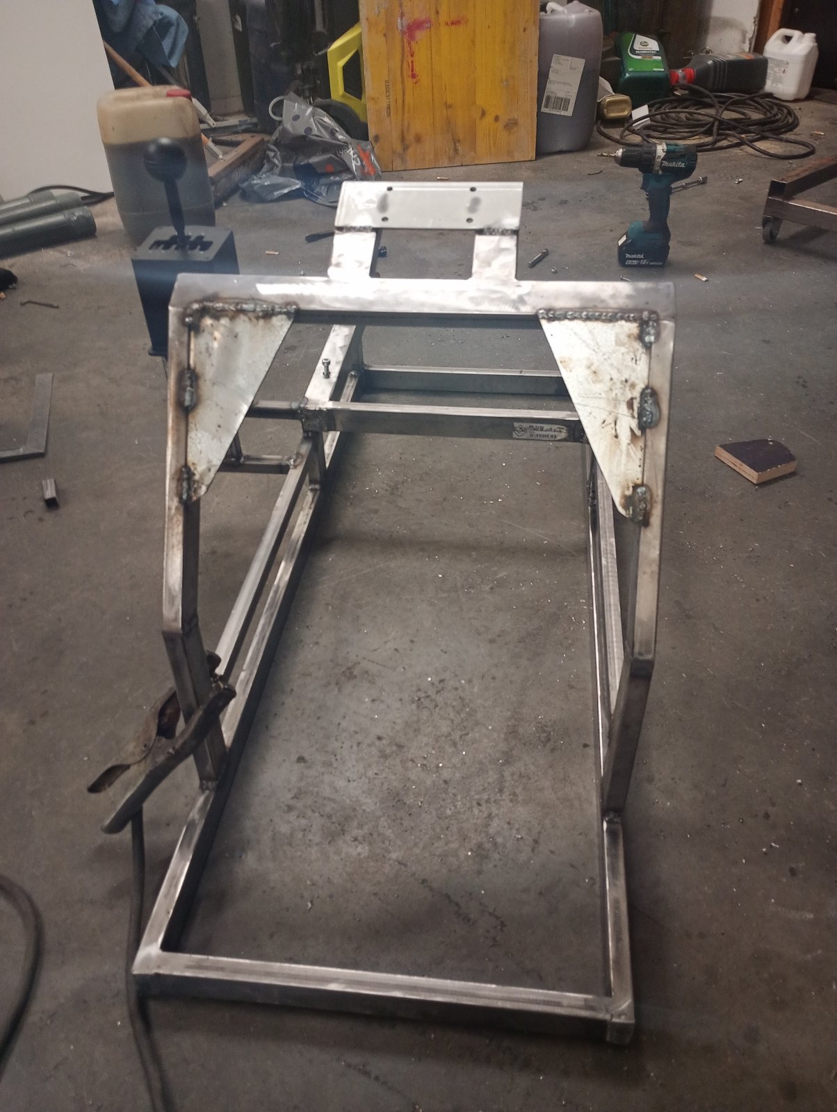

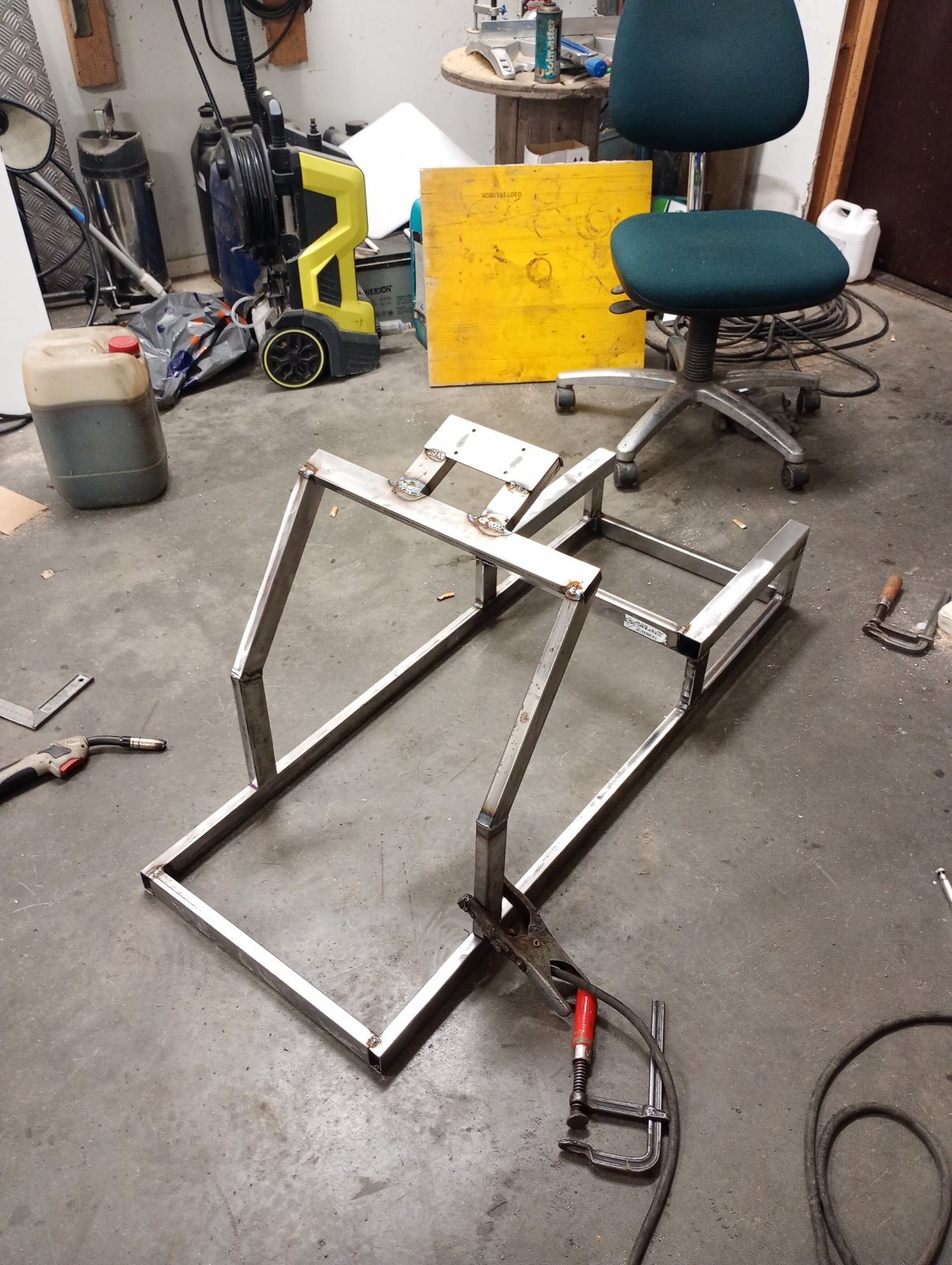

    Some frame welding.

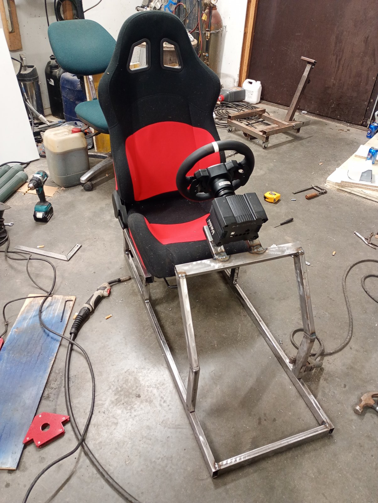

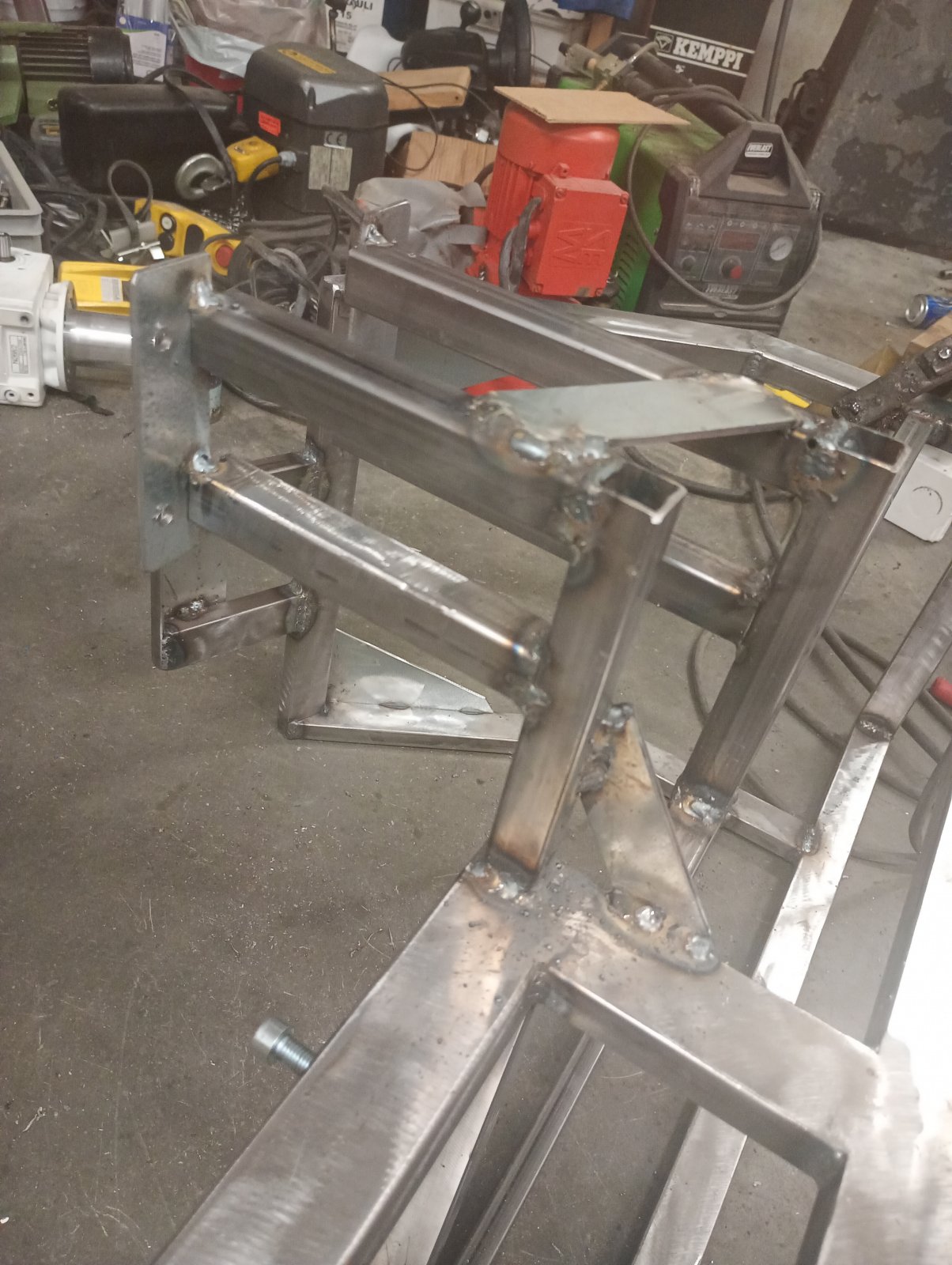

    More progress... IMG_20250220_214540088_MFNR.jpg IMG_20250220_224334448_MFNR.jpg

    That seat looks almost exactly like my old seat. The reclining is convenient but is a wel point in terms of stiffness.
  5. TomSim
    TomSim Member
    Feb 12, 2025
    32
    192Coins
    +7 / 0 / -0
    It really seems veri stiff, At first I thought that it will need some supporting tubes but now it seems very stiff. I think I have to drive it day or two and see if here is something to modifyi. Of course I don't know if it is difference when it is in 2dof use than now...maybe I just overkill it right away.

  6. TomSim
    TomSim Member
    Feb 12, 2025
    32
    192Coins
    +7 / 0 / -0

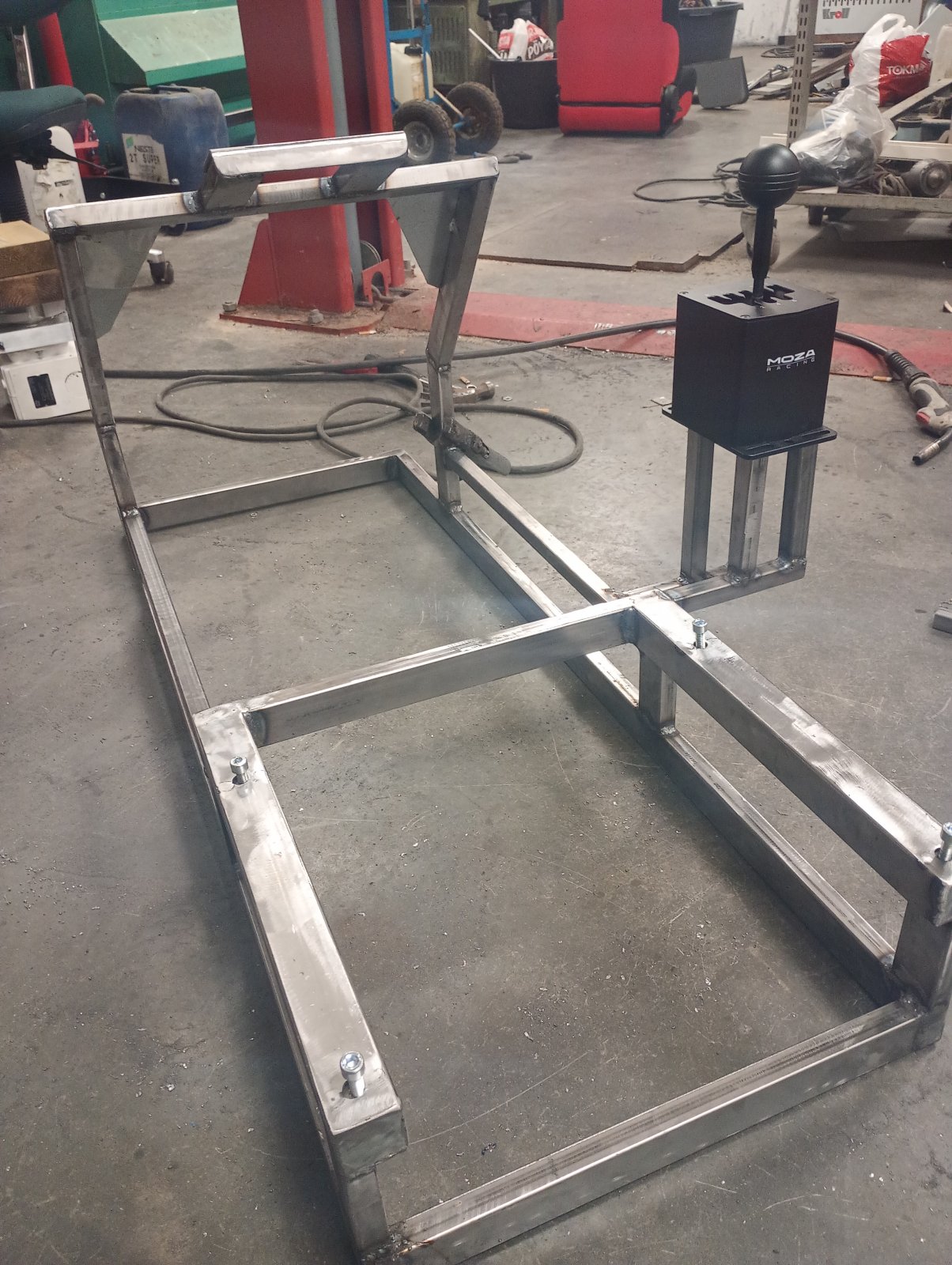

    I thought that this kind of supporting beam would make it rock solid. It of course makes harder to get out form the seat.

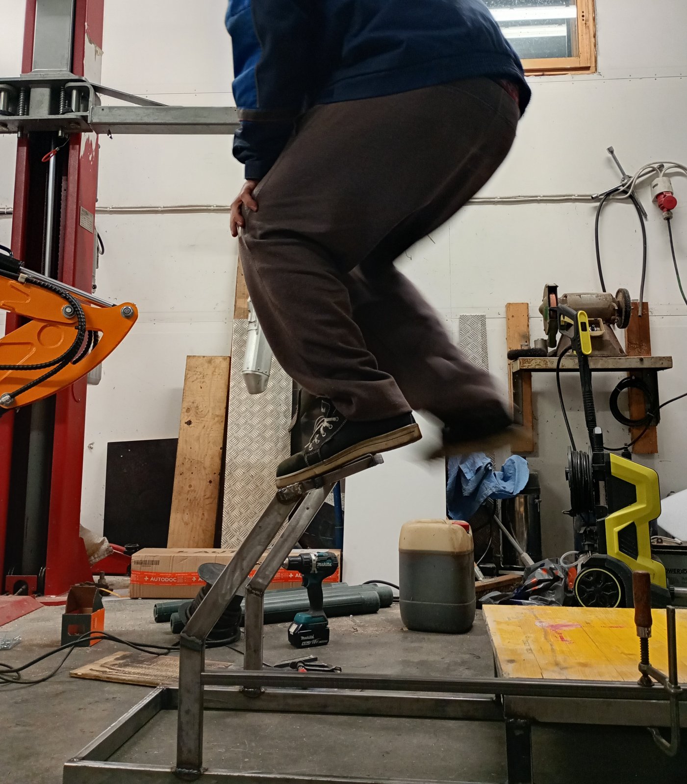

    I weight about 97kg

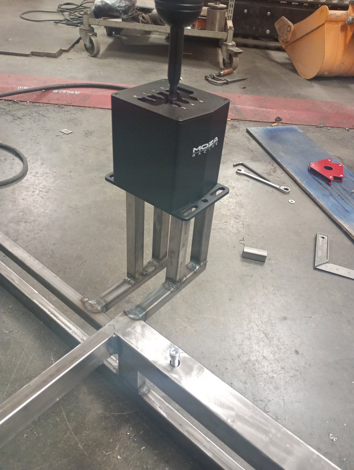

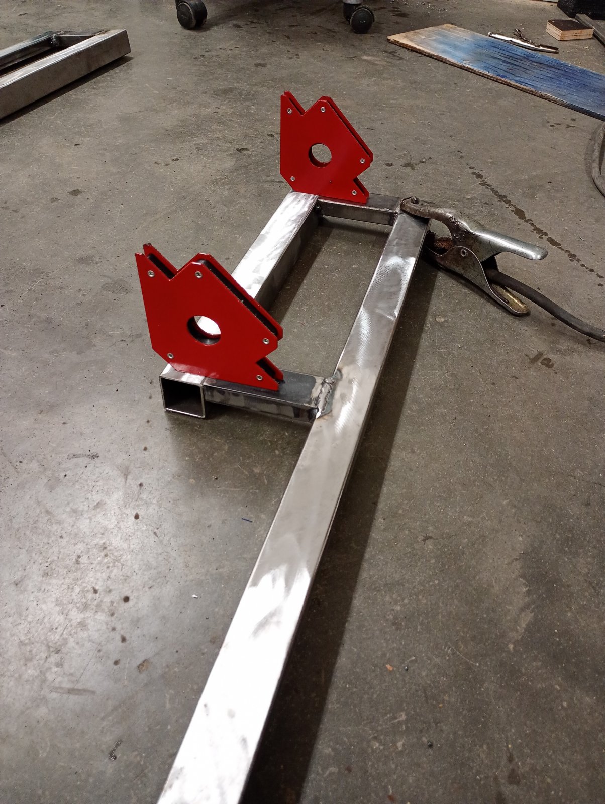

    More progress made. Thread inserts welded inside tubes for the seat, shifters attachment in progress and more some supporting pipes and steel plates added. It is still very lightweight, I will weight it when it's done.

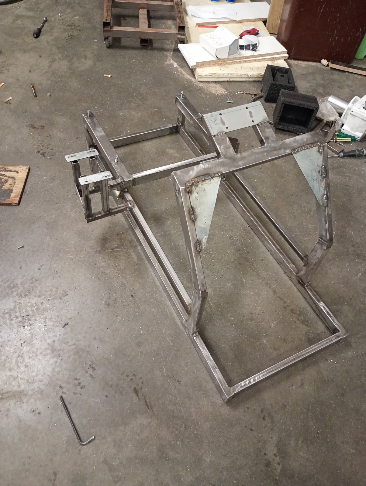

    And again more supporting structure.

    Weight is 35kg with seat, shifter, wheel and pedals and I'm 97kg. Is that good or bad? Maybe those 500w motors will have enough power?

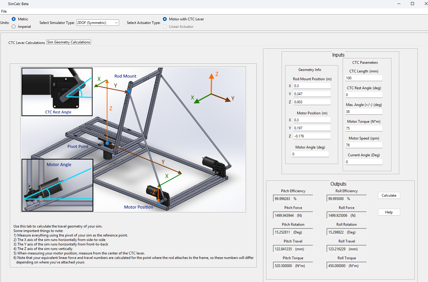

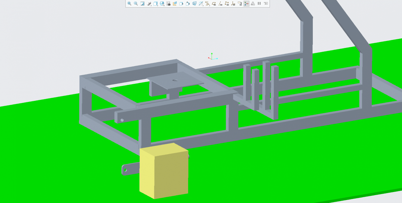

    Here is what I have simulated with simcalc. There is also picture how I'm gonna place motors and uniball rods,
    I only put together the right side for the sake of the example.

    This top part where wheel base is attached gives little flexing from side to side. I trying to think where I should maybe add some support. It may not need any but if it does, is someone who can give me advice?
  19. noorbeast
    22,202
    154,675Coins
    +11,209 / 57 / -2
    Is it side to side flex or a slight torsional twist?
  20. TomSim
    TomSim Member
    Feb 12, 2025
    32
    192Coins
    +7 / 0 / -0
    Mostly side to side and some up and down. I didn't know about torsional twist, I
    need to look into it more.
