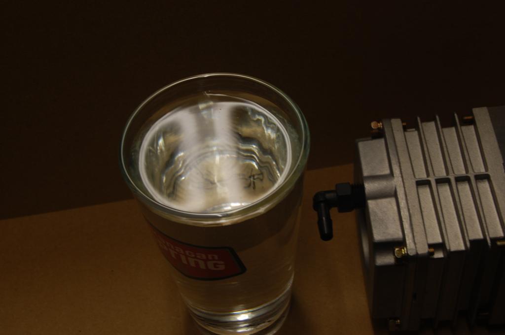

    Hard mount
    Thin Foam
    Thick Foam
    • Creative Creative x 2

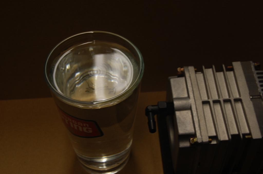

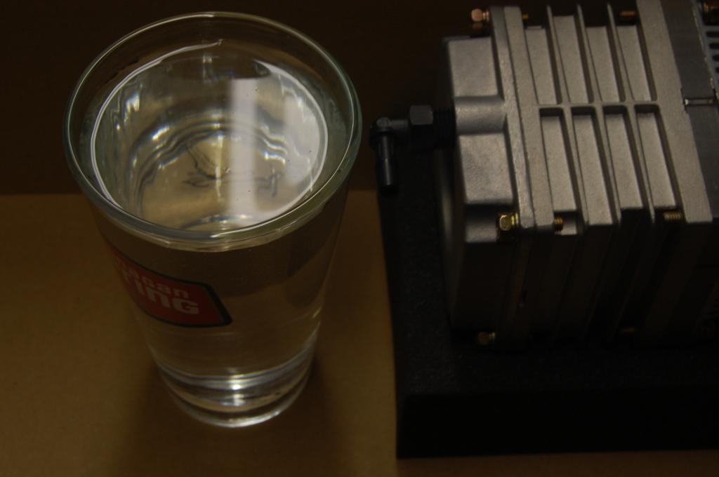

    Well here she is, Completely Overkill on the project but hey, what the point of a project if your just going to hack it together and make it look like crap.
    Baffles were Dadoed into place but were unfortunately a little loose, So Good ol Wood glue to the rescue.
    Figuring out the corner's with the foam.
    base foam
    80x80 fans will be mounted to either end plate and One will Suck and One will Blow....Ill be finishing That up today when i return the 200mm Fan I attempted to use(Way too low of CFM)

    Correct Insane. Its a Air pump enclosed in a sound proof box. Pump is for the Ekretz mod on my Fanatec CSW. M000000re POWER!!!!!
    This Box will also double as a stand for this Bad boy.
    Fan's mounted Tested a Work Freaking awesome,
    Intake 120mm fan is 2000rpm and 70 CFM
    Exhaust is 80mm is also 2000rpm but only 31cfm

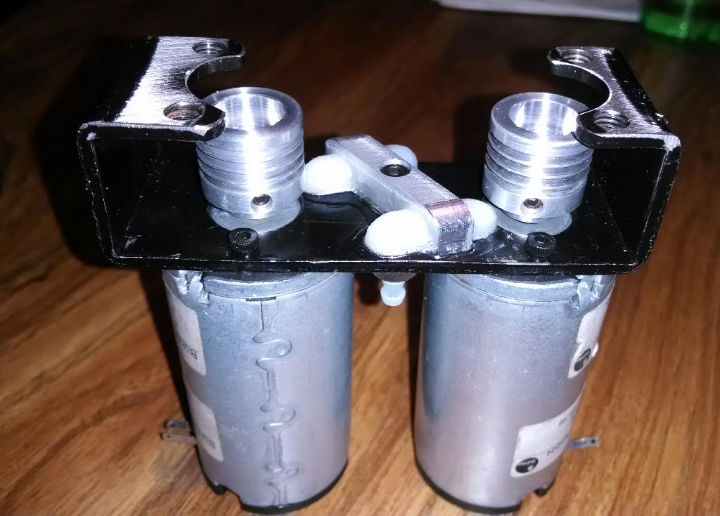

    @bsft - He is going to change his motor from Fanatec CSW wheel with bigger and better one (Buhler motor) and once he meets it's force he would need to cool it better than the current stock fan inside Fanatec.
    Therefore the nuclear reactor ;)

    I haven't ran the Air line yet, so that might not help seeing the end product and what its for. But ya. All thats left is to wrap it in some carpet, Drill a hole for the 1/4" tubing and power to come out and wire up a 12v supply for the fans. Then just wait for the motor's and Mod parts......... Then take apart the wheel and go to the machinist buddy and go to Town Lightening Everything we can to reduce the Free wheel friction as Much as possible......Then Install a Slip Ring like this to again aid in removing the friction...>Then im sure ill find more stuff to do.......lol
  18. Nick Moxley
    17,057Coins
    +2,506 / 30 / -2
    Maybe this will help, Air Passages into motor's
