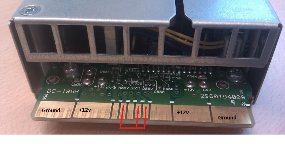

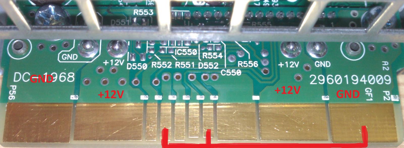

  7. bsft
    Yes I am now curious about the server PSU, I will wait to see how they actually get wired up, I am sure I could find the 12v with a multimeter though. In AU, they are $35 each delivered at 575 watts, thats definitely cheaper than the others.
  8. Historiker
    2,162
    9,214Coins
    +2,170 / 19 / -1
    If you are using the 700GB (700W) they should look like this, mine do anyway. Two alternate ways to jumpering the PSU, both work. HP DPS-700GB.jpg PCB-700GB-TOP.jpg
    The above images were found in this thread, there are 157 pages of information on various server PSU hacks:
    http://www.rcgroups.com/forums/showthread.php?t=1005309

    "Apr. 30th, 2013 - Been a long time since I have edited this page and thought it was time to add a few things. When I posted this project little was known about these PSUs. When we started using them we simply tried pins until they worked. Now we know the pin-out and there are many more interesting things you can do with these guys. For starters, we found that shorting pins 6-9-10 together powered them on. Unfortunately pin 9 can be used for adjusting the voltage. Shorting 6-8-10 also turns them on and leaves 9 open for use. Putting a 1K ohm pot between 3-9 allows for output voltage adjustment up to 13.8V. Shorting pins 4-8 will lower the fan speed but the PSU can still raise the speed when needed. "

    Hey Nick, could you link to the original post you quoted from? I would like to read more about that myself. My PSUs are outputting the regulated 12v but it would be cool to be able to bump them up to 13.8 if that will also increase the amperage.
    Simple linear pots should work, as long as they are good quality.
    An update on the performance of my PSUs. I have spent the day playing Asseto Corsa pushing 3DoF (traction loss) and they have performed perfectly. They do get hot but if that worries you a cooling fan could always be hooked up to push air through them.
    Edit: I found it :)
    http://www.tjinguytech.com/my-projects/HP47A
