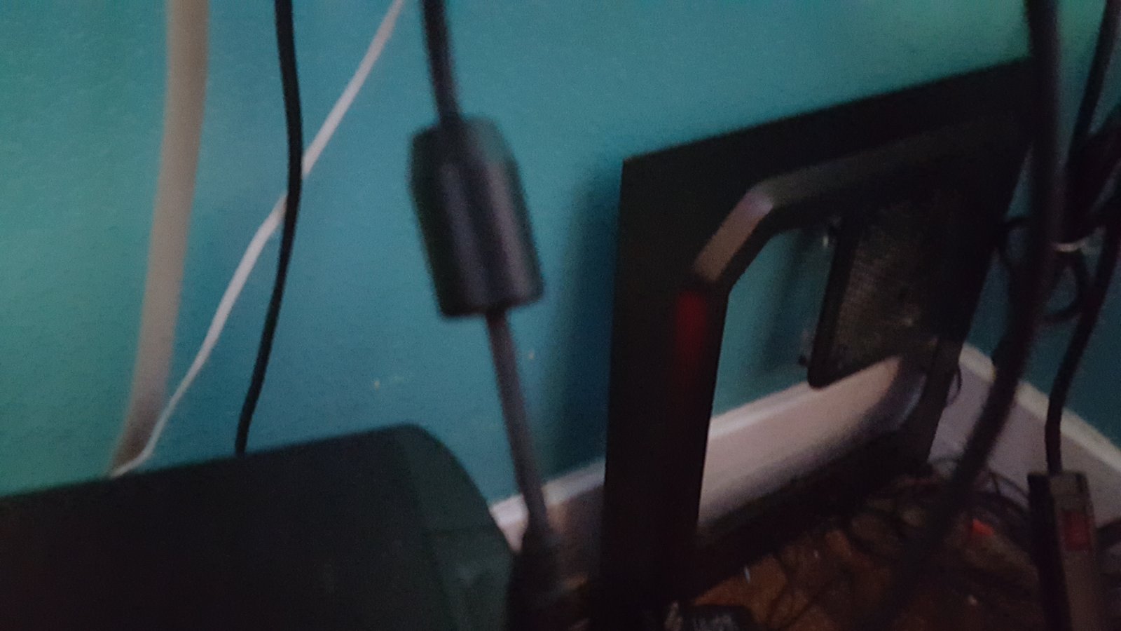

    So Small update for some electrical stuff, I ran the Stock Mini USB wire that came from Pololu since the beginning of my rig and while it worked great, i would get the odd shut down that called ZERO motor driven error's, NO feedback disconnects, Nothing out of the ordinary that i could put my finger on. But yet somehow Simtools manages to loose connection with the PC requiring exiting/crashing/refiring up Simtools to get the motion back.
    So after a few discussion's with pololu and Robbie, The Pololu tech suggested i try some Ferrite shielded USB cables. And what do you know, They seemed to help, I was able to run my rig even harder and faster than i was before and no fear of any shutdown's.
    So a word of advice, Get some quality Sheilded cables for your JRK's. PS, you dont have to spend big for good cable's. Just make sure they are 28/24AWG

  12. Boomslangnz
    Oct 26, 2014
    346
    4,170Coins
    +243 / 1 / -0
    Thanks for the info @Nick Moxley
    Ive had some issues with usb cables too, had random shutdowns the same and found changing usb cables fixed the problem but would still ocasionally have the odd shutdown (pretty much none now) however Ive just ordered some of those usb leads you got to replace all mine as they sound like what I was looking for (good quality usb leads) DO NOT BUY JAYCAR ONES they are useless for NZ and Aussie people :)
    Just a small word of warning that amazon gave some crazy shipping price for those usb leads like $270 nzd just for shipping but I found they also sell them on ebay and only about $30 nzd for shipping for the exact same usb leads

    Just type in ebay Monoprice USB 2.0 A Male to Mini-B 5pin Male 28/24AWG Cable w/ Ferrite Core
    Nick got the 6ft ones by the looks of it but ive ordered 4 x 6ft and 4 x 10ft to try out, was unsure in 10ft would be too long as ive found leads have to be as short as possible with jrks previously

    OK so next tip for guys who want to save a few $$ and maybya try their own Ferrite cores.
    I found they come in an assortment of sizes from like, 2-3mm upwards of 8-9mm diameter's for bigger wires. Prices can Vary but you can usually find them for under 1$ a piece.
    Search Ferrite Core on Ebay and you'll find plenty of sizes. I have some of these on the way and might test with the current ferrite shielded cables i already have. I mean after all who says there such this as too much shielding/protection.

    It is not the dollars that matter to me but where the cores are located on the cable, as I have a very small box for the 3 JRKs and very limited room. The clips will give me far more options to locate the cores on the cables.

    @Nick Moxley , I use these on video/audio to kill interference. they do work. i hope they work for you. i use ferrite cable for my rig.

    Yes ferrite beads are miraculous.
    I use them on every single cable of the rig (power and signal).
    I suggest to place them on both ends on long cables.
    As close as you can to the ends.
