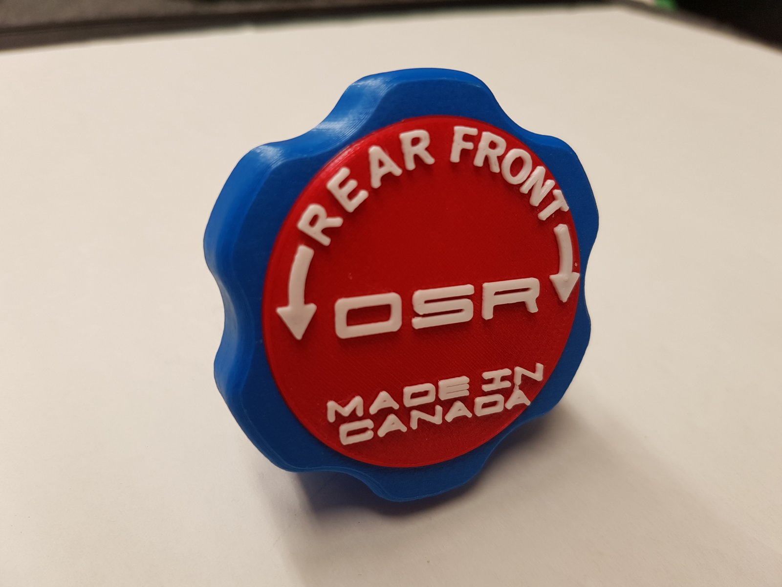

  10. Nick Moxley
    17,057Coins
    +2,506 / 30 / -2
    Lol, ya ive done a few dozen or so for my cousin, nice little $$ maker and forces me to get some colors which ive put to good use for OSR projects like below.
    Prusa is doing great, Its not Kapton tape you see but rather Blue painters tape, I use the tape when i want a nice visually appealing finish, the Glossy look of the print on the PEI sheet isn't always ideal for the objects i make. I wrecked my first PEI sheet pretty good with printing TPU and ignoring the rules, You can get replacements from other sources aside from Pursa. Its not very fun to replace, but lmk if you want any tips when the time comes.
